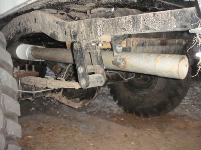

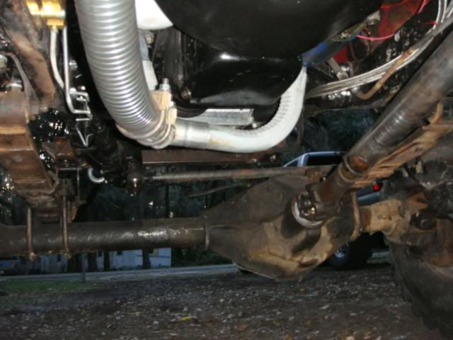

The open headers was driving me a wall so I slapped some redneck engineered eahaust on. Flowmaster 40 series, some tubing i already had ans some Advance Auto Parts flex tube. MUCH quieter and has a good tone.
