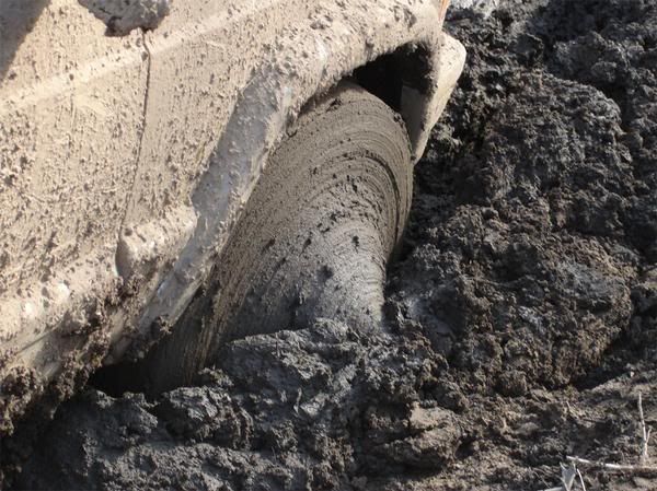

Originally Posted by jkl View Post
Welcome to Florida wheelin, most trails involve some sorta mud or slime. I didnt hit the hill as hard as he did, but it takes a little throttle to make it up the first half.
Yeah, Indiana is kind of like that, hard to avoid mud here. Not too many complaints with slime lol. Though we do have some pretty sticky mud:
Back when the Jeep was still stock, didn't stand a chance
Those are Super Swamper SSRs under there.
As much as I'd love to run a tire like a BFG Krawler, they really don't do very good in mud. I'm actually strongly considering TRXUS MTs for my next tire.
