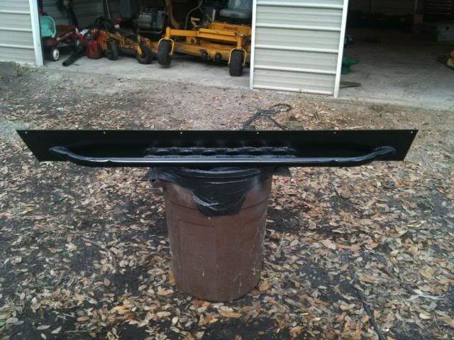

Got one painted today. Decided to rattle can them for easy touch up.

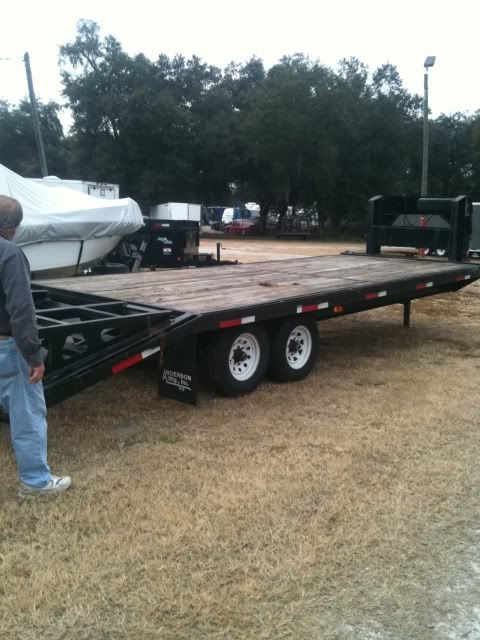

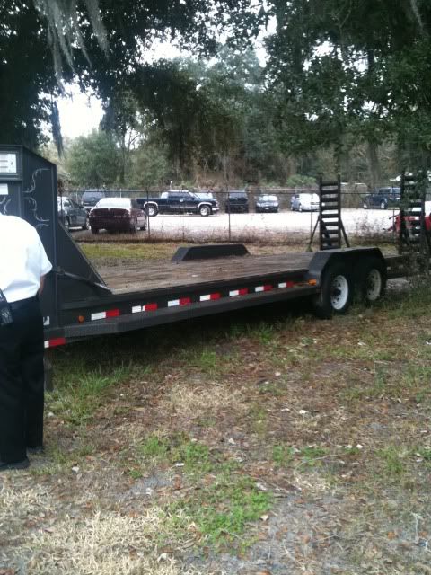

The other day at work we had to go to a trailer store and pick up a light for one of the guys. Walked around and found some smokin deals on some new trailers, but still a little more than I want to spend on a trailer that will only be used a few times a year. Also found two used 25' goosenecks. I think I'm going to go back and see what kind of deal I can work on the black one.

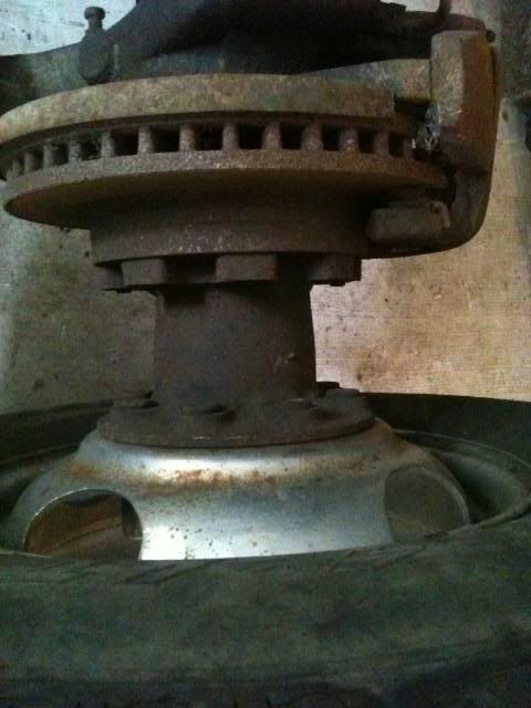

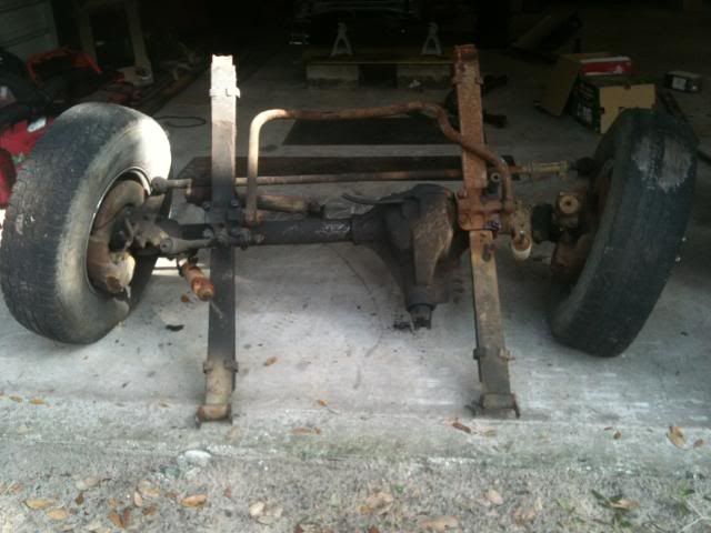

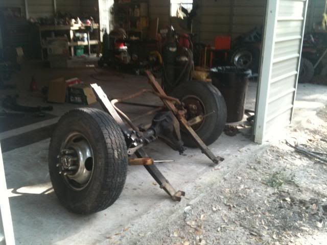

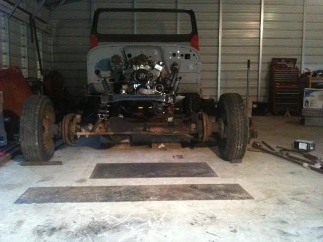

Picked up a Dana 60 today Found a dually front and going to run stock H1 wheels, just have to run spacers on the rear.

you know you can take the dually hubs off right? they're just extensions bolted on like a giant spidertrax spacer

You have to change the hubs to SRW hubs and change the rotors or drill out the old ones. I believe the later models have the spacer in them. Cheapest set Ive found was like $230 a piece new. There is an older article on pirate that says you can get them for $185 from six states distributors, but their website doesnt show prices.
Running H1 wheels has some perks - cheap beadlocks and they protect the locking hub. They have a 7" backspacing so it will bring the overall width down some. Found this jeep on pirate with the same set up (H1 wheels, dually front and spacers in the rear).

Takes "widetrack axle" to a new level
