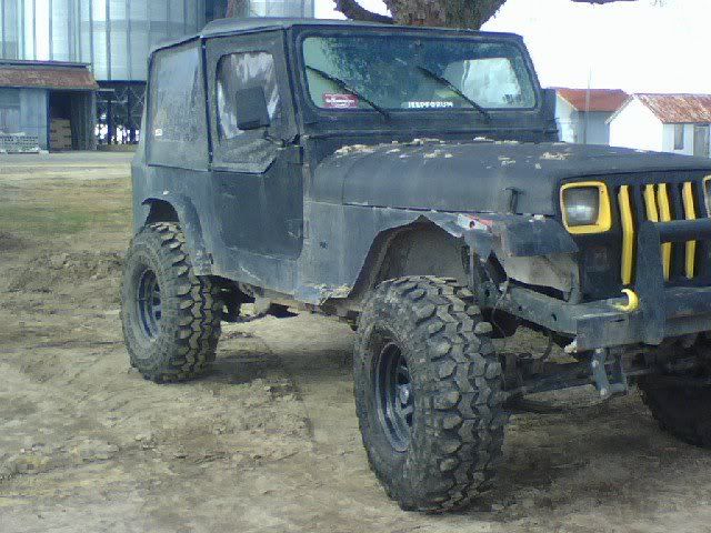

This pic below was after moving down, cleaned it all up, got a new used set of rims and tires, 31 Dunlop ATs
Got a set of 32 TSL SX's for a good price and threw them on, trimmed the fender flares, front fenders and front bumper. Moved KC lights from windshield to front bumper:
