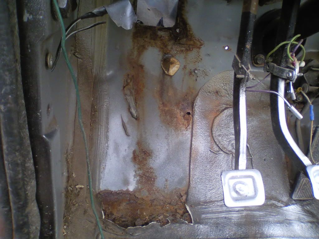

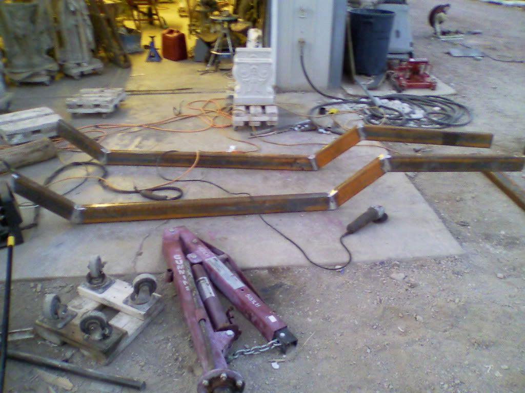

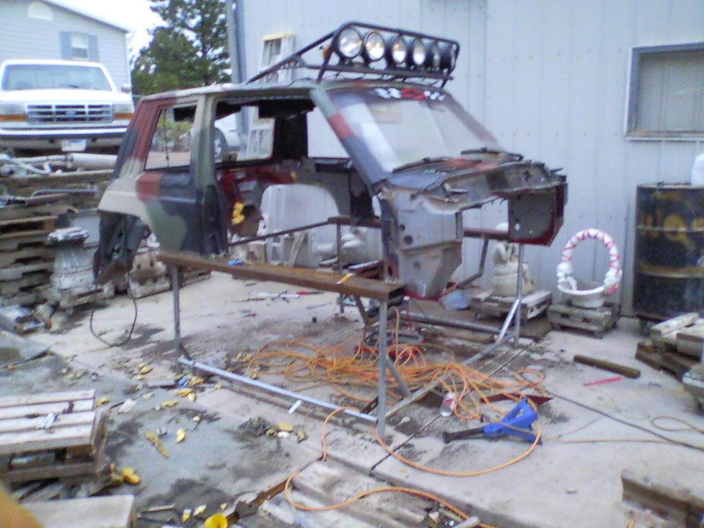

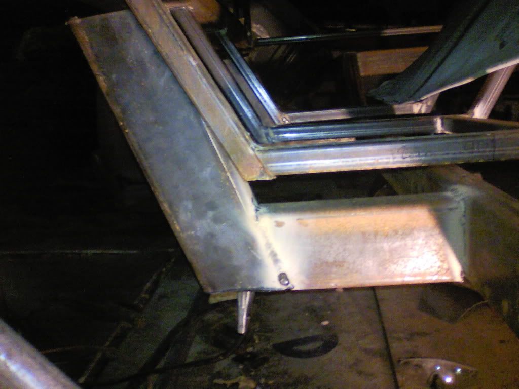

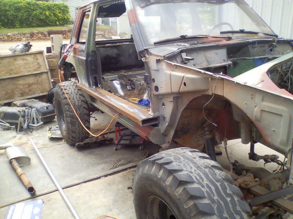

ive been working on this since august when the unibody frame went to hell, i got flamed for not doing stiffeners untill they saw pics of my frame and floors so i went to 2x4x3/16 tubing for a tube frame and 2x6x1/4 tube as boat side rockers

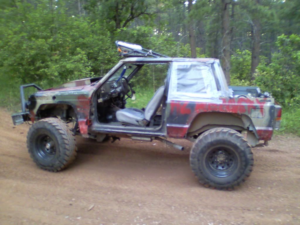

thats what i got now, i will have pics of how it sits now tonight

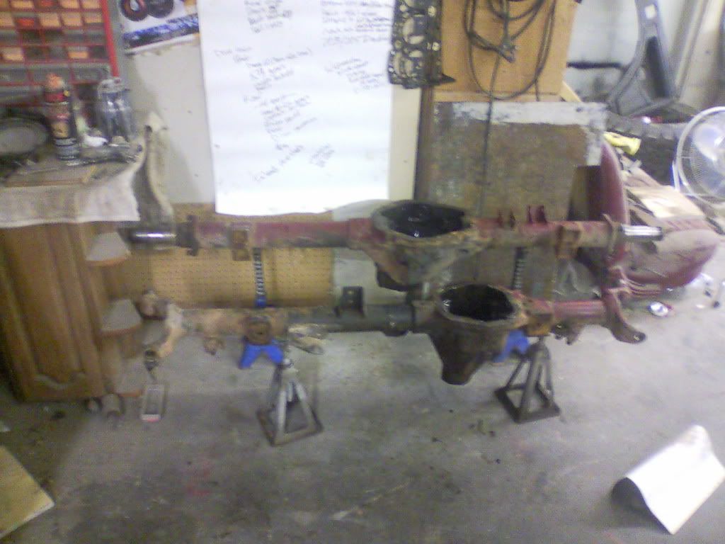

alright, i started to pull my front axle apart and tomorow over my school lunch break i will be calling the salvage yards to find a front dana 60, i need a pass drop front drive shaft which is a little hard to come by around here (for cheap any ways)
i will keep the 44 for a season though unless i find a really good deal on a 60 and a gear set

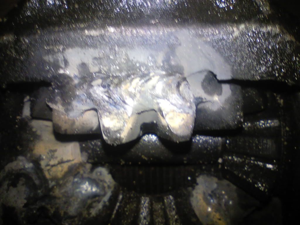

i will be weling the spider gears on it tonight as well as removing the brackets from it
pictures will beup later

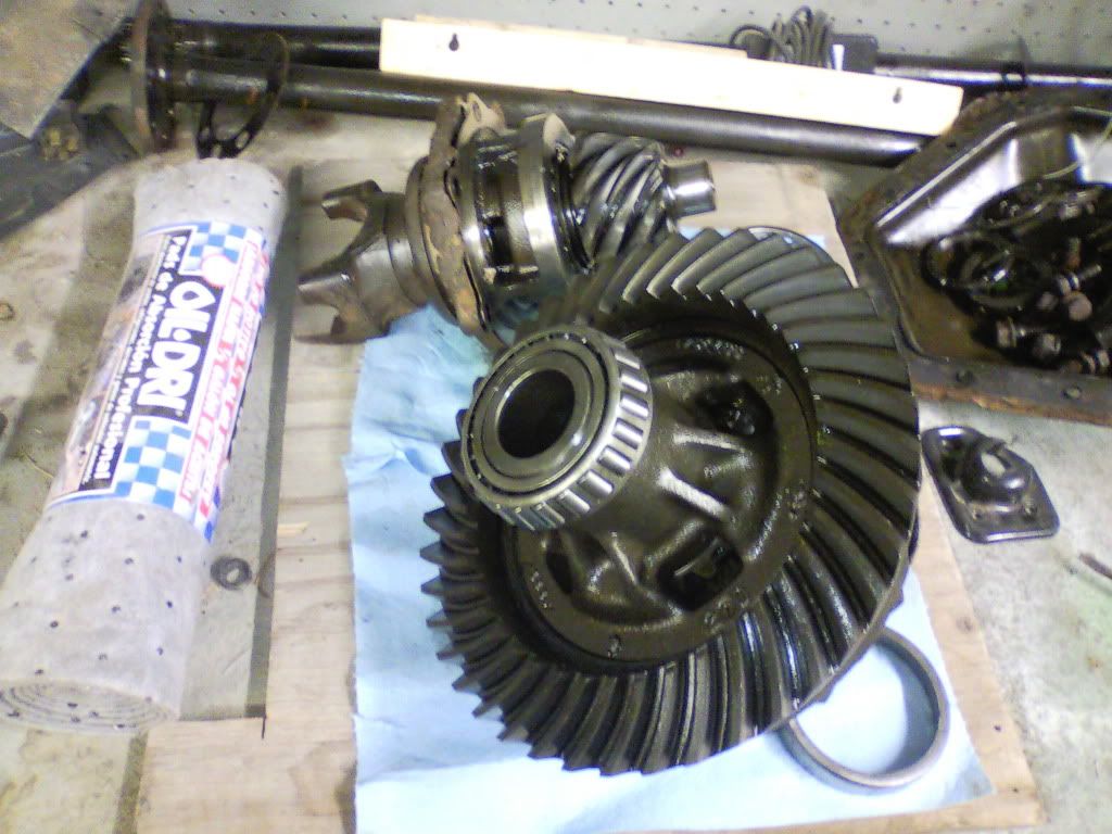

got some more work done tonight, finished pullin the front axle apart and found out that 44s cant swim... if ya remember from my first thread here i got here stuck to the doors on the bald tires i way runnin, turnsout the seals let in mud and water, my shafts were starting to rust andthe ball joints were shot so i welded the spiders and while im waitin on a front 60, im gunna see how far a stock 44 will go
