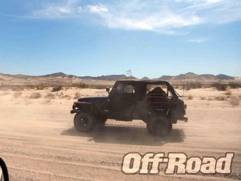

Just got this pic from our Mojave run this past March.
-Justin

Awesome pic.
