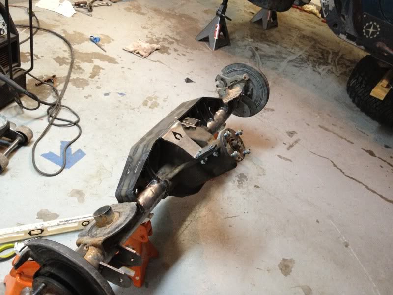

Since I like the axle lowers, I went ahead with the frame mounts. Got both sides done and started on the axle side uppers.
Made a mock link, 28" eye to eye, as per Blaines instructions.
Set, well kinda, I dropped the axle to ride height after this and really set the frame side mounts.
I had to notch the Driver side of the skid to fit the frame mount, little over an inch.
Set the upper

Sooooo.... that looks kinda not stretched.
I had stated earlier that the stretch is gonna happen later when I have the time and money to do it right. Chop the frame in front of the frame mounts, push it back, chop the rear, reposition body mounts. Only 4 weeks till I go back to my university. So this needs to be done soon.
Oh I gotcha, I misunderstood. I thought the project was on hold until then. Right on man, looks good!!!
No problem! Cool thing is, you don't even pull springs when the time comes, just chop pull back, weld up and continue. I am just gonna save for corner armor, driveshafts etc. Probably a fuel cell too, so that can do more than 4"
