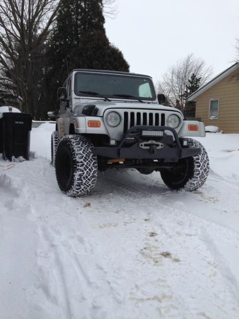

Bought the bone stock LJ around Feb. 2013 after selling my 1970 Nova. This isn't my first Jeep but it's the first that I can now afford to really play with. The plan is to build a streetable off road machine that is done right without going overboard. Thinking about this a bit, overboard is hard to define, just ask my wife....
I started with a DPG Ultimate kit as I felt this was a good starting point.
Jeep suspension lift
Before measurements
DF-31.5"
DR-32.25"
PF-32"
PR-32.5"
After measurements
DF-35.25"
DR-36.5"
PF-35.15"
PR-36.25"
7 hour install time
DPG Ultimate Old Man Emu Lift Kit
-OME Nitro Sport Shocks
-OME Coil Springs
-OME Steering Stabilizer
-JKS front and rear Adjustable Track Bars
-JKS Quicker Disconnects
-JKS Rear links
-DPG front and rear Bump Stops
-1.25"JKS body lift
-Brown Dog Machine 1" Lift Motor Mount*
-Currie/Savvy Correctlink steering system
-Ultra 15"x9" black rims with 3.75" backspacing
-Goodyear Duratracs 33"x12.50"x15"
Notes
-Soaked all nut in penetrating oil twice to prevent broken bolts.
-Silly amount of socket/wrenches required. Why mix metric and SAE?
-Taking Jeep in for an alignment, absolutely needed.
-Broke front track bar bolt on axle side, the bolt was $4 and the nut was $16!
-install was fairly simple, anyone with moderate mechanical abilities can do this with no problem.
-If you are doing this yourself you will need spring compressors for the coils.
Shortly after this install I regeared to 4.56s and added front and rear ARB airlockers, ARB compressor under the hood
Gucci gel battery
Brown Dog Motor Mounts
The Source with switches from OTRTTW
Linex in the tub
MOLLE panel on the tailgate
Poison Spyder rockers
JCR front bumper and steering skid, Warn Zeon 8 synthetic, Rigid 10" spot and Dually D2 wides
I ditched the chrome grill and installed Hella Clearvision replacement lenses and 55w bulbs-HUGE improvement
JCR rear bumper with tire carrier, rotopax gas cans, spare, leds in the spare for third brake light, hi lift extreme jack. I also flush mounted some rigid dually lights and put them on a separate switch
Marine grade clarion 4 channel amp 2 channels pushing the 6.5"Marine grade Kicker components, 2 channels pushing the 8" Marine grade Kicker sub and I have 4"x6" Marine grade kicker speakers in the dash
Even got to take it on some trips between projects last year:

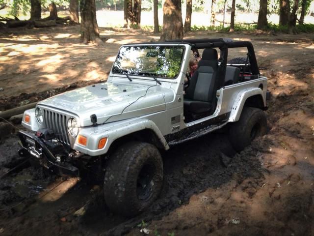

Before I regeared and added the lockers I was able to get Brutus stuck a few times

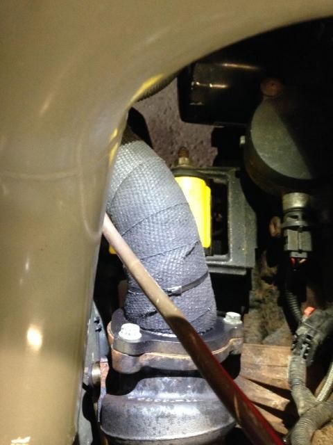

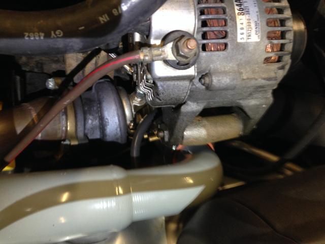

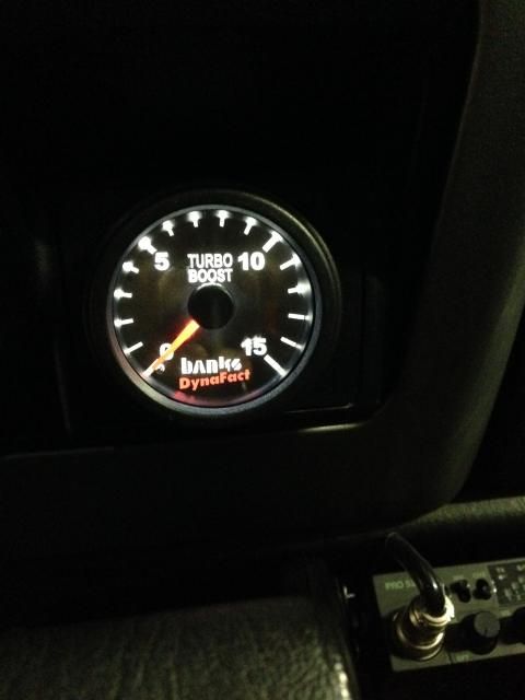

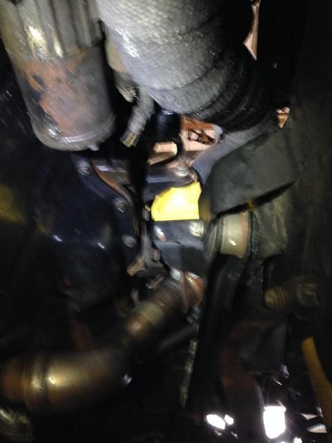

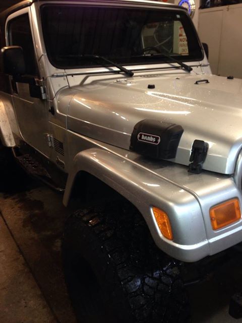

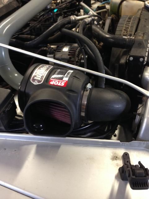

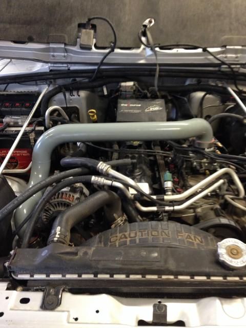

And the fun really began when I installed the Banks Sidewinder Turbo system.
New 62.5mm throttle body

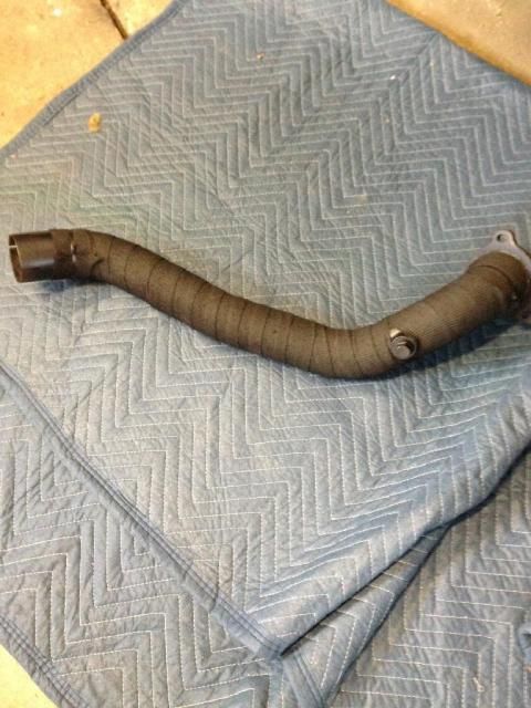

Along with the Turbo system I installed new plugs, Banks header, Magnaflow complete cat system, and Magnaflow performance exhaust which sounds great and doesn't drone. I also added some DEI header wrap on the turbo downpipe as it's pretty close to the starter and I wanted to keep the underhood temps down a bit.

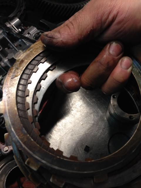

Shortly after the install I smoked my transmission and had to get it rebuilt and upgraded by Capizzi Automotive which is an amazing local shop.
Burnt clutches
My bill wasn't cheap but he does good work. Total out the door was $2907.27, here is what he did:
2/4 upgrade set $64
4/O clutch set $49
OD power pack $86
4/R clutch set $55
OHK with pistons $162
W/B parts kit $147
Accumulator pistons (3) $138 these were aftermarket upgrades and we later found that the computer didn't like them so we only used 1 of the upgraded pistons
Sealing ring kit $23 these are solid rings instead of the factory split seals that leak
Filter kit $21
U/D piston $26
ATF $70
Trans cooler $106
Overhaul kit $123
Axle Pinion Seal $16.10 (bad leak)
Diagnose trans $80
R and R trans $480
Overhaul trans $900
Install cooler kit $200
I know I could have had the work done cheaper elsewhere but John really took time to find solutions to the trans, spent a lot of time driving and tweaking his fixes/upgrades. The bottom line is he added an additional clutch to the 4/O and 4/R sets(this is from memory so if I messed up the nomenclature it's my fault), up'ed the line pressure just a little(it won't allow a lot), and improved the seals throughout. The trans shifts much more positively, the only problem is the computer at this point.

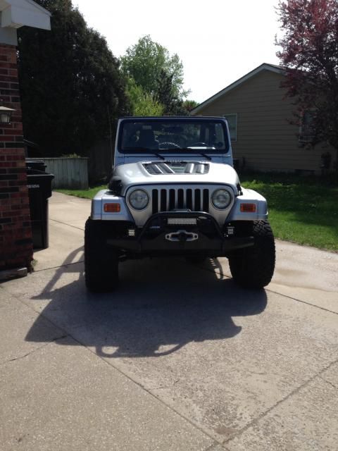

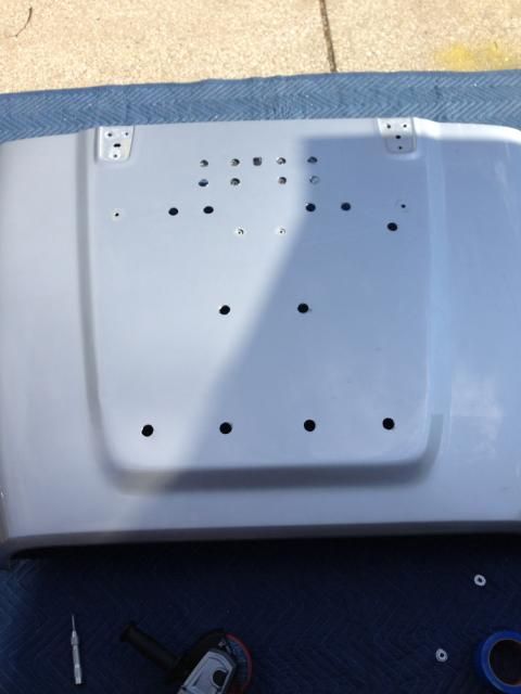

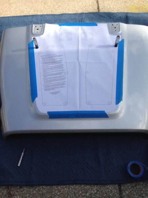

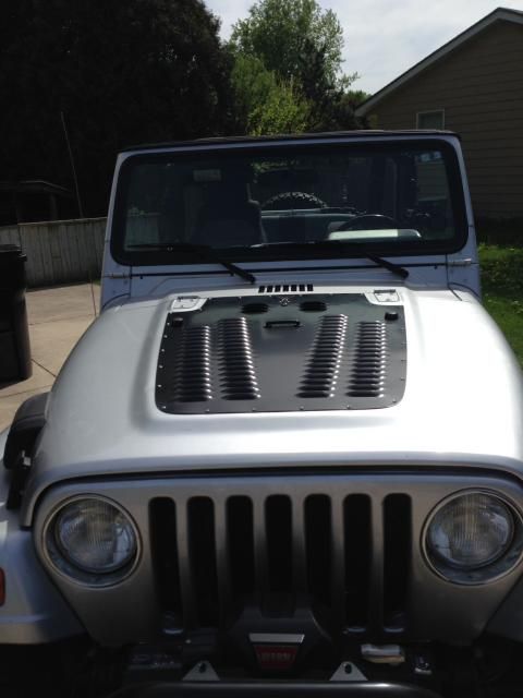

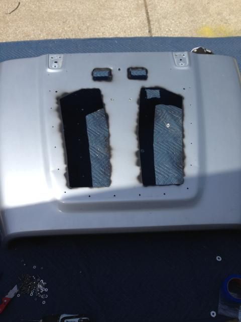

Today I installed a PSC louvered hood vent. Very straight forward and easy install. about 2.5 hours to do the job from start to finish.
Remove the hood, don't forget to detach the light, windshield wash hose, and ground strap. Tape the template to the hood and use screwdrivers in the bumper holes to align the template.
Use an awl to mark your holes, remove template, drill using a 1" hole saw. The first one is scary, check your marks twice!
Using a thin kerf metal cutting wheel on my grinder I cut the steel. I did use a straight edge and sharpie to draw lines between holes.
Use the footman loop to hold the panel to the hood and drill your holes for the perimeter fasteners. Once complete remove the panel, paint the cut surface to prevent rust.
Install panel, I put a bead of high temp silicone caulk around the perimeter and in the middle to protect the finish, not required but I thought it would help that much more. Don't over torque the fasteners as they will snap. Replace hood and align to body.
Looks sharp and you can see the heat coming out of the hood now, must be a good thing.
