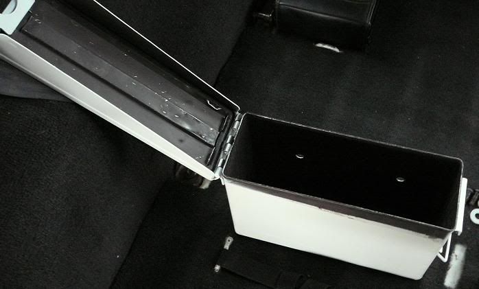

Gonna work on a little storage idea. It will involve a small ammo box I inherited. Nutserts will be involved.

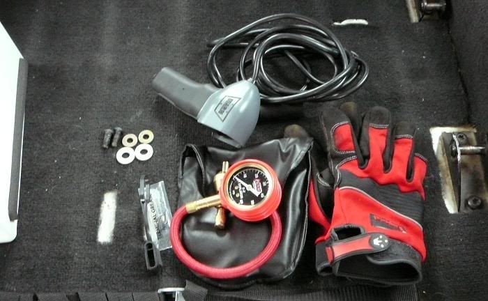

post #118 of 1309 Old 01-20-2012, 07:25 AM Thread Starter
bobthetj03
Location: NorCal
Posts: 5,316
Originally Posted by ChaseB View Post
TJs could definitely use some more storage, I've got 2 duffels with tools just crammed into the back lol
Yep, me too. Got a small Craftsman bag with tools under the passenger seat and a small backpack with other junk under the driver seat. This ammo can I have will fit my winch controler, some gloves, my Currie deflator an maybe a couple of D-rings. Not a lot, but it will make it easier to get to em. I sand blasted the ammo can at work and applied a coat of Rustmort primer on it. I will line the inside with some ozite carpet and drill two holes in the side for mounting to the inside of the tailgate. A couple of nutserts on the inside of the gate will secure it. Yeah, it sounds kinda stupid, but hey, at least it's something cheap I can do to my heep!

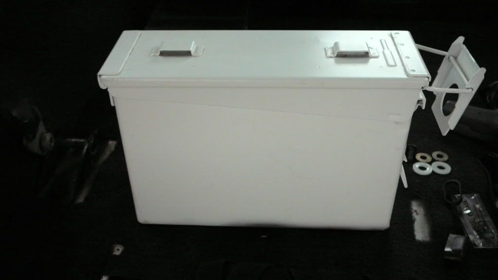

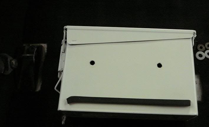

post #119 of 1309 Old 01-20-2012, 12:40 PM Thread Starter
bobthetj03
Location: NorCal
Posts: 5,316
Ammo box is painted up.
Mounting holes drilled out. The foam strip is to keep rattling at bay.
Mostly what I'll be stuffing in there.
Gotta install the nutserts still. Not real exciting, but a fun little project none the less.
