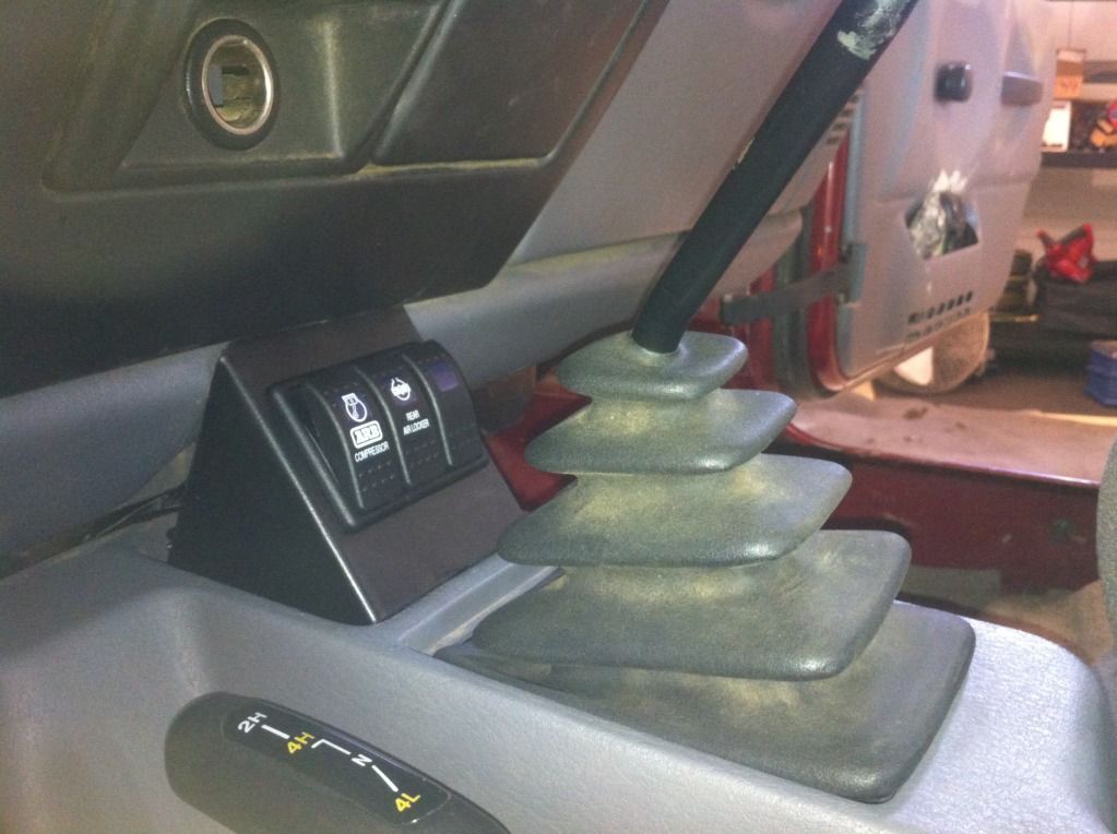

So while looking at the parts included with my ARB compressor, I learned that I am missing some parts that are included with the ARB locker, but not the compressor. Since I bought my axle with the ARB already installed, it looks like I am going to have to order a few more small things to get the compressor run to the locker(solenoid, fittings, etc.)
So, in the mean time I figured out where to mount the compressor and the switches. I didn't like any of the switch options out there for the tj already so I decided to try my hand at an option I haven't seen yet. I chose to build a switch box where the coin tray is. I have no experience with sheet metal, but I think so far it is coming along nicely and will definitely suffice. I didn't take many pictures because I had no idea how it would come out and I didn't want to waste time taking pics if I just junked the thing after lol.
I mocked it up out of cardboard first to see if my vision of what I wanted was possible
Then I cut the template out on the thin sheet metal
And then I bent each side 90 degrees using a technique I found online and put it in the tray
I'm not done yet but I think so far its going to work well.

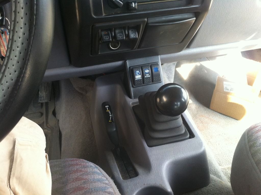

Got my ARB compressor and line to the locker all finished up. I am pretty happy with the way my switch panel turned out too. The position is very easy to reach and looks almost stockish. My brother (monsonman) had the idea to use "plasti dip" to coat the switch panel instead of paint. It gave it a rubberized finish that looks good and won't scratch up my dash.

Looks stock! No issues in 1st or 3rd gear with the shifter hitting the buttons? That would suck on the highway...
Nope! Here's a side shot with it in 5th

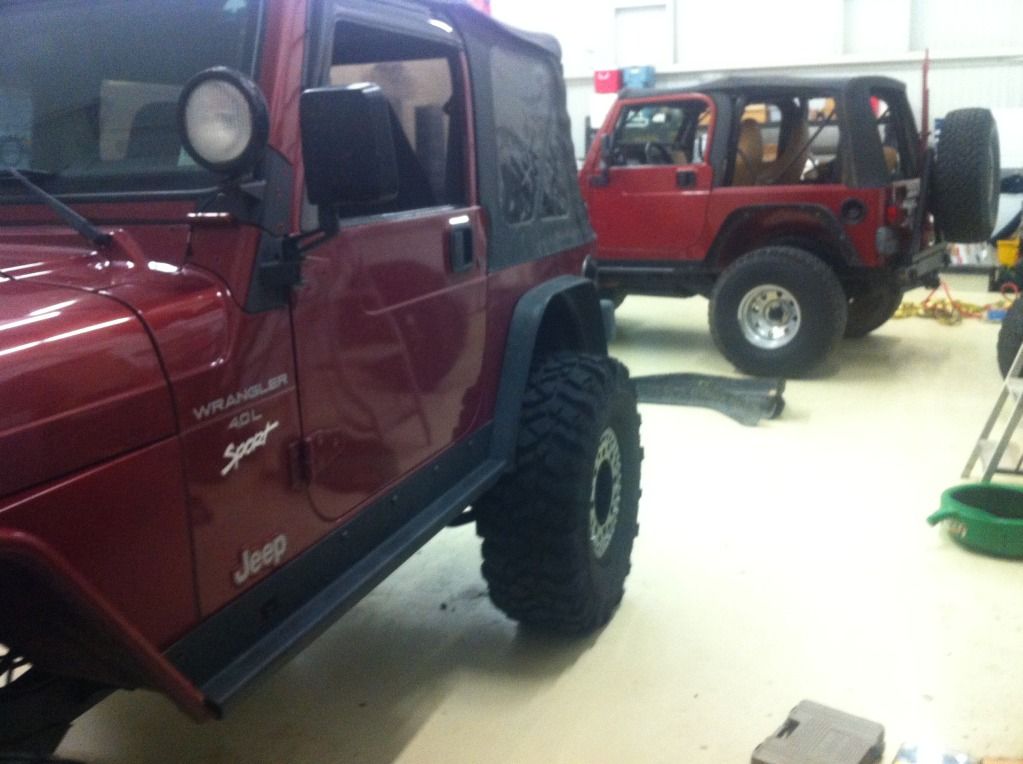

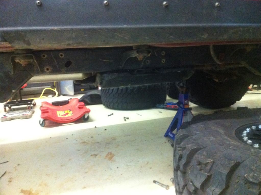

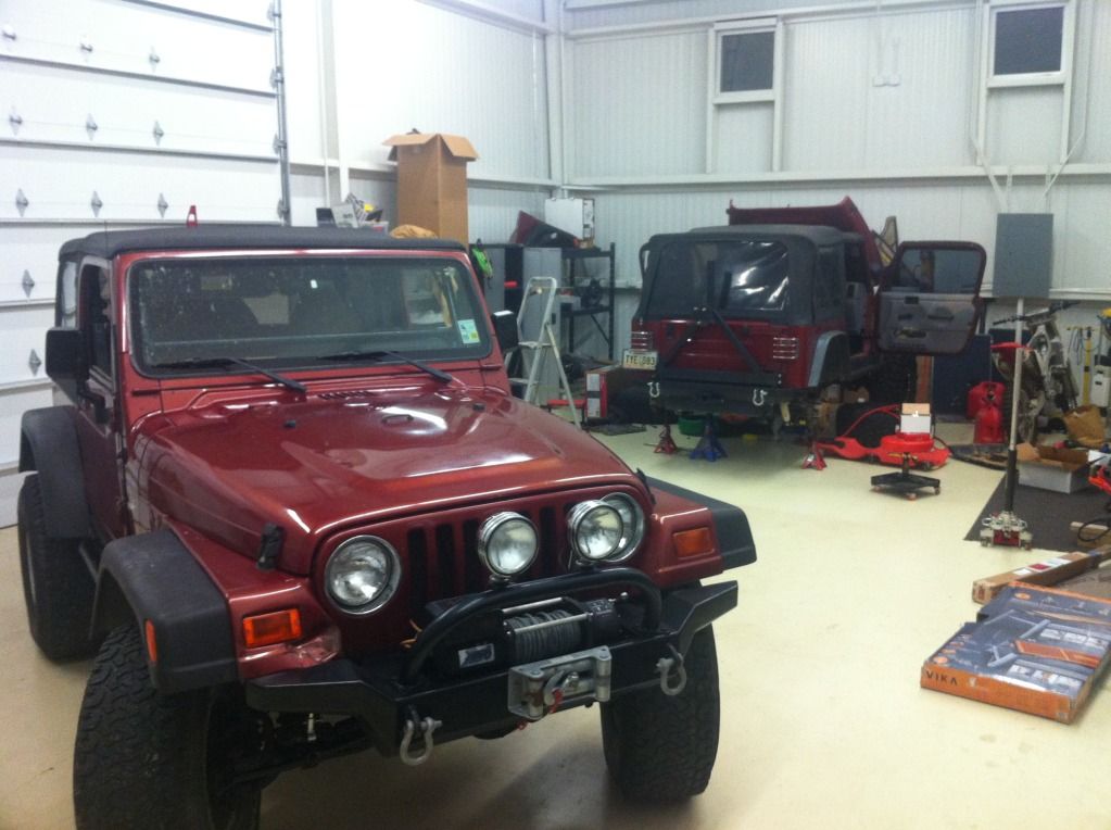

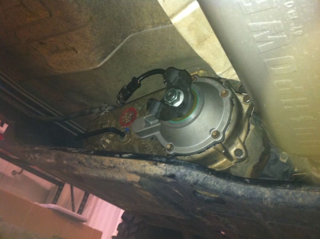

SOooooo got my SYE finished up tonight. Going see my local driveline guy tomorrow morning for my driveshaft. His price is competetive with TW and others and I like dealing with him so I am giving him the work. Plus, he's going to use what he can off my old driveshaft since the joints are almost new. Should save me a few extra dollar signs I also got my IRO adjustable control arms all in and pinion angle adjusted pretty good after the SYE.
No more TCASE drop!!!
All buttoned up, waiting for a driveshaft

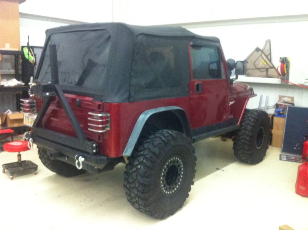

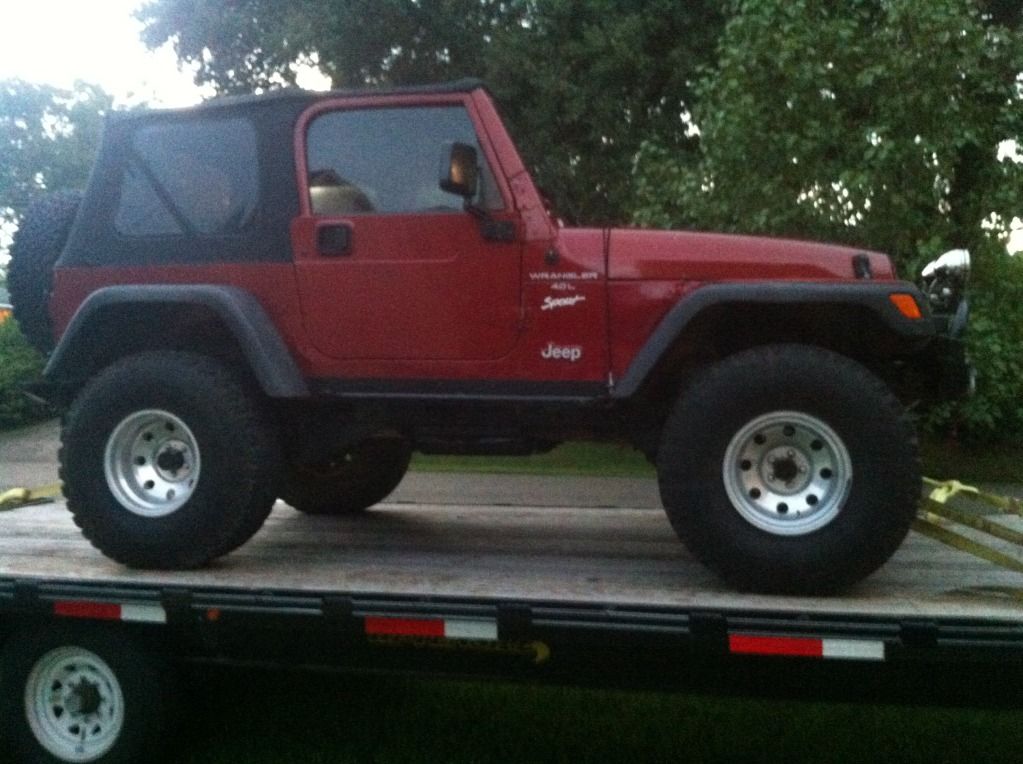

In slightly related news...My brother decided he wanted to get rid of his cj5 crawler and get something he could drive on the street AND offroad. And what better vehicle to do that in than a tj He easily found a guy to trade vehicles and he ended up with not just any tj.....but a CHILI PEPPER RED TJ!!! Oh by the way...my brother and I are twins lol. Now our jeeps are too, kind of
Here it is:
And they meet

Jeeps lookin good man, I was confused at first when the pics were first loading I was thinkin didnt he have tube fenders and beadlocks???
Thats pretty cool though is your bros already lifted?
Luciano I was thinking the same thing. Either way, that's pretty cool that two CPP TJs ended up in the same family.
Haha I figured it would throw off some people at first. It is lifted...It looks like about a 4" skyjacker, no BL. The PO did some interesting things with the lower control arm mounts though that will probably get addressed after ORV. It looks like he welded on a secondary lowering bracket for all of the lowers. The Tcase lowering kit is homebrewed as well so not sure what's going on there. We are already shopping axles for him lol
