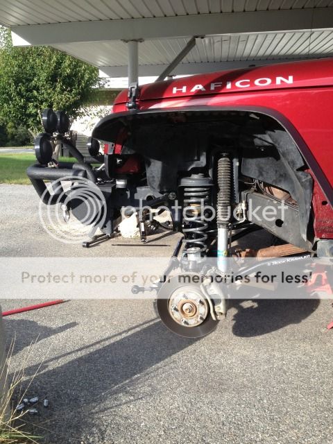

2nd Stage of lift kit. AEV 2.5
Front
As of today.

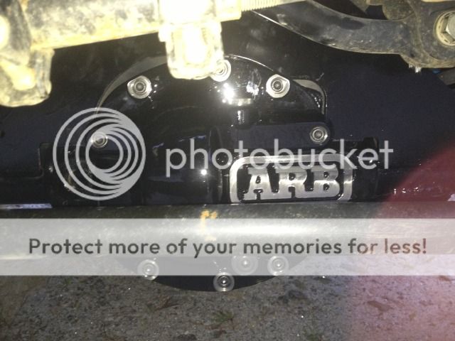

4.88 and ARB Air lockers front and rear. ARB Diff covers, and some JKS Quick Discos. Also have Rock Krawler adjustable control arms and Track bad on order.

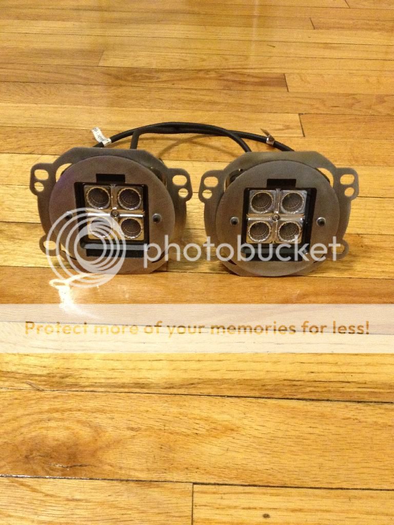

Replaced the stock fog lights.

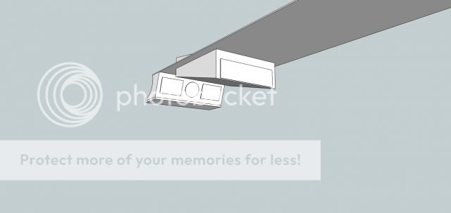

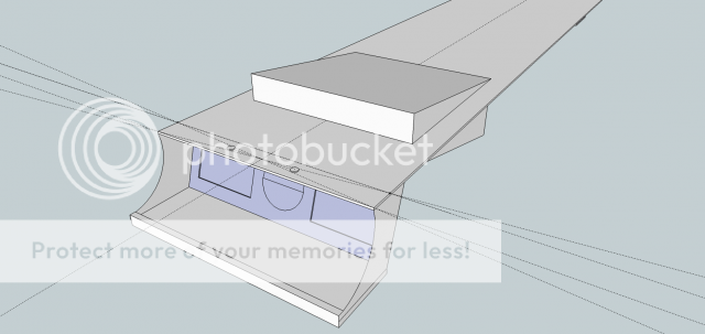

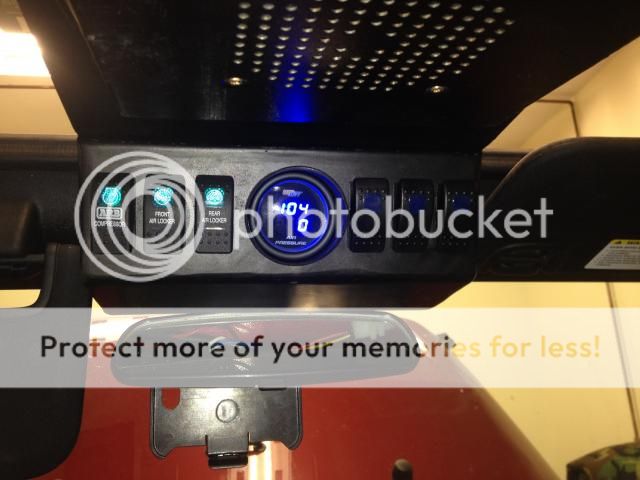

So I been working on a overhead console and this is the final drawing that is going to the shop, The gauge and switch portion is meant to favor the look of the SPOD, it will hug the natural shape of the inter molding while still clearing the rear view mirror. The location and angle of the CB mount changed as well I have built this section and have test fit it in the Jeep and the CB is visible while allowing a clear line of sight to all switches and gauge. I also reformed the rear mount so detentions in the drawing are exact to the roll bar that it will attach to. I should in theory be able to email the files to the shop go pick it up and bolt it in. For caution and margin for error we are going to wait till we have the Jeep in the shop and built/test fit as we go. Either way I am pretty excited about it cant wait to have it built.
Front mount will be simply two screw holes as a custom mount is already in place on the windshield frame.
This would be the drivers point of view if looking up at the console from the drive seat.

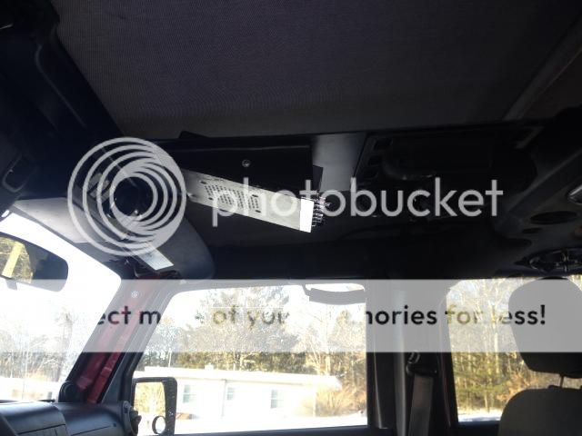

Got the console almost finished and then bought a hard top, so we have to start over with the console.
Upside down shot,
The plan was to finish out the CB box, It was going to be enclosed and a few changes made but never got back into the shop.
Top.

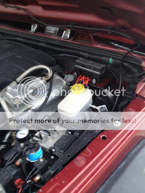

Also built a Relay box mount for the Brake booster.
Wiring looks bad in these photos. I was test fitting still, now that is is all in wire loom and tucked in it looks much better, all wiring exits the rear of the box towards the firewall.
