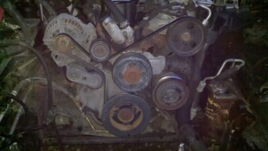

Today I flushed the cooling system before I start the engine change. Neglected! I opened the petcock --- nothing! WTF???? Poked around alittle, the rusty goo and sediment in the bottom of the rad was rediculas. Anyway, flushed 3 times to get it clear.
Started the tare down today. Removed the TB. What a carbonized mess. That is as far as I got before nightfall.

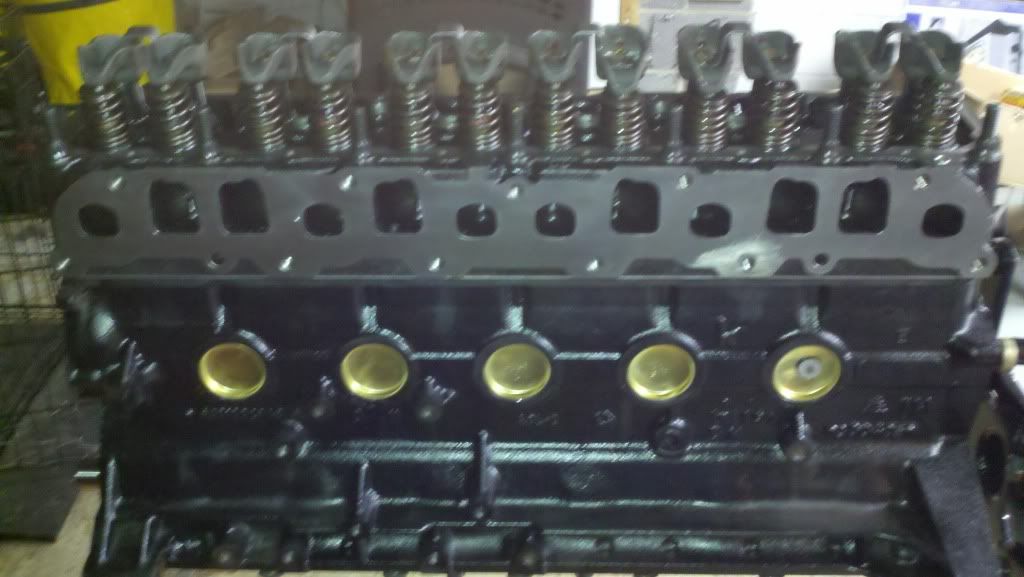

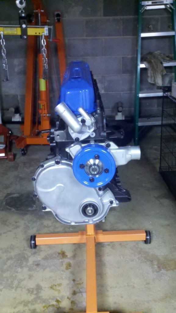

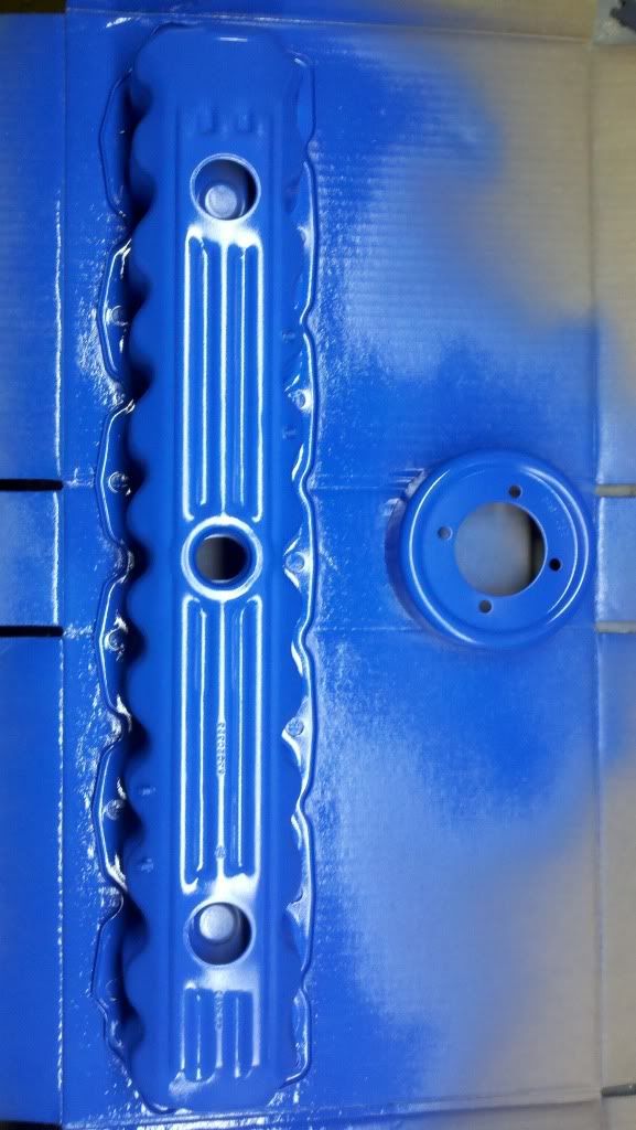

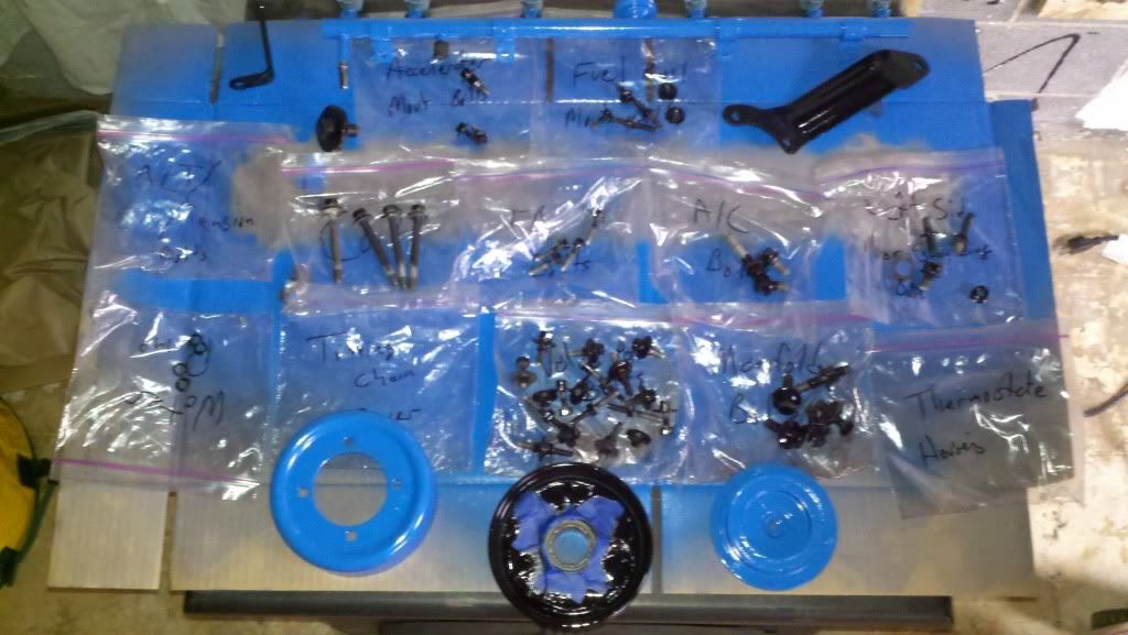

Well I have been living, breathing jeep motor for two weeks. Wife would like to kill me. Almost finished....
.....after glass bead blasting and several runs threw our dish washer......wife just loved that.
Blue
starting assembly....

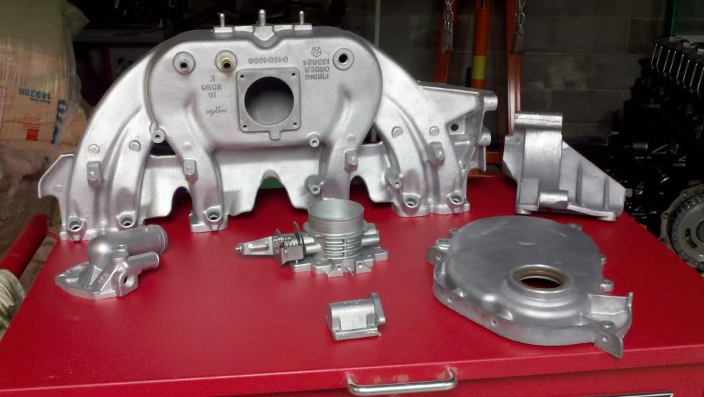

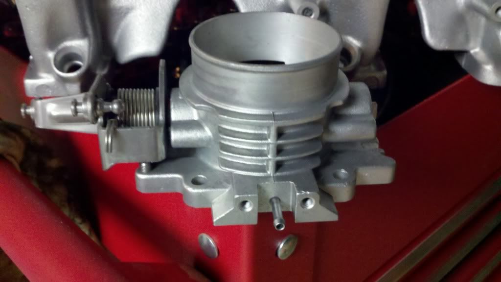

Had the TB bored to 64 mm by Liegh Machine Shop in Huston, TX (Highly recommend his service)

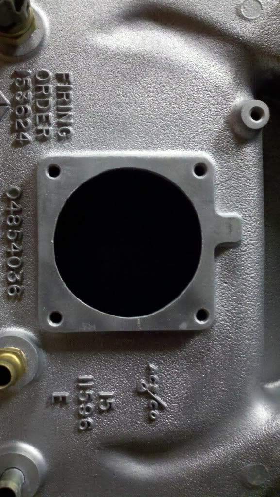

I had to enlarge the intake TB plate to 64mm. I used a metal rotory file to remove the aluminum.

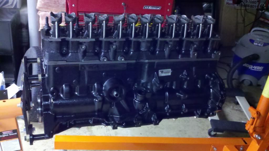

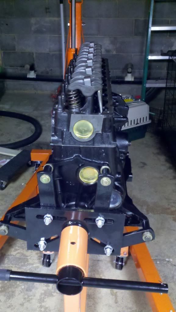

...and more painting
