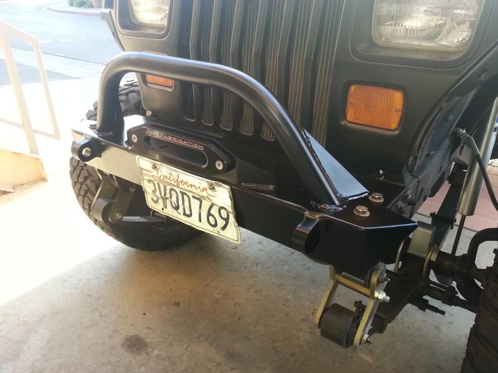

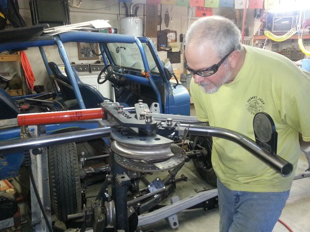

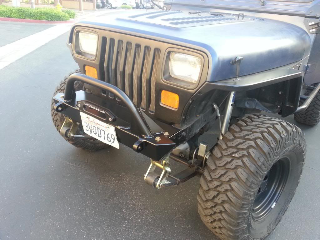

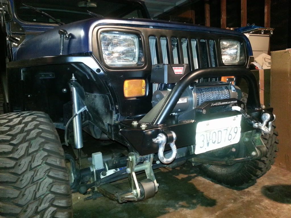

Been working on the bumpers the last couple of weekends. Went out to a buddy's house (a fellow Jeeper) to bend some tubing for the front hoop and the rear bumper swing arm. His CJ5 in the background is getting a stretch, links, D60s, and 40s...oh...and a V8 stroker.
Getting a little closer to finishing the rear.
And the front bumper is finished. I'm very happy with how it has turned out.

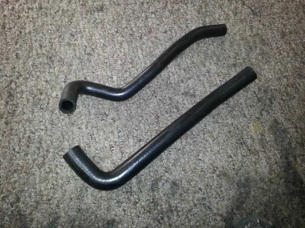

Nothing too exciting...I swear I'm slowly building a new Jeep one part at a time...
A couple of weeks back I put on new fuel filler lines since mine had dry rotted and started to seep fuel. Picked them up from mtscompany.com...quick service and reasonable prices. I had difficulty finding these locally.
Easy to swap!

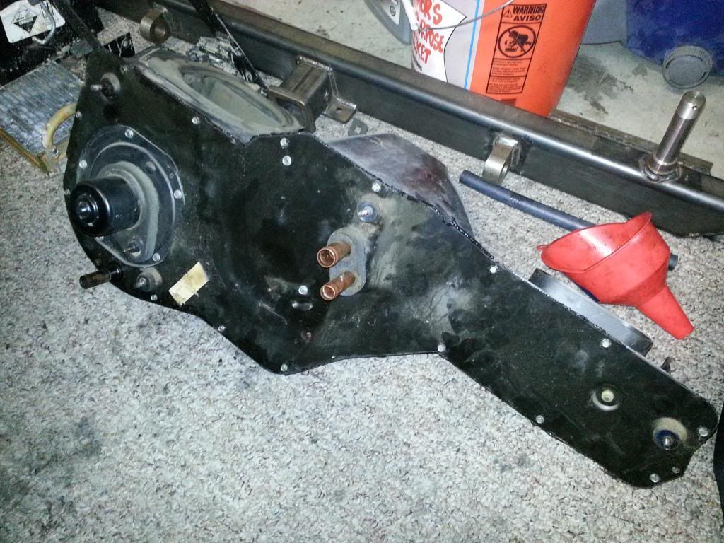

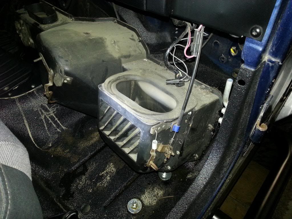

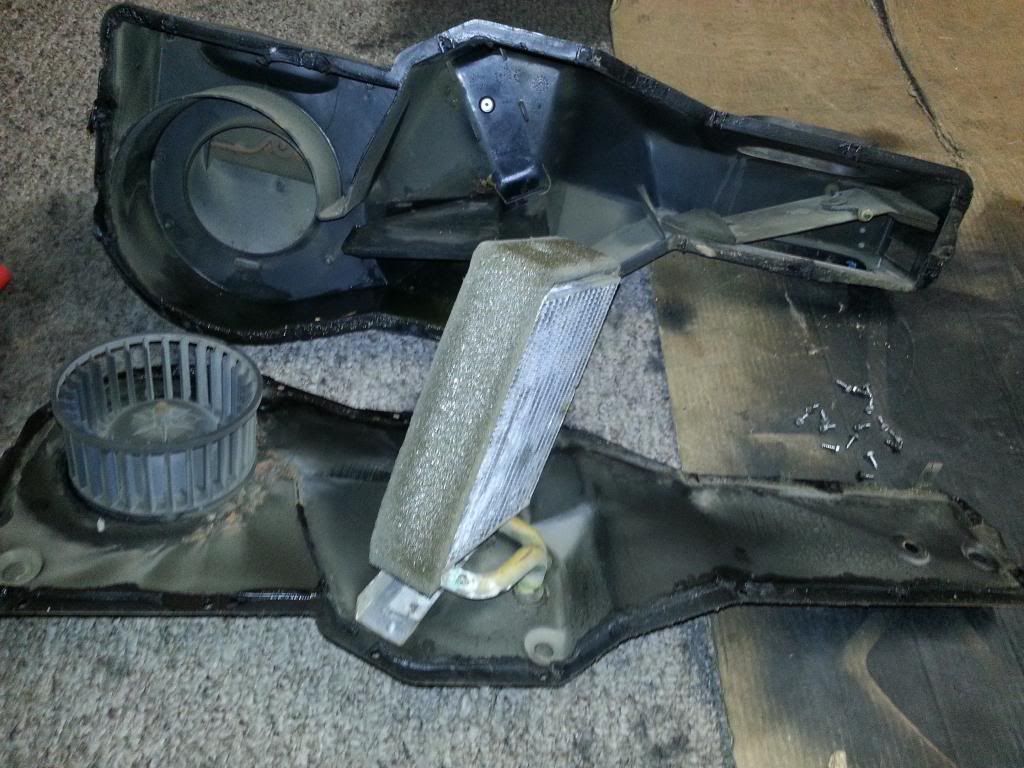

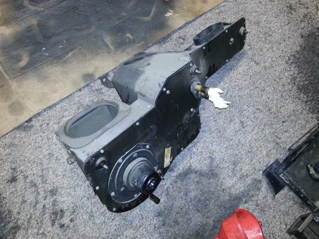

My heater core has been slowly leaking more and more lately. Replaced it last night. Pretty easy job, especially compared to other heater core swaps I have done in the past on other vehicles. I found a couple posts on this process, but I'll post up my pics as well to possibly help others.
First, remove the battery tray. Later, you'll need to remove four nuts to get the heater core/duct box out. The hidden one is the one on the driver side of the firewall, just to the side of the valve cover.
Be sure to drain the fluid first...
Before you remove the four nuts, disconnect two of the cables on the front of the ventilation box and the blower motor wiring harness. Then you can remove the four nuts and pull the box out.
Once the box is free, you can remove the last cable.
Here it is removed. Start to take all of the screws out to access the heater core.
Once the box is open, remove the two screws to free the heater core from the metal panel, and install the new one. I carefully removed the foam from my original core and used spray adhesive to attach it to the new one. I also scraped the black RTV and applied a fresh coat.
The next step is the trickiest. Put the panel back on the box, but be sure to align the core and the two flapper valve pivot rods back in their correct holes...all without coating everything with the fresh black RTV that was applied.
Reassembly is just in the opposite order. Top off with coolant when you are done!

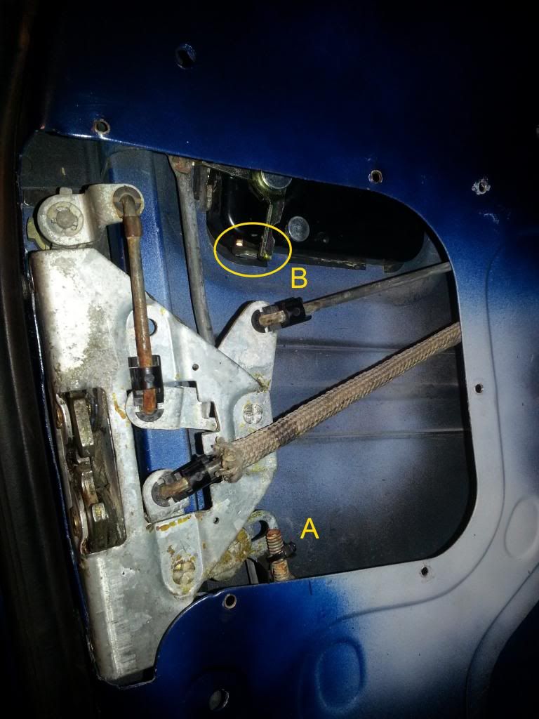

I finally fixed my cheap Chinese exterior door handles. For the past six months I have been reaching through the vent window to open the doors. It is hard to explain, but the linkage of the handles would deflect causing the exterior handle to "pop" and become non functional. I figured out how to setup the linkage so that this doesn't happen any more. Here is a pic that shows how I adjusted it properly.
The trick is to adjust the lower "j" or "u" bar (A) such that you have some play in the handle before any stress is put on the small linkages. This results in a gap between the two door handle linkages (Circled as B). If the vertical linkage is too far to the left, the little lower linkage will kick past it if your doors are the least bit difficult to open. Don't adjust it too far to the right or the handle wont' have enough throw to pop the latch. Hopefully that will help someone out.

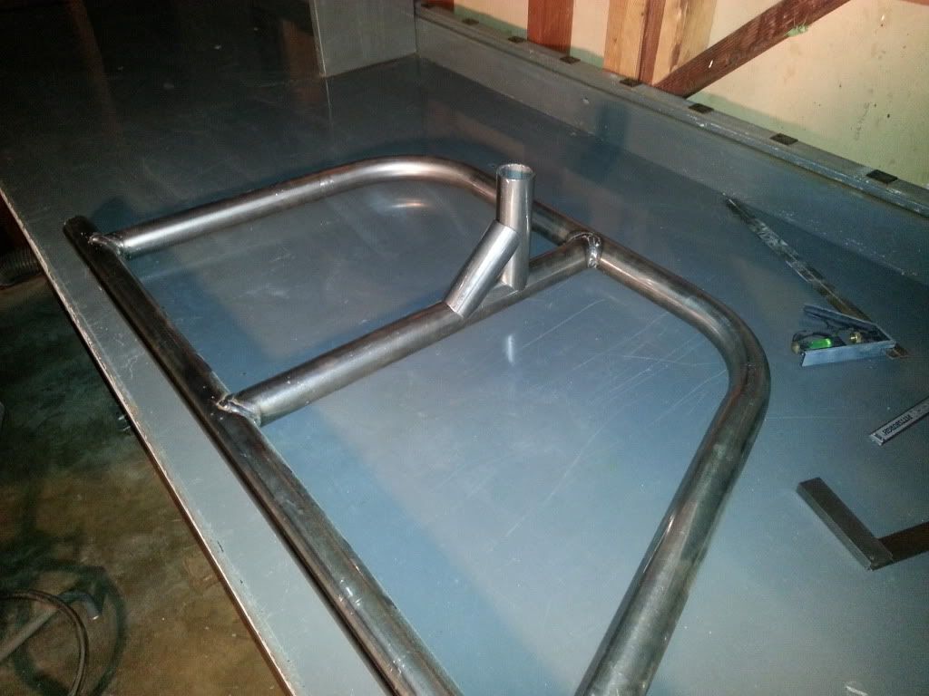

Finally, I started to work on the rear tire carrier again using the new tools. I want to get the bumper finished up within the next two weeks. I still have the latch to figure out. The notcher makes for a nice fit! The tire mounting plate will attach to the end...its on order:

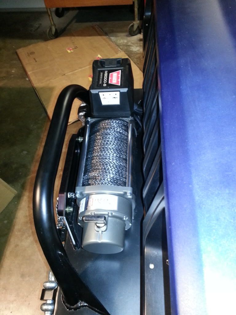

And now the fun part...Warn M8000-s winch. Finished the install tonight by shortening the power cables. Now I'm just waiting on new battery post clamps so I can make the final connection and power it. Had to pull the bumper to mount it...not to bad...makes it much harder to be stolen. I also got a new battery since my other one probably wasn't up to the task of the winch. I'll have some pics of that later...I'm doing some other rewiring after being inspired by other threads
I'm glad the winch fits as well as it does and there were no surprises.

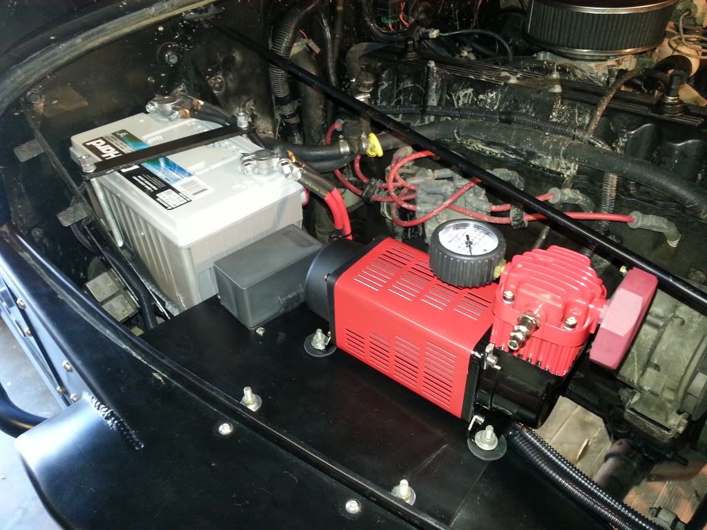

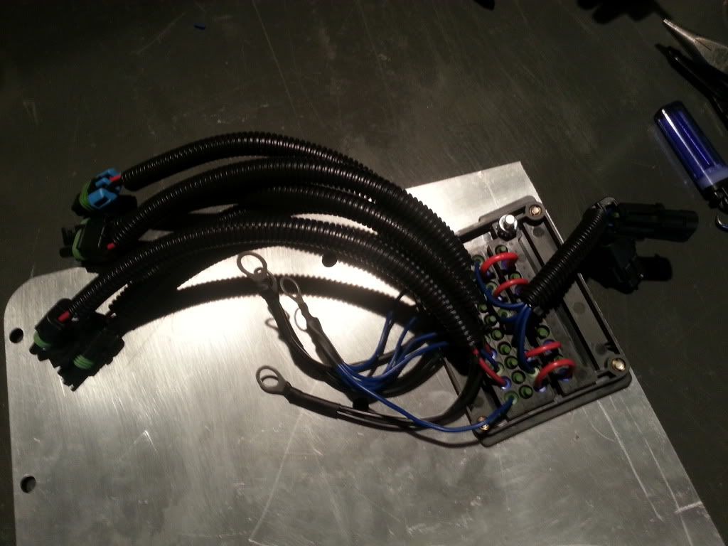

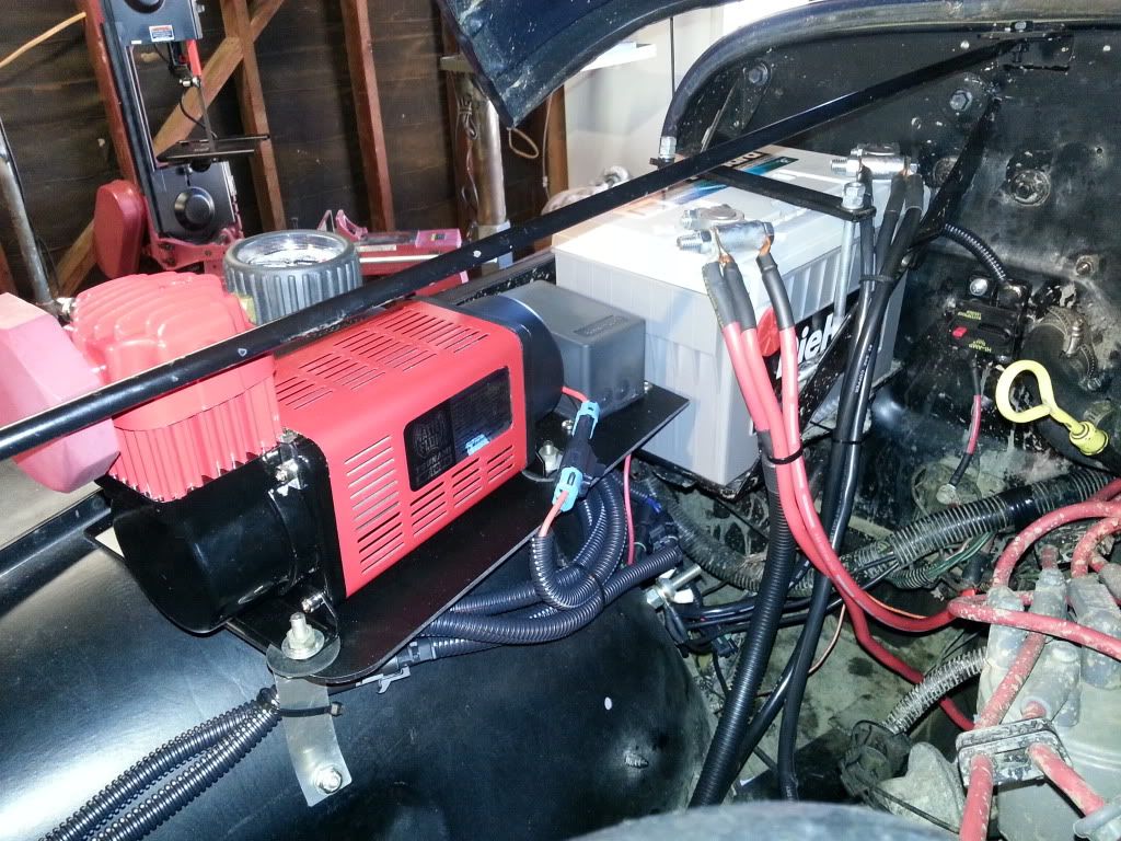

Been updating the electrical due to the winch install. Decided to dig in a little deeper than I had to, but I like the results:
First off, swapped the battery to a Diehard Platinum 34/78 series since my previous battery wasn't big enough for the winch. Swapped out the battery post clamps to allow easier attachment of the big cables and upgraded the wiring to the starter, alternator, and starter relay. Also added in new grounds to frame, alternator, body, and head, which tie back either directly to the battery or to a ground stud on the fender. A new 60amp circuit breaker is to the right of the battery (more on that later).
The new addition of the compressor is also pretty obvious. This unit is highly liked on this site and should serve tire air-up duty well. At $60 bucks from Pepboys its cheap enough to replace when it wears out. I'll eventually add a little tank to add a little reserve capacity for lockers. There is enough room next to the compressor to mount the coiled air hose, just need to find a way to secure it.

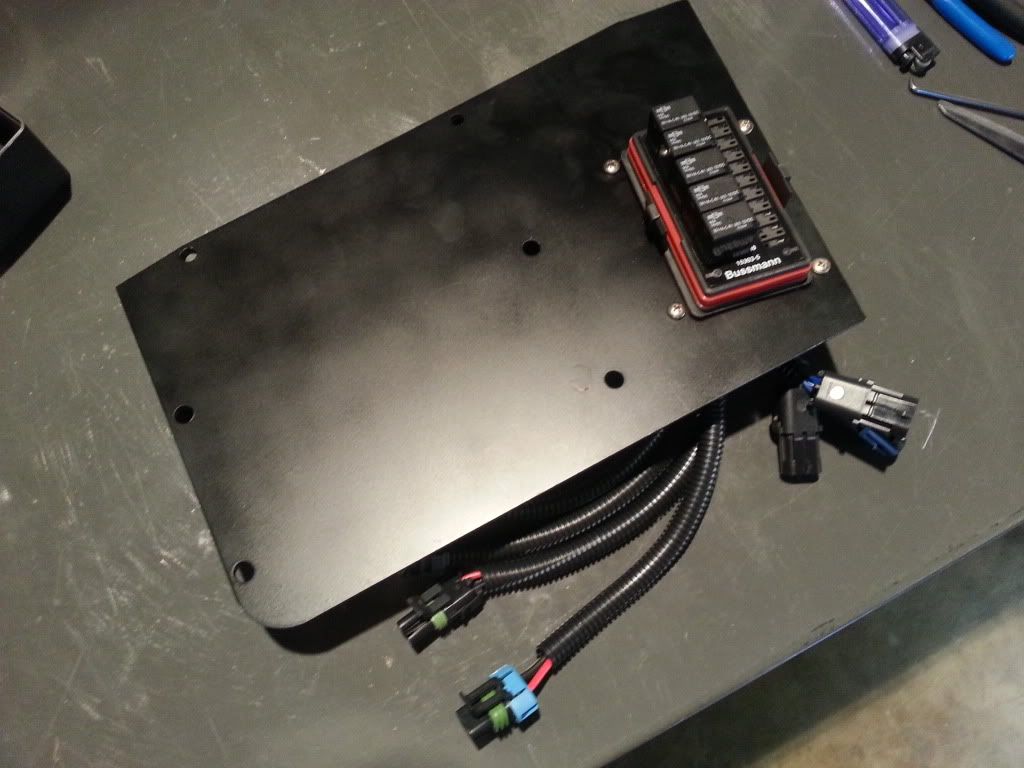

In between the battery and compressor is a small relay-fuse box which is powered by the 60A circuit breaker. I wanted to have a small power distribution center for future electrical needs and to hard wire the compressor to. I also did the common headlight relay mod and utilized two of the relays in the box for that.
I utilized Delphi weatherpak connectors, which coupled with the box, should give a reliable setup that should fend off water pretty well. Grounds tie back to the panel and then are jumpered to the ground stud for a good connection.
The relay-fuse box idea came from this post: http://www.jeepforum.com/forum/f20/a...ssman-1453156/ I didn't order the exact parts list from that post, but most of the list. It took me a little bit to wrap my head around all of the small parts, but I'm very happy with how this has all turned out.

Hope to finish the rear tire carrier this week. Finally getting some time to get back to Jeeping. New house and upcoming wedding have killed a lot of my Jeep time over the last year.
