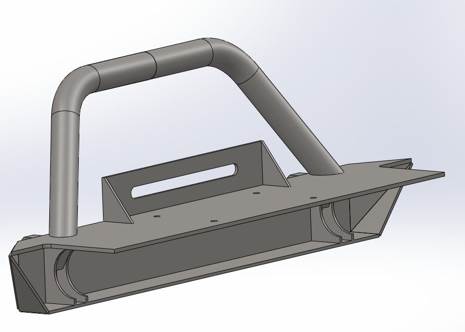

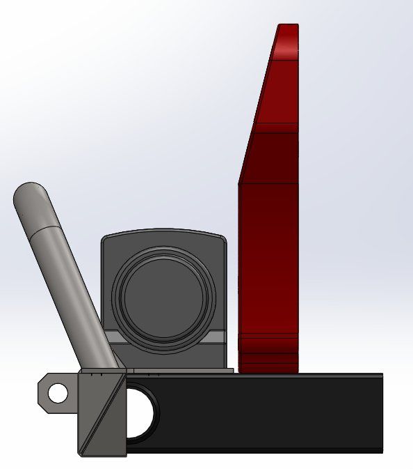

I have also been playing around with Solidworks at work to draft up a front bumper. Here are some screenshots...any thoughts?
My main goal was to go away from a simple tube in the front and stay with a more C-channel design, similar to the stock bumper. This should prevent the bumper from sticking out and reducing the approach angle. I've also tried to reinforce the shackle tabs into the back of the bumper with some additional bracing that needs to be notched to go around the stock x-member. Top plate is 1/4", while the remainder is 3/16" plate. Bar is 1-3/4" diameter, 0.120" wall. Calculated weight is 45 lbs. The winch is a Warn M8000, I got the dimensions off of their website. There is also enough room to mount one of those slick 10" wide LED light bars on the underside of the round bar (they are a little $$$ though).
Does anyone know the standard bend radius (center line) for a 1.75" diameter tube bender die?

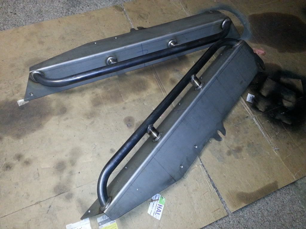

Rock sliders arrived late last week. I need to do a little trimming to get them to clear the front Defender flares. These are Shrockworks for a YJ with TJ flares. I wanted the tube step to help with getting in and out of the Jeep. I liked how these tied back into the body mounts to keep from crushing the tub if you were to hit the tubes hard. We'll see if they squeak or not...I'm not too worried about that.
Hopefully I can work on these soon...had to work on the GFs Subaru this past weekend...

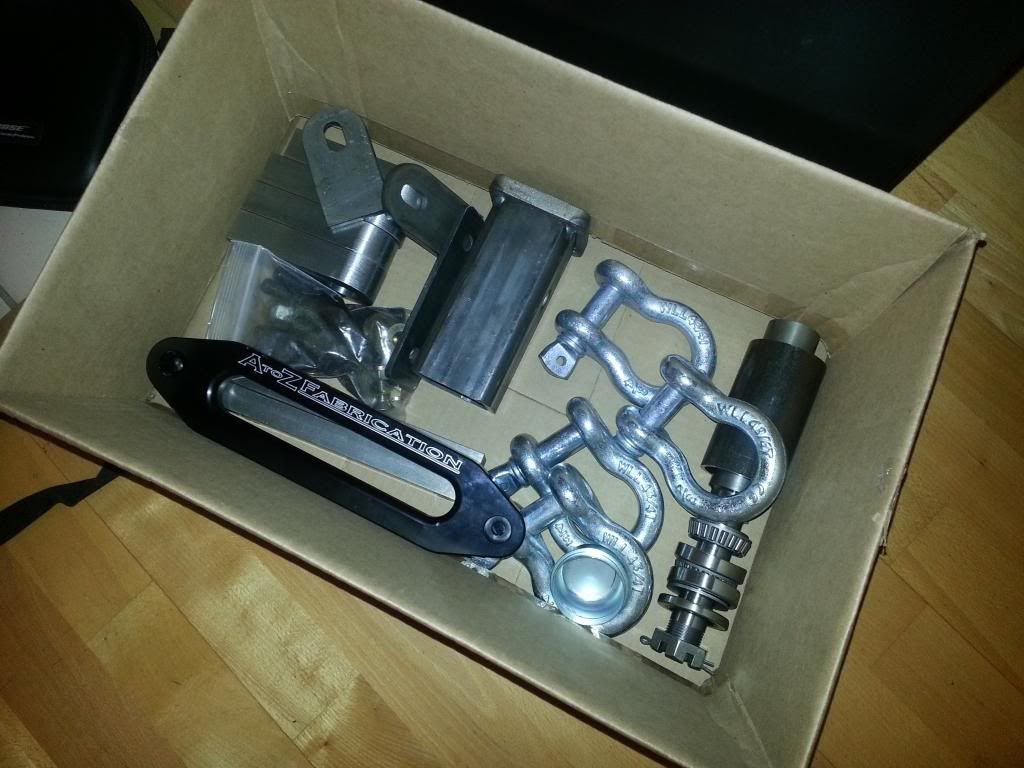

I also received a package from A to Z fab with some parts for the front and rear bumpers. I have tweaked the design a little bit, but it is in general the same. I just need to get a quote to get the steel laser or water-jet cut and then I can build.
4x clevis mounts w/ clevises, HD rear bumper swing out pivot, rear bumper builders kit (2" hitch, 2x clevis mounts, mounting plates with hardware), and an aluminum hawse fairlead.

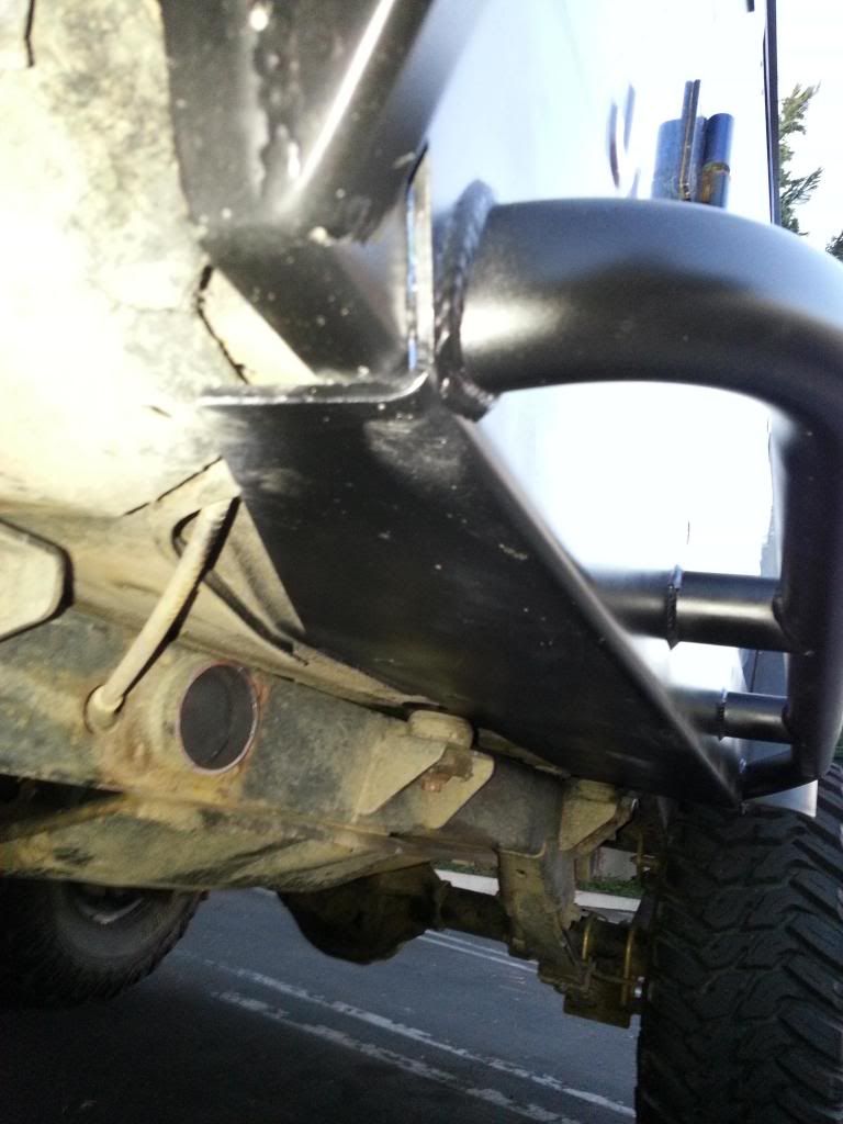

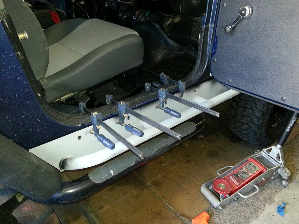

Finished the rocker guard/slider install yesterday. These are from Shrockworks with the tube step ("YJ w/ TJ Flares"). I'm glad to have the old tube steps gone!
During the install. I primed first, painted the backside, installed, and then painted the outsides last. Finished the top edges with Ultra Black RTV...hopefully it keeps more water out than traps...
Here are the undersides, they tie back into the body mounts for stabilization when an upward load is put on the tube.
Looks a lot more hardcore with these on...

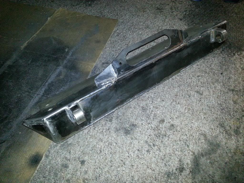

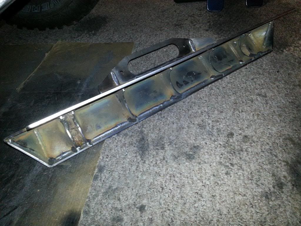

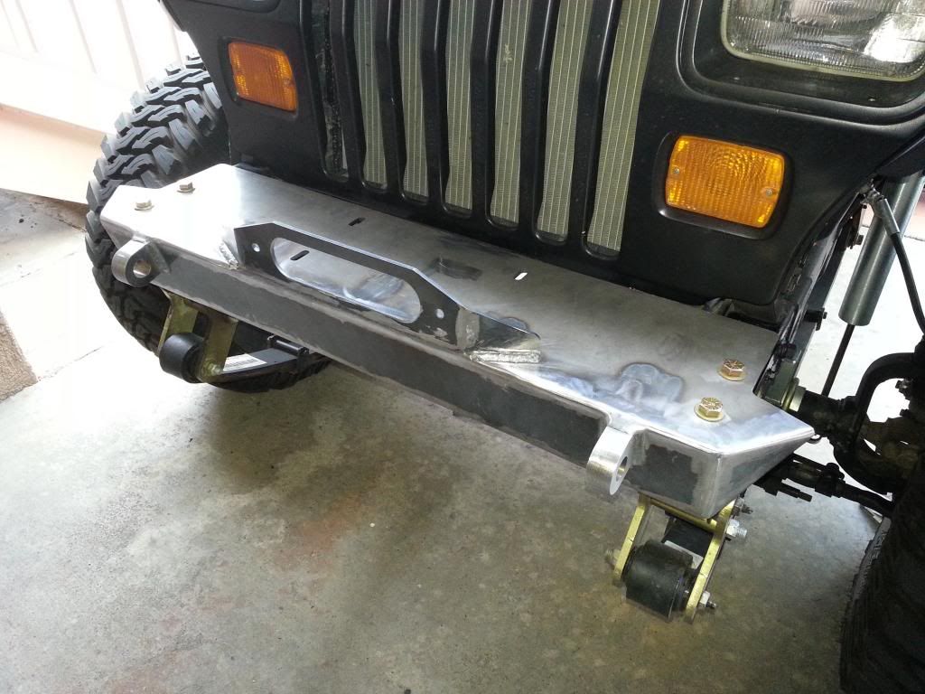

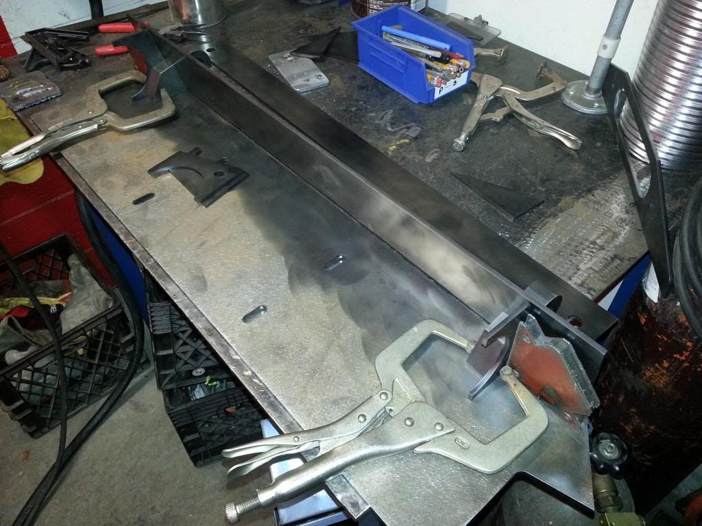

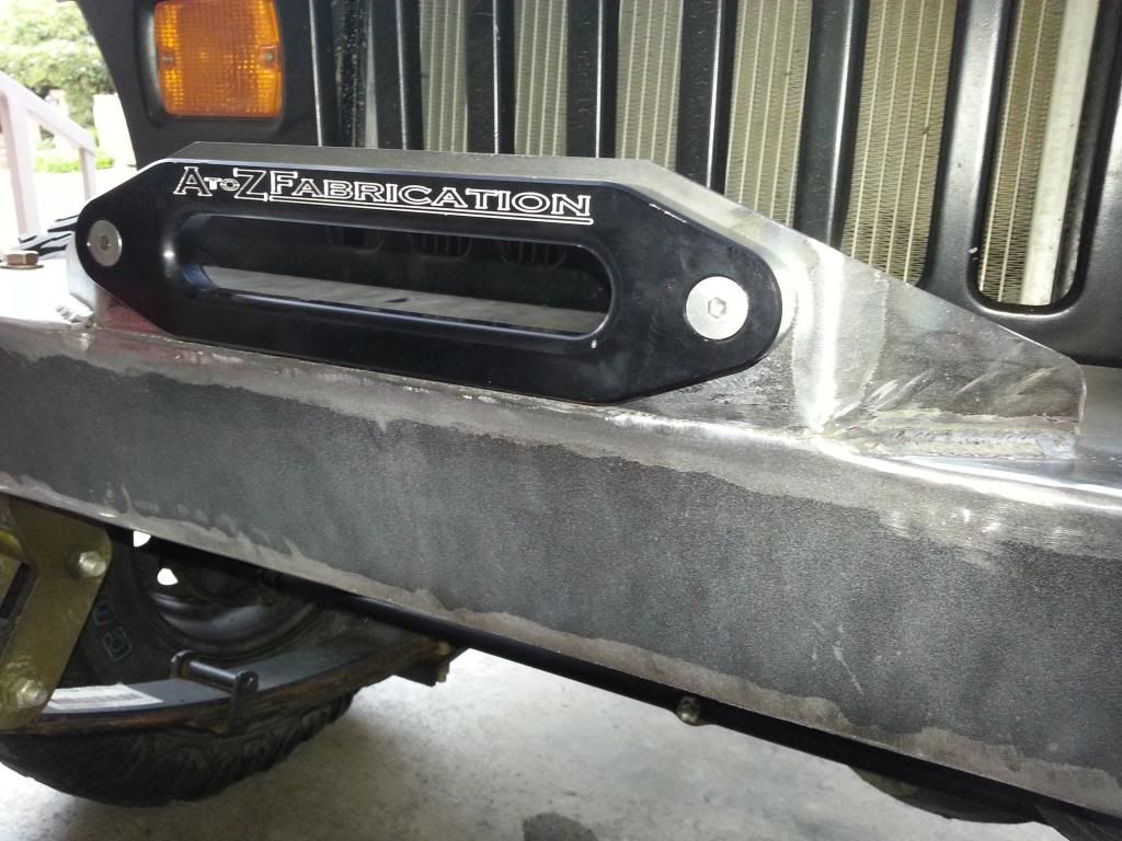

A few weekends back I had a friend weld the front bumper up. The parts for the front bumper were laser cut at a local shop, with the exception of the shackle tabs, which came from AtoZ. I've been slowly working on grinding all of the welds flush since to make it look like a single piece. I probably have one more evening and it should be ready. It still needs the front hoop; I have the material, but just need to go to another friend's place to use the tube bender. Here are a few pics from the front bumper build. Unfortunately I didn't take any pics of the lasercut pieces.
The first few are of the setup and during the weld process. Alignment was a piece of cake due to the lasercut parts. They are cut to within a few thousandths. Lots of gusseting on the backside of the bumper, especially around the shackle tabs.
Initial setup:
Adding the gussets:
Finished up - minus hoop:
Front side:
Still needs some grinding...but its getting there.

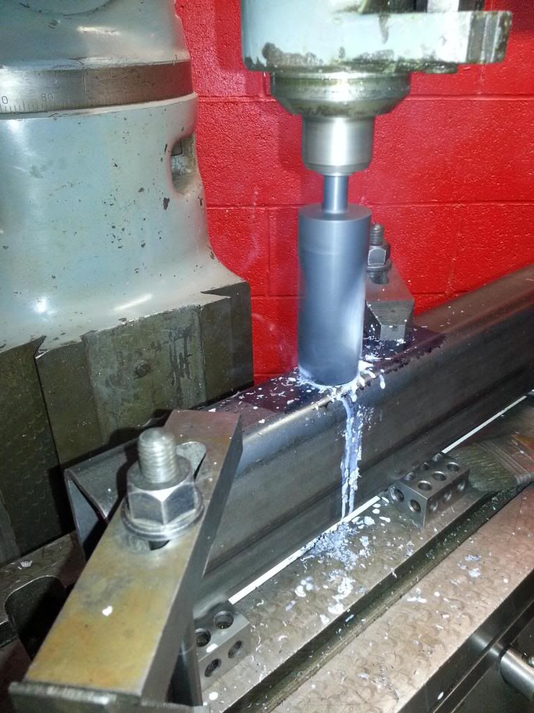

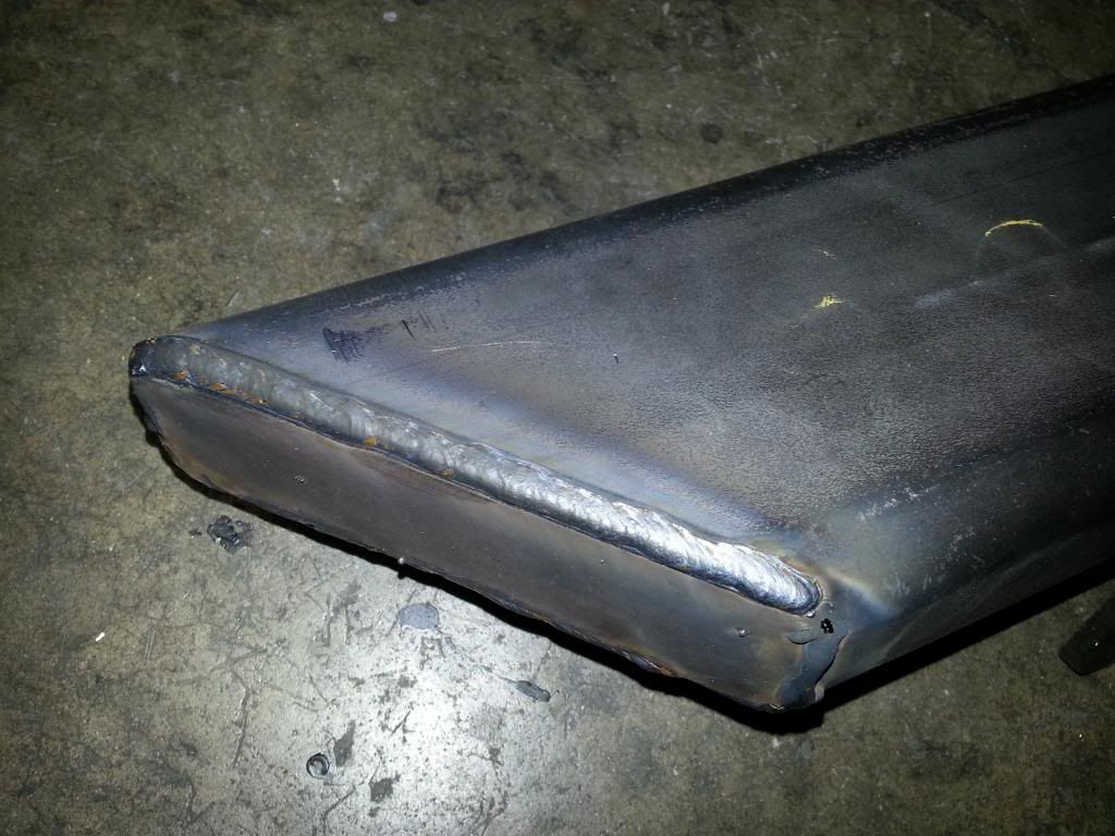

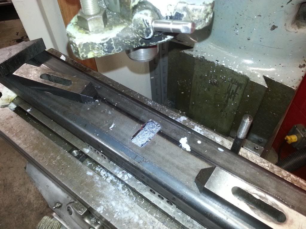

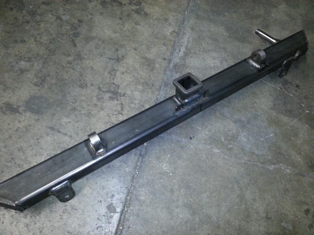

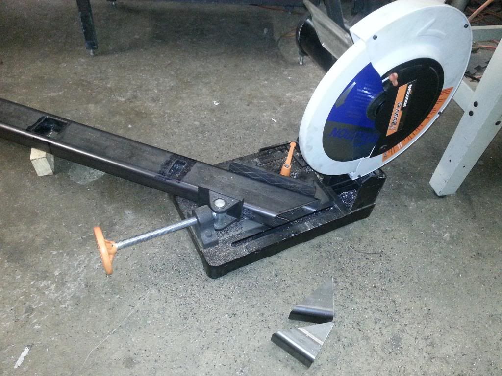

This past weekend I dove into the rear bumper. I haven't posted up any 3D CAD images of this one yet, but it is a straightforward design. I'm still trying to figure out how I want to mount the tire. I'm trying to get a Hi-lift and Jerry can/Rotopax into the design, but I'm having difficulty. Here are some pics from the main cross member.

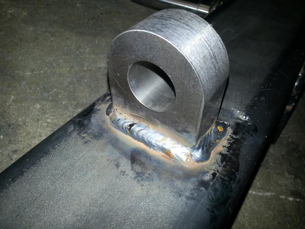

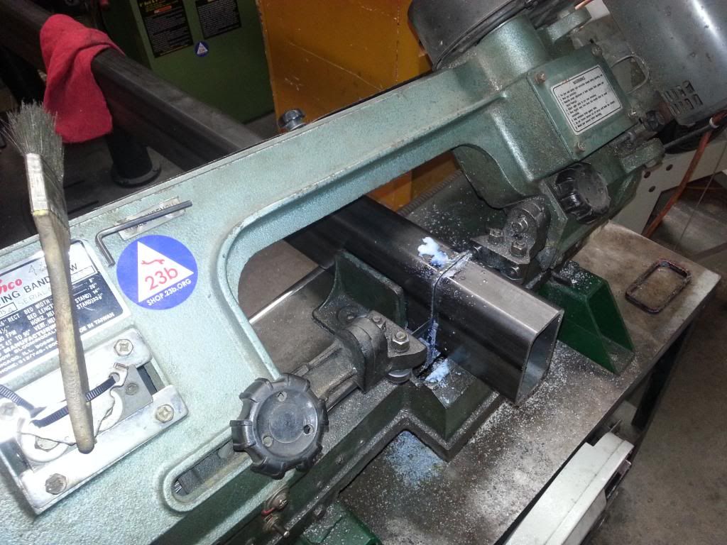

The tube is 2"x4"x3/16" wall, the remainder is from AtoZ with their heavy duty spindle upgrade. This was the first time I have done any machining or welding (more than a bead or two at least). I had some experienced supervision and a really nice machine to use.
Cutting tube to length, 56"
1.5" hole for the swing arm spindle. This taxed the 1/2 hp bridgeport pretty well. Slow and lots of coolant.
Milled out the pockets through both sides for the shackle tabs and the receiver hitch.
Cut the corners off with a dry cut saw...this is a must have for anybody doing metal work. Butter!
All welded up!
A few pics of my welds. All of the "big" welds turned out quite good...lots of heat! Took me a couple of trials to get the hang of the smaller welds on the end caps, but I eventually got it.
Next step is to do the swing arm. I have some 1.75"x.120" wall round tube for that. I just need to finalize my design.

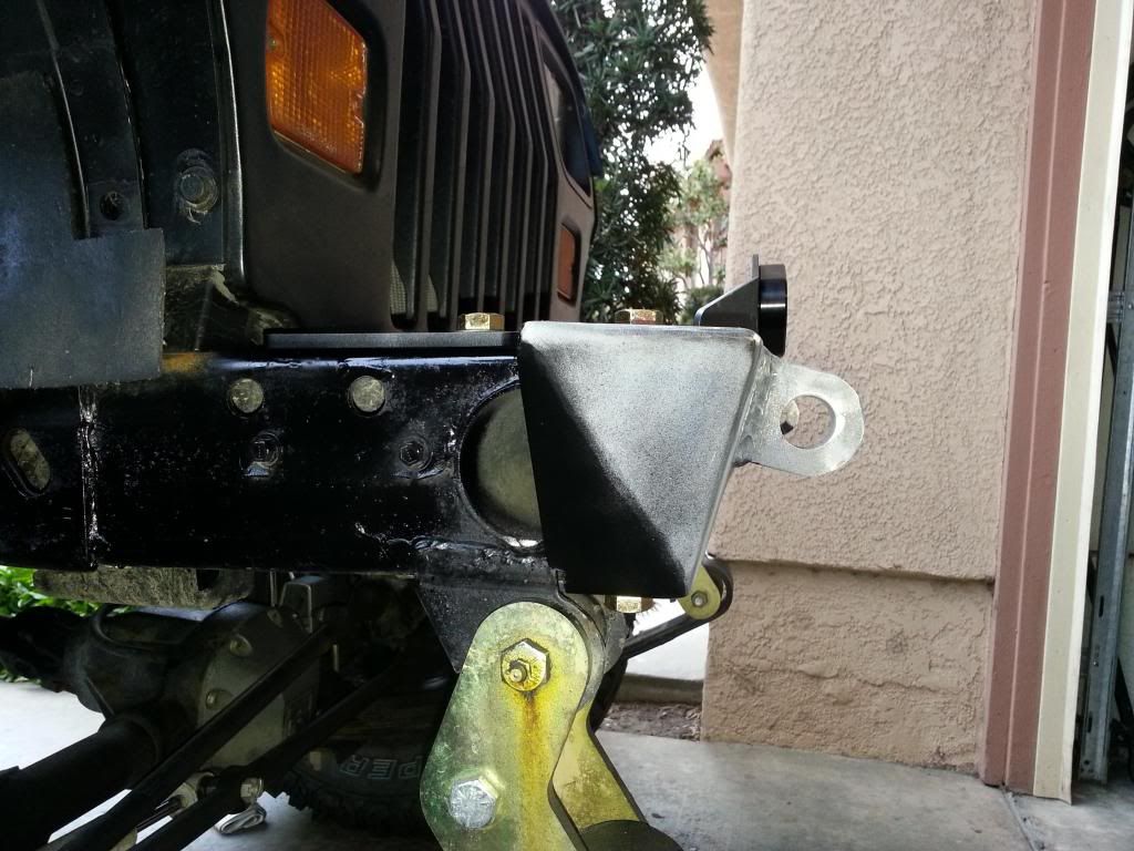

Spent some time on the front bumper this weekend. Lets just say it took a bit of massaging to get it to fit on the frame. In my design, I tried to leave some room for the welds, but I didn't leave enough. I also didn't account for some support brackets on the front frame cross member. But eventually I got things to fit up pretty well. I did have to slot the mounting holes by about 3/8". If I built another one, I think I could make it "drop on" with none of the cleanup that I had to do.
I'm hoping to bend and weld the front hoop on tomorrow. Went ahead and primed and painted the backside of the bumper so it doesn't have to come off again. Here are a few pics:
