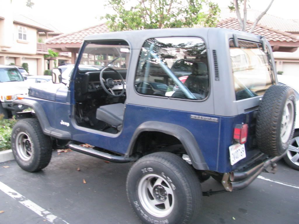

Repainted the hard top over Memorial Day weekend. I was going to go with black, but some friends convinced me to stay with a lighter color since the black might be really hot down here in SoCal. I used Rustoleum textured dark pewter paint, it is a couple of shades darker than the original gray (Real life seems darker than in the pics). I like how it turned out. Also painted the inside with it as well. Plugged some existing holes in the top from a roof rack using some two-part epoxy clay. I want to tint the windows soon.
Before:
During, with a coat of primer.
After:

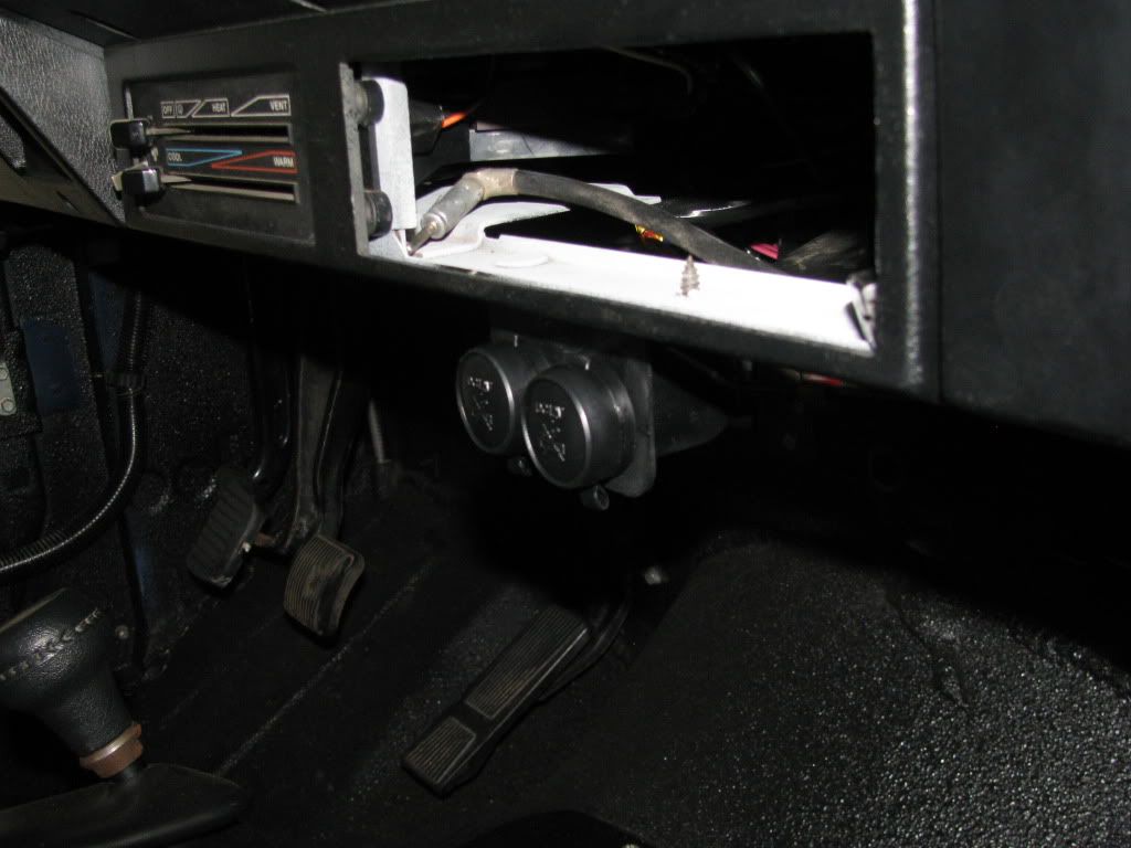

Also installed a dual power outlet. Picked up at the parts store for 5 bucks. There was already a stud on my dash, and another hole that a PO had drilled. These two lined up perfectly, so I didn't even have to get the drill out! Powered it using the wiring that used to go to the cig lighter that I removed a couple of months back.

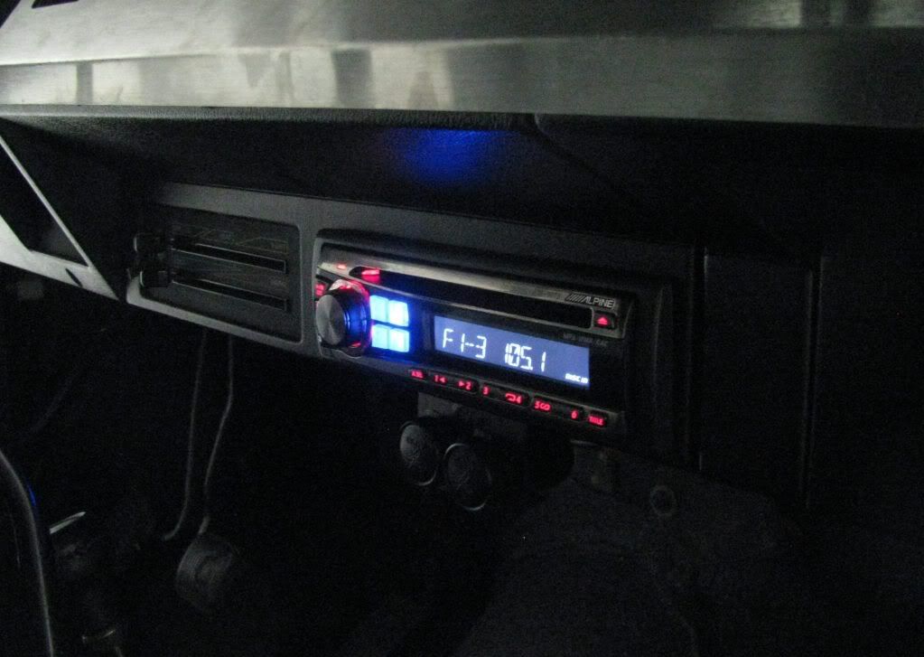

Found a used Alpine head unit on craigslist a few miles from my place for $40. Seemed reasonable enough. Installed it yesterday, but it didn't fit right with the JVC adapter, so I had to reinstall the correct one tonight. I'm actually afraid I won't be able to get the head unit back out now since everything was a tight fit.
Here is a shot of the new head unit!

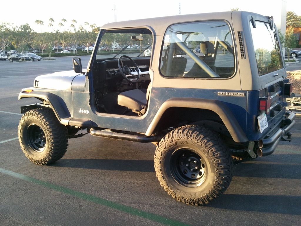

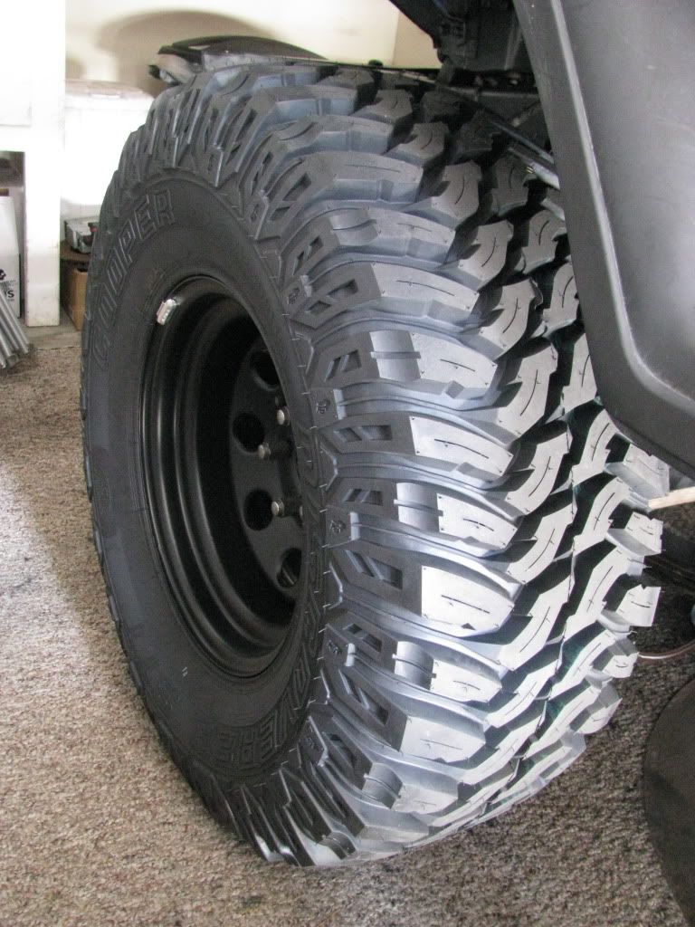

Pics as promised. Got out of work early so I ran down to the offroad shop to pick up my new rims. ProComp Series 98. These are flat black steel, 15x8 with 3.75" backspacing. Loaded them up and then went to the tire shop to get them installed with new meats: 33x12.50 Cooper Discoverer STTs.
I had some BFG KM2s on order, but after waiting 6 weeks I decided to change. These are $20 cheaper per tire and most reviews on here have been great. Figured I'd give them a shot.
Obviously, I haven't driven on these too much, but they seem pretty quiet and I like the looks. Didn't take too many weights to balance them either.
Overall, I think it looks like a totally different Jeep. I was taking a look through my build thread last night and I'm actually amazed at how different this Jeep is now. I finally feel like I'm at a point where there aren't any major issues that need to be sorted out (tires were the last, old ones were really dry rotted). There are still plenty of things to tackle, but its been serving me well as a DD back and forth to work; it is a lot more fun to drive than my Xterra.
I really want to go wheelin' now, but I'm going to have to wait until I get the new rear axle in with 4.10s. My current setup of 3.07s in the back and 4.10s in the front won't work to well in 4x4!

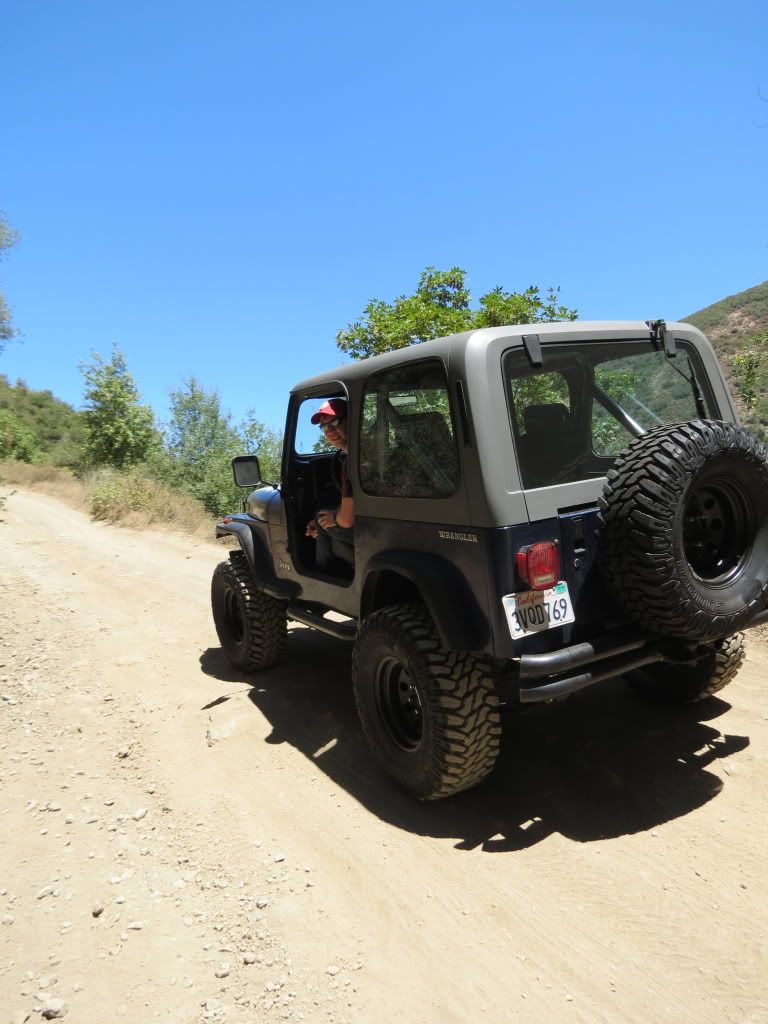

But I did finally take the Jeep in some dirt yesterday!. My mom was in town from GA and we headed up into the Santa Ana mountains just behind my place to the very top of Santiago Peak (~5600'). Nothing extreme (no 4wd required, especially important since I can't use mine yet), but a ride I have been wanting to do for a bit since it is so close. Went up Maple Springs Truck Trail and hit the Main Divide Truck Trail that runs down the spine of the Santa Ana's. Weather was nice, although a little warm up top...pretty clear though, could see all of Orange County and out to Catalina Island, northwest to downtown LA, and north to Mt Baldy and San Gregornio. Jeep did well, check engine light came on a couple of times on the way down, need to investigate, and some tire rub in the back when I drop off of rocks (TJ flares will fix that).
Here are some pics. First two are less than 50 ft after hitting dirt for the first time.

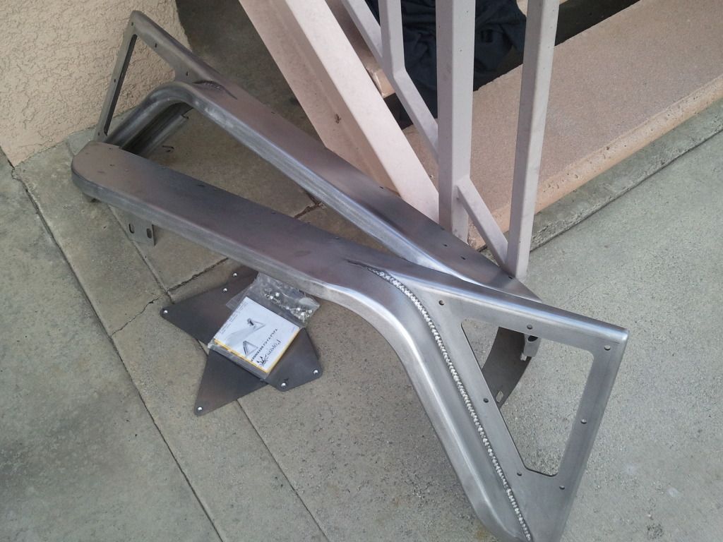

Poison Spyder gear...drove out to their shop on Tuesday. I have to admit I was a little bummed to find out that they shipped my fenders to someone else earlier in the day, so they didn't have them available when I arrived. I was so aggravated that I didn't take the time to check out any of their vehicles; in retrospect, it was stupid to do that since they shipped them out the next day and threw in a free t-shirt!
Hood Louver!
3" Tapered DeFender Flares! These are Beefy...3/16" steel!
Install should start Sunday. I do plan to do some paint work to the hood and upper cowl to spruce things up. Not sure when I'll get finished though, definitely more than a day's work.
