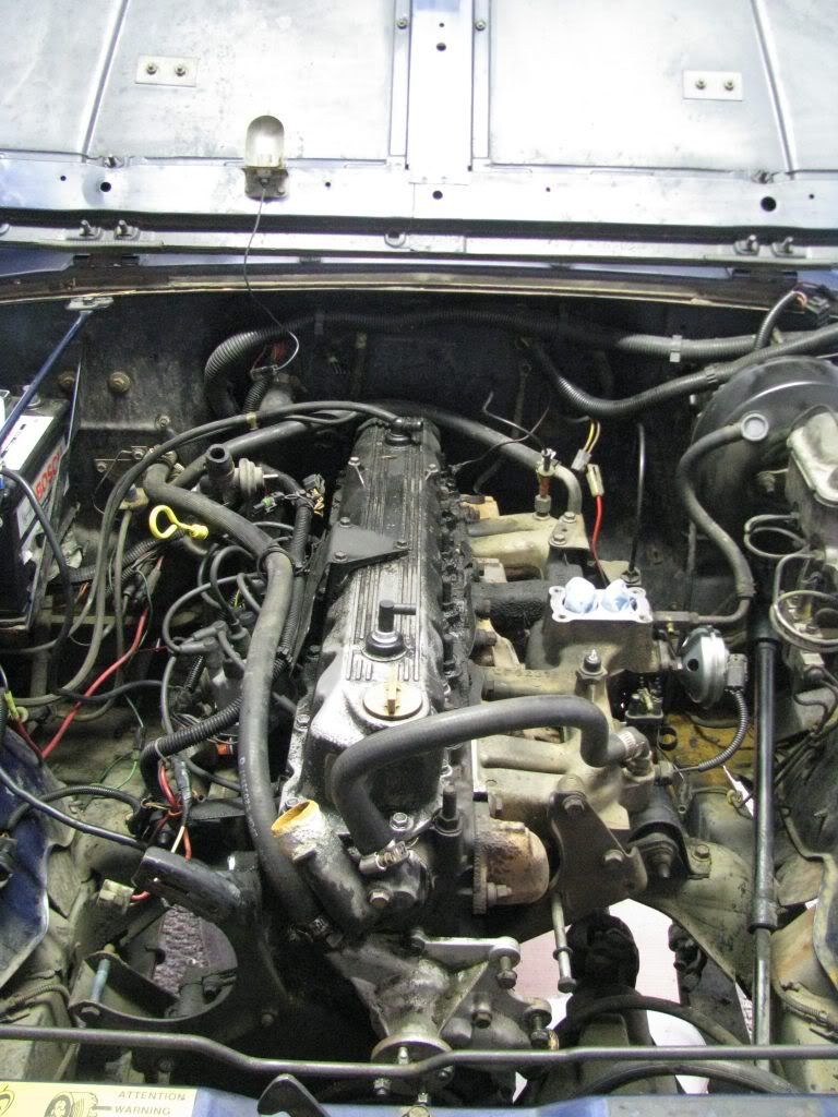

I last left off with my tear down to install the Howell TBI kit. Here is the pile of stuff that comes off with the Howell. After this photo I also added the air pulse valves and a few other small items. This pile is completely in my way, but I like seeing how big I can make it!
Here is a shot with all of the stuff removed for the Howell kit. Much cleaner engine bay. Again, still have the pulse air valves in this shot, so it only gets cleaner.

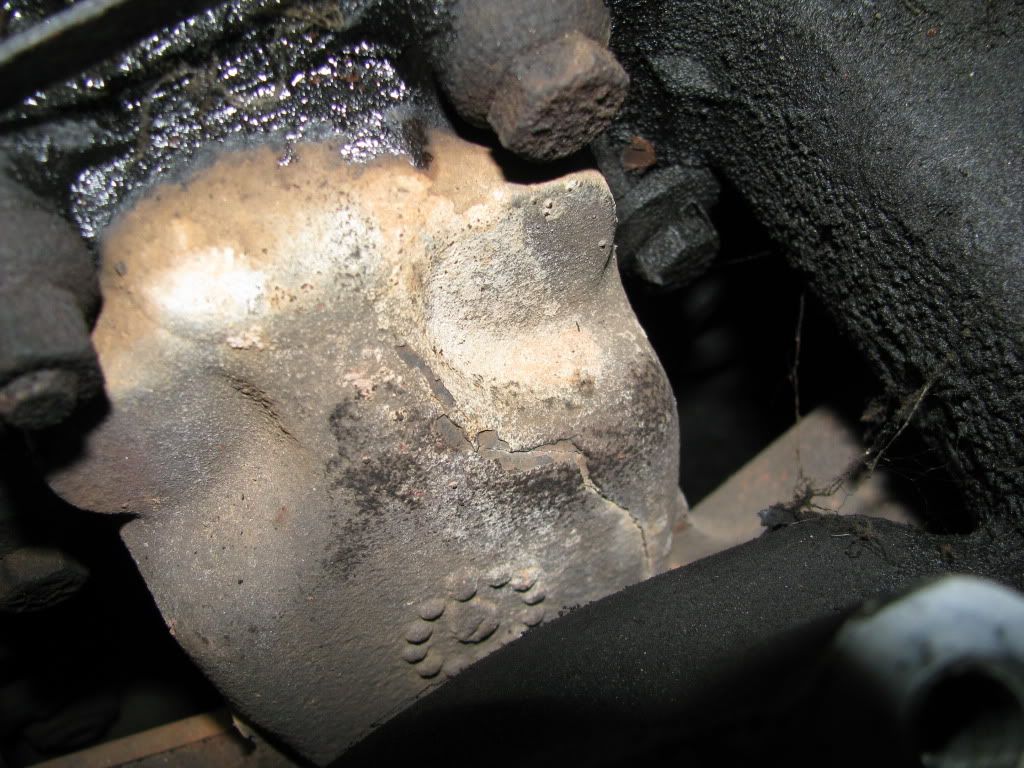

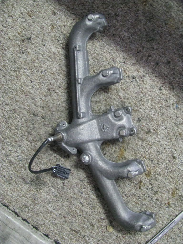

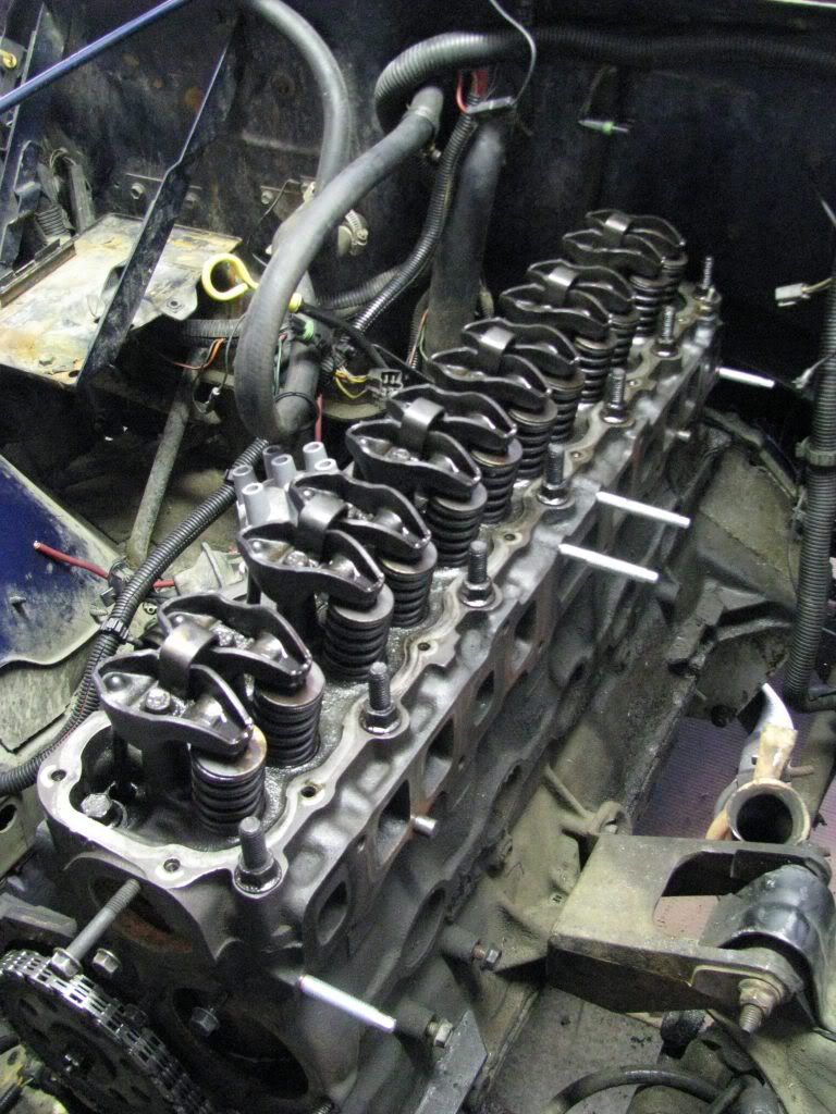

Now the fun begins! Here is the crack in my exhaust manifold that I found. Not wanting to have issues with the O2 sensor and the TBI fuel injection kit, I decided to remove it and order a new one. Well, lucky for me the rear manifold stud sheared off and the front stud did the same with hardly any torque at all on it. Also, all of my valve cover and manifold bolts were less than finger tight. I'm amazed my engine hasn't fallen apart yet.

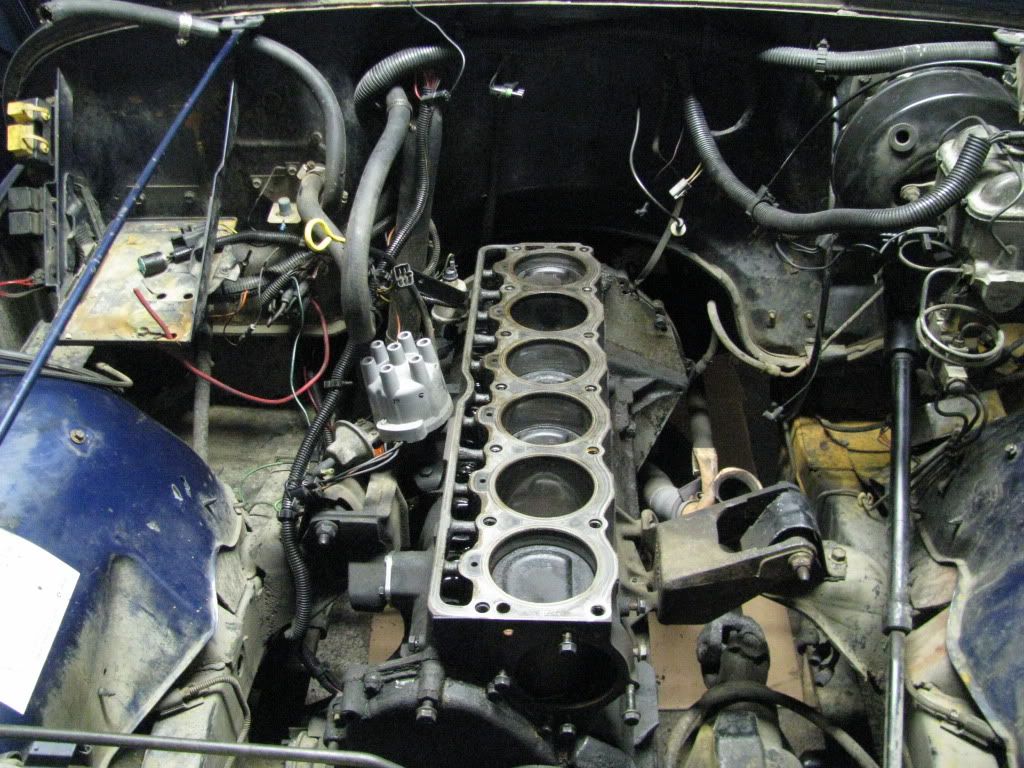

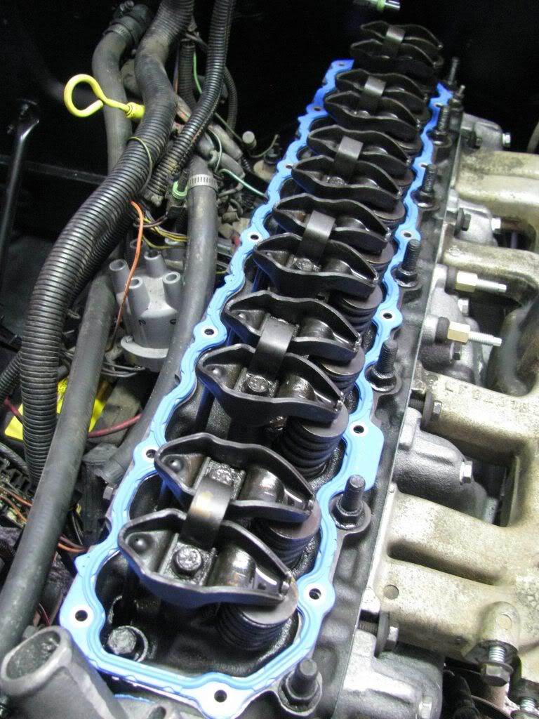

So, off with the head to get the rear stud out. I've heard too many horror stories about broken EZ-outs. Luckily I was able to remove the two broken studs with a 1/8" left-handed drill bit.
Last night I finally put the head back on. Chased all of the threads and reused the bolts. 4-stage tighten sequence to get me back to 85 ft-lbs.

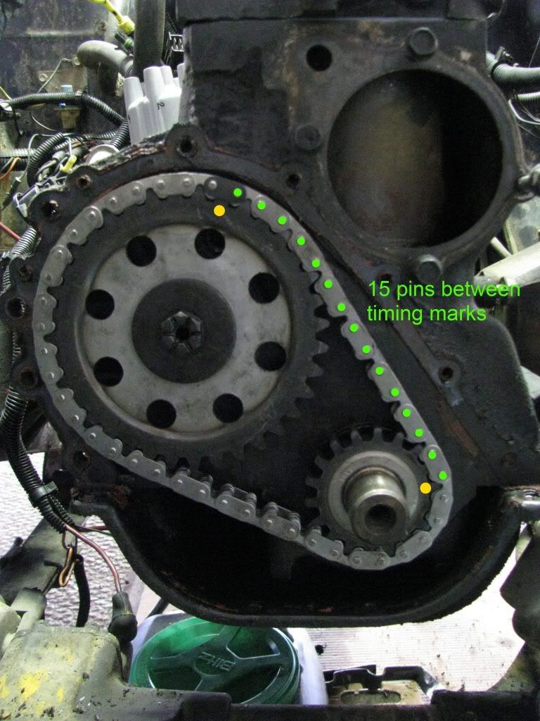

This morning, I pulled the timing cover and water pump while I was at it. The chain had a ton of slop in it; so much so it was rubbing the timing cover. Had to pull the harmonic balancer, came off easily with a crow's foot puller.
New chain installed, pretty simple. Brought engine to TDC (two sprocket dots facing each other) and removed the timing set. Reinstalled and checked alignment by rotating the cam sprocket dot to 1 o'clock and the crank sprocket should go to about 3 o'clock. You'll want to see 15 pins between the two dots.

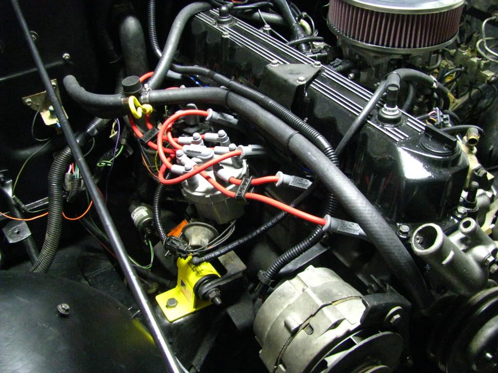

Then I installed some teflon tape on plugs of the new exhaust manifold and put the new Howell O2 sensor in.
I did some engine bay/firewall,frame painting while I had things apart. No real pics. Finished today by installing a new trans mount from Energy Suspension (P/N 3.1108G, ordered from Summit). The old mount was starting to separate; I had jack the trans case up about an inch to reinstall the new mount.

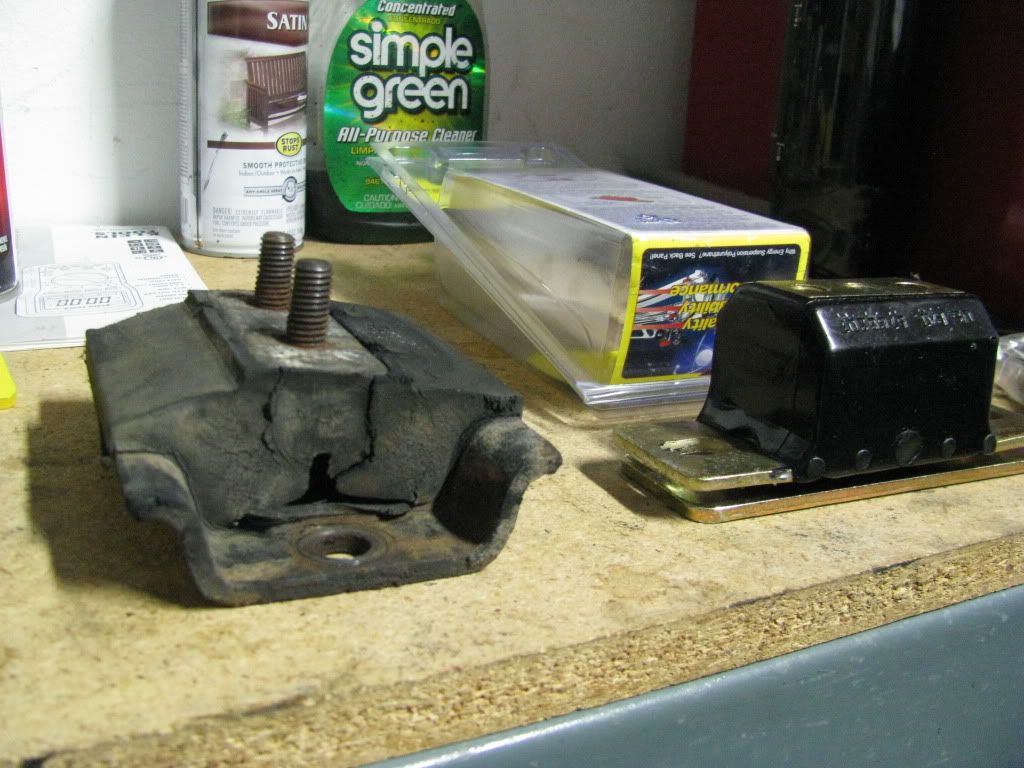

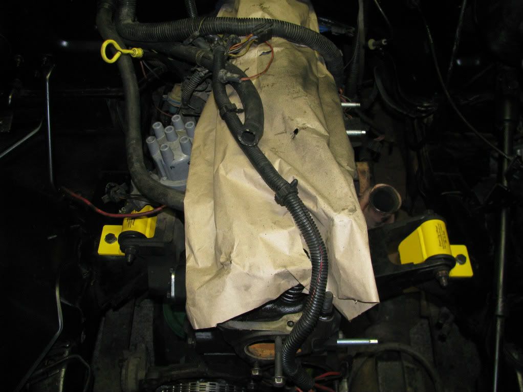

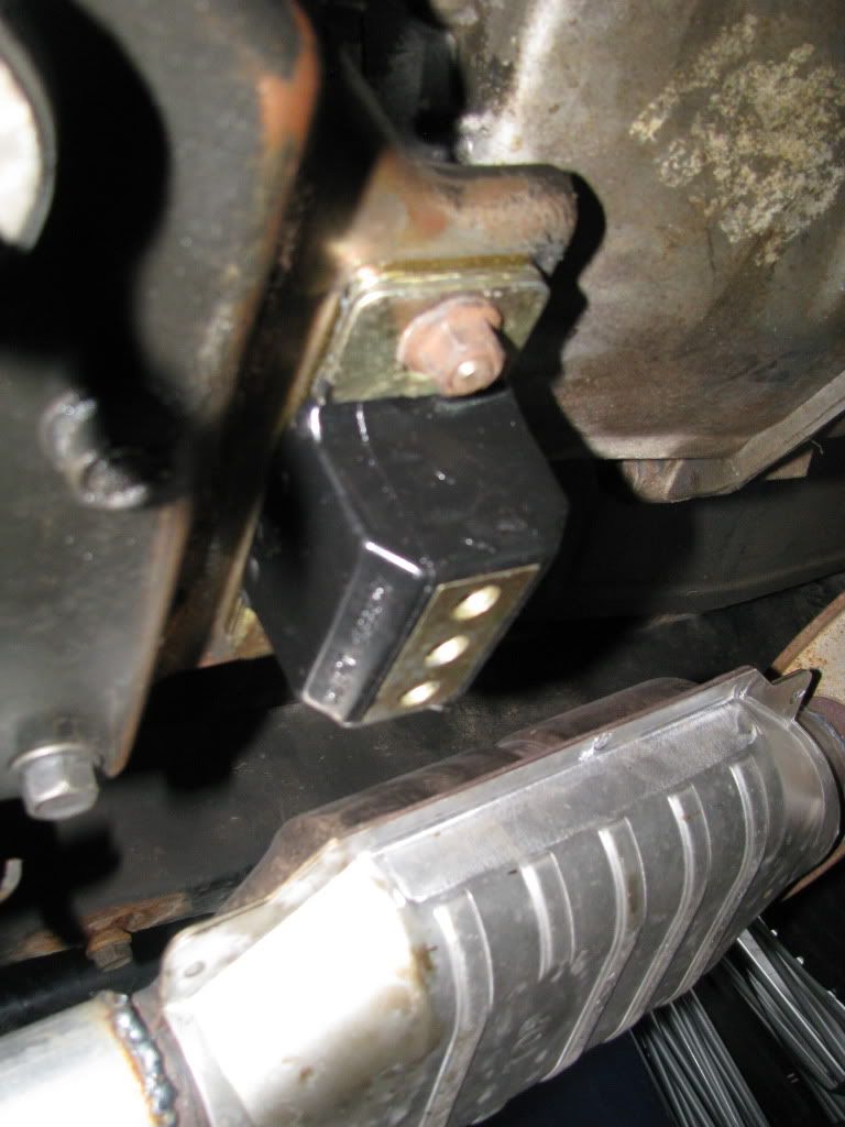

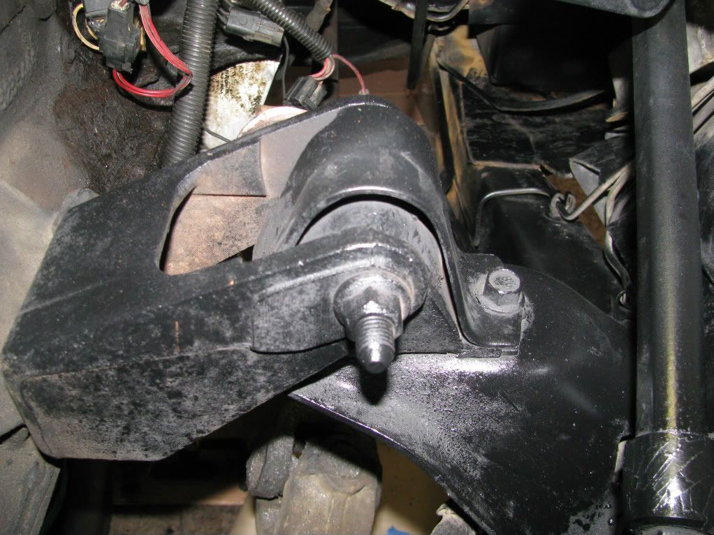

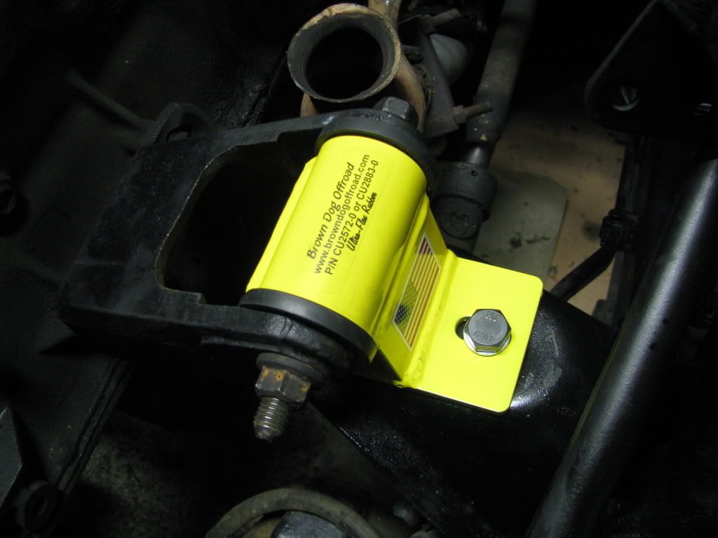

And to finish it off, new Brown Dog Motor Mounts. Standard height. My old mounts were sagged about 3/4" as well. It is noticeable how much higher the engine sits.

I painted the valve cover (pics later) and while it was drying I installed the new exhaust manifold. I used studs from a generic exhaust manifold hardware kit from O'Reilly's.

The two manifolds were torqued to spec. 30 ft-lbs for the middle two exhaust bolts, and 23 for the rest. It took me 3-4 rounds to get these tight, seemed every round pulled them in a bit more. I had a little misalignment with the two manifolds. The exhaust manifold didn't have a gasket from the factory. I didn't trust the flatness of my head, so I used the one-piece gasket (foil side towards the head). Hopefully the cone washers will handle the difference.

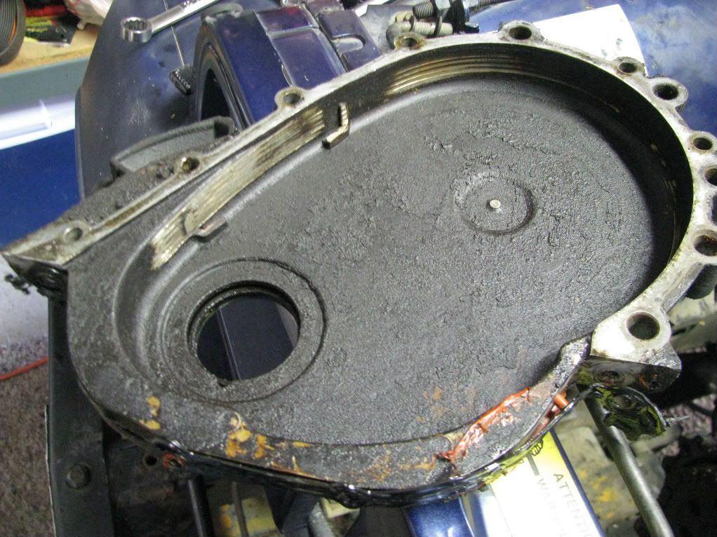

Then the timing cover went on. The timing cover was a pain since its a two piece gasket. I had to tighten the oil pan bolts first to allow the block bolts to line up with the holes correctly.

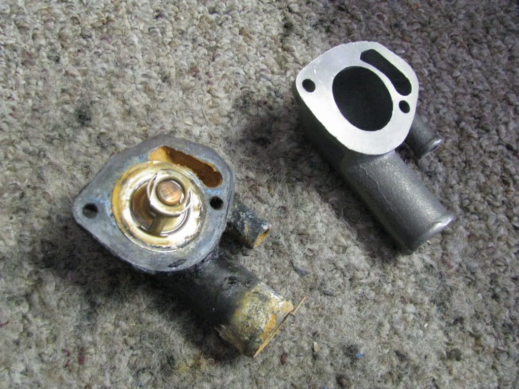

Here is a pic of the new and old t'stat housing. The original was so corroded that I didn't even want to try to clean it. A new one was 12 bucks. A 195 degree t'stat was installed. A 160 degree came out. That probably didn't help my emissions since the engine would never get hot enough to trigger the computer to go into closed-loop operation.

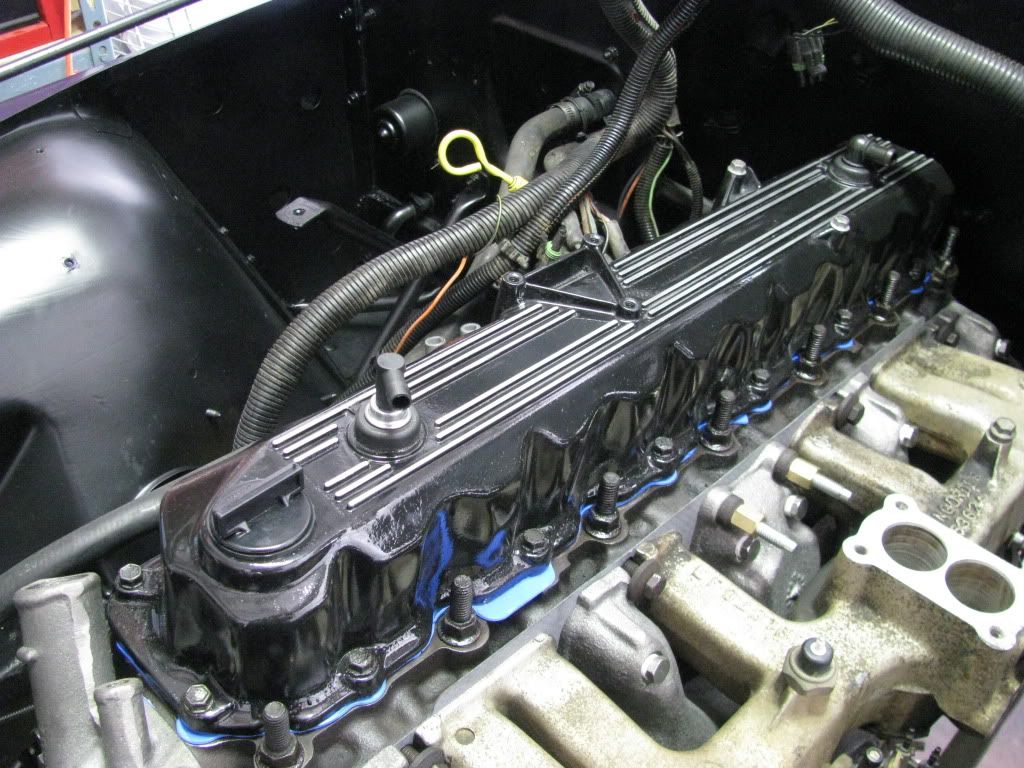

And to finish the day...here is the new valve cover gasket. This is a nice Felpro PermaDryPlus that I picked up from Summit. It's a bit expensive at 40 bucks, but its reusable and definitely seems like a nice gasket.
And then the newly painted valve cover. Turned out nicely. I used Rustoleum engine paint in gloss black. You can see the engine bay repaint as well.

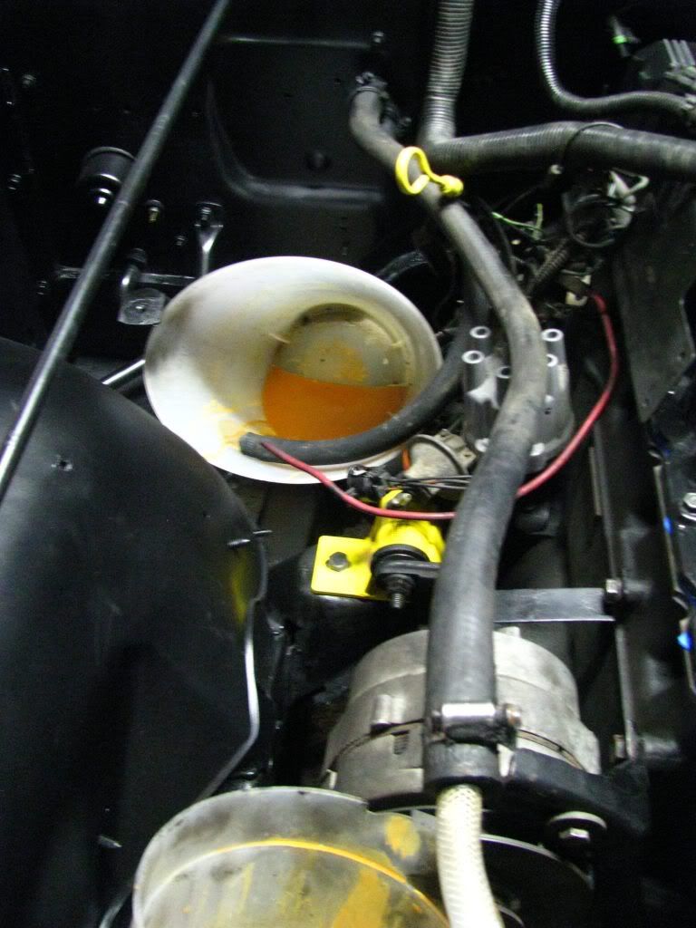

Connected my water hose up to my heater hoses and flushed my heater core. As expected it was quite filled with rust. I flushed about 7-8 gallons of water through it and it still wasn't perfectly clear.
Then I started the Team Rush install. An MSD 2F coil went on first and then a Borg Warner cap, adaptor, and rotor button. The BWD select components seem to be decent quality with brass contacts. The "non-select" box is for the distributor-to-cap adapter. Super easy to install. Gapped new plugs to .042". I started to lay out the MSD cut-to-fit wires but it started to get too late, so I'll tackle those tomorrow.

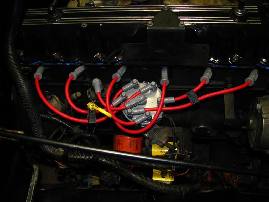

The next night I installed MSD cut-to-fit spark plug wires. This took about an hour and a half to complete, but I think it came out well. I wrote a how-to on this, but for some reason it appears to not have posted either. These weren't hard to do, but it took some time to do the first wire, then the rest were easy.

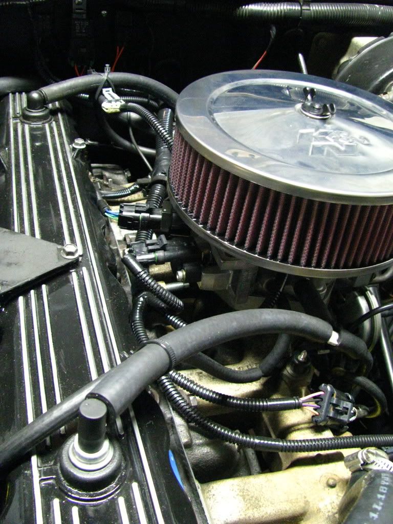

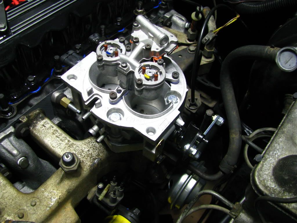

Then I put the new throttle body on...and the K&N filter kit recommended with the Howell. Then new heater hoses and vacuum lines went in. The engine compartment is definitely looking much nicer now. I still need to paint the driver-side fender, but it needs to come off for straightening since it is tweaked a little.

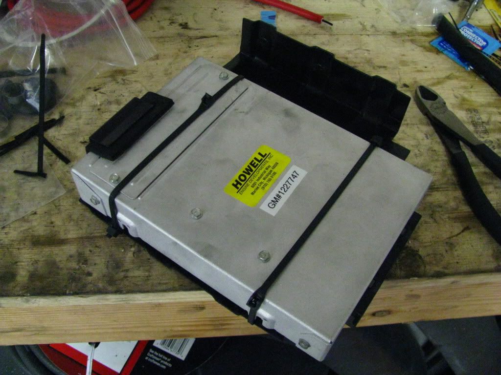

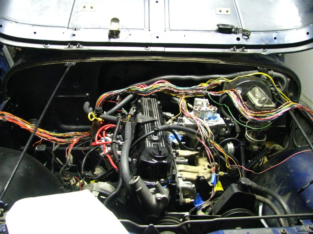

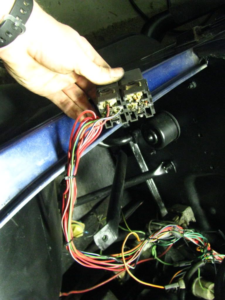

The following night I tore into the wiring harness. I pulled the stock ECM first and pulled the ECM wiring connector through the firewall. The GM ECM was attached back in the same spot. I drilled a few holes in the bracket and used some zip ties to secure it. I also reused the foam from the old ECM on the new one to prevent rattles.
All of the plastic wire loom was removed to make it easier to strip wires. Not only did I remove the wires that went to the ECM (only three remained that were needed for the Howell), but I removed the wiring for the diagnostic ports and sol-vac relay (and associated "black box") located by the battery tray. The sol-vac was removed from the factory on a recall many years ago, but the wiring and relays still persist.
The Howell wiring job wasn't that bad. I spent more time trying to figure out what all I could remove. To keep it easier, the computer wires could just be cut out and capped.

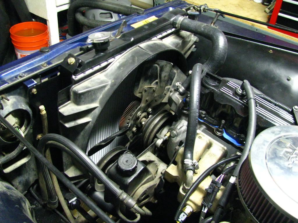

Then installed a new radiator and hoses, followed by the shroud, alternator, power steering, fan, etc.
Here is a quick shot of the new wiring harness around the TBI. I'm impressed with how nicely the Howell is put together. Wire lengths have been perfect.

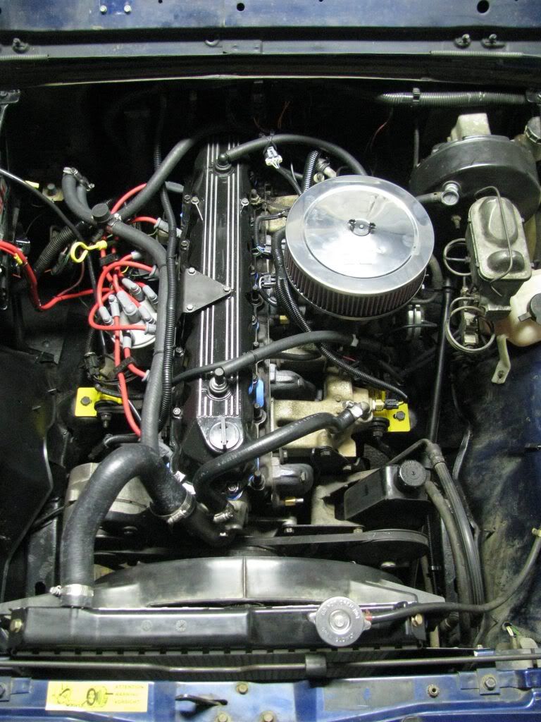

Here is the finished engine compartment. Still need to paint the driver side fender, but I'll get to that later. Installed new battery cables since my old ones didn't give me much confidence.

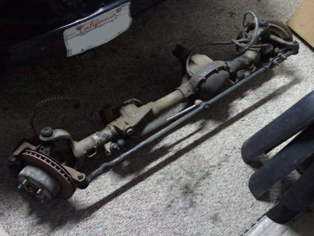

Grabbed a '95 YJ front axle out of a 4 cylinder from a local Jeep guy. It has the 4.10 gears that I want to run with the 33s that are planned. Also has the larger u-joints in the axle shafts, although I'll be putting in a pass-side axle shaft from a TJ to eliminate the vacuum disconnect. Doing a little refurb on the axle is probably the next undertaking. Assuming I can get a little bit of cash for the stock front axle, I should come out cheaper than a new set of gears by themselves...let alone the gear setup costs.

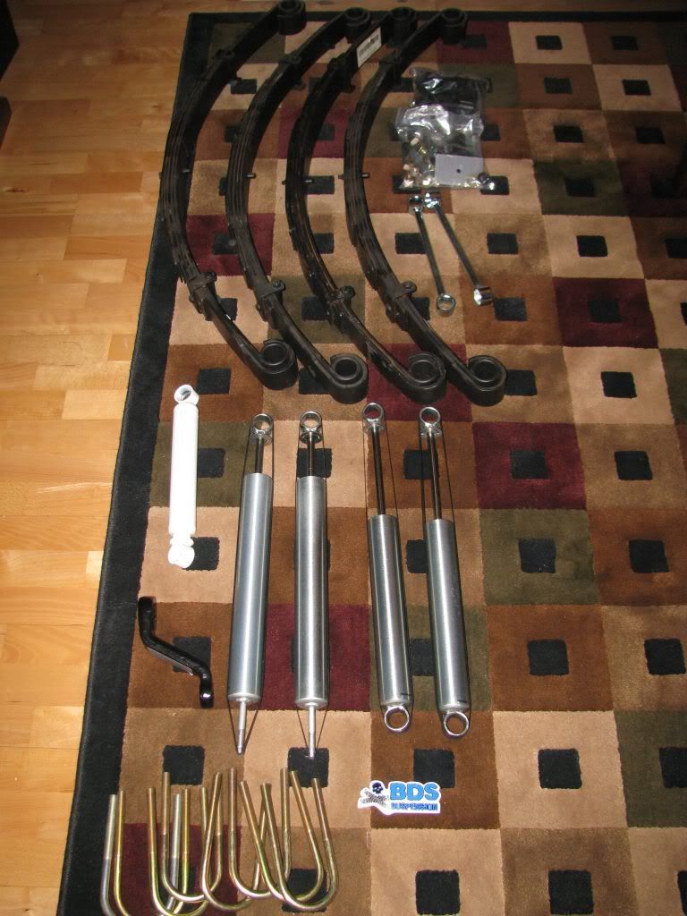

Also picked up a 3.5" BDS lift kit from the local shop today. Their prices were better than BDS's website and they still honored the promotion for free shock upgrade to the 9500 series. Also got a 5500 series steering stabilizer. Didn't get shock boots, since I thought they were included, so I'll probably have to order those.

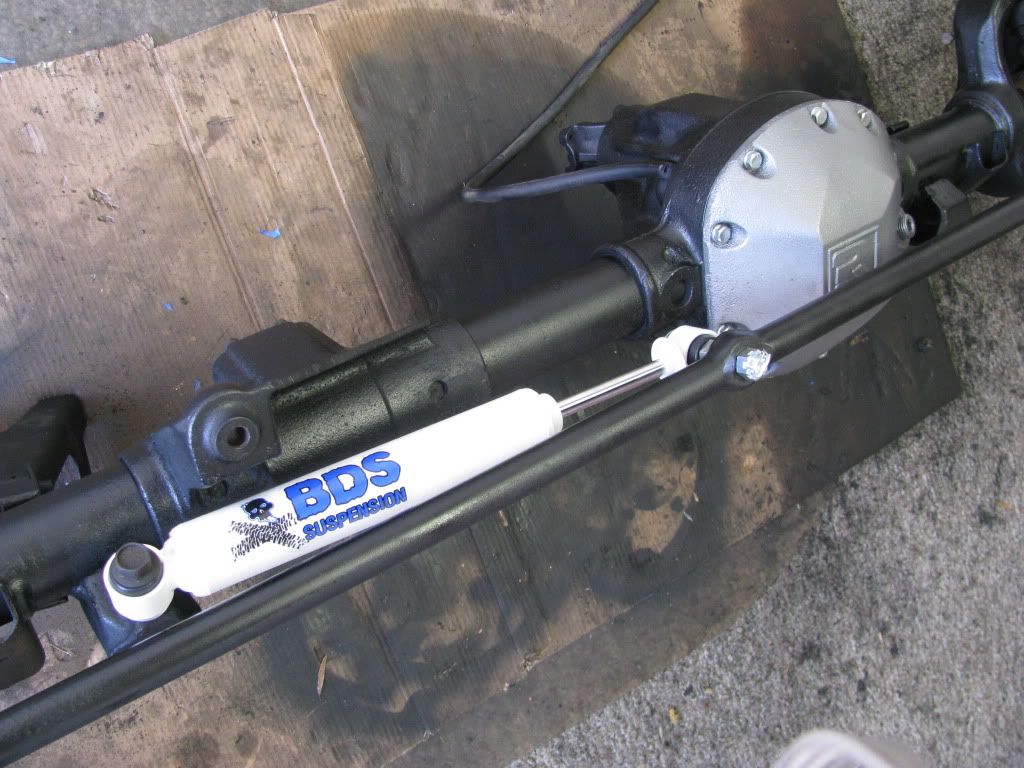

Last week I dug into the "new" front axle. Pulled the carrier and installed a new axle seal along with a pass-side TJ axle shaft, hopefully it doesn't leak; I had some issues getting the seal installed. Also installed a Riddler diff cover with a Lube Locker gasket while I had things apart. Put the new stabilizer on too. Overall it turned out quite nice.

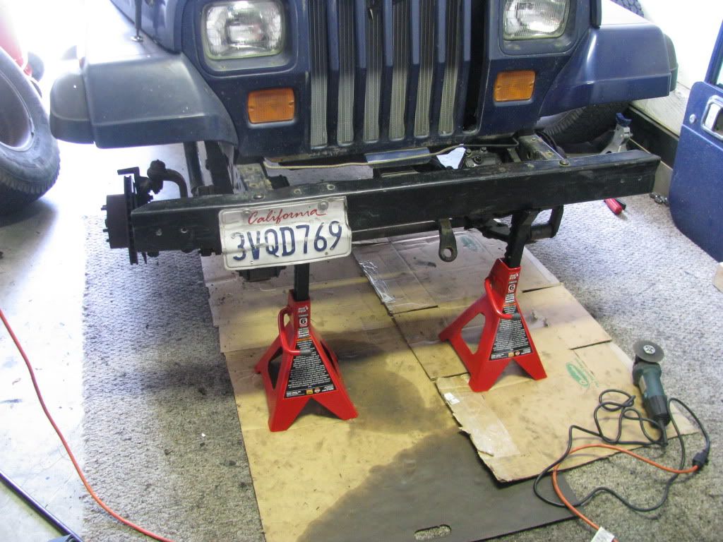

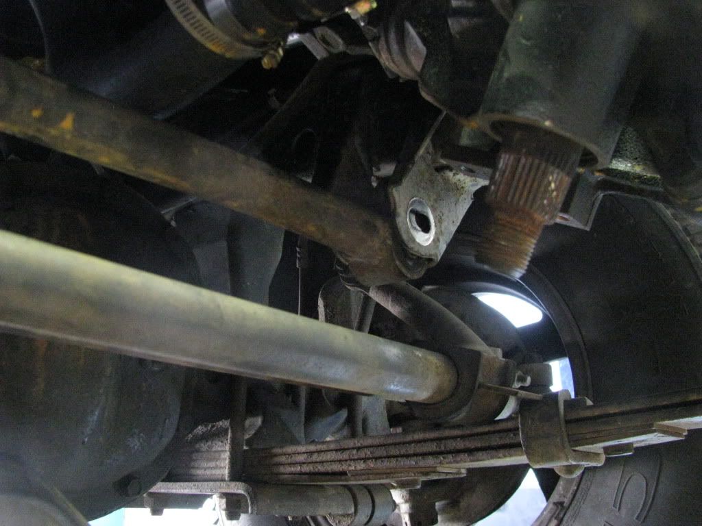

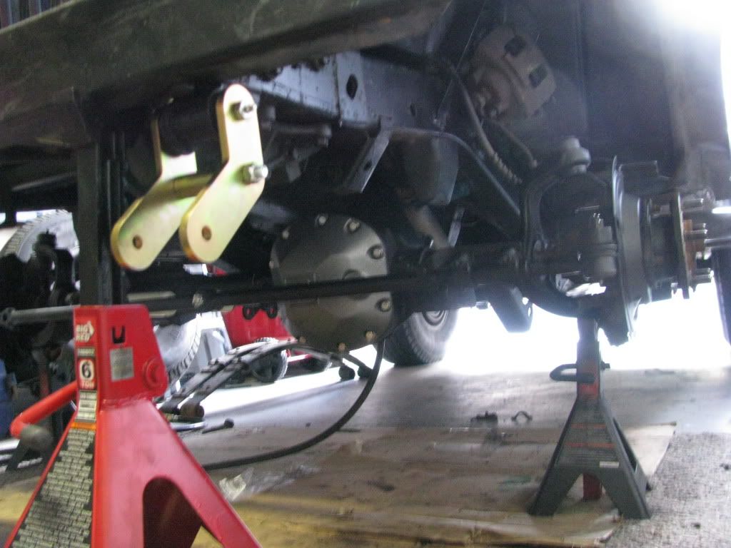

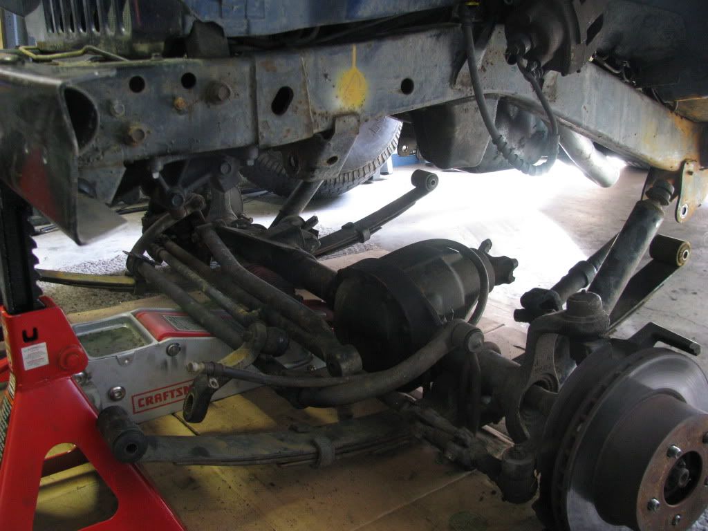

Sunday afternoon I decided to tackle the front half of the lift kit. Here are a few shots along the way:
First a pre-lift shot...
First thing was to remove the pittman arm (I had to use the grinder with a cut-off wheel to cut a slot and then used the puller). Unbolted the sway bar and upper trackbar.
Then it went up on jack stands, pulled the wheels and calipers.
Then with some jack/jackstand manipulation I was able to unbolt the leaf springs without them being loaded. Here it is with shocks and leaf springs disconnected, ready to be pulled. I had a heck of a time pulling this entire assembly out from underneath by myself in a one car garage since the jack stands were in the way with no place to move them. I should have removed the leaf springs first.

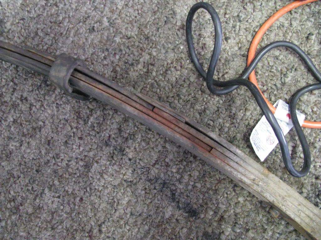

Here is one of my front leafs. The other one only had one broken leaf.
Moving the front axle in was much easier. I relocated the jackstands back further, moved the axle in, and then relocated them back to under the front bumper. Here it is ready for leafs with 5/8s boomerang shackles installed:
Here it is bolted up. Everything went together nicely. I still need to put the draglink in and figure out if I'm going to run a sway bar (I thought the kit came with disconnects, but it didn't...)

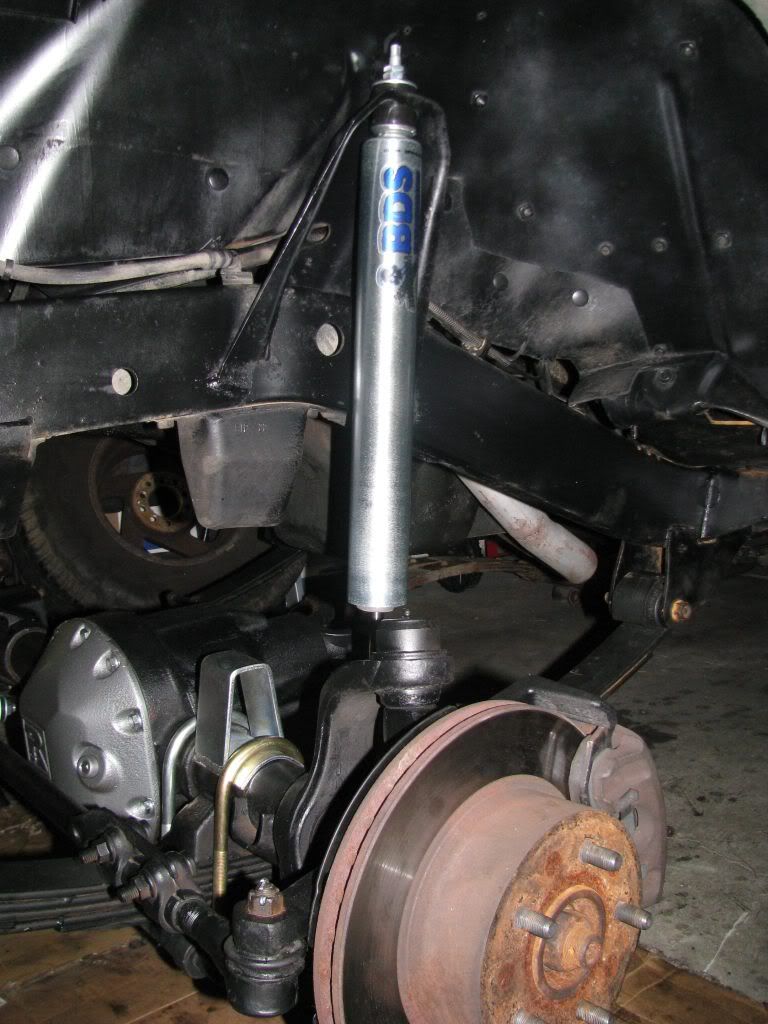

Then the new shocks went on. Reinstalled the calipers. I need to pick up longer brake lines.

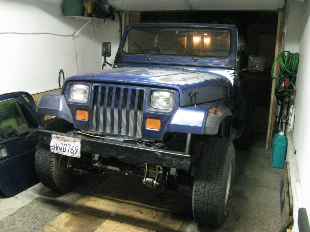

Here are two shots with the wheels back on, ready to be pushed back into the garage. With only the front half of the kit on, I have 8" of lift. I'm sure that will come down some when I lift the rear and after it settles, but I wonder how much. My original springs were completely shot. I'm happy with the install and the overall look underneath. I know looks don't matter too much, but this Jeep was so neglected that I feel it deserves a bit of fresh paint and new parts underneath.

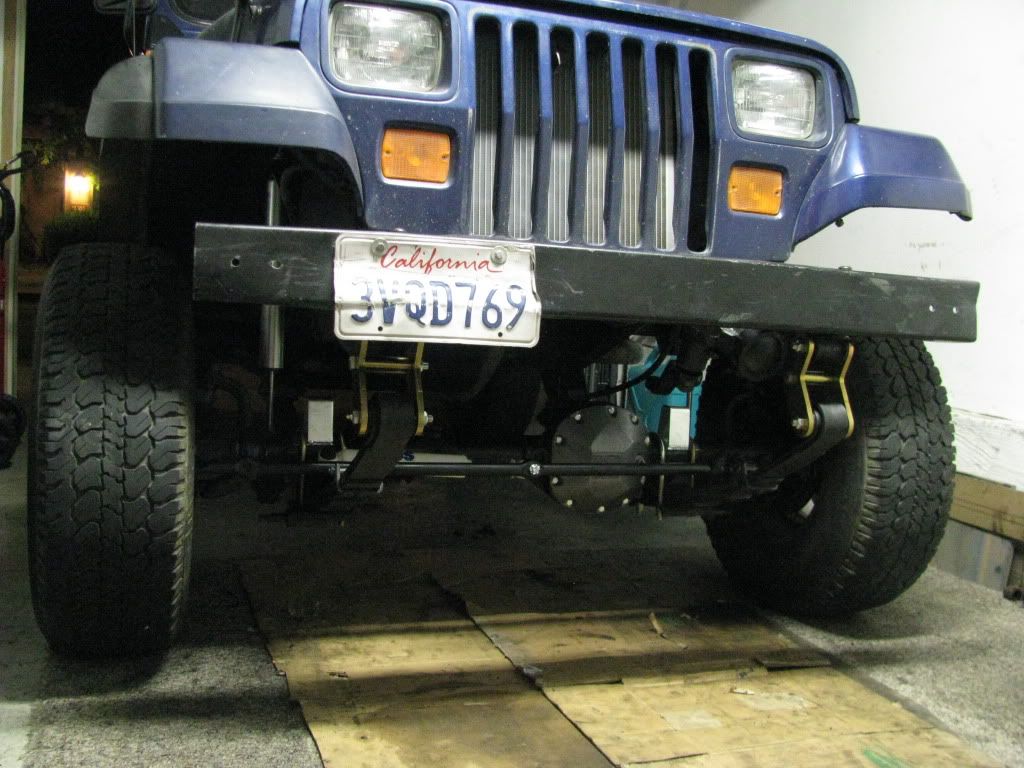

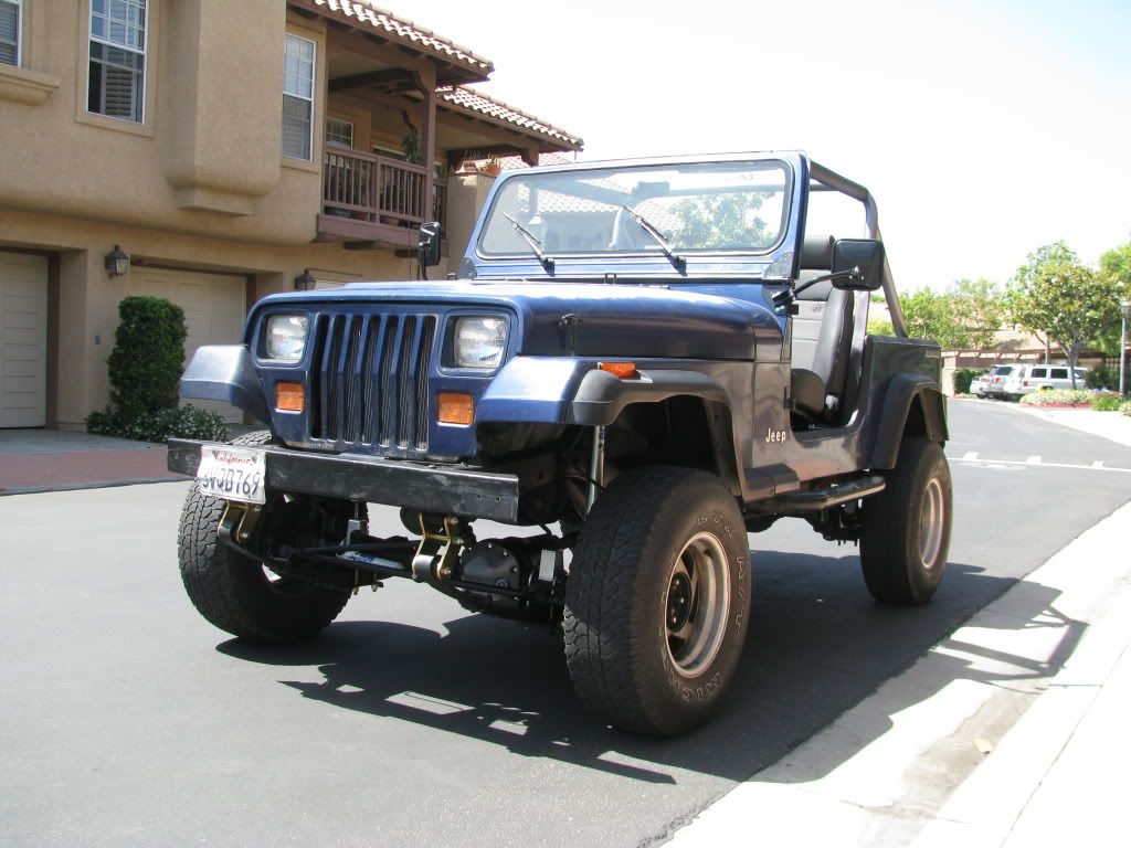

Finished the lift this past weekend (3.5" BDS with 5/8" MORE shackles). Took me 8 hours to finish the front (extend the brake lines, bleed the calipers, install drag link), do the tcase drop and do the rear. Much easier since I wasn't swapping the axle.
Before:
After:
And a couple more shots:
I gained 6" in the front and 5" in the rear. I'm currently sitting at 24.5" at the bottom of the rocker panel. I'm currently not running track bars or a front sway bar. Everything is still pretty stiff. Ride is a bit bouncy on the interstate. Seems tolerable now and I need to flex it out a bit to try to get it to settle and smooth out even more. Put about 100 miles on it since Saturday. Once I pass smog (almost passed on Tuesday), I'll order my new tires and rims.
