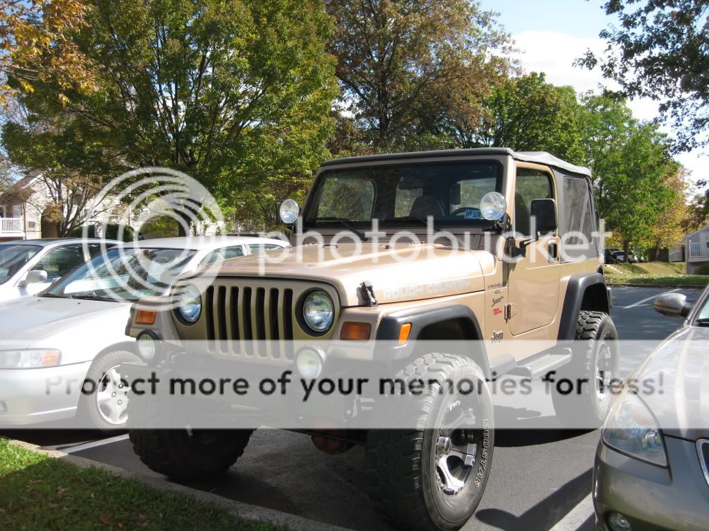

Heres the jeep when i first got it in the beginning of October 2008. 1999 4.0L 5 speed.
Thats when i got it from the dealer, you can see my old green dodge Dakota in the back.
It had a tan top that needed to be replaced. The black one thats on there i got for free out of a relatives garage. (sold there jeep with the hardtop forgot about the soft top) Its for a 03-06 jeep but it fit no problem and no leaks.

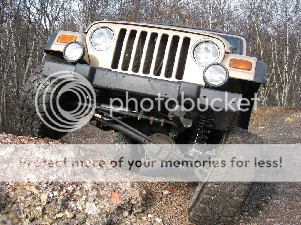

Here it is with the stock tires and wheels still on and the lift on.
Here it is with the new tires and rims i bought of soldkm. There Dc-1's with 35X12.50 16's mud stars.
Looks alot better IMO.

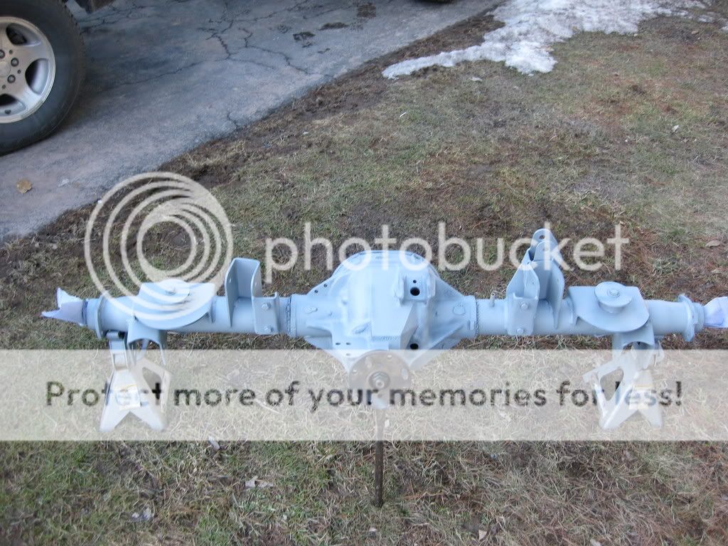

Next i needed to do something about my rear axle and get some clearence back so i ordered an AA SYE kit and pulled an XJ front friveshaft. I also got my hands on an 8.8 rear axle 31 spline LSD. I geared it and the front to 4.10's becasue i got them for cheap with the help of Solidkm and Rick at his garage. I had the brackets on my 8.8 welded on from EMS offroad.

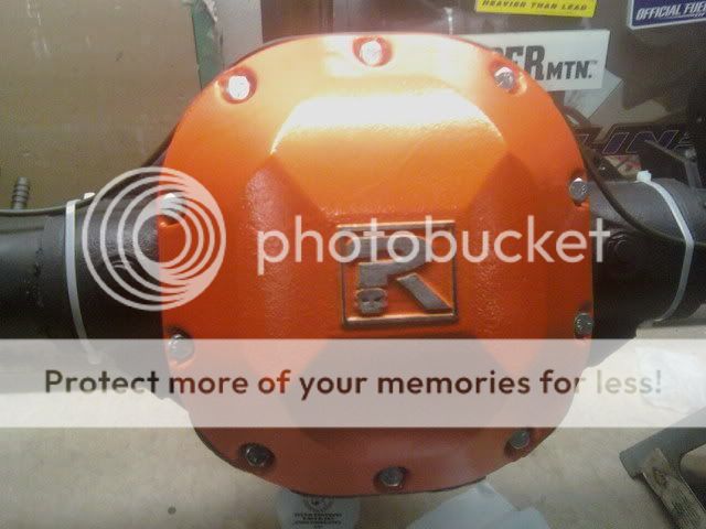

Next i needed a diff cover so i got a riddler one for my birthday and solidm km painted it up for me wile i was away at school.

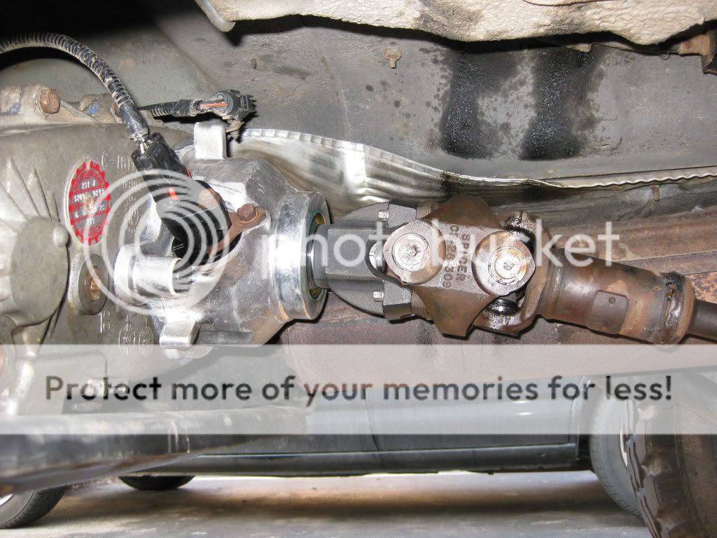

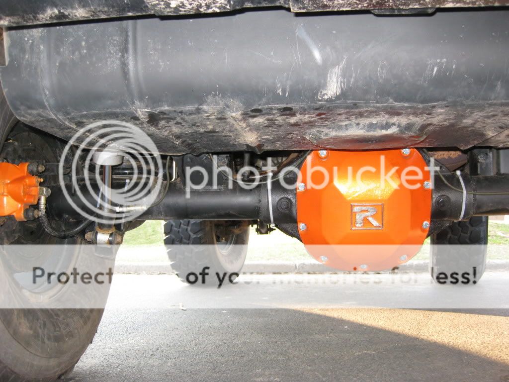

I got the SYE and driveshaft and axle put in over spring break, it was a rainy day but luckly the jeep is lifted so we threw and old mattress under it and pulled everything and put it all in. Before however, i ordered some RC upper adj control arms so i could dial in the pinion angle.
fficeffice" />>>
EMS offroad took a wheel spacer and ajusted the brackets to put the rear right i nthe center of the jeep.

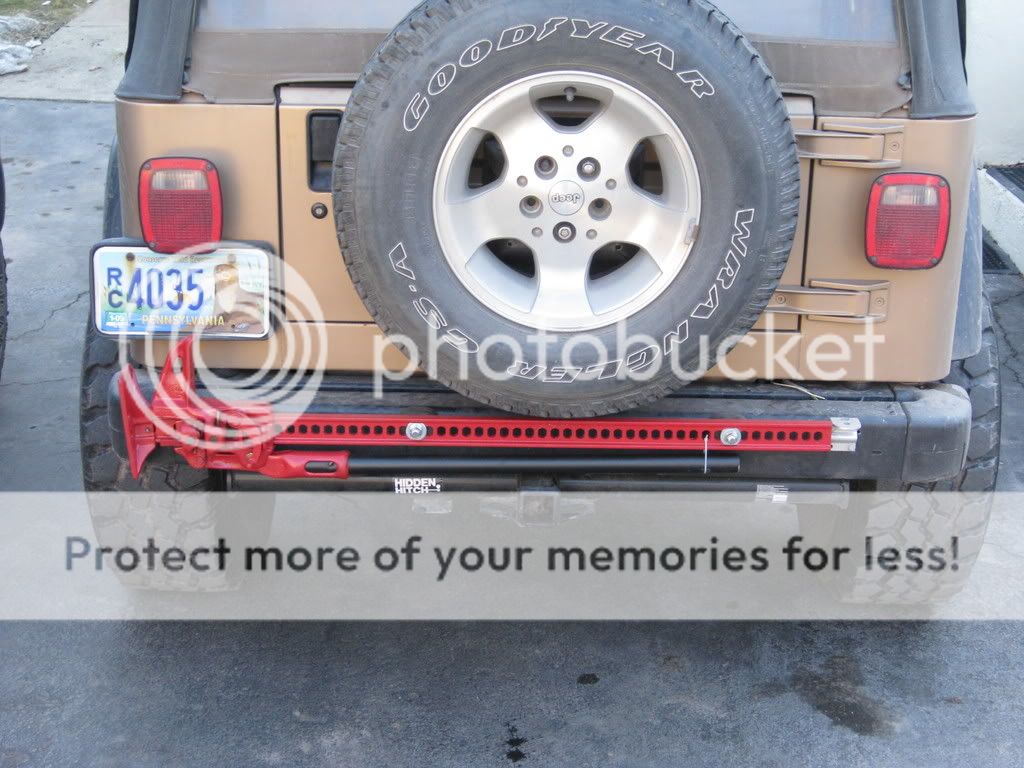

Next i got my hi lift jack mounted and with the new axle was able to be harder on the trail.
Still has the stock spare, if i got a flat i dont think it was going to help.
Jeep has awesome flex with this kit and i still have the front stock uppers.

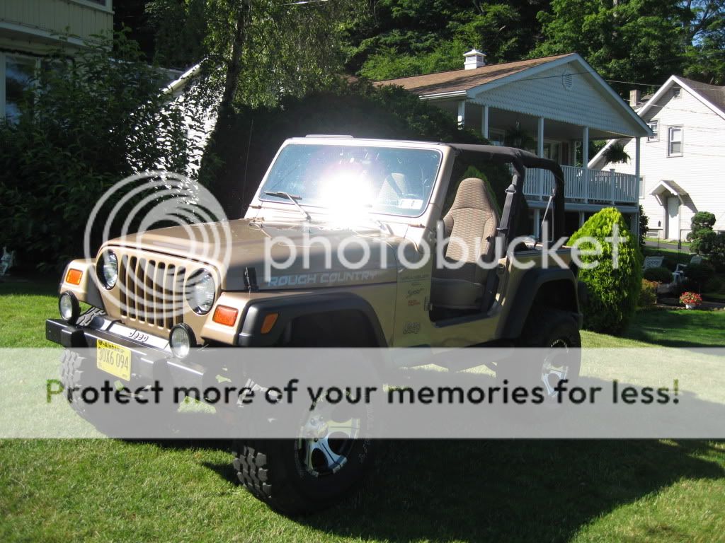

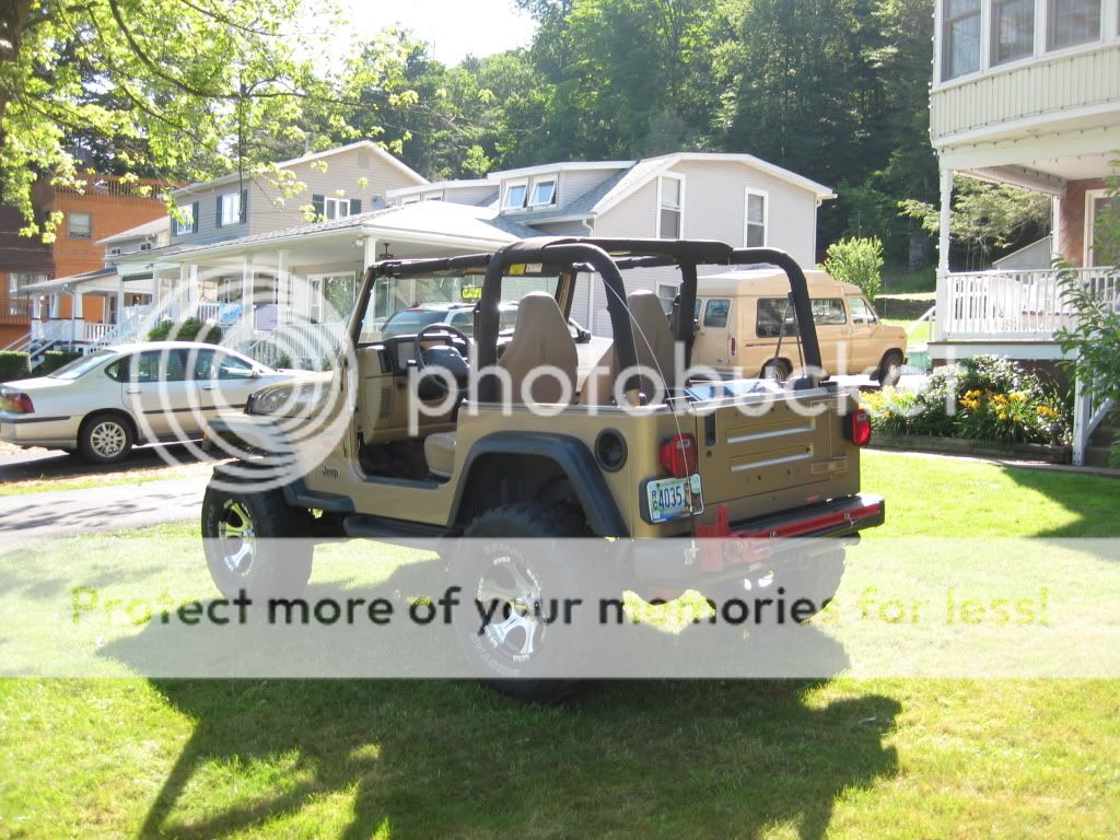

After that i didnt do to much to the jeep, i did take everything out over the summer and herculine the tub. I also painted the headlight bezels. I also got center caps for my rims to clean it up a bit. Here it is this summer with the top and doors off and that spare tire gone.
At the PA all breeds jeep show in York PA I got a set of window brackets for lights and got a set of hella 500 driving lights and mounted them up, I had always wanted these for my jeep.

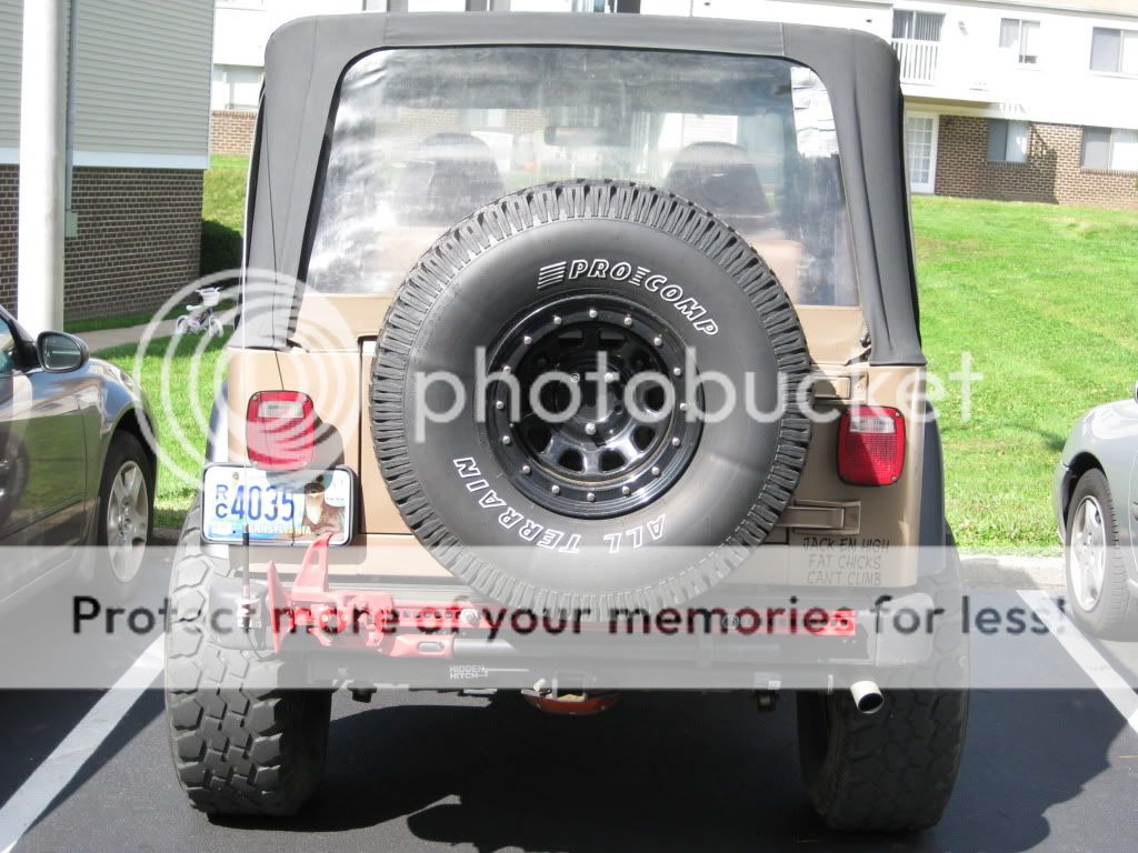

I had black rims that I got last October when I first got the jeep at the quadratec scratch and dent. So after saving up over the summer I got my tires for the winter and mounted them on the rims. Now I have a full size spare.

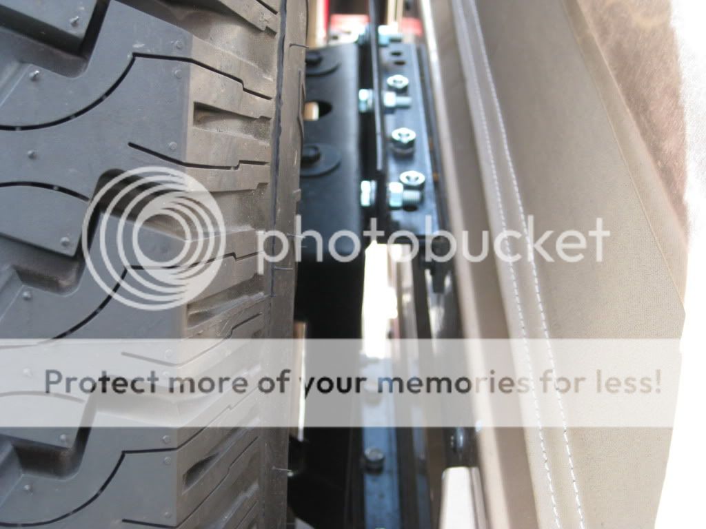

I made my own bracket out of some angle iron so I could run the 35 on the tail gate.
The tire rests on the jack so there is almost no weight on the tailgate so my design worked out perfectly.
