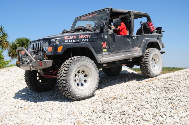

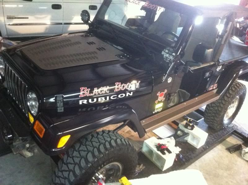

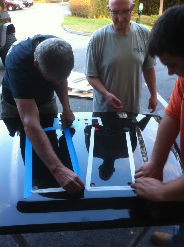

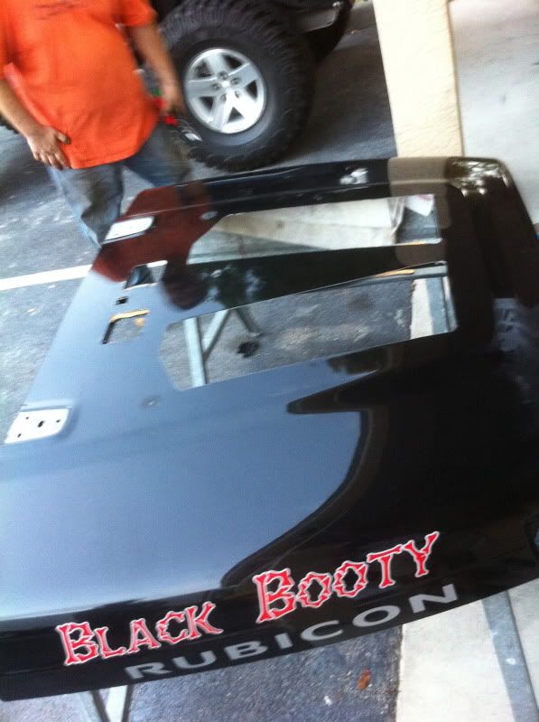

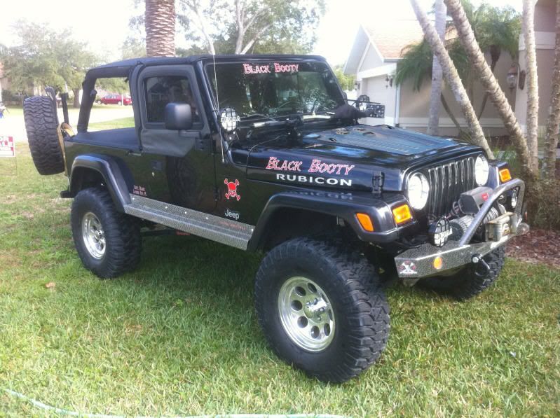

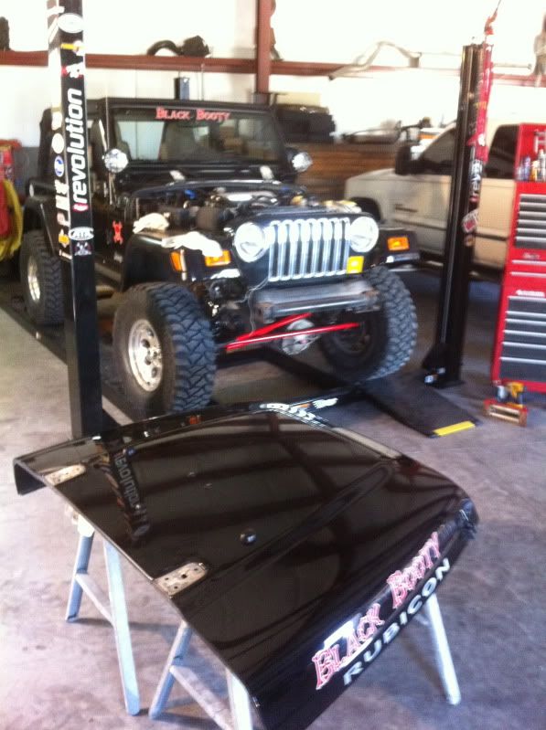

tryin to work out a color scheme....

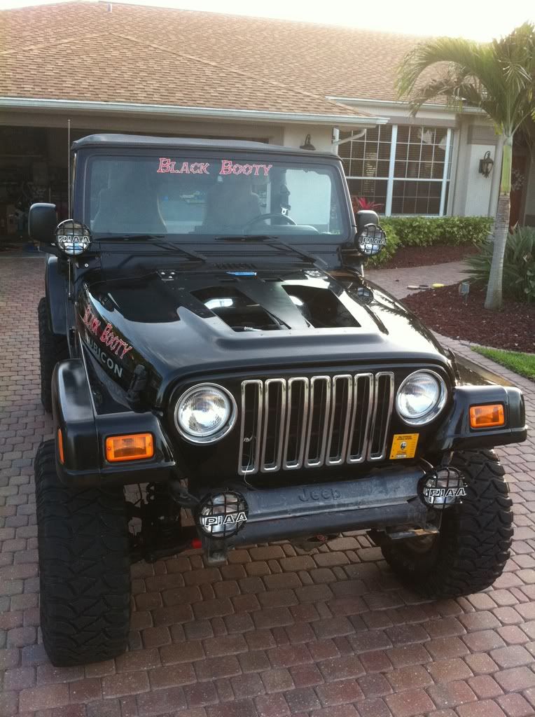

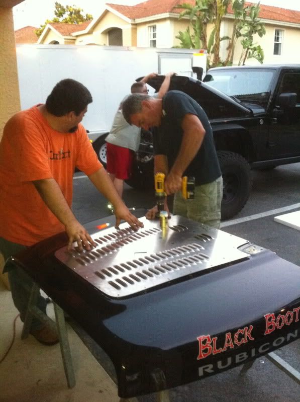

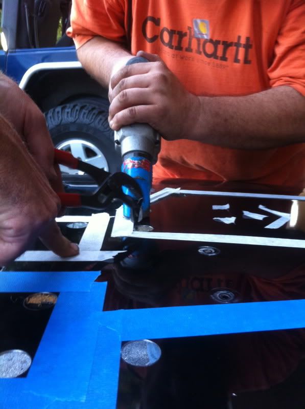

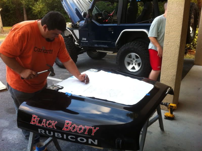

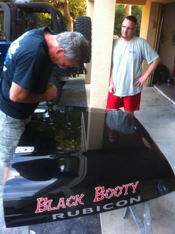

Got my Poison Spyder Louvered Hood panel in, now for the install....

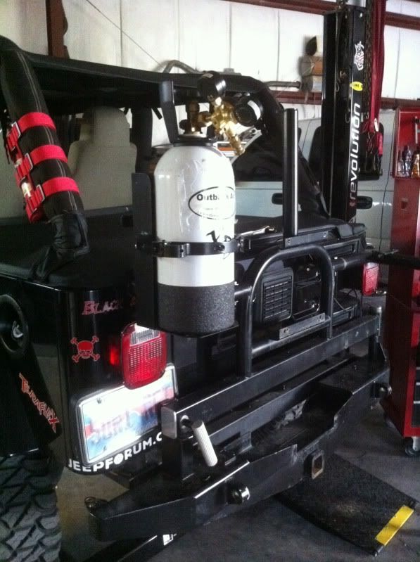

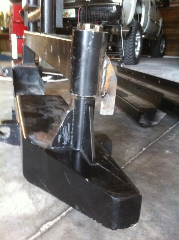

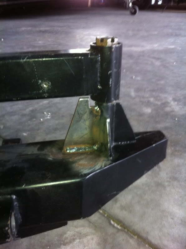

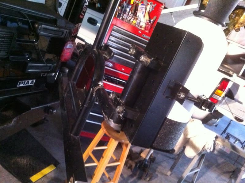

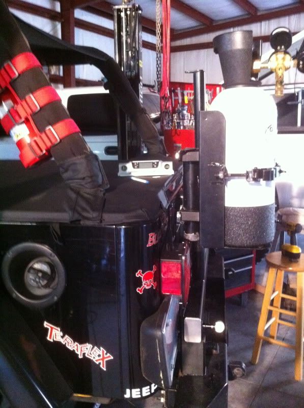

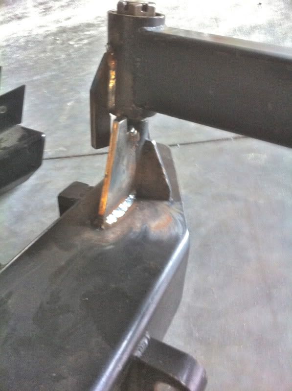

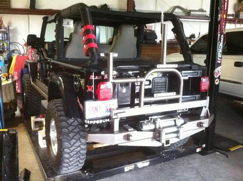

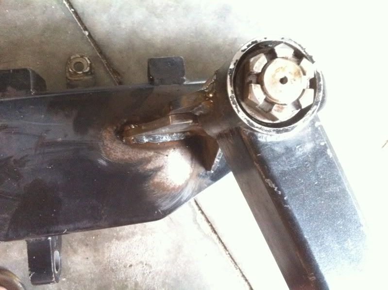

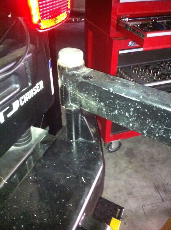

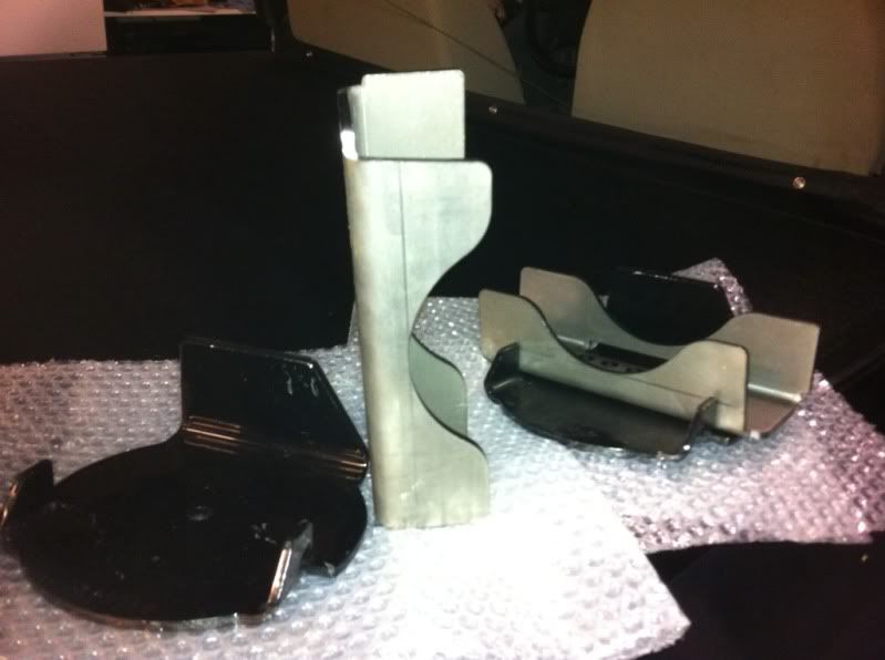

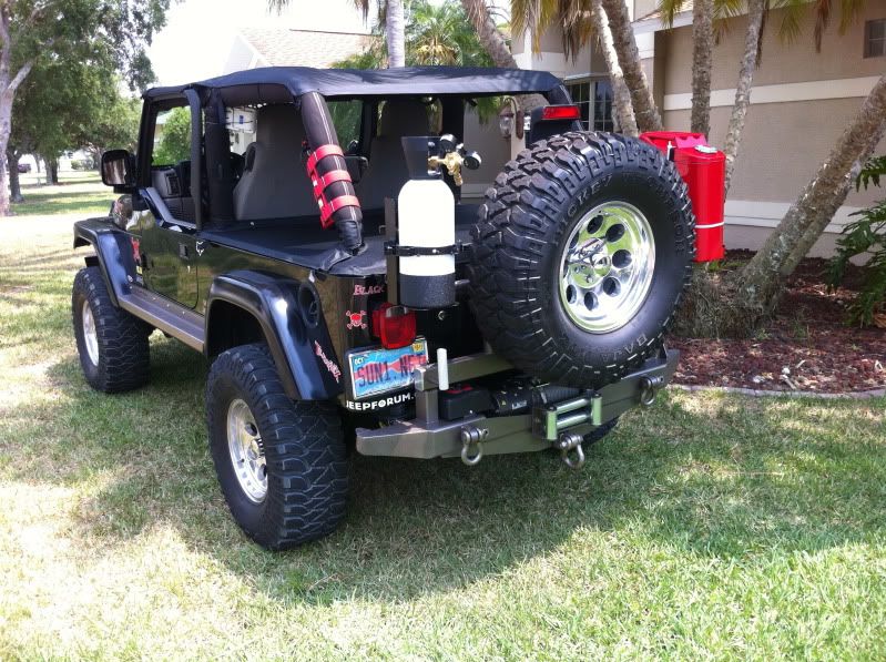

on my rear bumper I had to design a stop it wouldn't swing around and smack the side.
added some arm's to carry an air tank and gas can.....made them removable also....

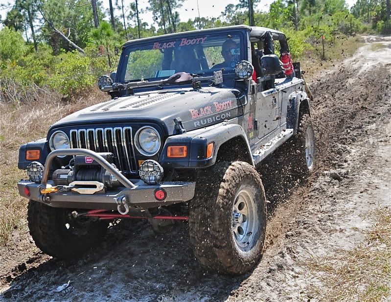

now there's some real vents....

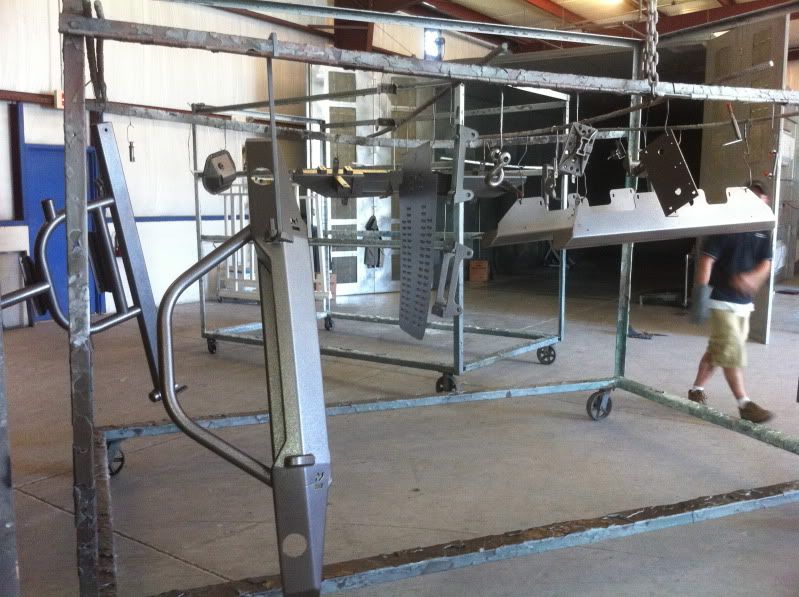

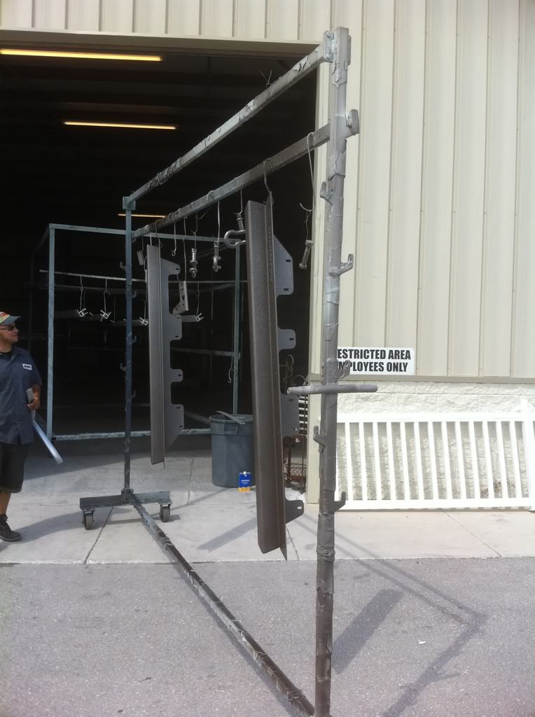

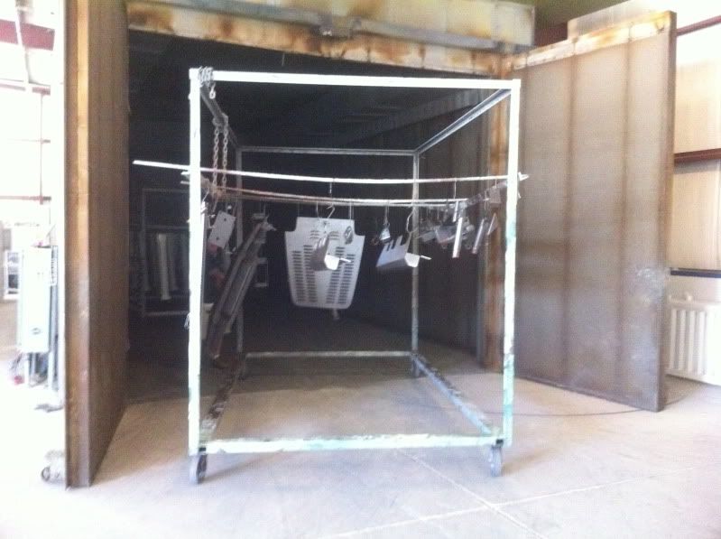

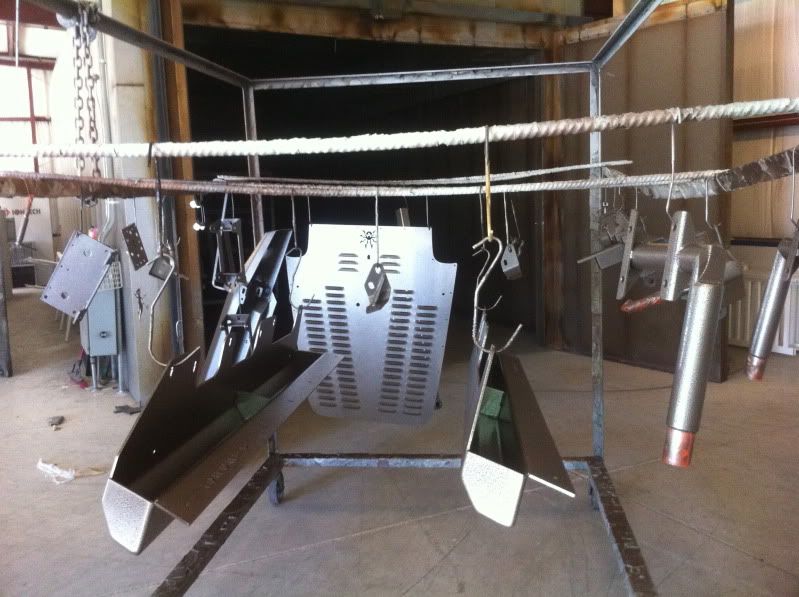

sent all the parts to the powder coater......

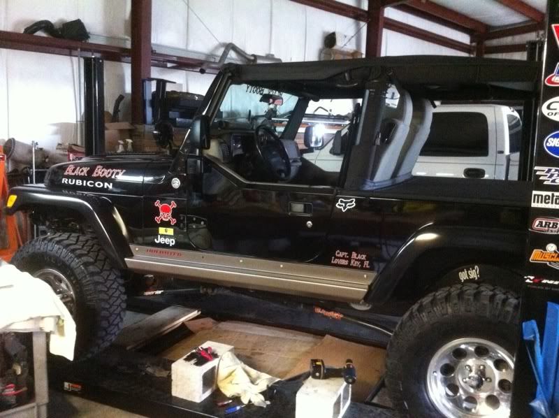

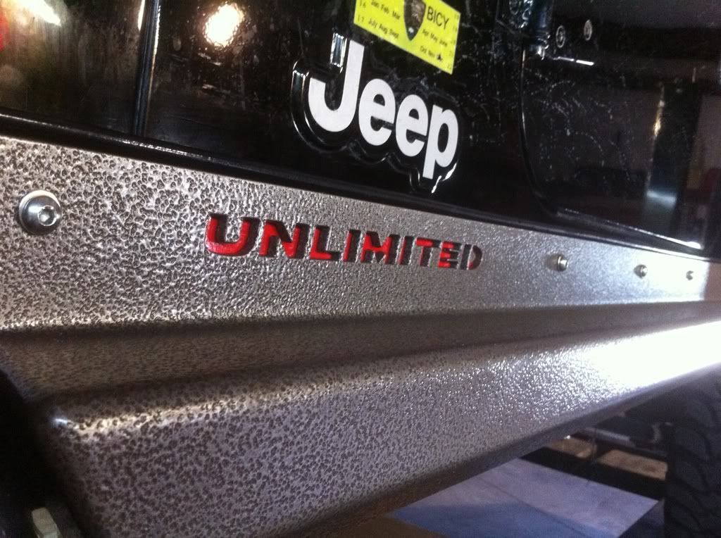

I wasn't crazy about the finish on my Kilby Rockers, no problem, they took them back re sandblasted and shot again.....

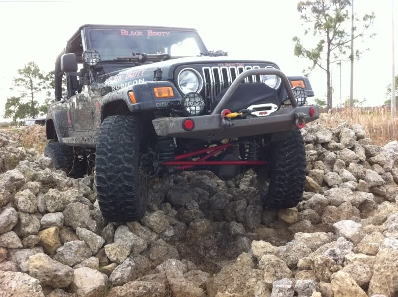

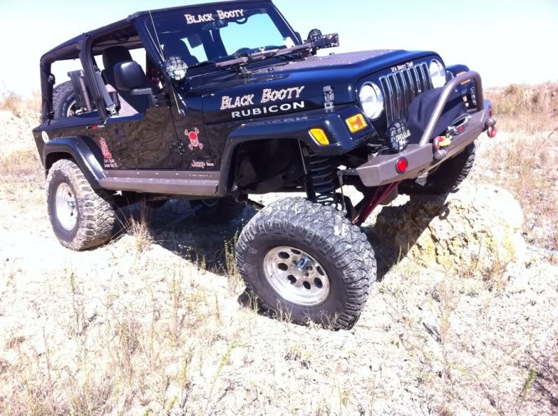

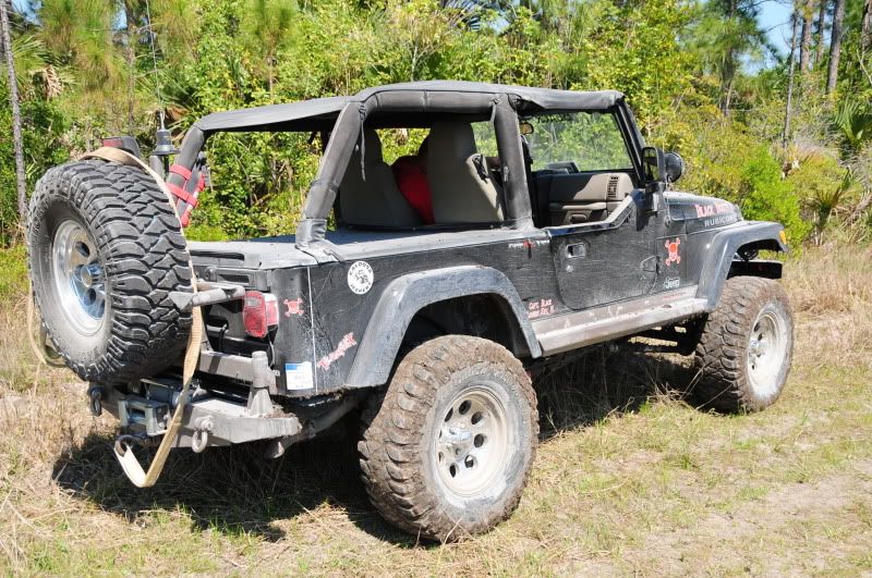

Looking nice.
Not a fan of the stickers ...but hey if you like it thats what counts.
Badass rear tire carrier and dual winches tho.

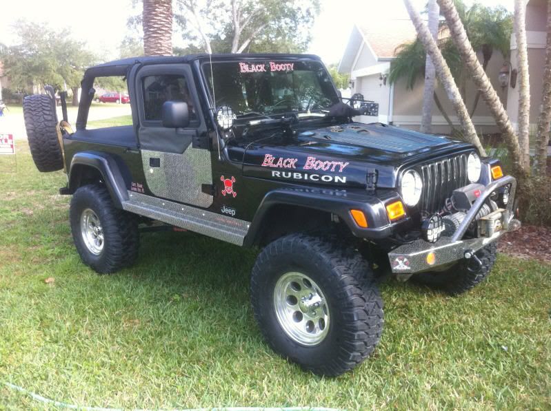

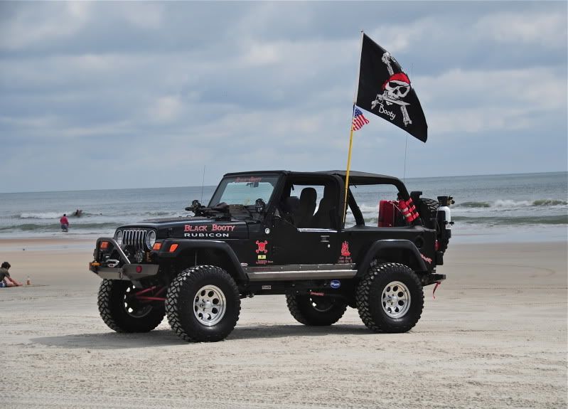

Nice looking Booty on the beach...... JEEP BEACH, NASA launch in the background....
Some of our club at Jeep Beach 2011....
********LOOK WHAT THE "BLACK BOOTY" WON **********

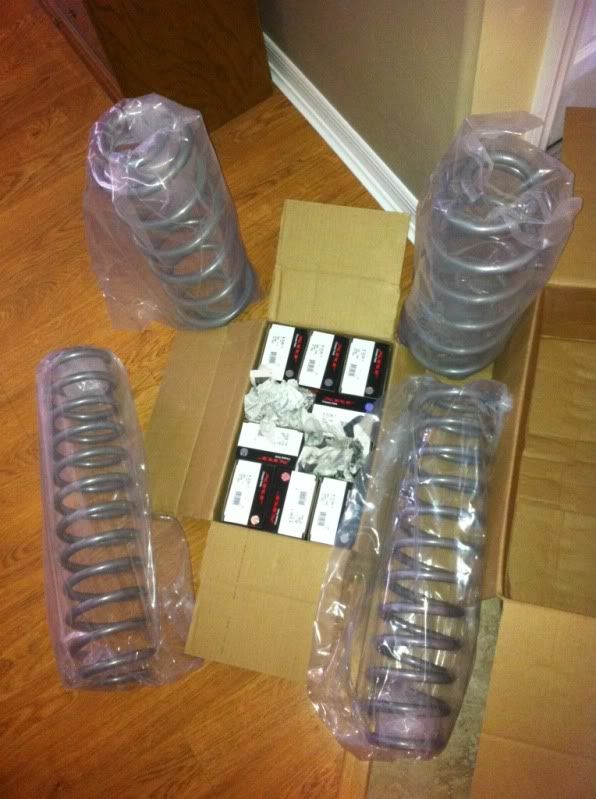

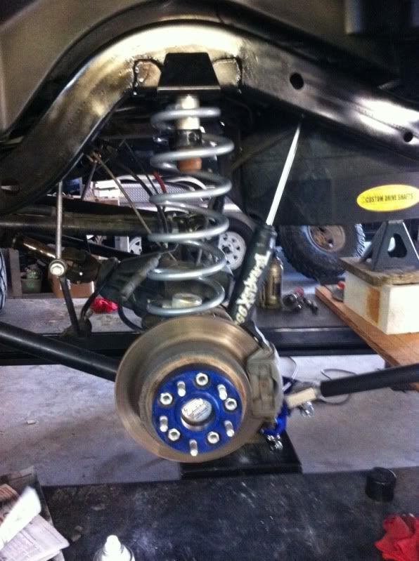

ok, i was feelin that my Teraflex springs were to comfy,soft, for me, so I ordered some new Rubicon Express 5.5" springs.....

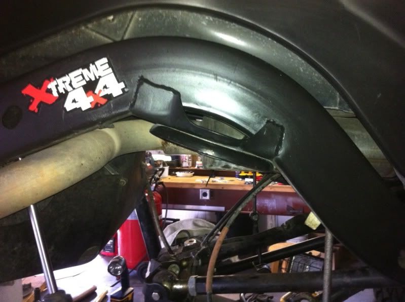

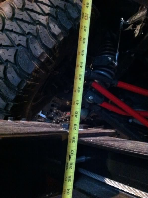

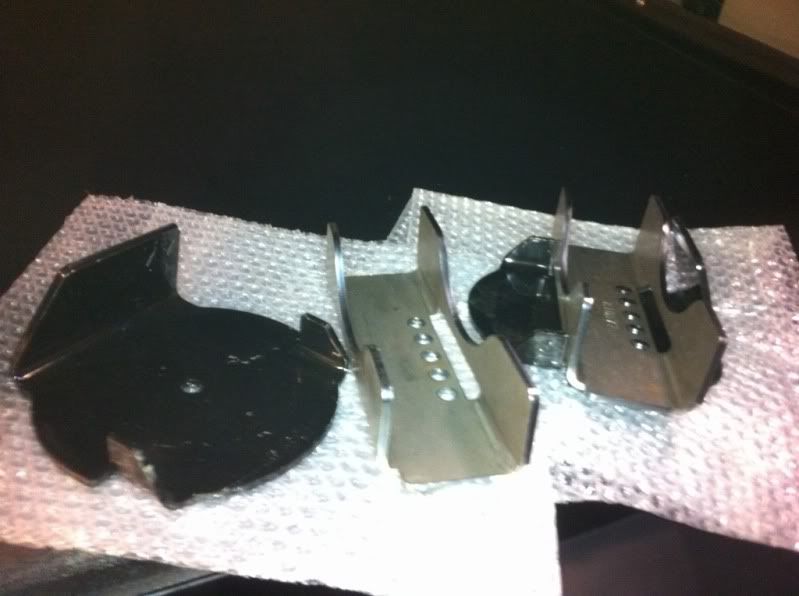

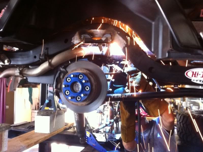

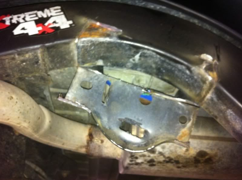

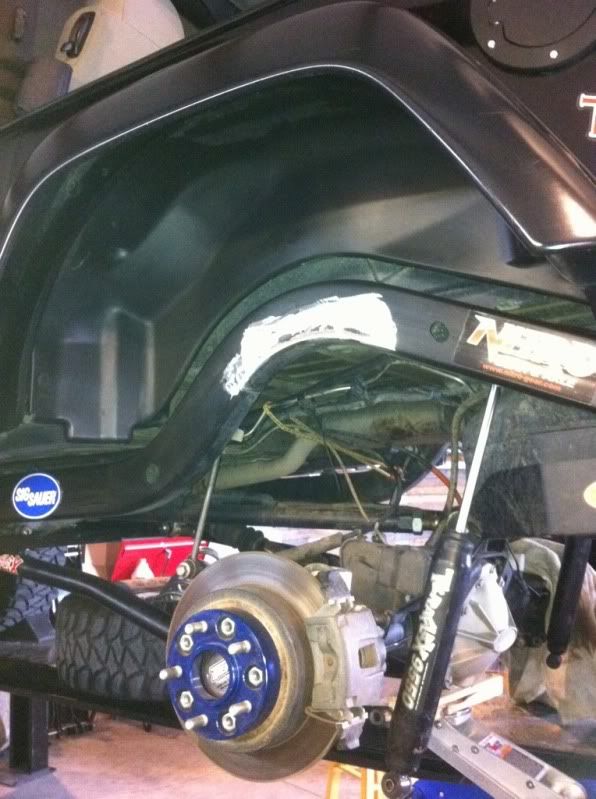

My GenRight rear spring mount re-locators came in. Their gonna get me prolly another 1" in height. I'm gonna need "high heels" to get up into the Booty pretty soon. I'll have to put my 1 1/4" spacers back up front to even out BB. I just hate a front sagging booty.

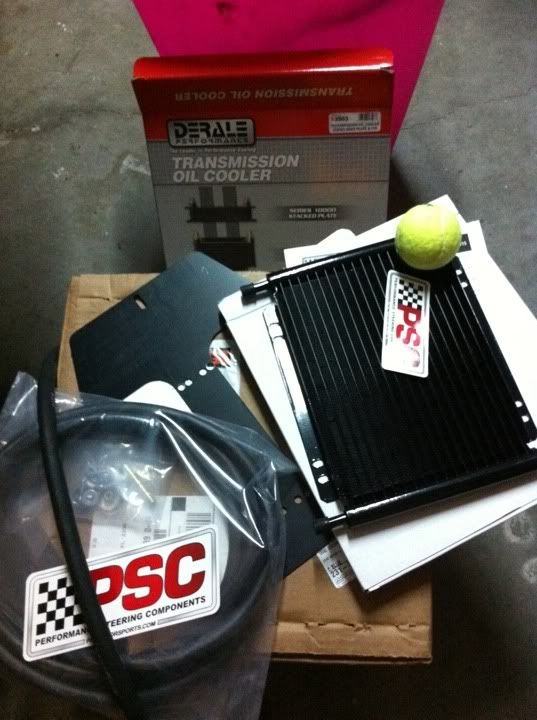

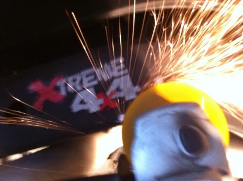

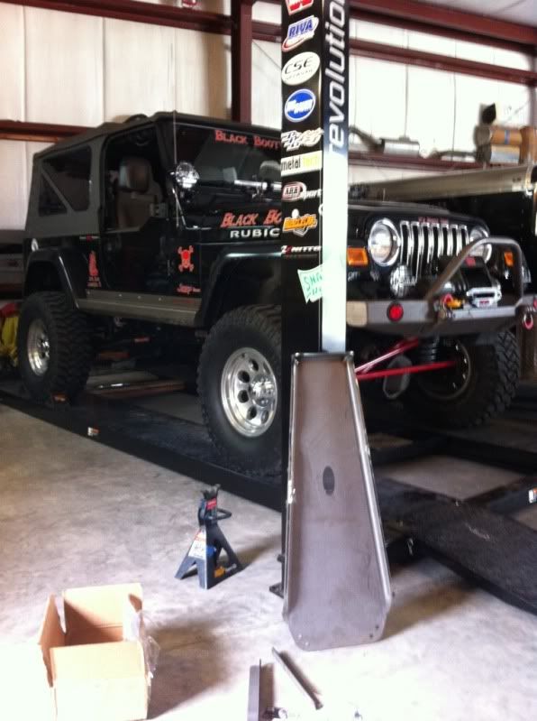

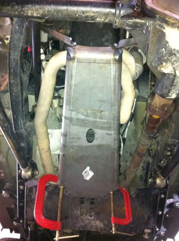

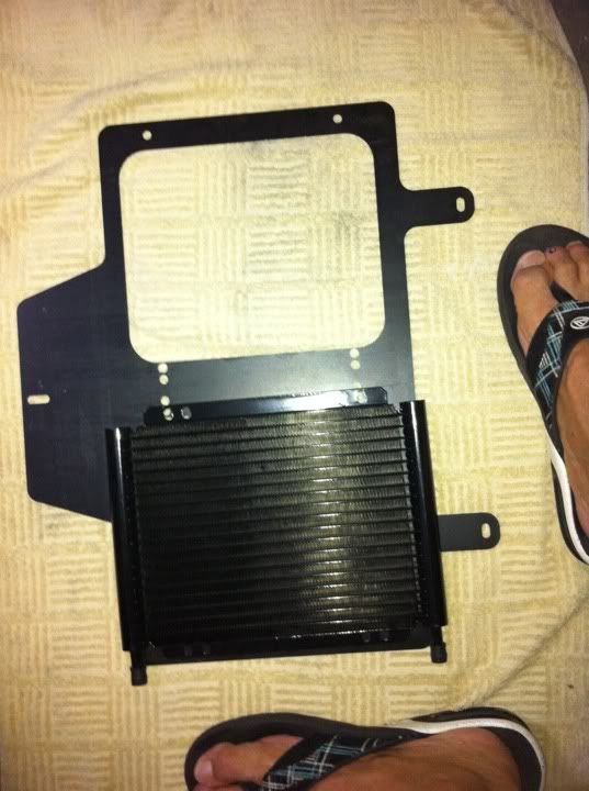

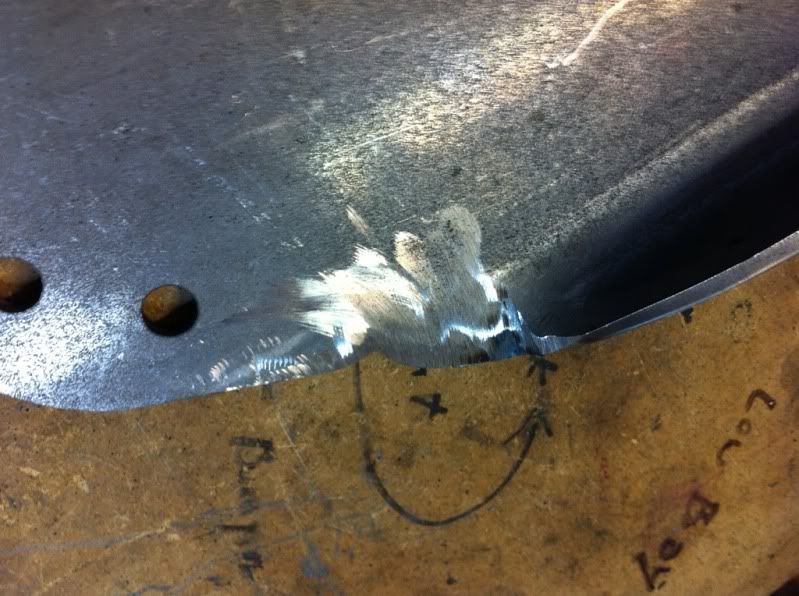

New skid finally came in, already dented my trans pan but got a new one in stock....
Installed trans pan plug for easy emptying, had to trim, grind, cut the skid to custom fit all...
also added trans and power steering coolers.....

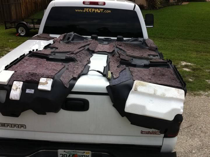

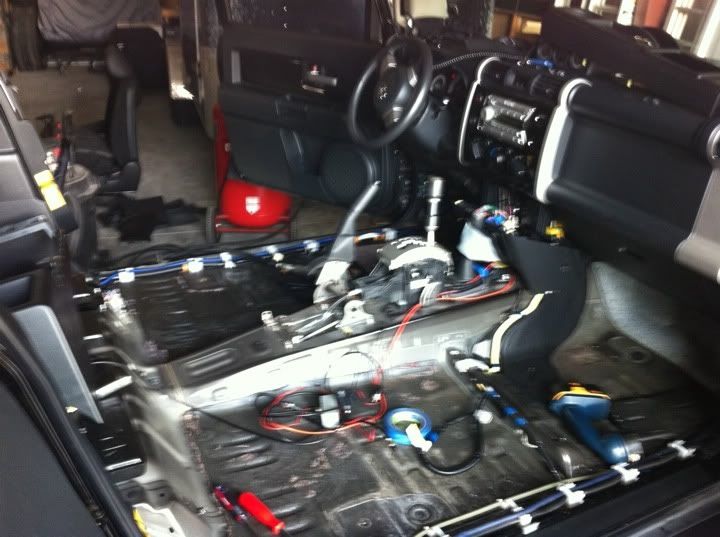

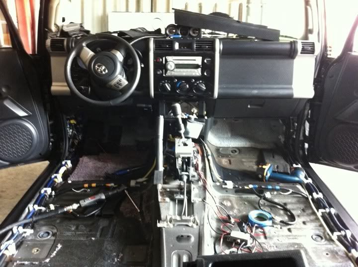

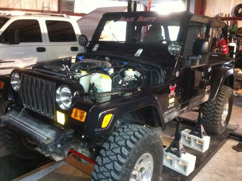

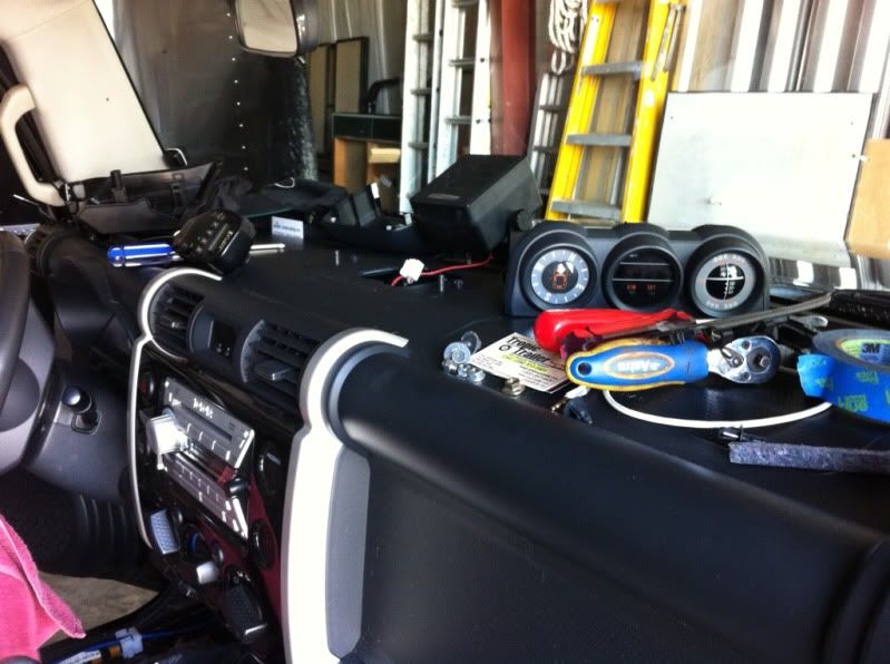

since the Booty was out of commission while installing stuff, I took the FJ out into the swamps and discovered a faulty floor plug that blew out and let in the swamp water...
drying out the carpet...
redoing some wires while the stuff is out....

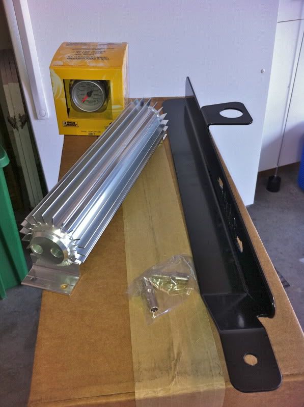

installing a radiator skid and an additional heat sink for trans fluid along with the temp gauge for trans fluid.

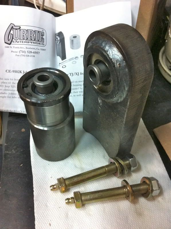

...along with the replacement Currie CE 9102K Johnny Joint which will replace the control arm bushing to help eliminate front end problems, one being death wobble.

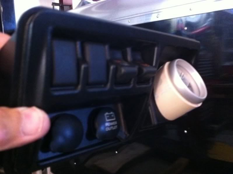

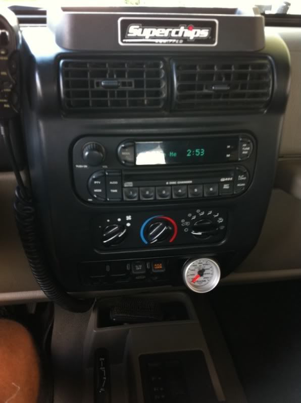

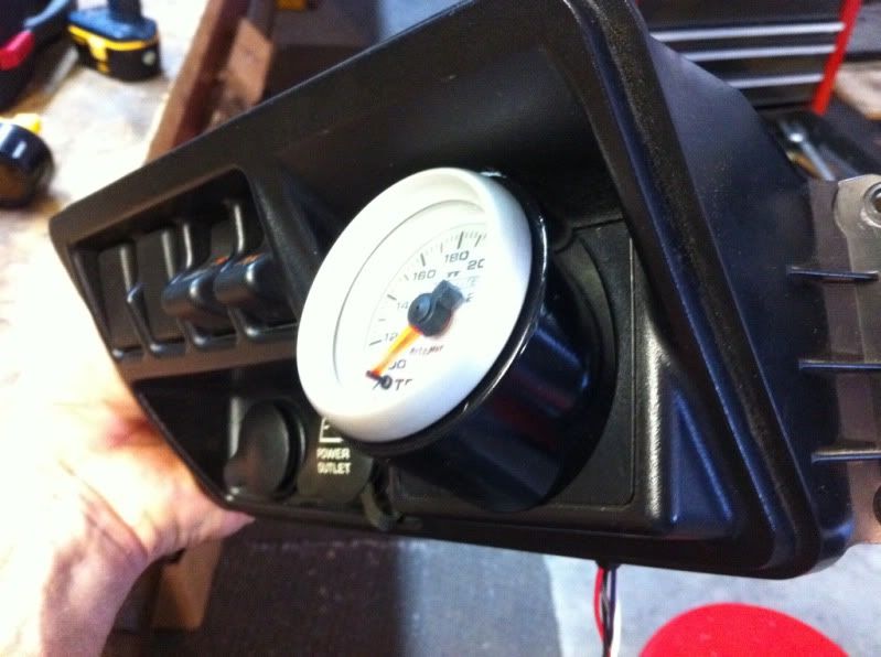

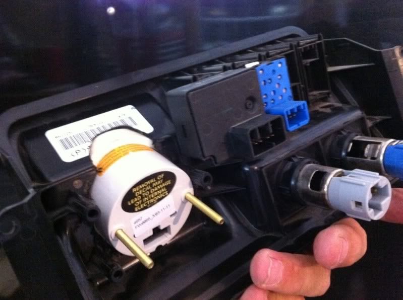

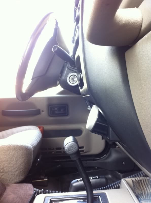

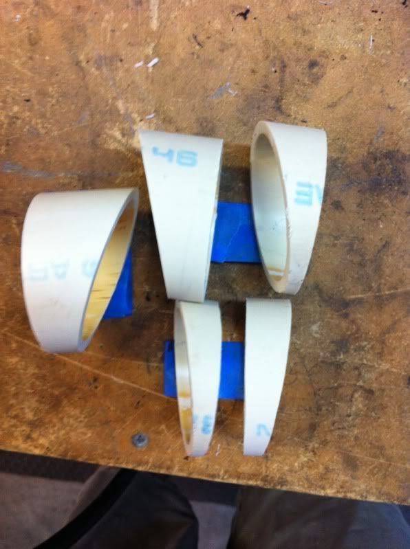

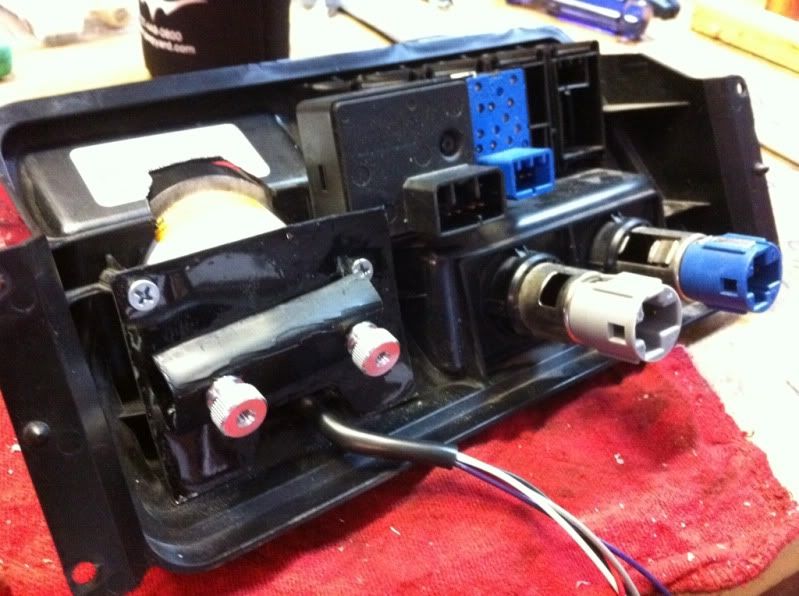

ok, the hard part is done! I got the trans temp gauge located and mounted, the rest is a piece of cake! (right?)
I wanted to locate the gauge somewhere I could glance at it and see the temp quickly but not have it stick out like a sore thumb. Going for that "stock" look. The blank plate next to the locker switch was plenty big and empty. BUT, it was at the wrong angle to actually see the top #'s on the gauge if mounted flush. So I started checking the web for options on mounting and all it seemed to offer were separate gauge pods that stuck up or out somewhere. If I was going for a racing look that might have worked. I came up with making angled spacers so that the gauge face would tilt out and upward for easy viewing. After making/trying 5 different spacers I got it to work as planned. pic's below......

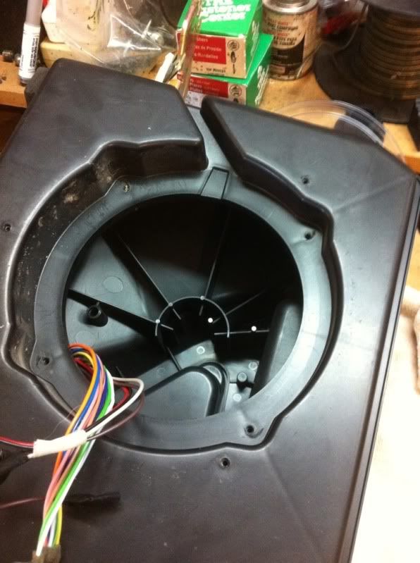

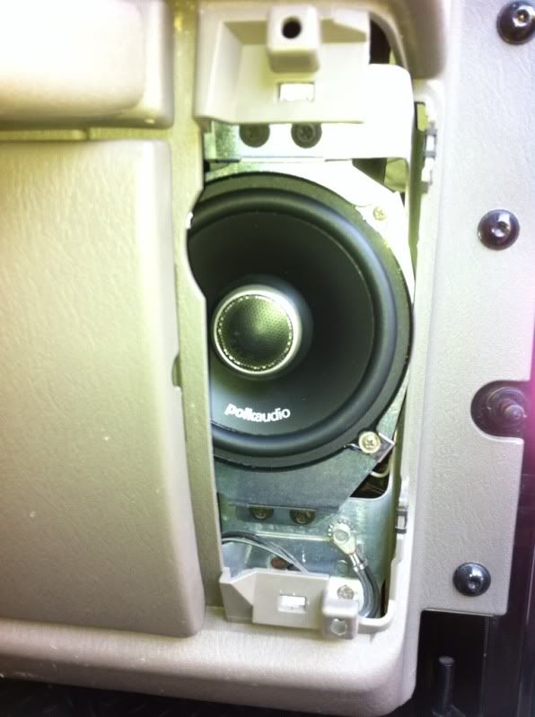

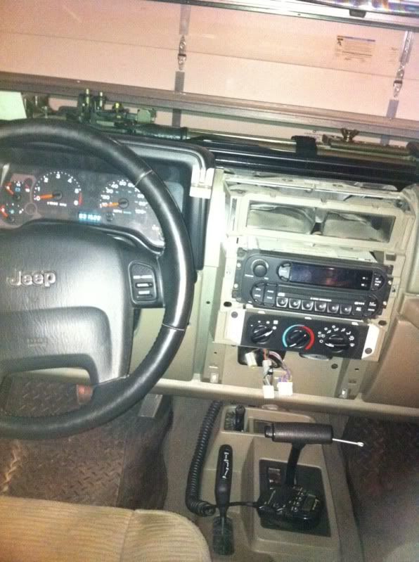

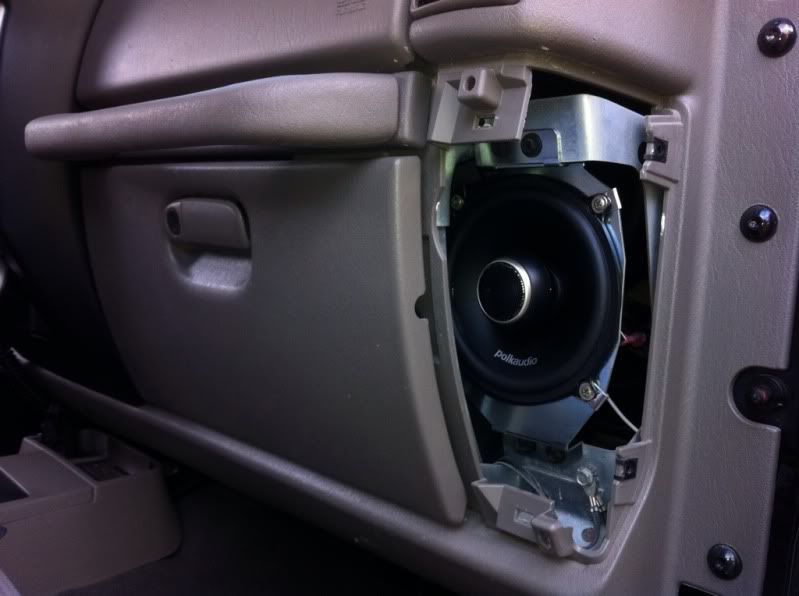

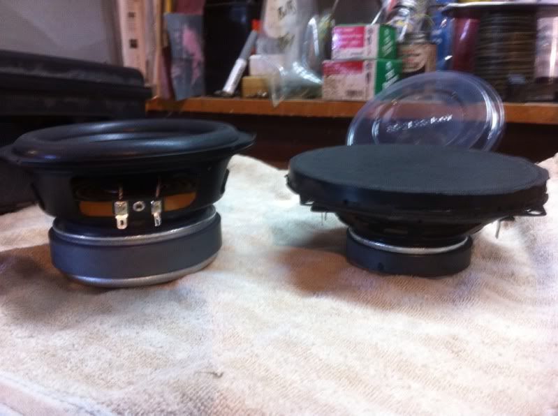

Woofer blew so I got a New Bazooka sub, on the left....
Just installed 4 Alpine DXi speakers to replace original speakers. 5.25" in the dash and 6.5" in the overhead sound bar

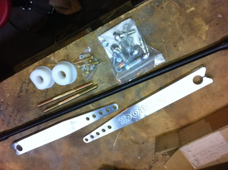

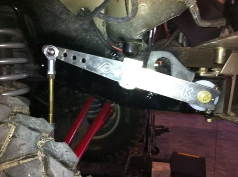

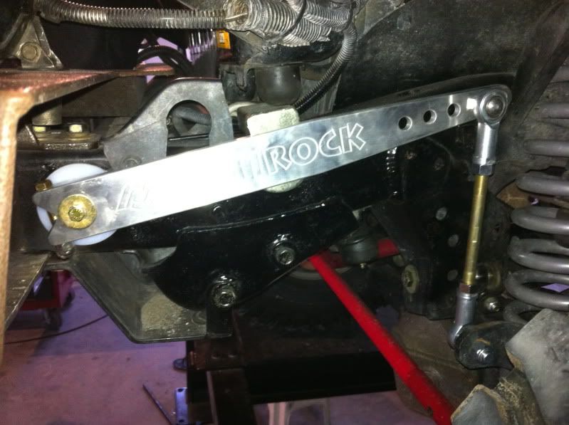

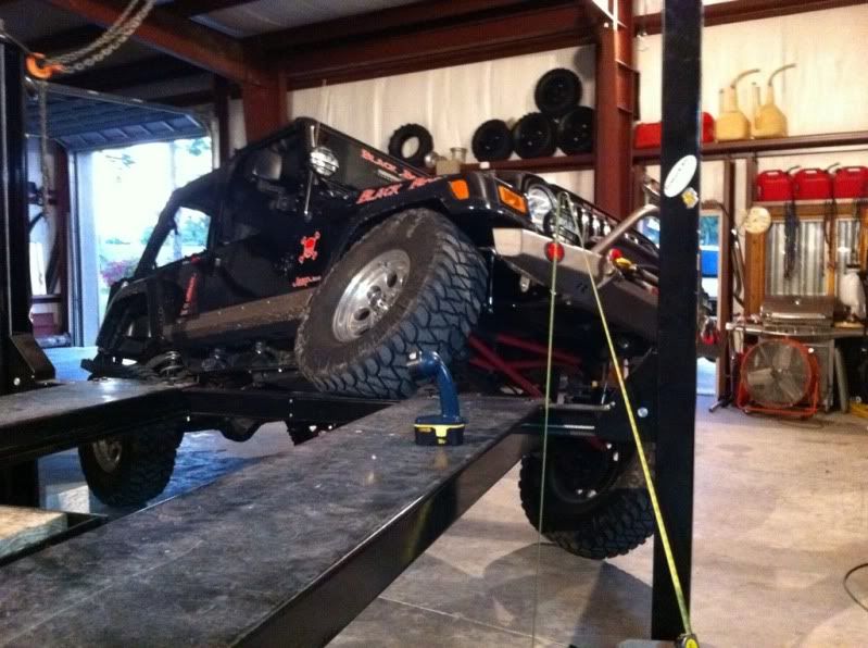

Just installed my Currie Anti-Rock sway bar....

WTF, I was never into stickers either, i don't like shirts with logo's/words on them, not sure what got into me with the Booty but alot of people love it. I wanted to do something different for jeep Beach 2010, and it went over real BIG. Stuck them on two dayz before Jeep Beach. Just riding down the road, watching the faces as people are reading the stickers then a giant smile and thumbs up follows. People want to take their picture with my Jeep. it's crazy!
