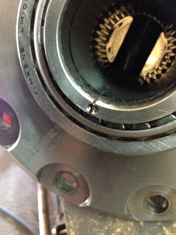

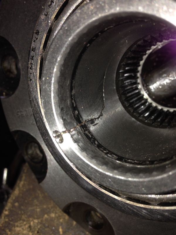

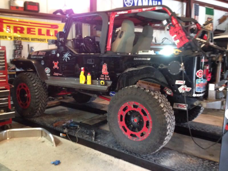

So from what I can remember since last posts in December I've done the following: I got my 3rd and final set of GenRight rear fenders at Jeep beach and they were perfect!! Also My front RCV Axle was delivered to me at Jeep Beach since the original one they sent me would not go in to the 35 spline ARB. The short axle on the driver side fit just fine, the passenger-side long Shaft would not go in. I sent back the long shaft to RCV for them to check it out the acid dipping and thinking there was too much coating on it and they returned it to me one week before Jeep Beach. Of course it still did not fit. So after talking to those guys I had them send me two brand-new un heat-treated uncoated axle shafts just to get me through Jeep Beach, it arrived at the hotel just in time. It took a little knocking of a big hammer to get it properly in the ARB but at least it worked. It held up for all of Jeep Beachs obstacles and trails until the end when my front ARB would no longer lock in, my compressor would just continually run so I knew there was a giant air leak somewhere. After getting home to my shop I was able to pull out that long shaft take off the diff cover and find the bad news. Got out my micrometer and checked all of the 35 spline axle shafts that I had. They were all identical and they all fit into the short shafts side but not the passenger side. Then I took a close look at the ARB locker once I removed it from the pumpkin and saw a nice crack in the outer housing where that shifts lights and two, which tells me something was to tight.
Now don't forget previous to Jeep Beach I installed ARB 35 spline Lockers with JK gears, size matters!
Also back to the Air leak, somehow something happened where my little copper airline inside the diff got completely chewed up into tiny little pieces and particles so it was time to ship the whole thing back to ARB and have them look at it and clean it up and determine why that part cracked. I also shipped back to RCV the one of the two long axle shafts for heat treating and oxidized coating for reinstallation. Everything has been returned to me from ARB and RCV in great new condition axle shaft slides in just fine. One of the guys at ARB said they have seen this happen before with the JK 35 spline ARB Lockers for some reason. Now waiting for my guru to come up and shim my gears so it might be another few weeks before I get that front axle back together and running. I've still been able to crawl to the mall and many other places and enjoy it.
dirtycruiser is offline

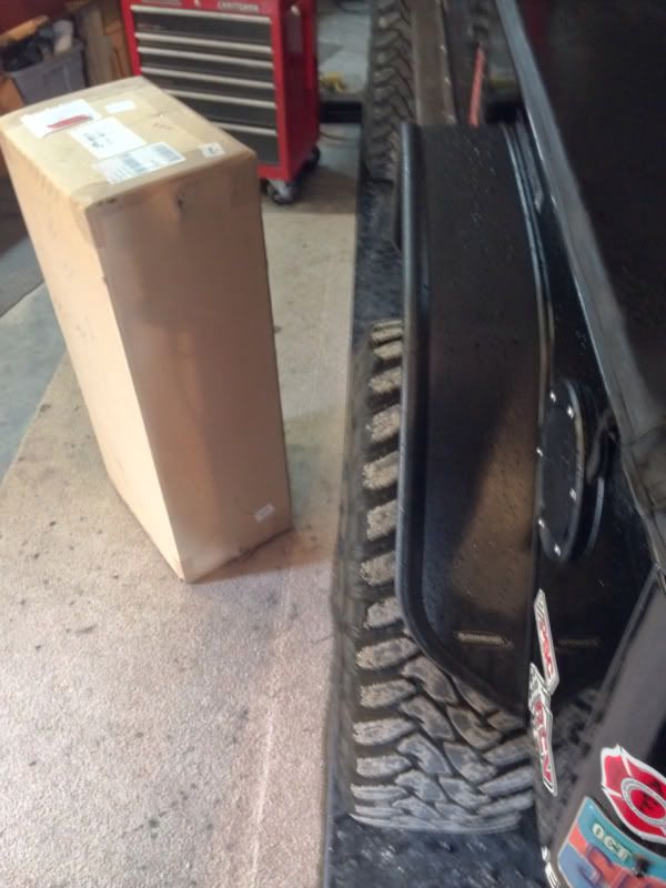

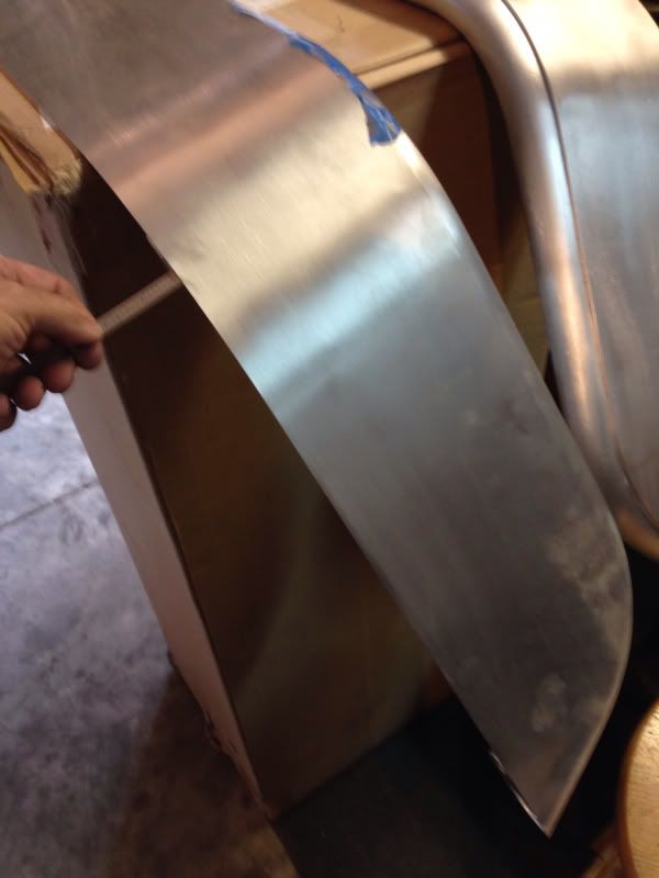

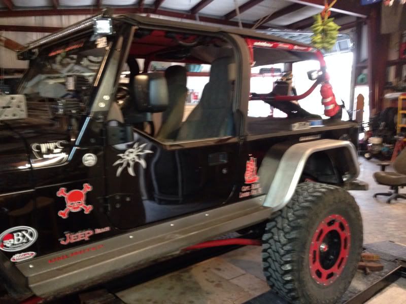

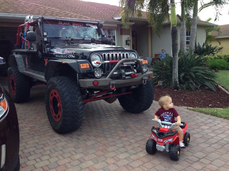

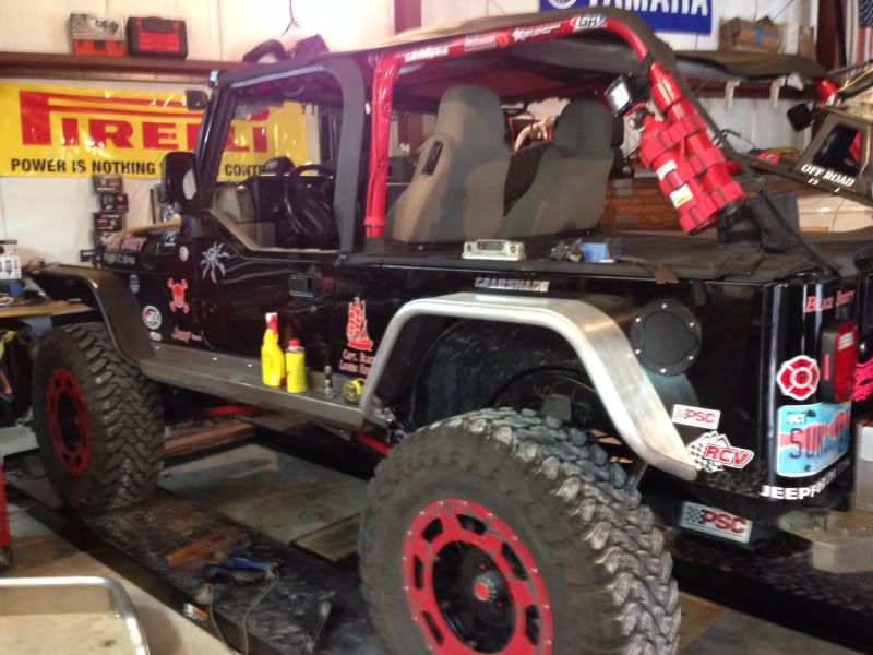

Now for the new Bling.......... GenRight front and rear 6" aluminum fenders along with a GenRight stubby bumper with hoop, all Aluminum. New hood hold downs and other metal stuff that slips my mind right now but their all powder coated and installed. I also did the inner fender liners and powder coated them the same. It probably took me about 12 hours a side to remove and rework all the stuff that was attached or to close for proper install of the inner fenders. Re routed some wires, removed others that hadn't been done when I installed the S-Pod and Led lights.
Touched up a lot of paint which could now be seen under the new parts.
Not painted black at the factory and it's gotta look good.
With the vented panels I can't have crap showing thru.
All of this had to be removed and reinstalled on the new fender liners.
What a pain in the a$$ that was.
Some Jeepers opt for leaving the stock inner fenders there and just cutting the tops of the existing fenders to fit the new stuff right on top, not me. It's well worth the time and cut fingers to make it look pretty and correct.
And no I did not pre-fit my parts before powder coating. All went well except a couple minor scratches on the inner liners which will be covered in sand most of the time anyway.
You can barely see the scratch in the pic below.
Turned out nice!
