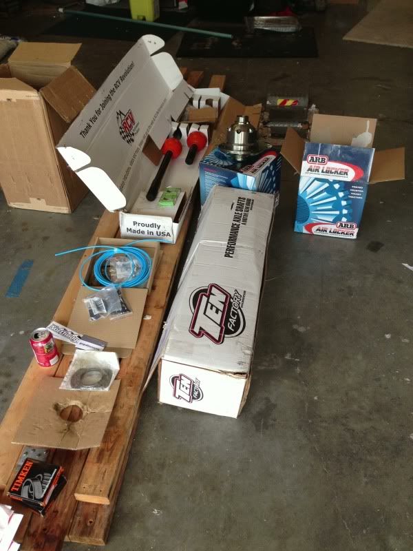

UPS to the Booty's rescue
New all 35 spline guts!!!
RCV fronts, alloy rears, and ARB air lockers front & rear.
This should hold my Booty together for a while !!

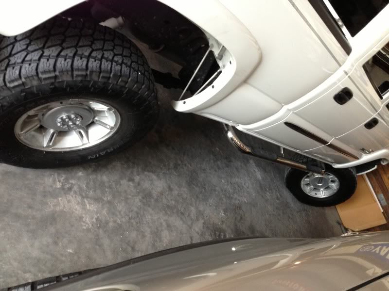

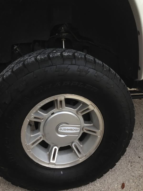

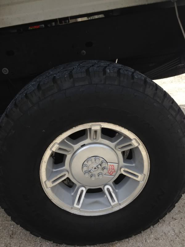

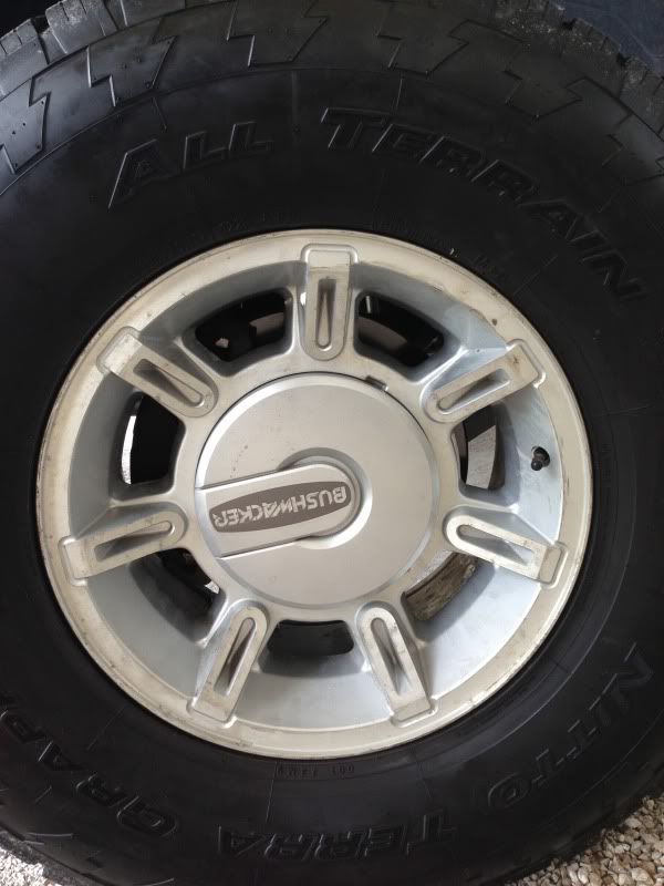

Updated my tow rig tires and wheels. Not looking to spend a lot on the tow rig, since the Booty needs the most attention. My existing 20" rims with 35" Toyo MT are getting worn a tad to much for the road trip up to Georgia for Jeep Fest towing my trailer and Booty. So having a set of 20" rims and a set of 17" TA 35" tires in the shop, the craigslist hunt was on for either a great deal on 20" tires or 17" rims.
I located a set of 5- 17" Hummer rims to fit my 8 lug axles. I did have to adapt the covers to fit. Saved $125 in cash not buying replacement GMC caps to fit. (More money for the Booty)
