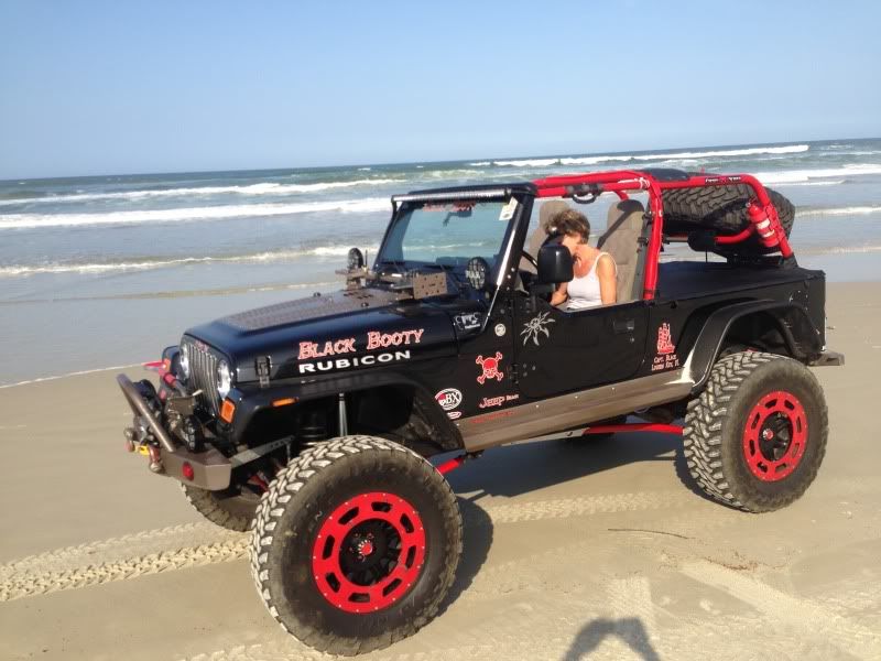

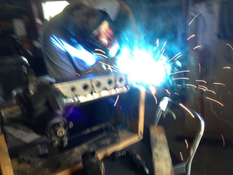

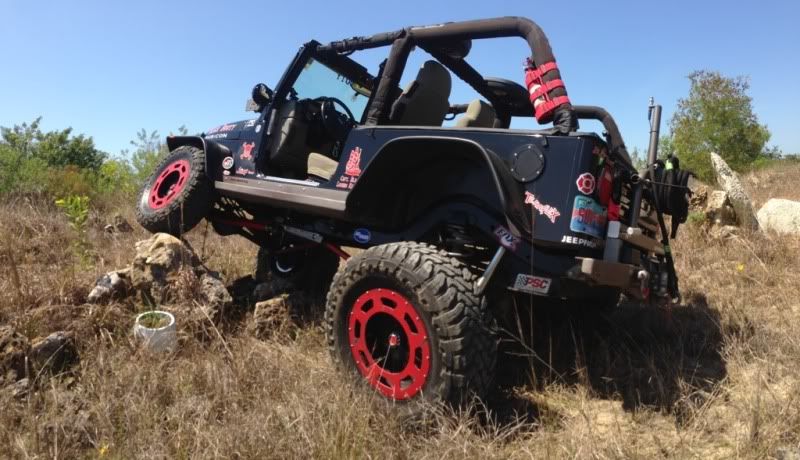

Here is a Jeep walker I built for a good jeeper friend who turned ??
This is his jeep:
2006 Rubi I found and advised a new Jeeper friend to buy after I surveyed it for him. Their moving from DE to Fl and wanted to enjoy the area by jeep.

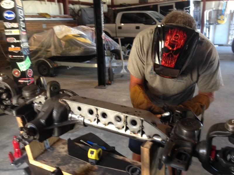

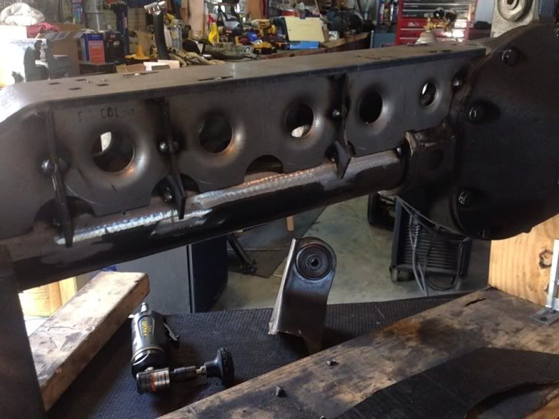

A truss we were installing on his Dana30

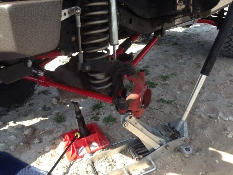

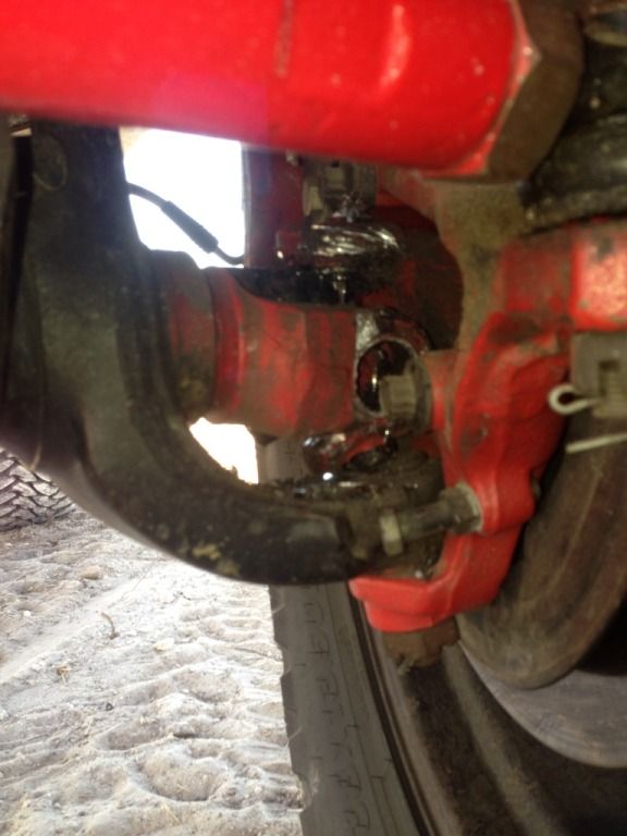

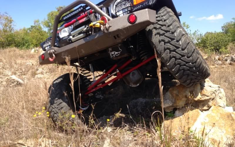

Bootys front axle u-joint letting loose

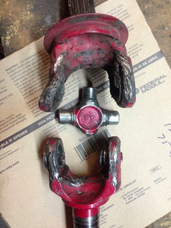

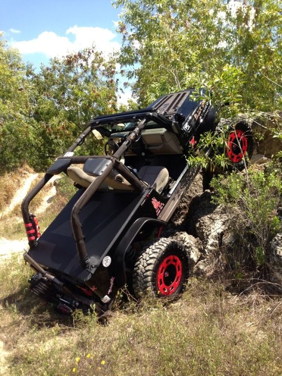

38" tires took its toll on my u-joint.cromolly axle ears took a beating from the u-joint when moving off of the rock pile to fix it.

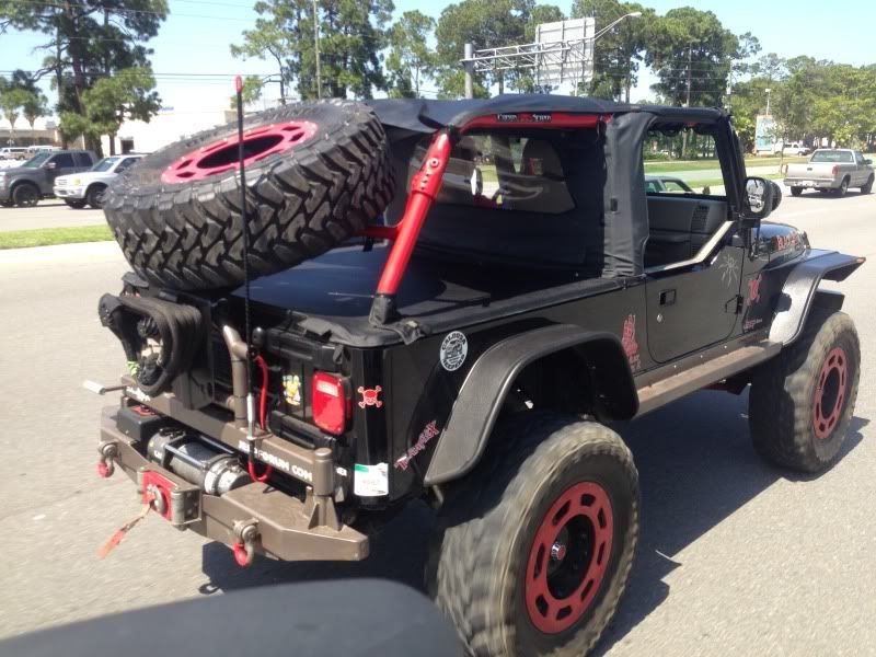

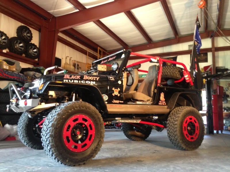

My new tire carrier I created.

Thanks, It did skim across those obstacles fairly easy now didn't it! I hate to say it but my spotter, not my usual one, steered me in the wrong direction right on to that giant boulder above. With the hydro assist pushing my wheels in the directions he kept telling me, it blew apart. My tires were wedged tight over that boulder that he directed me on to. But my ace spotter was there in front of me on his CB radio and I didn't listen to him which I should have. It's all in a days play of jeepin. I ended up buying a complete front axle( Dana44 rebuild kit) from the repair vendor there and we fixed it ourselves in a couple of hours. Teamwork !!!
A month previous I busted the other side u-joint at a local off road park. Which I just slipped the original Rubi Dana 44 axle back in once I got it back to my shop. Both of these axles were Force 10 chromolly shafts that the ears, where the U-joint ends slip into, also bent to make it impossible to reuse.

It was good to see upon inspecting the shafts once removed that there was no damage or twisting on the shaft or splines. I go rock krawling weekly, run 38" toyo ( heavy) tires with lots of other added weight that puts plenty of added stress on those axles. I have busted gears in both my front and rear stock air lockers to date. So it's looking like its time to buy a tank or a pair of Dana 60's with ARB lockers and 5.38 gears. Luckily my wife was with me when these went out this time. She agree's with the 60's addition.

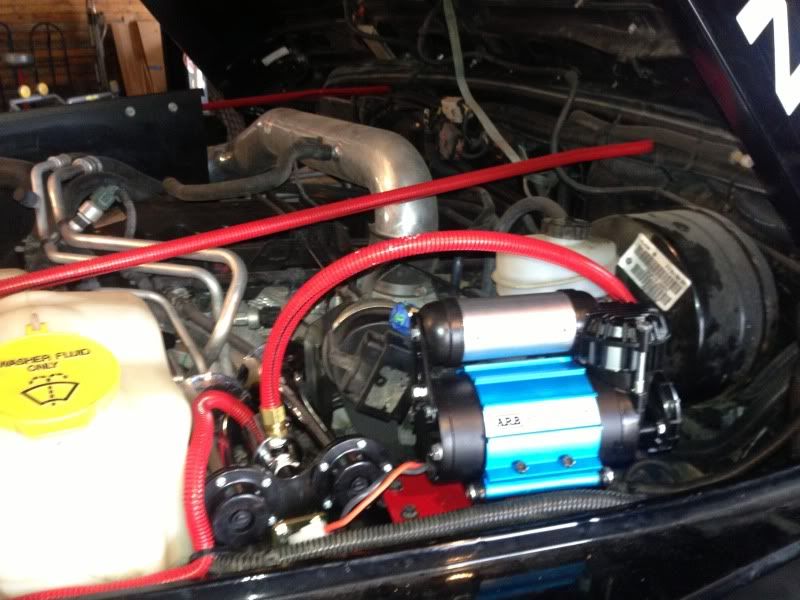

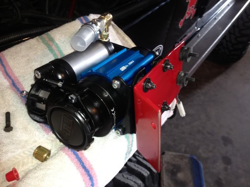

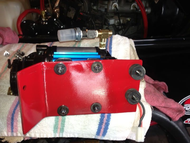

Installing my ARB compressor. Custom bracket made from leftover stock skid plate steel.

Would you happen to have more pictures and details of your tire carrier?
