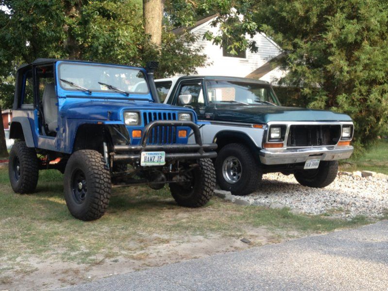

The Spring Under setup was originally 5" (1.5" shackles and 3.5" springs), and rough at best. The tub was cut to hell front and rear by the p.o. to "fit 35"s" but with that setup the cutting wasn't necessary. Once the Spring over was finished it was on the 3.5" springs and the stock boom shackles. The springs didn't settle and it was ridiculously tall which can be seen. I would honestly say spring over on the 3.5" springs it was probably 8" of lift total or so (I could have easily fit 37's 38's etc etc). I swapped my 3.5" springs for stock springs with a buddy of mine, and the lift height is probably 4". If anything it is maybe 1/2" higher than when it was spring under? The spring perches that were originally fabbed were a little tall, so to reduce the ridiculous height that the 3.5" springs gave me, the perches were redone which took about 1" out. The stock springs settled a lot better and are a lot softer than the 3.5" springs. I am about to switch back to 35"s and I don't think I am going to have any problem fitting them. When I get off work this afternoon I'll take some measurements for ya and post em up! I couldn't be happier with the spring over setup, hands down my favorite mod.
Spring Under with 1.5" shackles, 3.5" springs and 35x12.50 A/t's
Same Suspension set up on 33x10.50 KM2's
Spring Under 3.5" springs, stock boomerang shackles, 33"s
Spring Over on 3.5" springs and 33"s next to my cousin's 78 Bronco
And finally on stock springs, over axle, 33"s
Hope that helps for now!

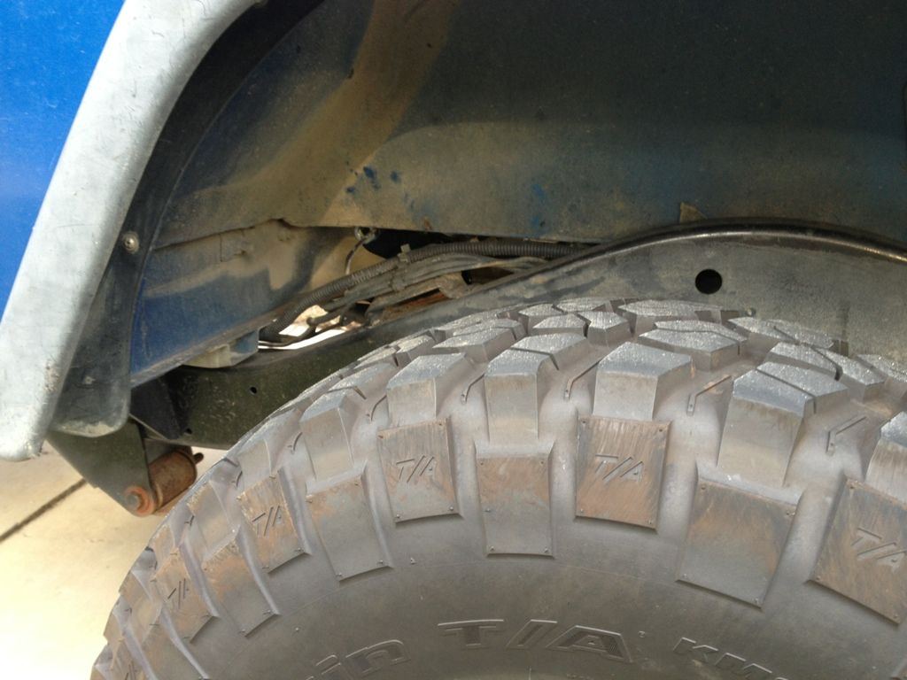

@zte87 Here are pictures and measurements for ya! For starters my KM2's measure out at 31.5" tall with the jeeps weight on them.
Here is from the concrete to the bottom of the tub, 26.5"
Concrete to the bottom of the frame, 22"
Concrete to the bottom of the skid, can't see the bottom of the tape measure, but it's right at 18"
Bottom of the tube bumper, 26"
Bottom of the shackle, 21"
Wheel well clearance, a lot, these measurements are ROUGH. Tire to plastic inner flare 7" or so depending on location, tire to tub, 10"
Hope that helps bud, thanks for reading!
