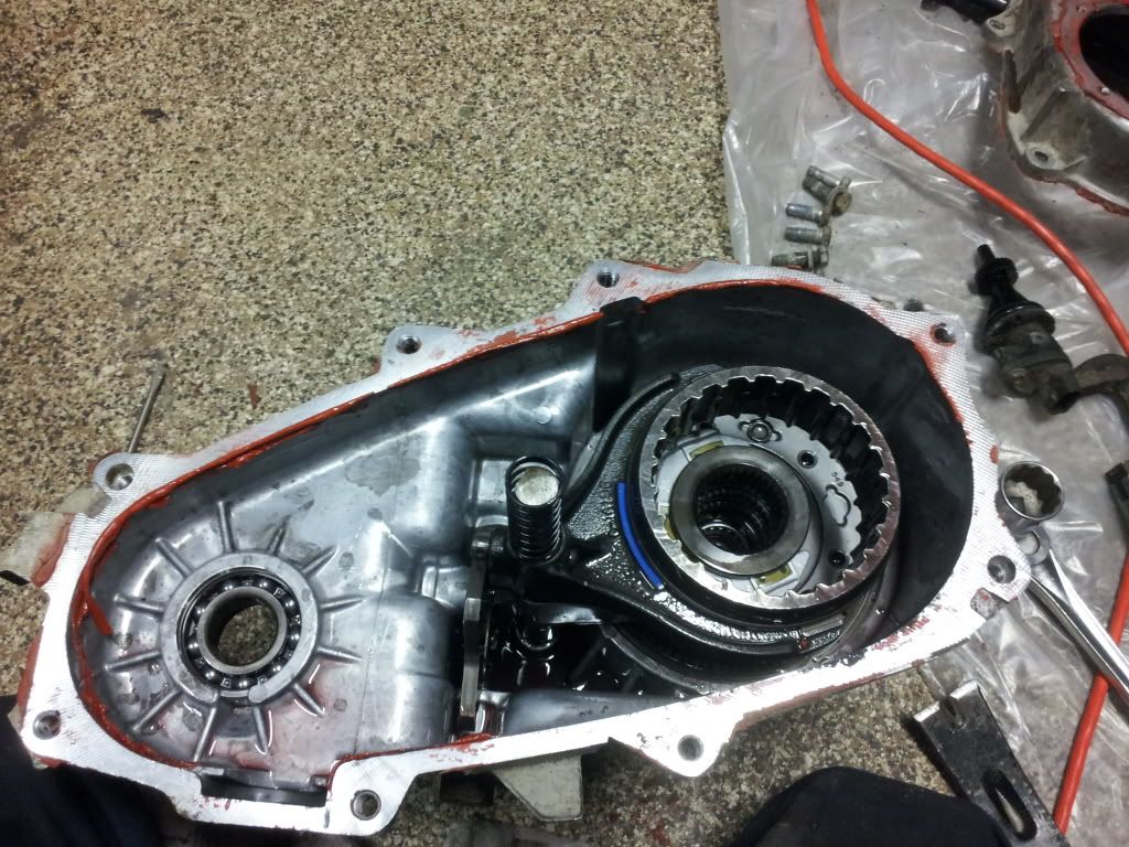

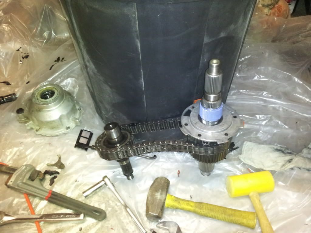

i didnt sleep well at all last night thinking about the tcase. i got up early this morning and got a call, guy came and bought my old ax5! i was happy to get it out of the garage. then i pulled the tcase back off and ripped it apart again. the set it aside and took apart my old np231 21 spline. i sawpped the 23 spline input bearing assemble into my old one and re assemnbled it. shifts like a total champ and i bolted it back up. now im gonna keep an eye out on cl for a few junk np231's as scavenge enough parts to fix the one i have for a spare. that would make a complete spre drive train! but in was a pita to do it all but its back together and i can sleep well tonight! heres some pics from yesterday.

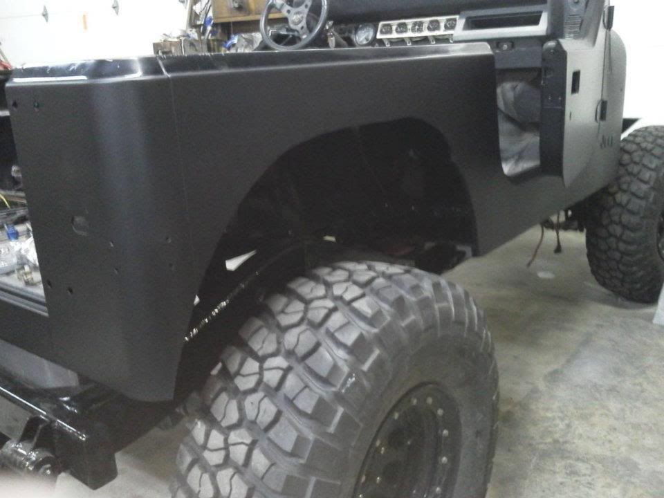

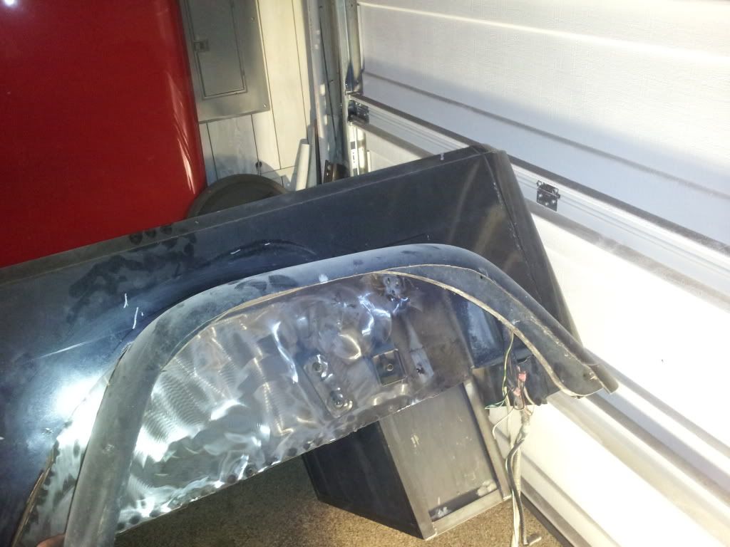

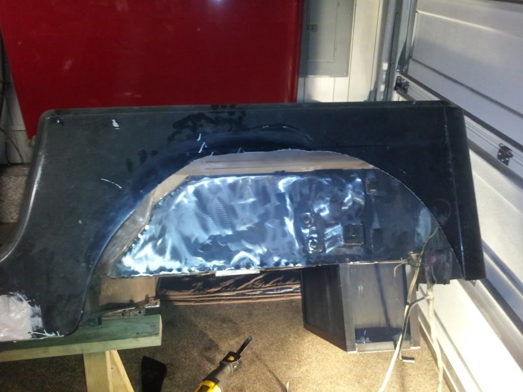

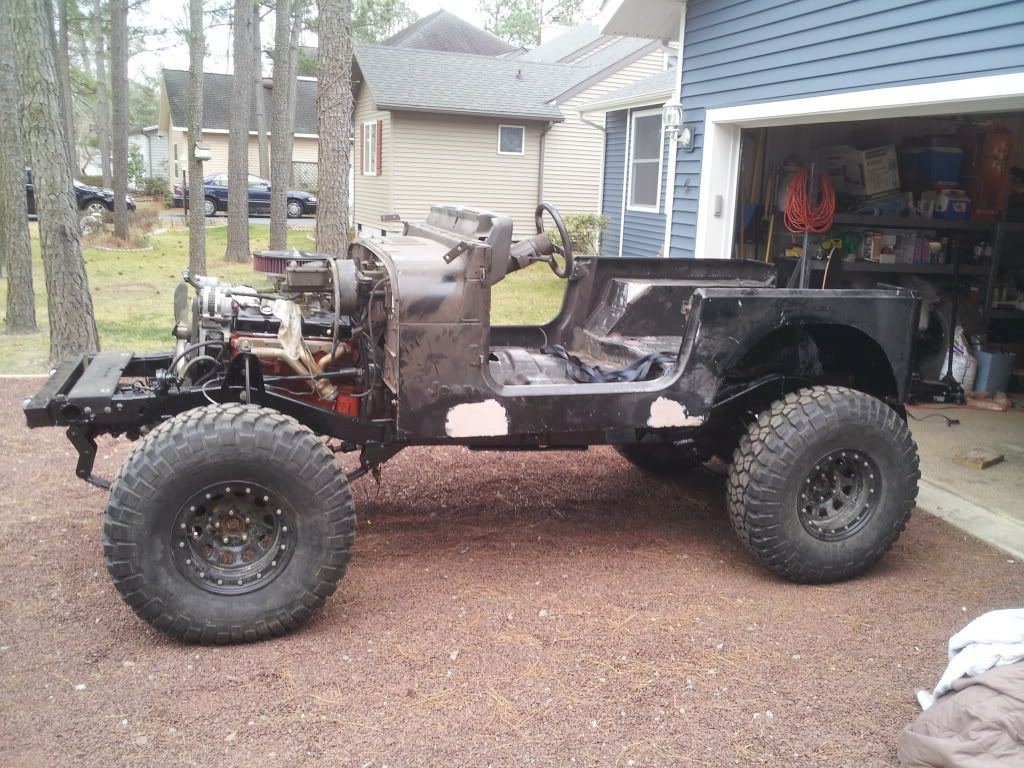

well today i decided to work on the jeep for a while. attempted to drill the holes for led tail lights and some how my new hole saw dulled out before it cut one hole!! i was pissed to i grabbed the sawzaw and hacked out the tub to compensate for the stretch. i will have genrights full stretch corner armor so it will look alot better when its done. but heres some pics.[IMG][/IMG] [IMG][/IMG] [IMG][/IMG]i also slapped some body filler in where i replaced the metal. so far so good, i did decide to go with john deer blitz black paint. easy durable, looks damn good and if i scratch it, they make spray cans as well and tough it right up.. i hope to get the chassis saver and monstaliner on the underside this weekend but well see.

Well when cutting steel with a hole bit it suppose to turn at like 500rpms or you could use a rotozip with a radius jig. Just my .02

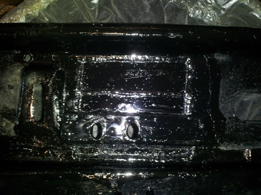

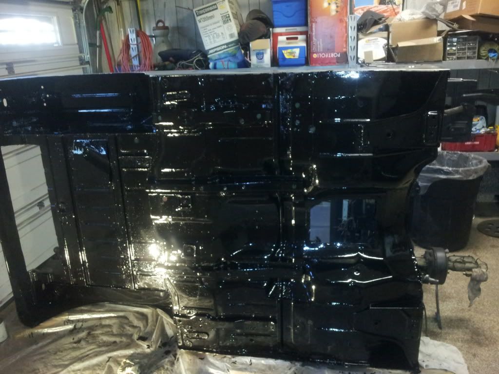

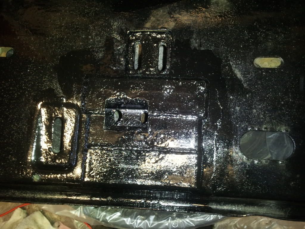

thanks griff, im gonna buy another bit and try again i guess. i painted the boddom of the tub with cs. hers the first coat. gonna let it dry an put a second on then monsta liner over it, which is gonna be a pita.. but hopefully im mating the tub to frame monday or so

got the second coat on. i also decided to not use monstaliner on the underside. it gets its texture by rolling it and it would not roll easy so im not gonna use it. i think the cs is good enough. so if any one wants a 1gal kit let me know cause it will be left over. so tomarrow ill most likely mate the tub to the frame and start as much reassembly as i can before paint. its gonna get sprayed next weekend and then its rea assembly time!

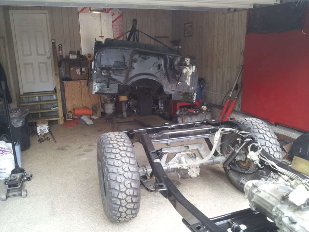

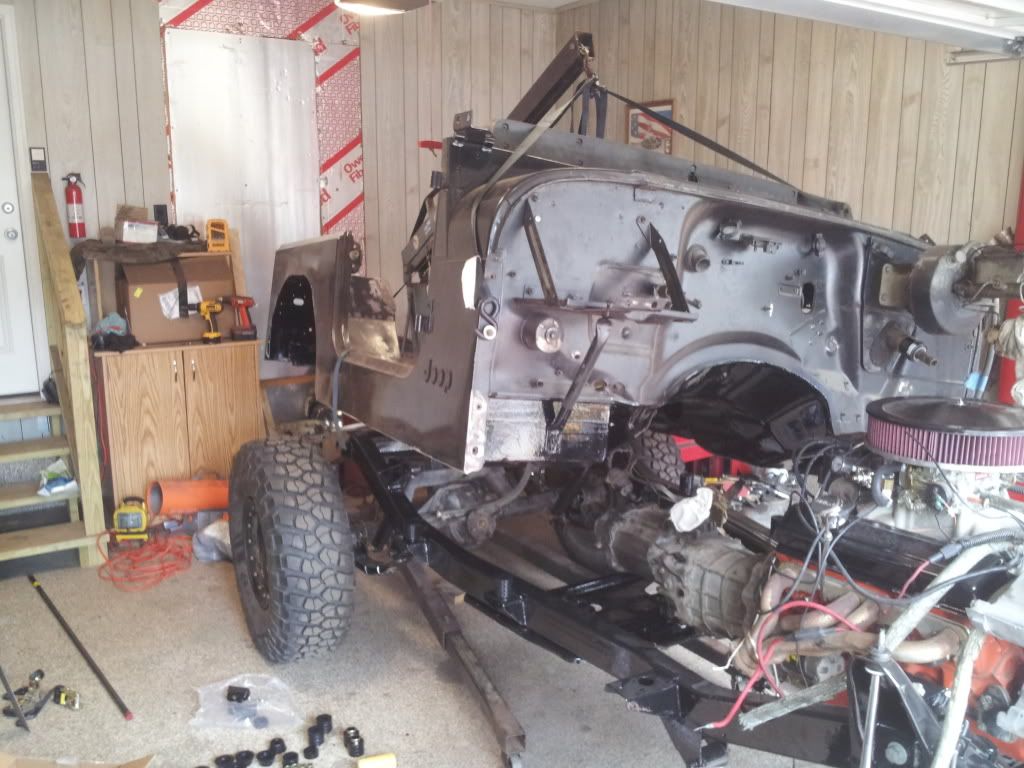

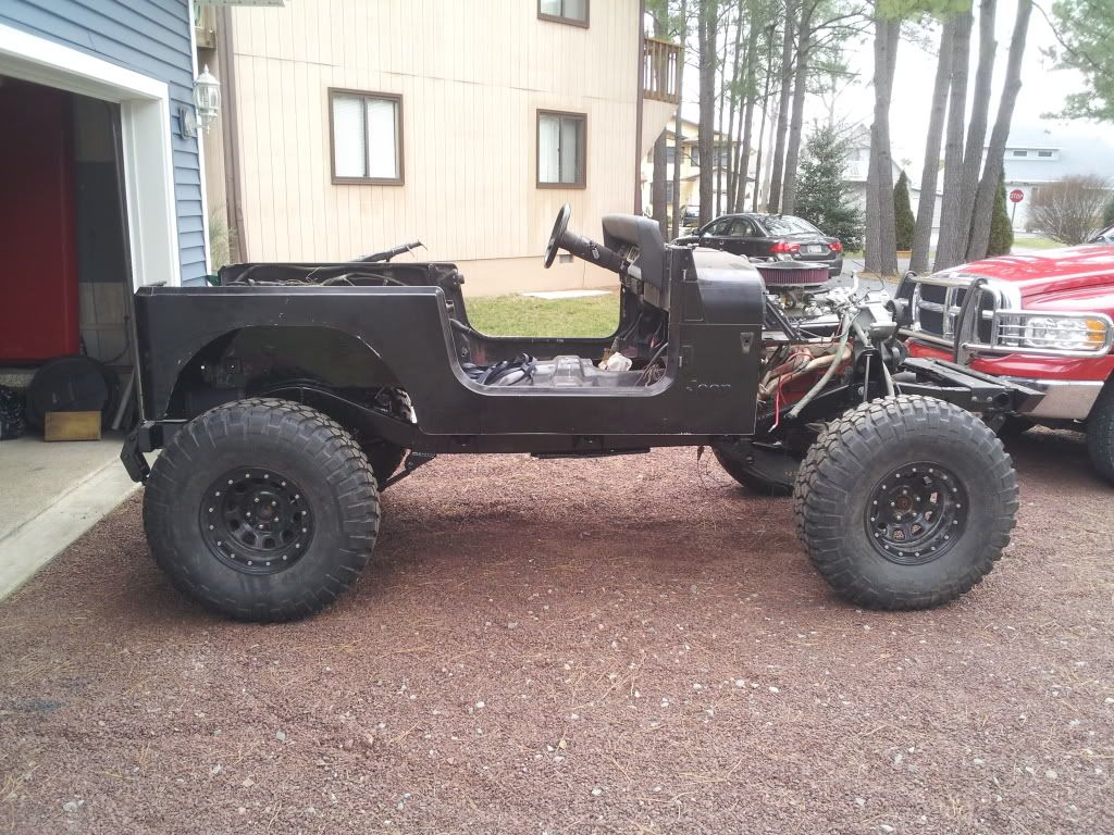

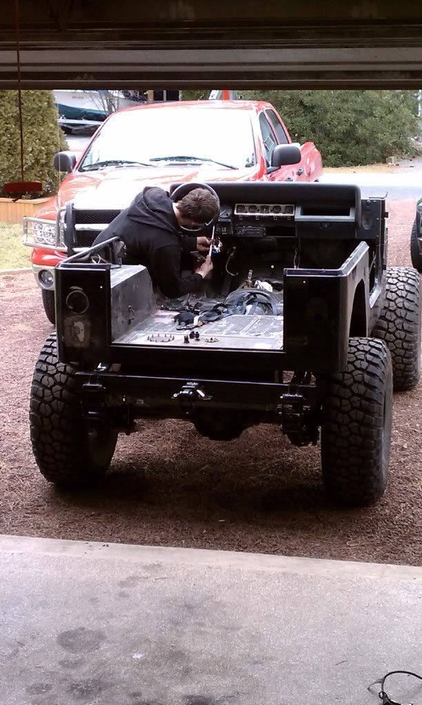

well i got up bright and early and barrowed mosesyj's engine hoist. i got the tub on the frame by my self. no one was around to help so i staped it up. lifted it, pushed the frame into the garage underneith and adjusted and got it all snugged up and bolted down. it went pretts smooth, i started plumbing in things, heater core hoses ect. hacked a bit more out of the body to clear the tires at full flex. im stoked its definatley looking good thats for sure. i cant wait to paint it and start the cage! i also had to fab up some crush sleeves for the day star body lift that didnt come with it, i just used 1/2 black pipe, or gas pipe and cut it to size and used washers. it worked great
the gf took a pic of me pulling the steering colum to get the steering shaft back in. i have more pics waitin for them to come through

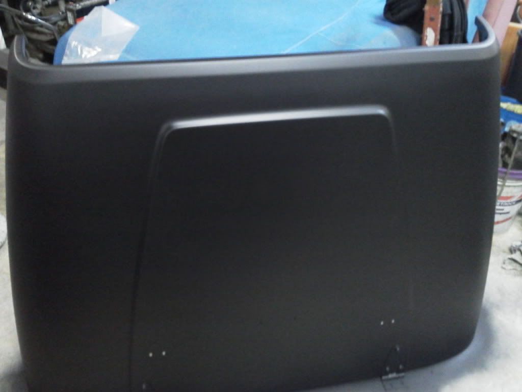

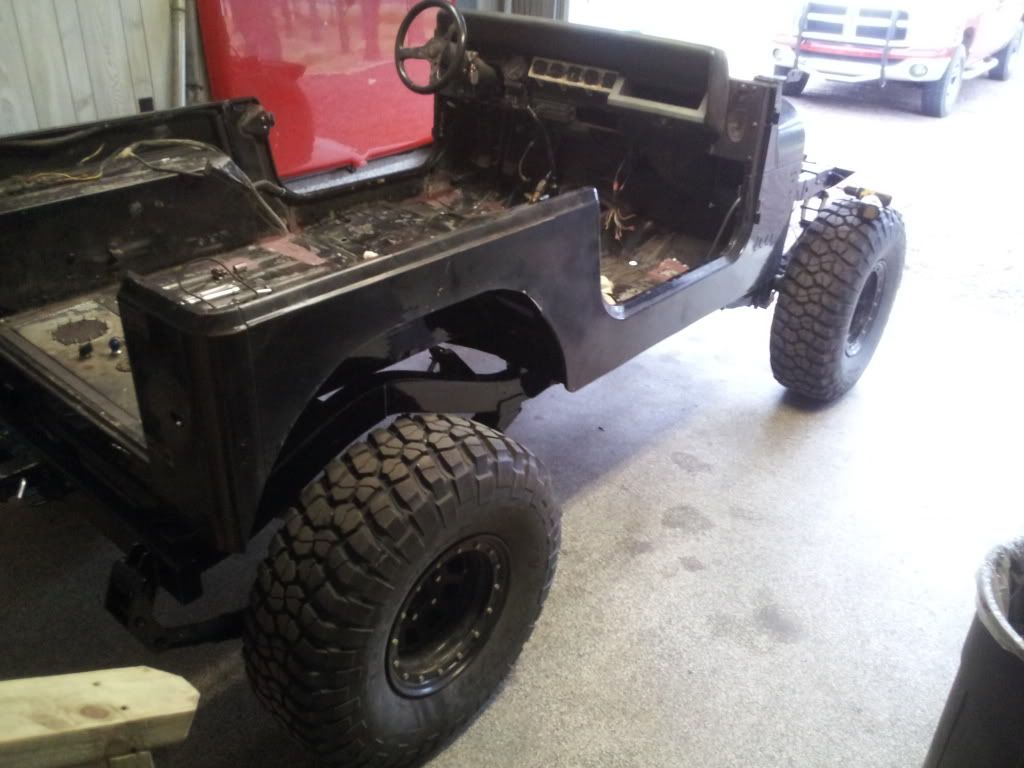

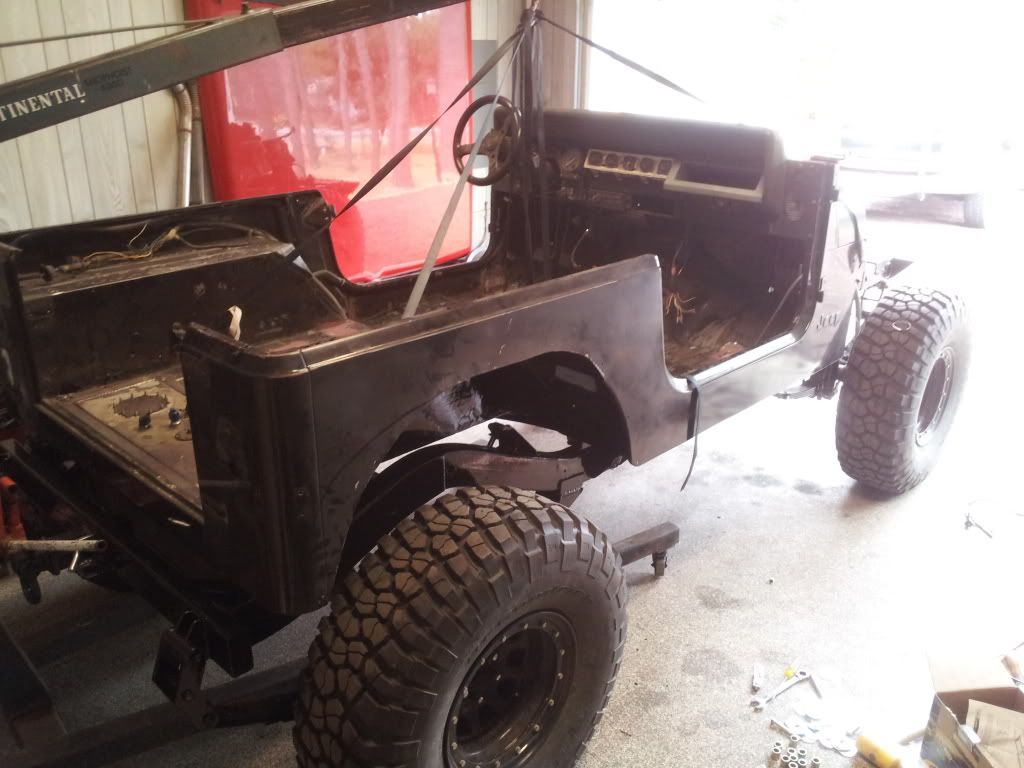

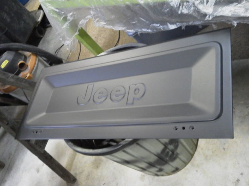

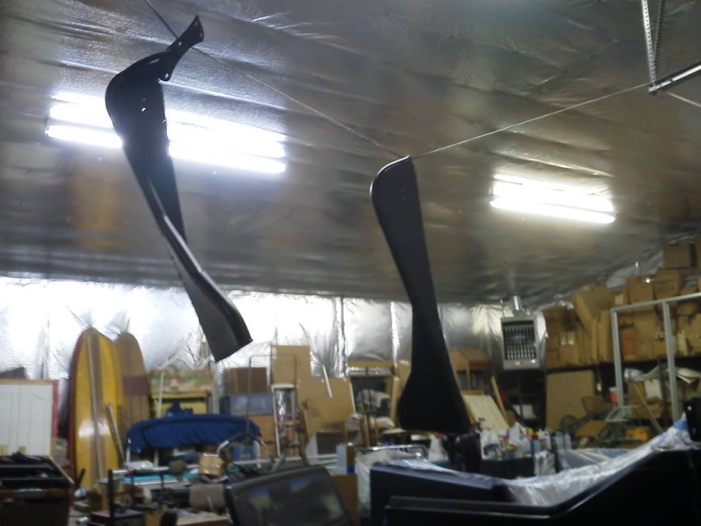

here are some pics i snapped after i believe coat #2, the color is john deere blitz black for all that are wondering
tube fenders hanging from ceiling

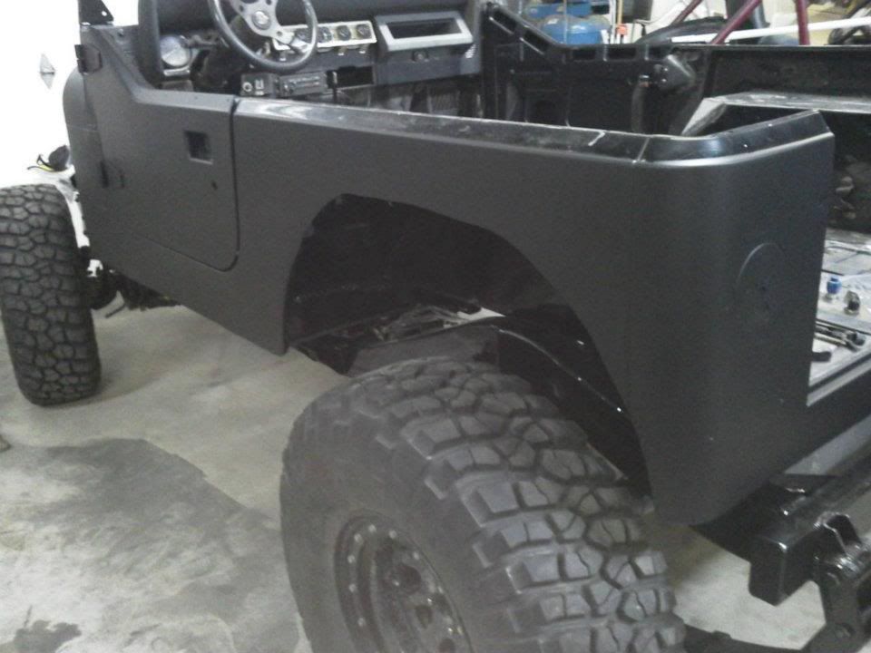

Posts: 609

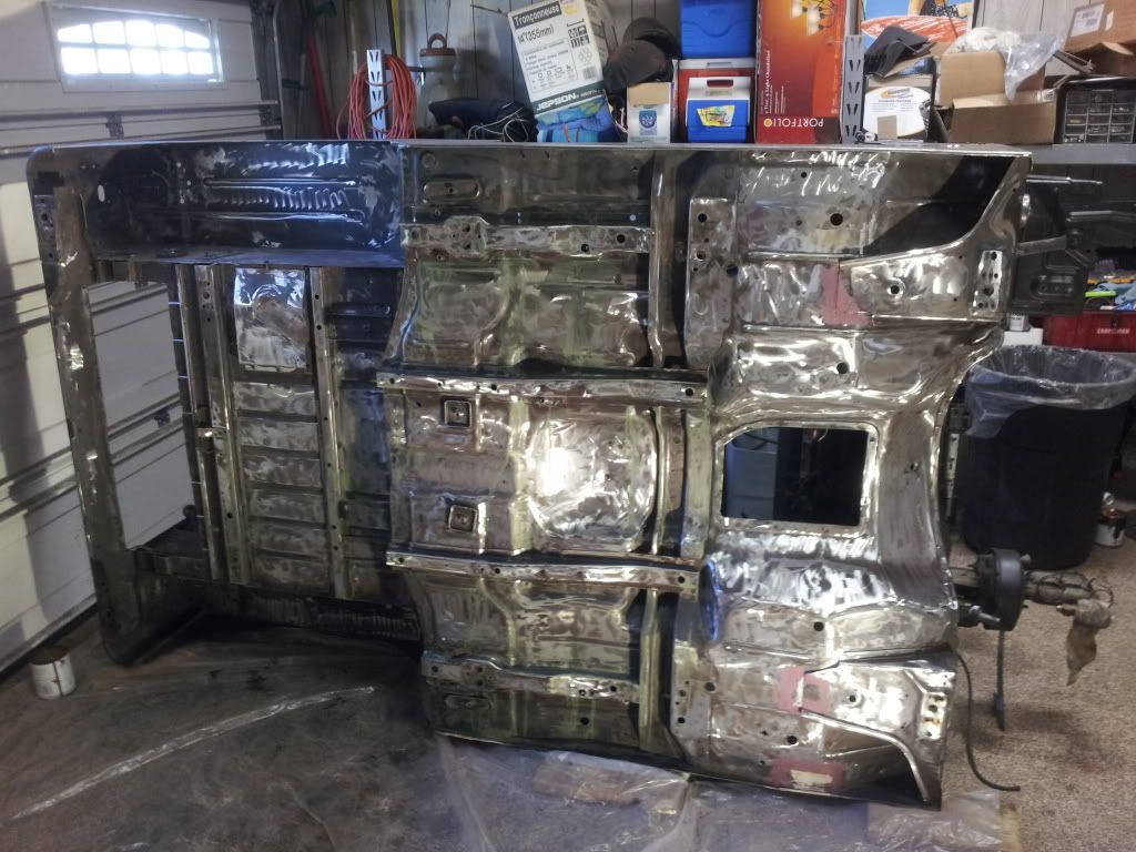

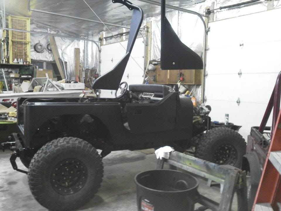

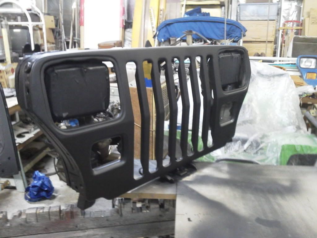

a big thanks to mosesyj! i really appreciate your help with the paint bro!! i havent posted in a while, ive been so buisy getting this beast ready. a few days late as ***** and its finally painted and ready to come home tomarrow. then its time for cs and ml on the inside of the tub. it looks amazing flat black, im gonna paint the jeep logos on the tailgate and the tub orange and all the other peices gloss black. "and my gf forgets what i look like" < she typed that.. but its a few things to buy and alot of hrs left to finish but its way farther than i ever expected to be at this point, complete rebuild in 4 months and change so far, hoping its done before april. and thats counting a trip to fl and indiana! well see. im waiting on door seals and lock cylinder gaskets, i removed the door panels, latches locks ect to do the job the right way.. heres a few pics
[IMG][/IMG]
[IMG][/IMG]
[IMG][/IMG]
[IMG][/IMG]

well today i got the clutch bled and it works like a champ. also painted most of the bolts/ misc parts. also installed the grill and radiator. gonna continue through out the week, cage stuff will be here wednesday so ill start getting that together and then be able to cs and ml the interior. its moving along nicely
