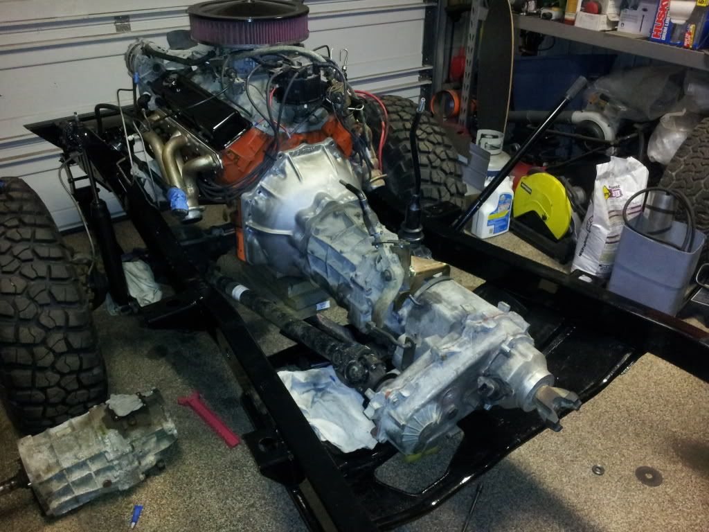

well i guess the pilot bushing got smaller some how when i tapped it into the crank. i removed it machined it out a tiny bit and the trans slid in like a champ. the jeep now has a complete drive train. i will be working on drilling holes it the skid to bolt the mount and torque arm to today. also im gonna go to napa and see about etting a hydraulic hose made.[IMG][/IMG]

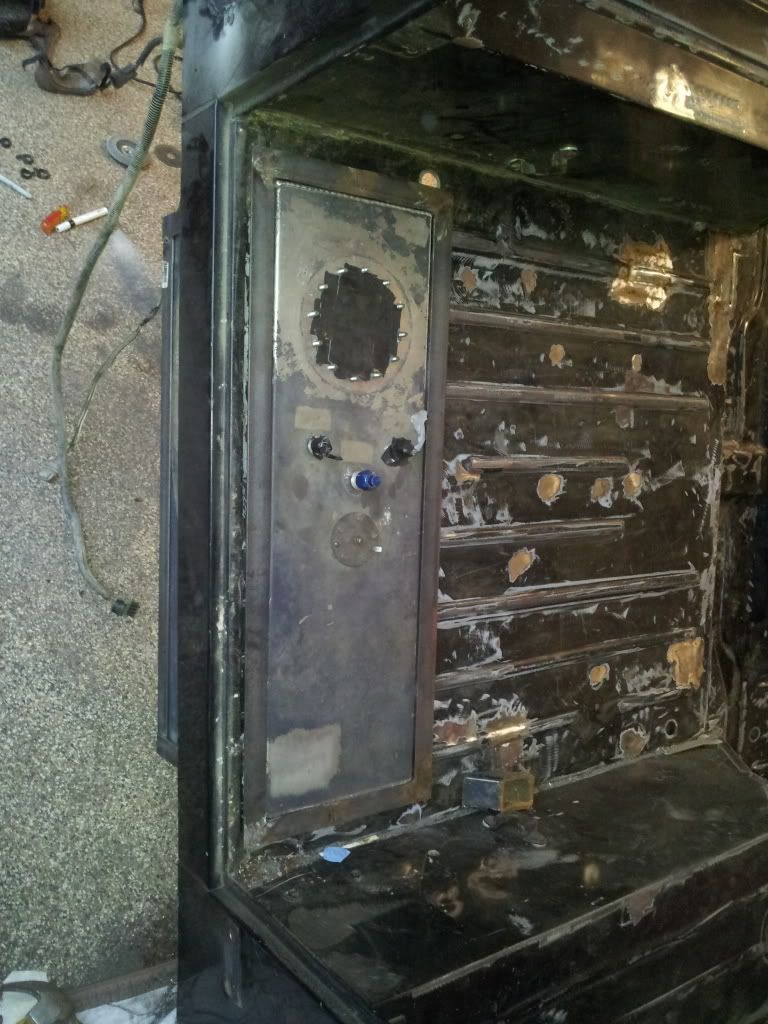

thanks alot! i try to do my best because thats all i can do. i just hope that it will last another 20 years! today i patched the old gas filling hole and cut a nice big one in the floor behind the seat to fit the fuel cell[IMG][/IMG]
