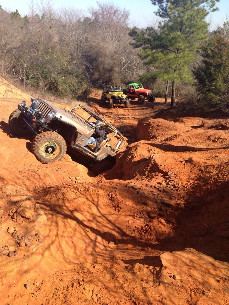

So did your new put put Jeep exceed your expectations?
Looks like you need to air down a bit more.
Those big ole bias belted tires like life around 6 psi

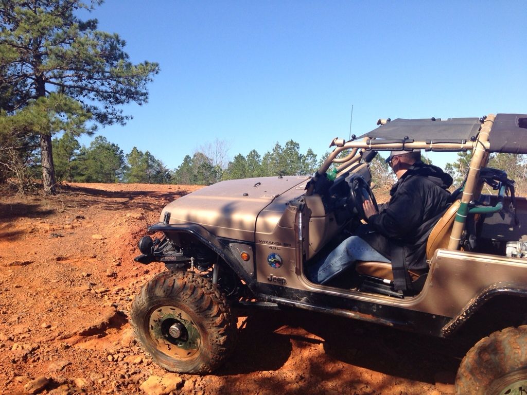

I crawled over some pretty nasty lines that I never even would've thought about with my old Jeep. I did get denied on one obstical that I know I've done a few times in my other rig, and that the YJ on 35's was able to do after I gave up. The wheel base on my rig was to long for it and had all 4 of my tires in muddy holes trying to climb up large rocks at the same time and they just wouldn't grab. The YJ was able to take each set of holes one at a time to go up and over the rocks. I had the tires at 8 psi, I'll prolly take them down to 5 psi next time.

I run 5 in the rear & 7 in ft with my IROKs, It worked out real well a week ago and no burping air on my double beadlocks.
