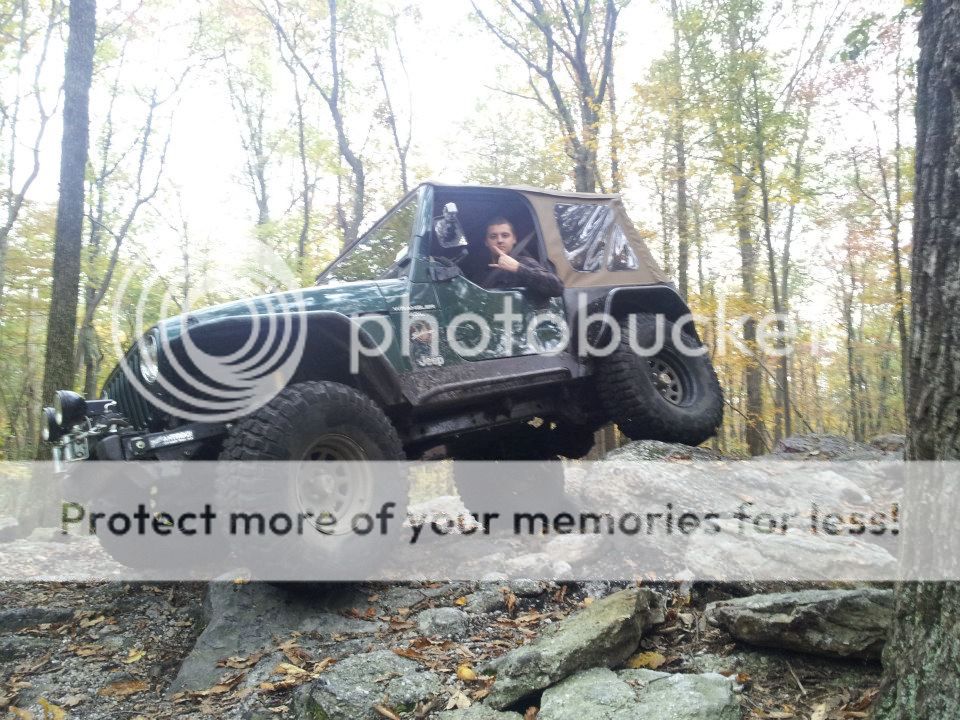

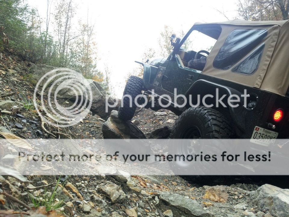

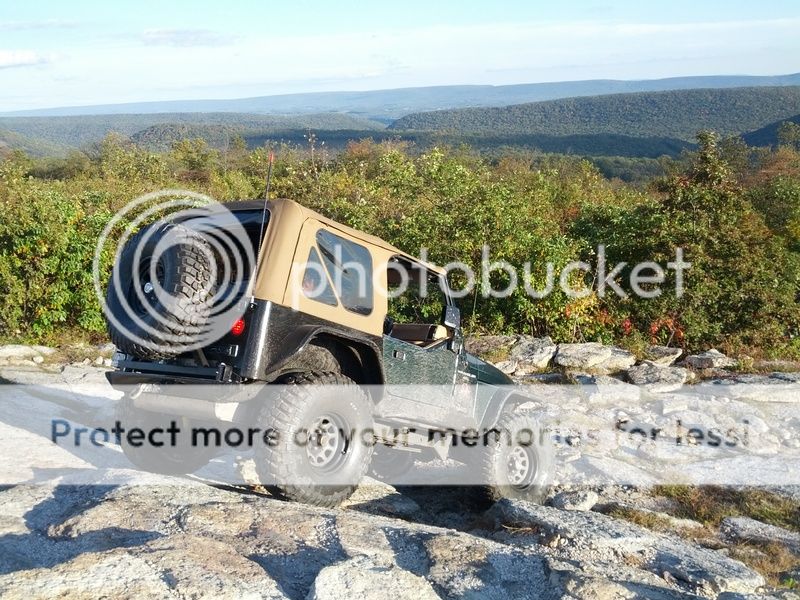

Well this weekend was a good one to go wheeling. A little on the cool side but not unbearable. Finally for once it didnt rain/sleet/snow while I was camping. Anyway I didnt get any definite responses from MJC (local club) so I hooked up with one of my club buddies and his samurai. We also had another samurai join us. They were on 31's locked and leafed and I was on 35's locked front and rear. This was my first shakedown run but after running a couple trails I could just feel the difference in a properly setup rig. We stuck to the main properly and ran all over the place. We ran mostly blues and blacks for the day and I tried a couple lines on tombstone but was denied. Noteable trails we ran were yellowjacket, trail 13, trail 22, snakebite, alot of greens, powerline hill, and alot more that I cant remember. The Jeep preformed very well with the low lift and having lockers. It has very good suspension articulation and was very surprising. Damage for the day I put a hole in my soft top after leaning into a tree and ripped the shock mount off the Ford 8.8. The samurais had some body damage but not much else. Overall a very good day trail riding. I will post more photos and hopefully some gopro videos soon when my buddies sober up. Any questions about the rig or what not don't hesistate to ask.

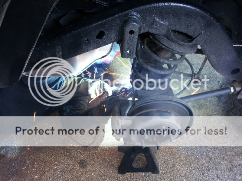

So after the trailride, the Jeep was in need of some repair. I swapped my hardtop on after replacing the seals. We also made progress on painting one of the doors, however we did not finish the driver side yet. I also took the Jeep up to Eric and he rewelded the shock back on. I do think this is going to be a future problem so may need to come up with a better solution to remount them. Any suggestions?

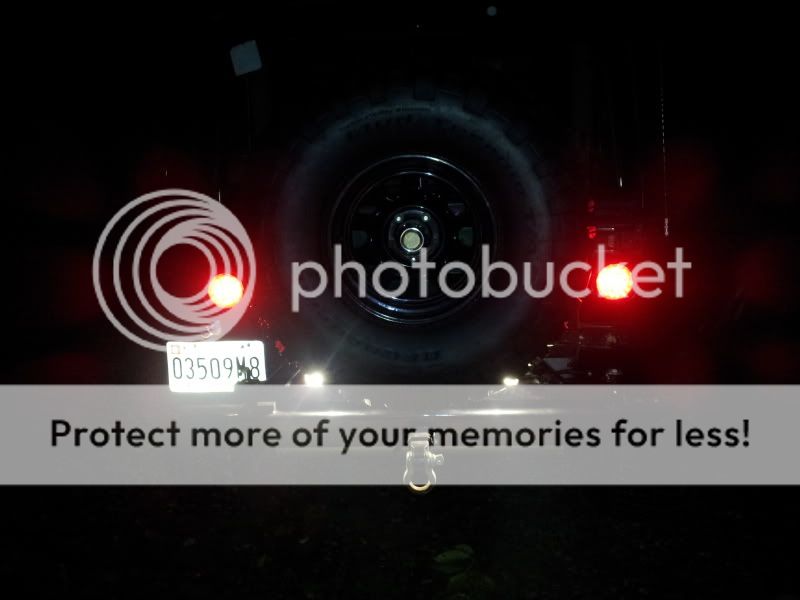

I also scheduled an appointment to get some window tint done at IAG in Westminster. So in preparation for that, I decided it was time to redo the reverse lights as I have not had any in months. Basically rewired the entire thing, wired it into the switch as well as when the transmission goes into reverse, heat shrank everything and did it the right way. Also retaped and wire loomed the rear led lights, that was also a prior hackjob.
