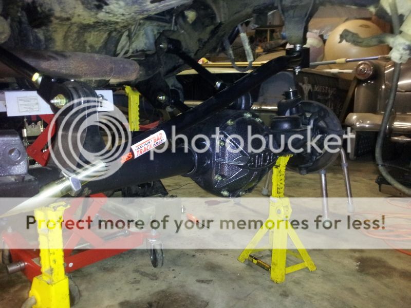

Anyway, Eric on Friday came and delivered my parts!
(HP30, Currie Control Arms, Transfer Case Shifter Bracket, Correct Speedo Gear)
I then got the heavy pig up on some jackstands I had:

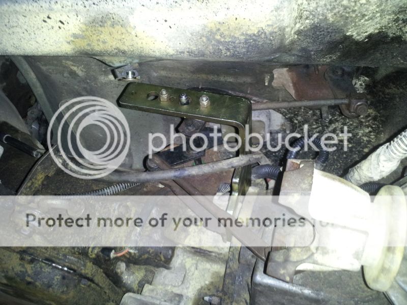

As I mentioned before, we have been having alot of trouble with the shifter linkage, so I decided to work on the front axle.
We stripped down what I needed to put on the new HP30, a couple bolts, an axle nut and new carter pin, and the rotors and lug nuts.
After that, I was pretty much frustrated with the shifter linkage, so we cleaned up the garage before I messed something up. We will just have to figure it out another day.
And thats it for now, I will give a couple folks a call who may know how to adjust the linkage, because once it shifts correctly and the belly up goes on, out comes the front axle!

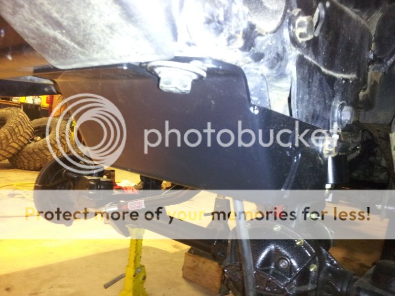

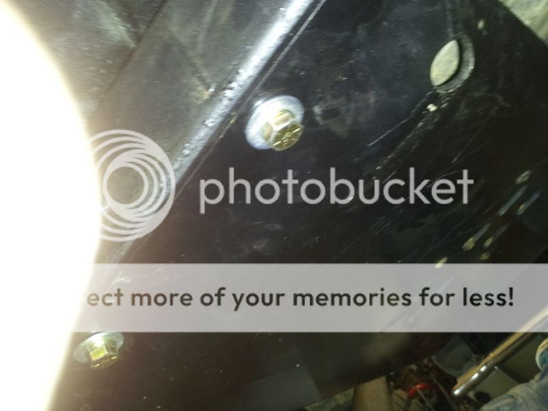

Greg and I went to TSC to pickup new skid plate bolts and some decent spray paint. After that we stopped at Advanced Auto and picked up a spring compressor that will be rented and returned. Next we then headed home to find Paul already there and waiting.
We then crack into getting the shifter bracket done. I really want to thank Paul here again since he has done this mod before and we got it done in about 20 mins. After getting the linkage adjusted, our progress once again came to a halt.
I was missing parts for the Speedo Sensor/Gear, so Paul set off to Ryan's to grab a couple misc peices and Greg and I head to Advanced Auto in Hanover PA to pickup a trans mount as mine was in a poor state and completely broken.
We had made it back before Paul and installed the transmission mount. Paul returned a short time later and we then got started on installing the belly-up pan now since everything else was already completed. (BL, MML, SYE, Shifter Bracket Kit)
We removed the old mount from the stock transfer case skid and installed it on the new Under Cover Fab Ultra High Clearance Belly-Up. With some work, we then got the bolts a few threads in and had the skid hanging. Next we tightened down the skid only to find out that I was having tub clearance issues. So out came a large pry-bar and a sledge and some "massaging" of the tub. Made sure everything shifted correctly and tightened down the skid.
The Belly-Up was finally done! No more drop! (I was given the task then of adding fluid to the case, what a pain in the ***!)

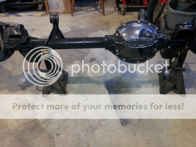

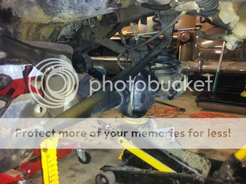

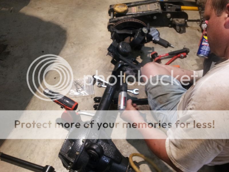

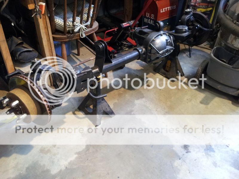

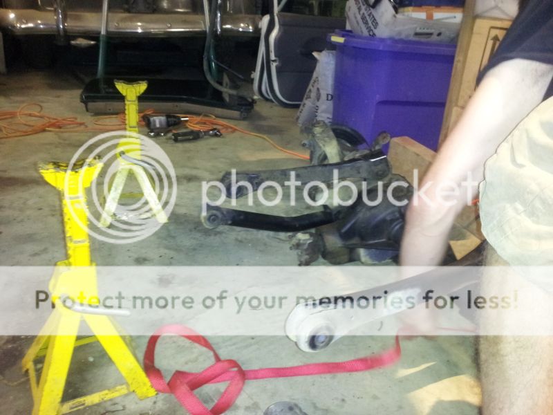

So after making alot of progress, we then decided to tear out the front axle. I did not accomplish alot here, other than being the parts ***** and holding the lights and handing tools. Paul took the lead and with in no time we had the front axle out with all the control arms, misc steering and the housing. Next we measured the new Currie Control Arms to the correct length and installed them on the housing. We had to drill out the bushing to get a greasable bolt through for the uppers.
After that we had came to a halt with the new trackbar, so Paul set back off again to Ryans for a huge *** drill bit (9/16ths) so that we could properly drill out part of the frame.
Since he was gone for about 45 min, myself and greg installed the Skid Row Steering Box Skid.
Paul then returned and we then installed the trackbar to the frame end. We then dragged the new HP30 under the Jeep and got all the contol arms mounted and the trackbar to where it should be. That was all in one day, and I was dragging by the end of the night. Once again I want to give a HUGE thank you to Paul, Greg, and Ryan for the progress we were able to make with your help.
We still have a ton of work to do to the front end but it can be completed soon, and then back to Eric so he can install the 8.8 and getting the rear setup!

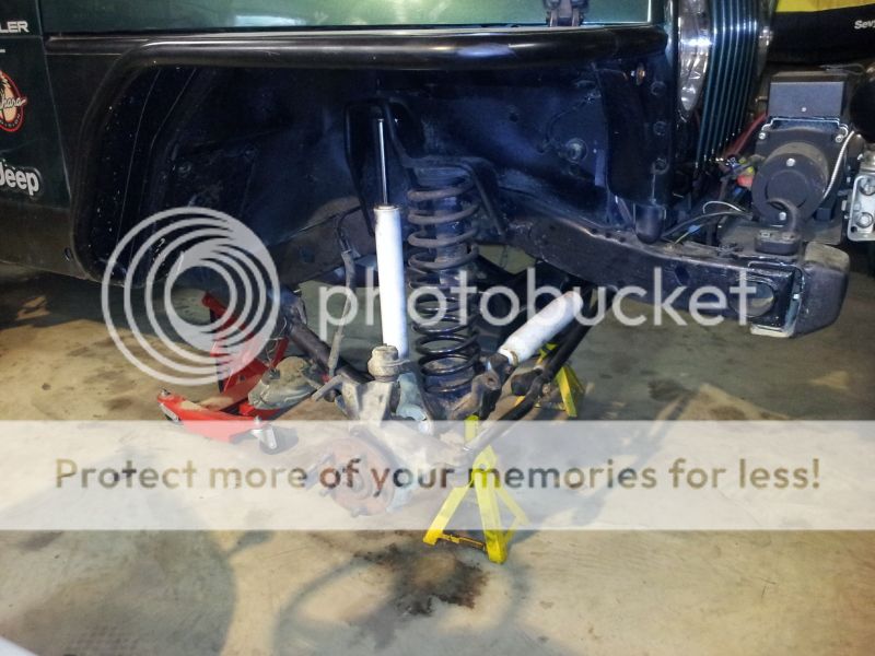

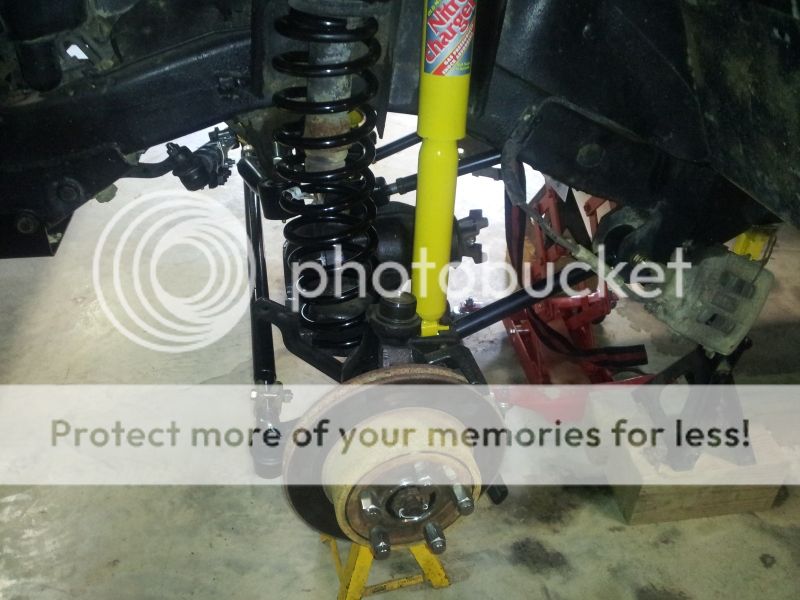

My step-dad and I were able to install the new OME 2.5" HD Springs and Shocks really easily. I am glad I only rented the spring compressor as it was absolute garbage and luckily we had enough droop/flex to get them in with the prybar.
Springs and Shocks Installed:

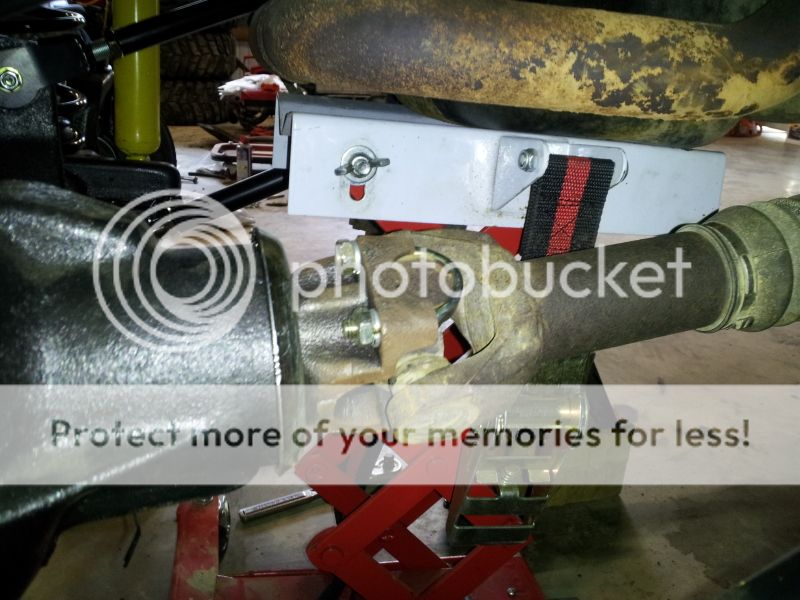

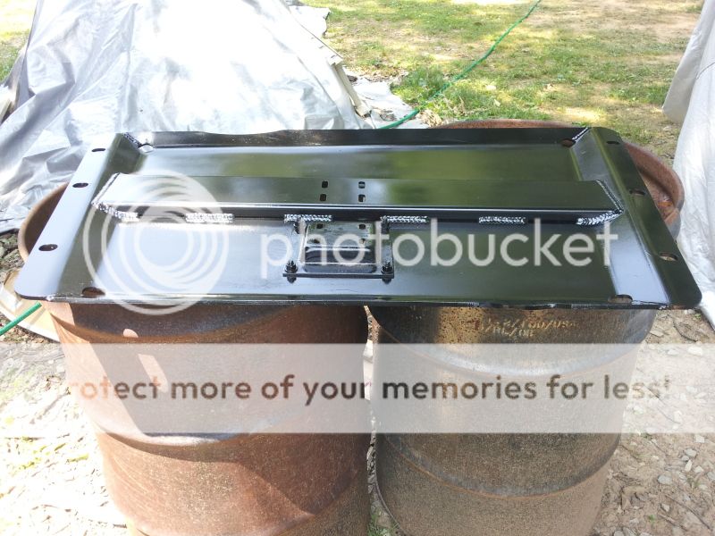

I first dropped by the belly up pan and gave it a proper coat of paint.
The went and hooked up the driveshaft.

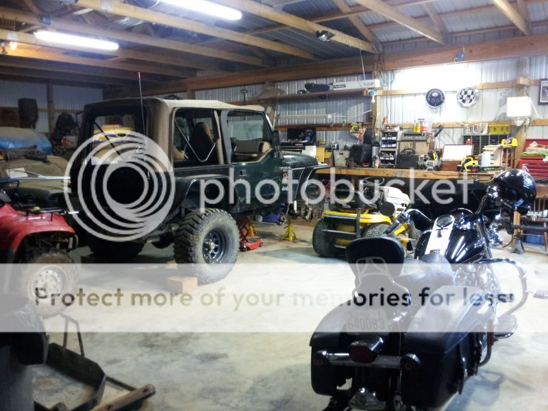

Well we made it out of the garage! Sunday (07/01/2012) we accomplished a good bit. I had my buddy Greg come over and we got started on the nutserts, what a pain but after we got the process down we made short work.
We first grinded down the welds on the outside of the nutsert. After little progress my step dad comes out and got them done real quick. He grinded them down and took the air hammer and knocked them out. Greg then tac welds the nutserts in place and then does multiple passes and I step in after the welding and clean it up flush with a grinder. After a couple of hours we had the skid bolted back up.
We then took the battery charger and hooked it up real quick and got it a fresh charge, it was reading on red at about 8 volts. After about 10 or so min we took a chance and it fired right up. We checked the transmission fluid and the little bit that leaked out from when the transfer case was off did not affect it, it was still reading on max.
We then bled the brakes to make sure I could have some stopping power. After that I hooked up the breather tube for the HP30 and we were off to roll out of the garage.
Backing out in 4WD with a locker was interesting. It look me a few times but we got it out of the garage. I can really feel the difference with 4.88 gears! It is super low and feels awesome. I can also tell the motor is alot closer to the body now as it has a little bit of vibration but not where it shakes you to death. I think it is fine at the moment but may take a look at it later down the road.

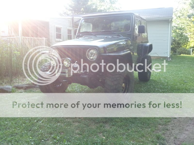

The next day (07/02/2012) I finally gave it a well deserve cleanup with a pressure washer and a wax. Cleaned up real nice and fixing to get it up to Eric after he returns from vacation.
Pics:
Belly Pan installed and no more t-case drop:
Going from the garbage 4" Rough Country lift to the 2.5" OME with Currie Arms. As you can tell the rear has not been taken apart, thats Eric's job.

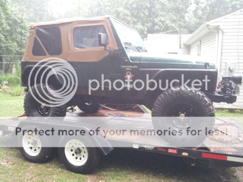

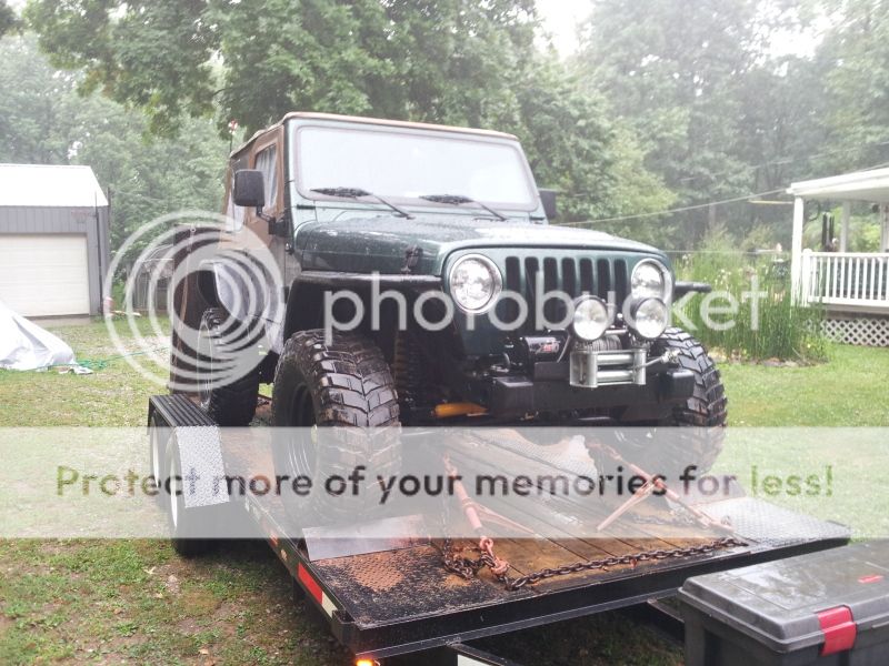

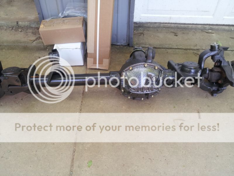

The Jeep is up in PA at Eric's house for the 8.8 overhaul. We got it trailered up to him on Saturday morning in the downpour. A long list of upgrades are in store, so it will be there for a few weeks. I wish it could be done sooner but thats the timeline so there won't be any updates from me for a while. Hopefully he will take some build pictures and keep everyone in the loop.
A few notable upgrades: Ford 8.8 with 4.88s and ARB, Currie Control Arms, Savvy Gas Tank Skid, JKS Swaybar Links and Trackbar.
