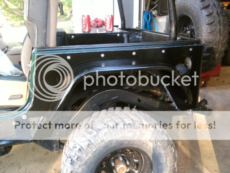

Poison Spyder Front Tube Fenders with Flare.
Side Shot.

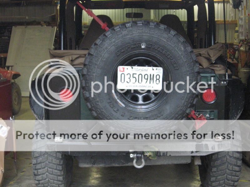

Rear Shot, I added a Skid Row Gas Tank Skid. Has since been removed.

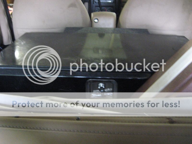

Tool Box and Subwoofer munted. Will be removed in the spring when interior is redone.

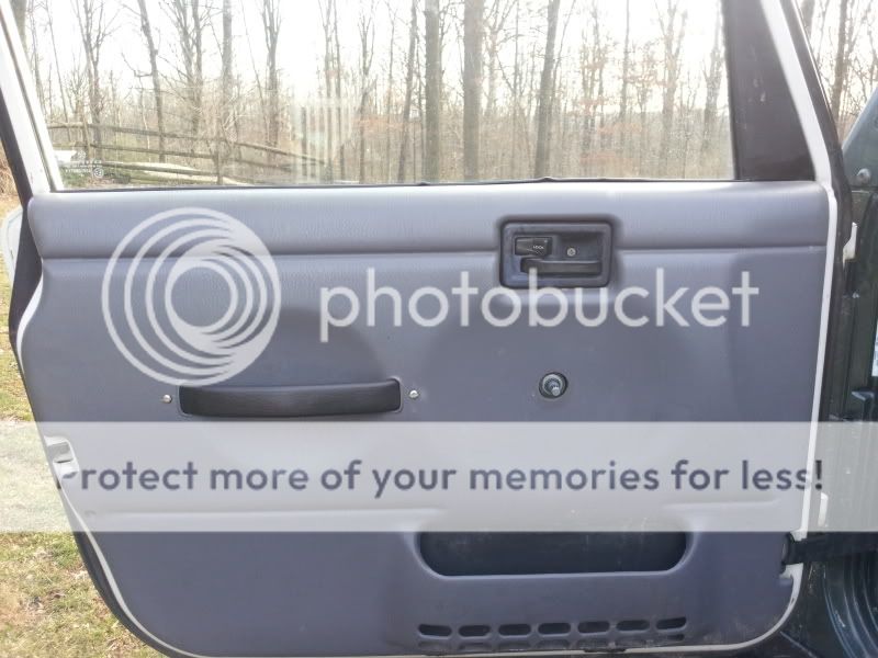

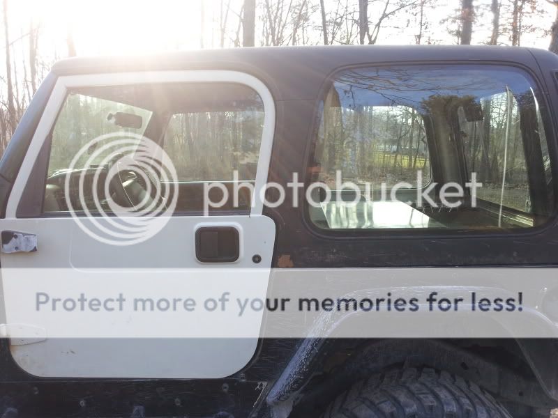

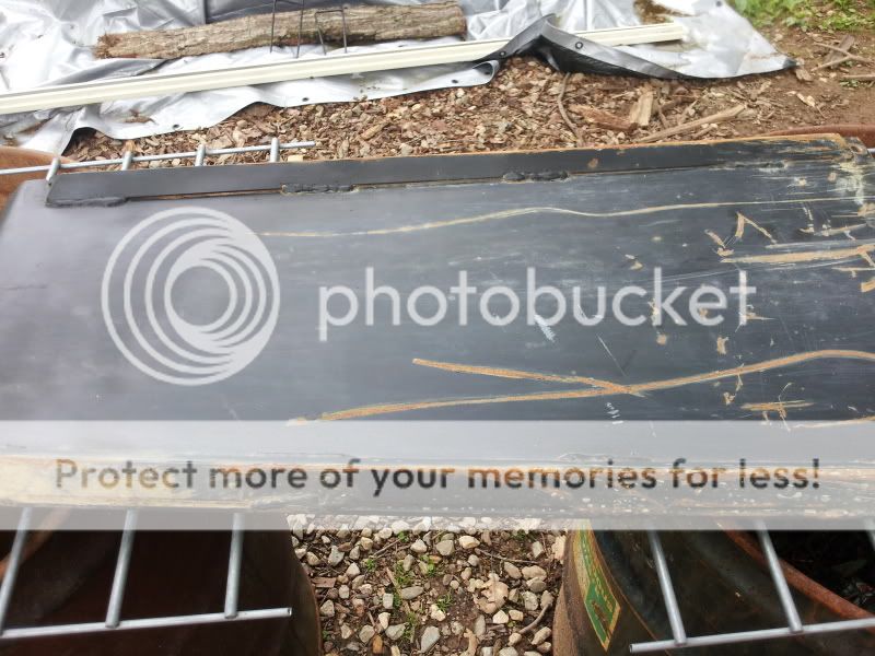

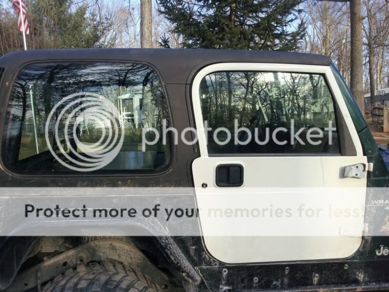

Installed a set of full steel doors and a hardtop. I got a decent deal but however they do require some work. Basically just put them on extremely dirty and in need of repair.
Last photo that I took before the tear down. The jeep took some abuse being heavy due to all the armor, undergeared and falling apart.

post #18 of 391 Old 10-16-2012, 05:25 PM
midnight_f150
Location: greenbrier
Posts: 1,473
Did you paint the doors to match or just paint them black?
midnight_f150 is offline
post #19 of 391 Old 10-17-2012, 12:26 PM Thread Starter
Bedwell
1984 CJ8
Location: Westminster
Posts: 867

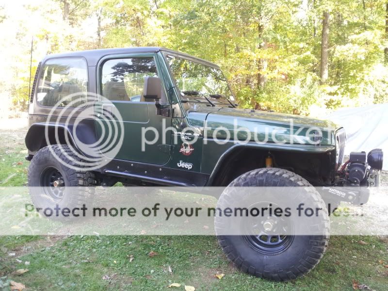

We painted the doors actually green to match, still behind on updates. Stay tuned!

post #21 of 391 Old 10-17-2012, 03:47 PM Thread Starter
Bedwell
1984 CJ8
Posts: 867
Originally Posted by printingray View Post
I like your hardtop selection. It looks attractive if remain in black and the doors turned into green.

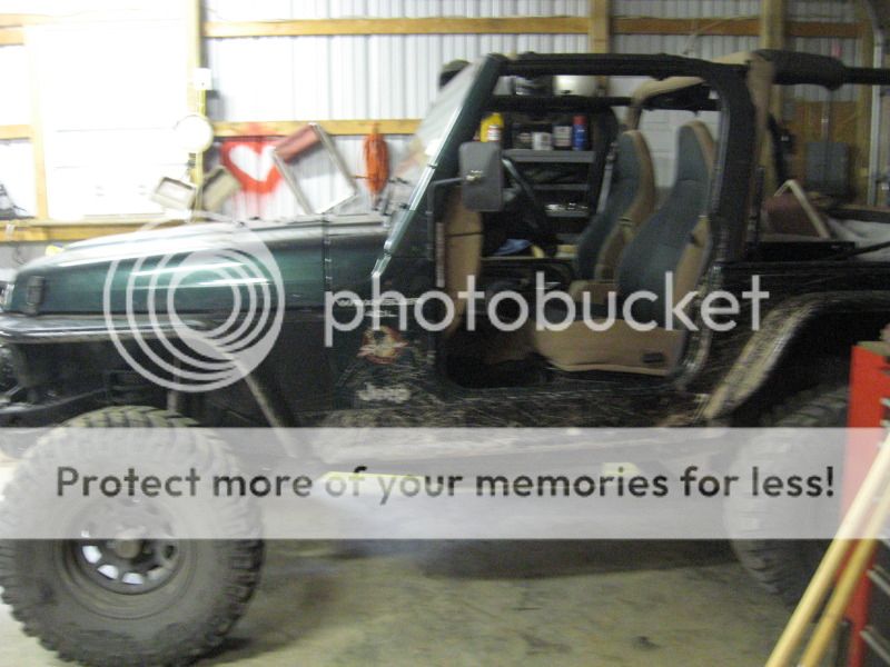

I dont want this thread to get out of order, but here is a teaser shot of what is to come. I originally wanted to paint the top tan to match, but settled with black. I think it came out great.
Thats the same thing I did on my green sahara I bought a Black top and wanted to paint it tan but the black grow on me. Jeep looks great. Look forward to more pictures and updates.

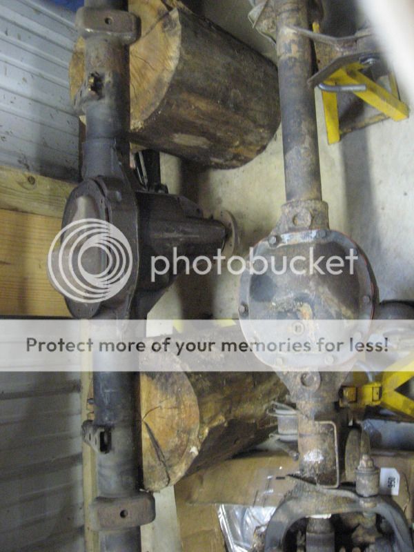

Dropped my axles off to Eric (Know Where 2 Jeep) as he had the best price for what I was looking to get done, I searched from local shops to online retailers and by far his was the best deal to go with.
As he is rebuilding the housings, I decided to start right away on my portion:

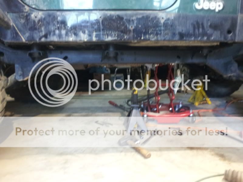

Myself and friend Greg removed the rear bumper, Skid Row gas tank skid, and the Dave Halltrail rocker guards and engine skid.
Repainted skid:

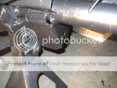

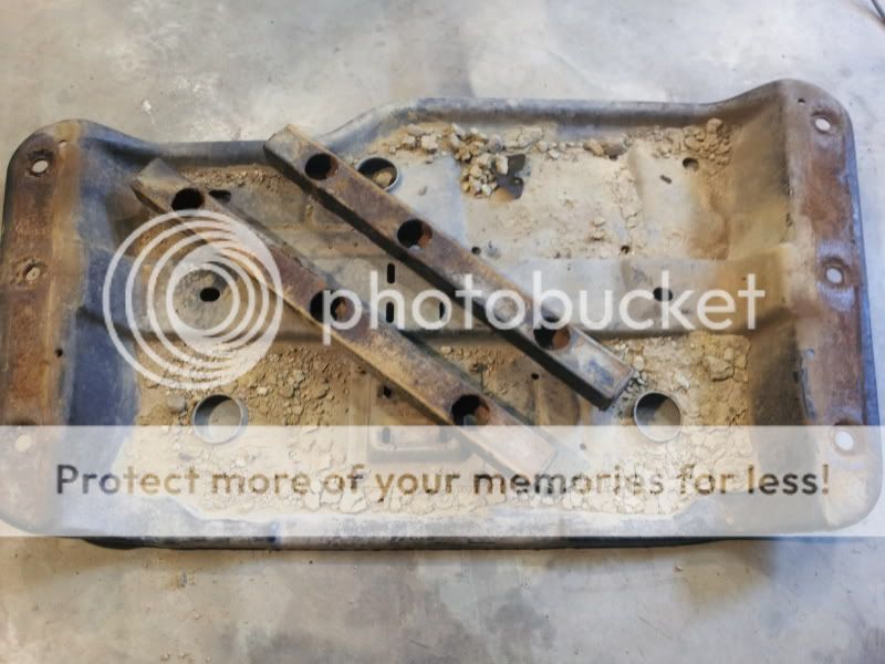

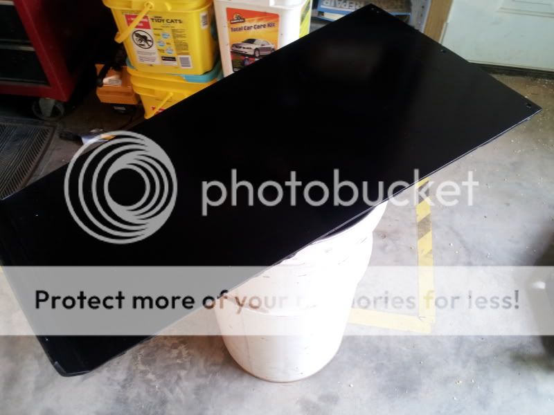

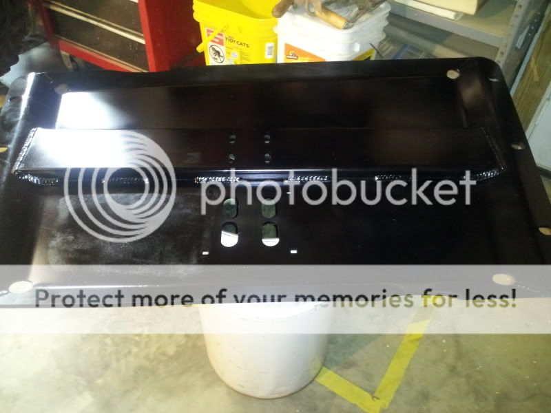

As I was waiting for my buddy to come back over, I decided to paint the Undercover fab works belly up pan:

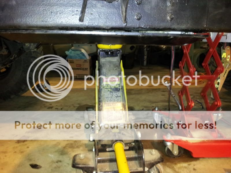

Next we installed the M.O.R.E. 1" MML to gain clearance for the belly up, took us a little bit but wasn't as difficult as I expected:

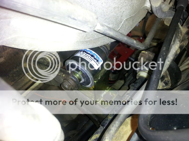

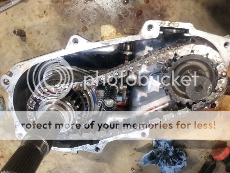

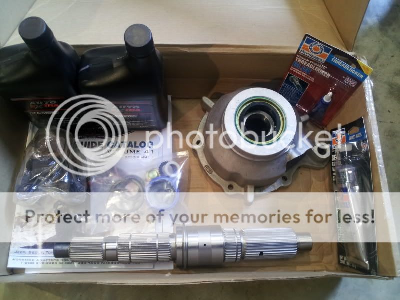

We then decided to install the Advanced Adapters SYE Kit for the np231 transfer case:
Flat Belly!
Not Good!

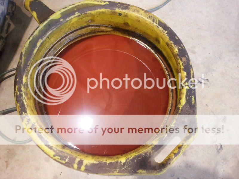

Thats the progress so far, still need to tear out the case to rebuild it, the ATF fluid inside was like a milkshake with some water, so we will see what might need replaced.

I have been somewhat busy in trying to get my half done as the HP30 is almost built. My last update was that we drained the transfer case of the fluid. That picture does not do it justice. It was alot more like a milkshake with alot of water.
We then pulled the case (what a pain the ***) and decided to do a full teardown to make sure nothing was messed up.
Myself and my friend Greg did the install of the SYE, it wasnt actually that difficult. However since I thought we had cracked the transfer case oil screen/filter, back apart the case came again. I picked up more RTV Sealant, another quart of ATF and some misc tools. We took the case back apart again to find the oil screen in ok condition however we replaced it anyway. Checked all the gears and did another bath in brake cleaner. We then manually put the transfer case in four low since we could not put it in gear due to the Motor Mount Lift. Set everything and the case is finally done. We then reinstalled into the Jeep, connected all the sensors, and I will be ordering a relocater bracket to be able to shift.
We then decided to just check the Under Cover Fab Works Belly Pan Skid and see how it would hold up. It looks awesome! 20" of ground clearance. I will NEVER lift a vehicle again if I have to run a drop pan.

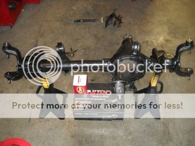

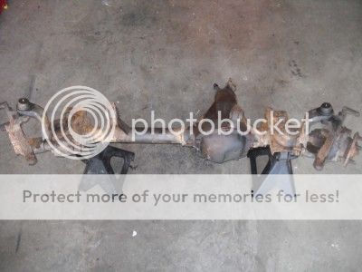

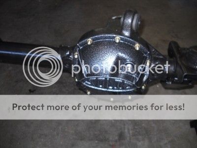

HP30 Start:

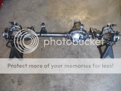

HP30 Exterior Stripped Down:
HP30 Cleaned, Painted, New CA Bushings & Ball Joints:

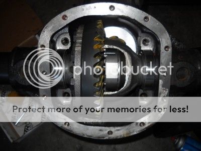

Mini Skids:
Interior Tear Down:
Interior Cleanout:
4.88s and Aussie Locker:
Ready for Oil:
Solid Axle Cover:

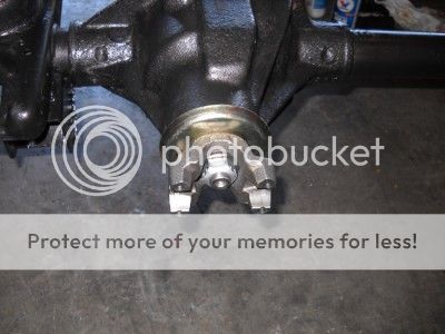

New U-Bolt Style Yoke:
