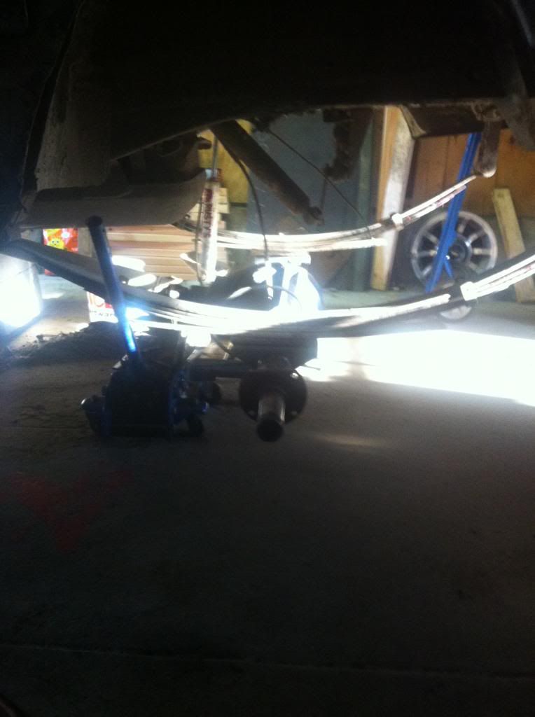

I added a cut down ram 1500 main leaf to each pack, because thats what I had laying around. I also cut 2 ram overloads down to the length of the ruffstuff perch to act as a .75" block.
Centering the axle and tacking the perches

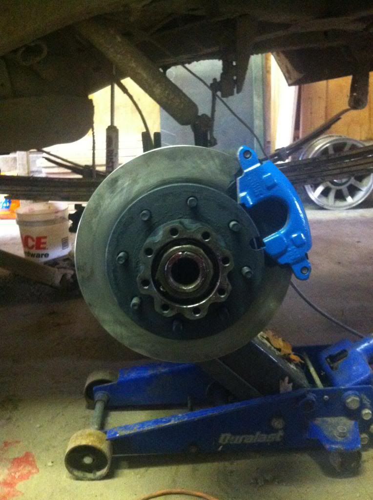

Then I welded in the perches and disk brake brackets
And finally on its own weight.

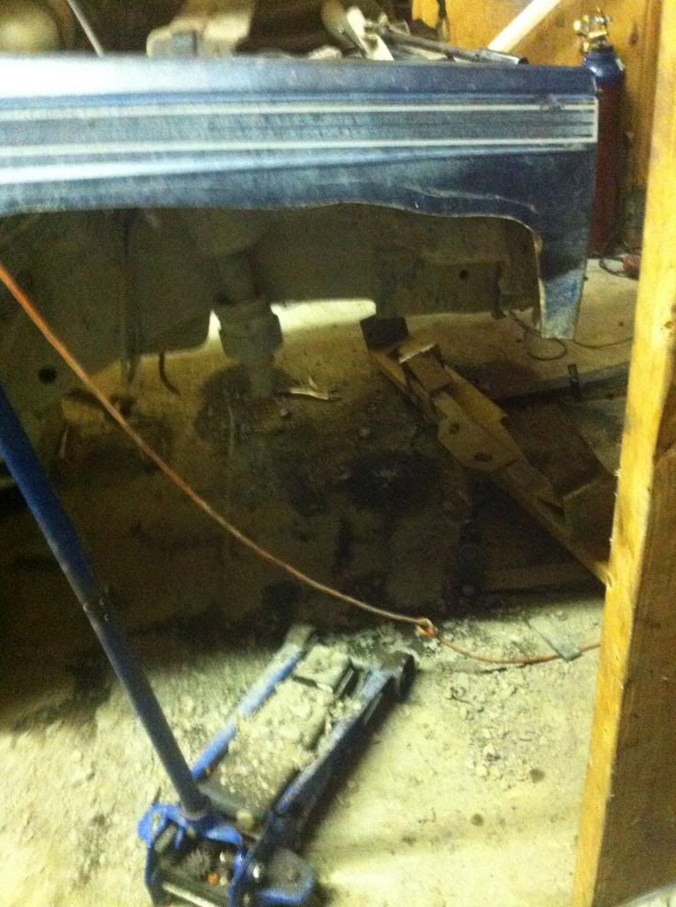

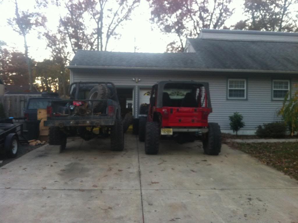

I could only get one shaft in to drive it out, the locker worked fine. Once it was outside, I put the other shaft in.
Here it is next to my friends TJ on 38s.
I turned it around to work on the front.

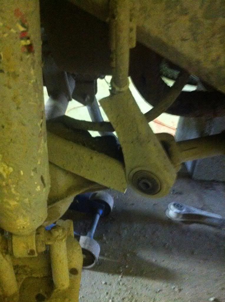

Living in the northeast, the quickest way to get the front axle out of a jeep is to cut. You can also see the rigged up shock extenders in this pic.
Anyone need a dana 30? I really need to clean up the garage.
You can see the stacked coil spacers in this pic.
Theres no going back now

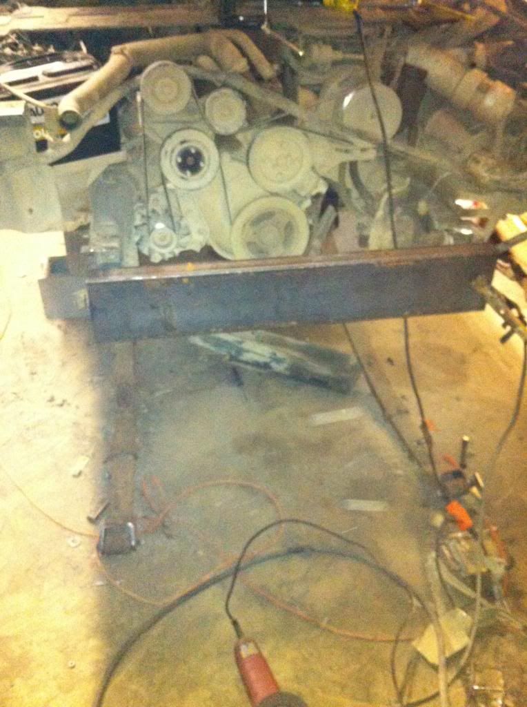

Made a new front crossmember to be a bumper, winch mount, and leaf mounts. Frame tie ins are 2x4 and crossmember is 2x6, both 3/16.

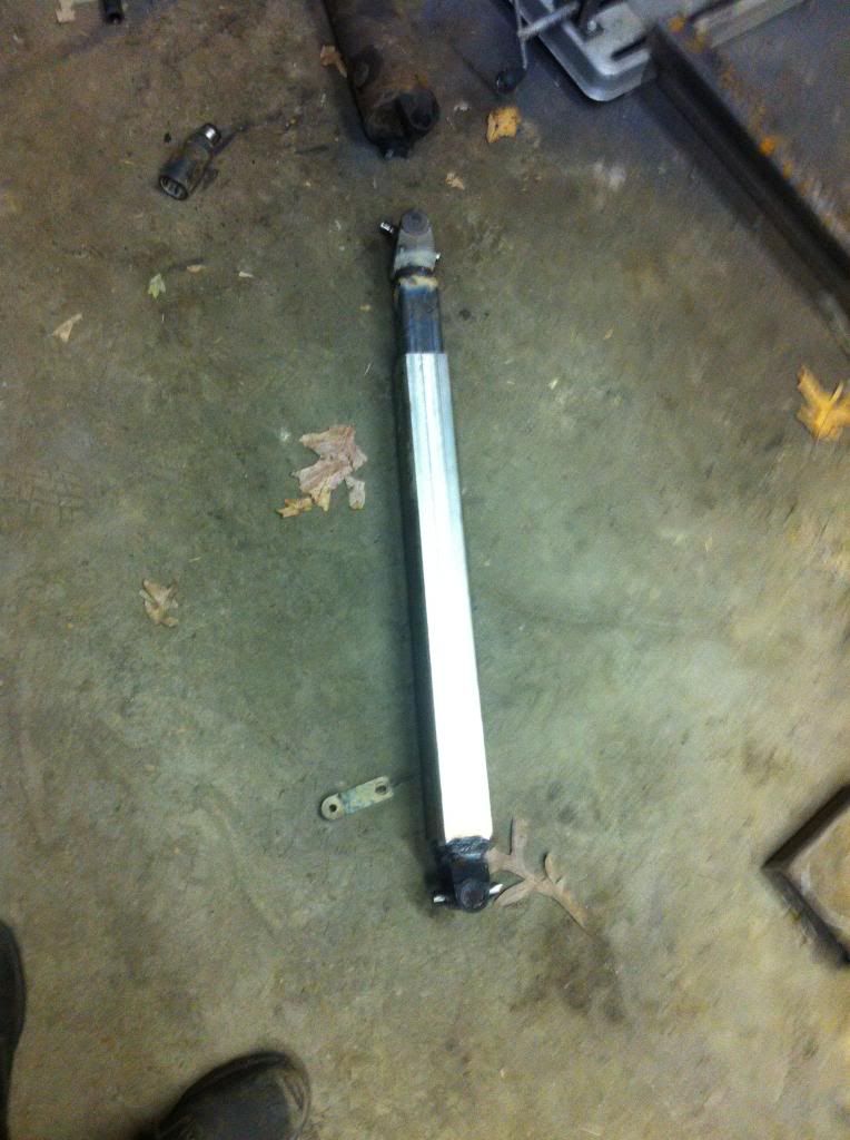

I took her out to test. I think it went very well for a test run. My shortened rear driveshaft worked. I exploded the slip joint on the front though, so I made a new one from square tube.
To do still is front lift and shocks, upgrade the brakes, rear shock mounts, and finish the bumpers.
