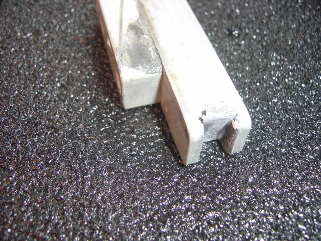

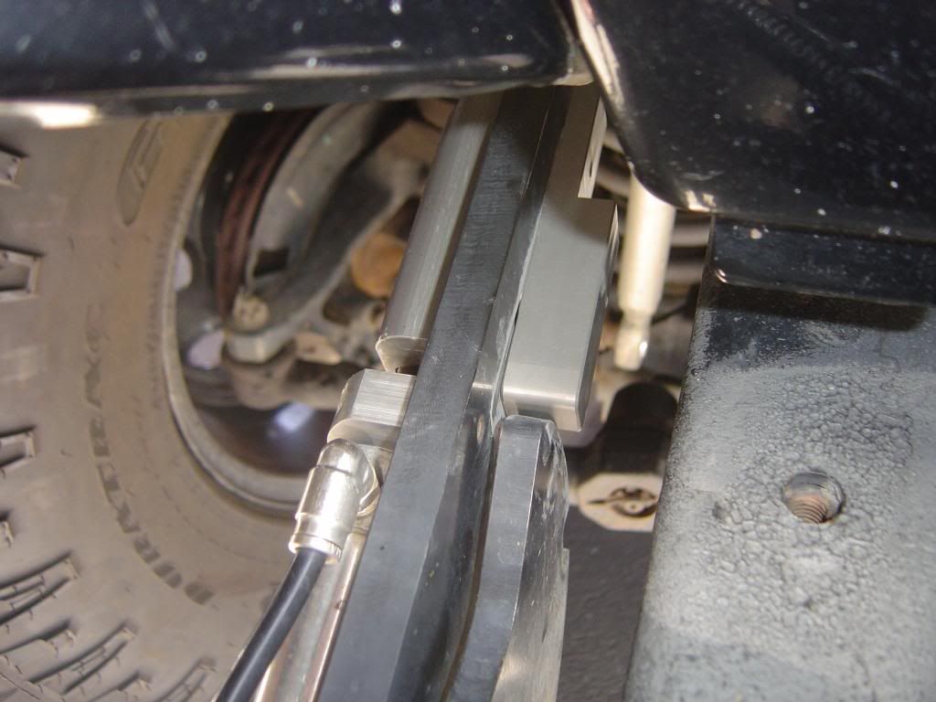

I was able to replace the aluminum piece on my ORO Swayloc today, nice to have the swaybar connected again. I don't know if I would have gone with the ORO product had I known the replacement of this piece would be considered routine maintenance.
And finally fixed
I had to flex her out for the pin to line up with the sway bar, thank goodness rocks are a dime a dozen in Tahoe. Winterized the rig last week including a new windsheild, stud tires, oil change, rear diff changed and tire alignment
I have a new OME/ARB steering stabilizer on the way as well as some Rubicon Express rear sway bar extensions, will mount in a week or two. The tracbar is something I am looking into at this point, hopefully I can find one that will really tighten up my front end.

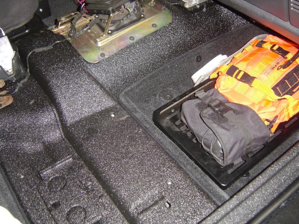

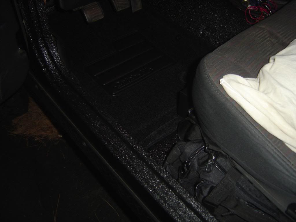

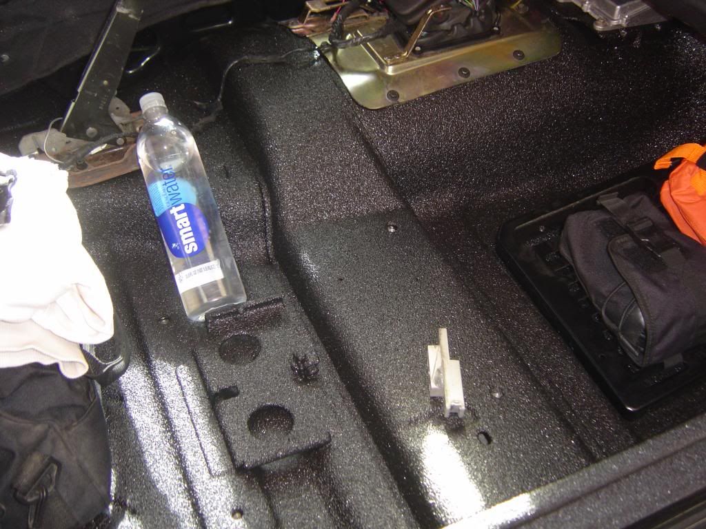

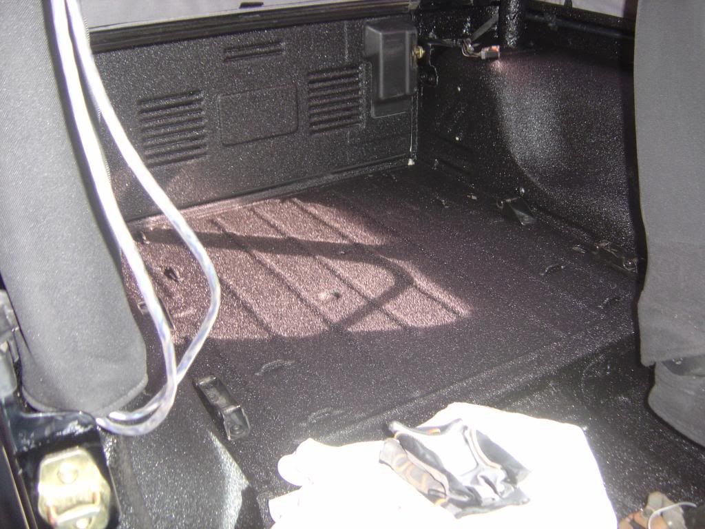

Almost forgot to post the Line X job, they did amazing work, very impressed! Had them apply the UV protectant so it shouldn't fade.
My Nifty Catch All floor mats should be here in a few hours via UPS, can't wait to order the Recaro seats!

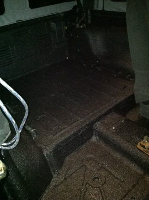

So brown just showed up and to my frustration the rear cargo mat was the wrong color (drop shipped from Nifty). My LED's were wrong as well, it seems a quarter of the time packages show up incorrect... such a waist!
The front mats on the other hand look great. They have a nice tight feel and look very clean over the Line X.
Nice shot of the tuffy box
Rear mats
Probably be another week or so before I get the rear cargo mat installed, bummer.
