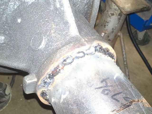

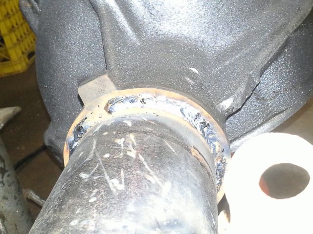

Done!
Perches, shock mounts, tubes, and brake line tabs.
Tubes
Brake line tabs
Most of my welds turned out pretty good. I had you spot on the tube that was welding pretty crappy.
But most were decent

I wanted to be sure that the perches wouldn't go anywhere so I welded as much as I could on the inside to.

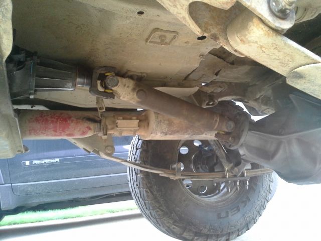

Picked up a flange yoke today from the jy. Got it off a 91 for 20$.
New u joints
Im very happy with the new angle. The slip yoke was sucked in a solid 1.5".
