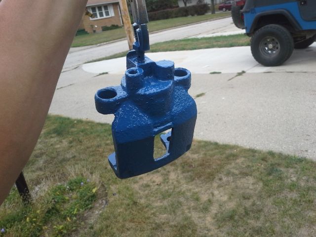

So, i was sitting here....broke....thinkin.... And what do you think about when you don't have money? You think about stuff you need to buy. One of the things I need to buy is new calipers for the 8.8, or so I thought.
The calipers that came with the axle looked pretty bad but I decided to test them.
Pretty nasty
Used my friends little air compressor
Shot some air into the brake fluid hole. (fluid that was in there before was clean, no rust)
And boom! They popped open easy peasy.
They closed fine too. So, I think I'm going to clean then up and reuse them. Any objections?
ashland82391 is offline
post #1194 of 3653 Old 09-19-2013, 04:03 PM
Ripper3494
Location: Warrenville
Posts: 5,741
I did that on my front 44. They worked, but worked like ****. You may have better luck though. Id say try it, the worst that can happen is that they don't work well

Yeah that's what I was thinking.
If it were the front brakes I'd be alot more hesitant, but the fact that they receive maybe a third of your braking power, I say go for it

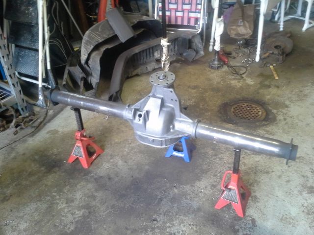

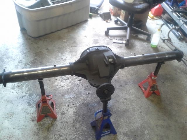

Started painting the diff.
Primer
Paint

Got one caliper cleaned and painted.
Street racer style! :-)
Used high temp engine paint. Figured it would be a safe choice since I don't know how hot the calipers get during braking.
