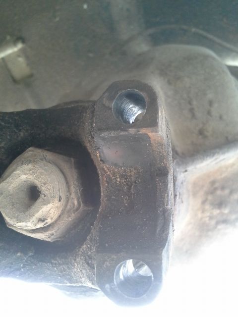

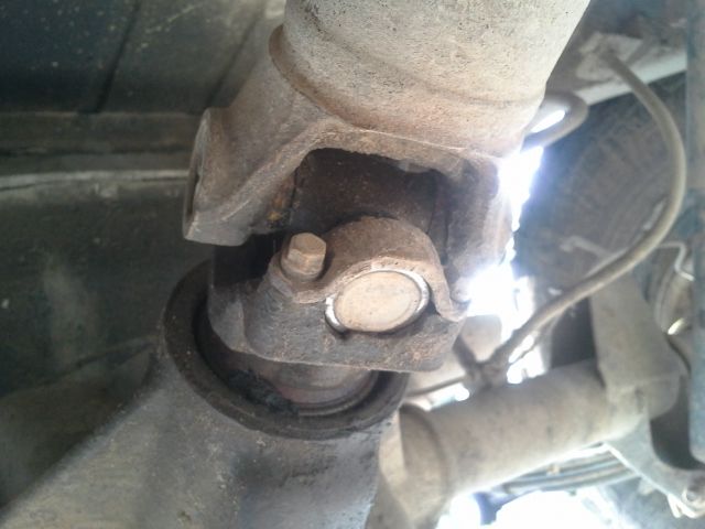

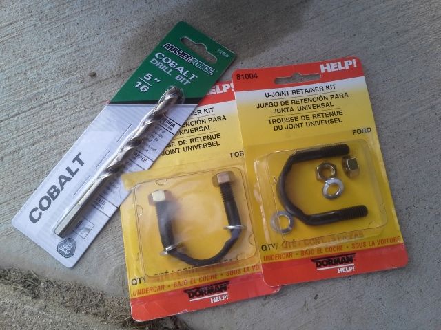

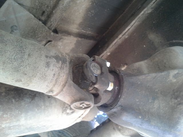

I did something to it today!
Ubolt straps! :-)
Cost me about 15$ total, including the cobalt bit.
Old
I had play in the u joint with the straps completely tight.
drilled out the threads with a 5/16 bit.
Boom! Done. Only took me about 15 minutes and there's absolutely no play anymore :-)
