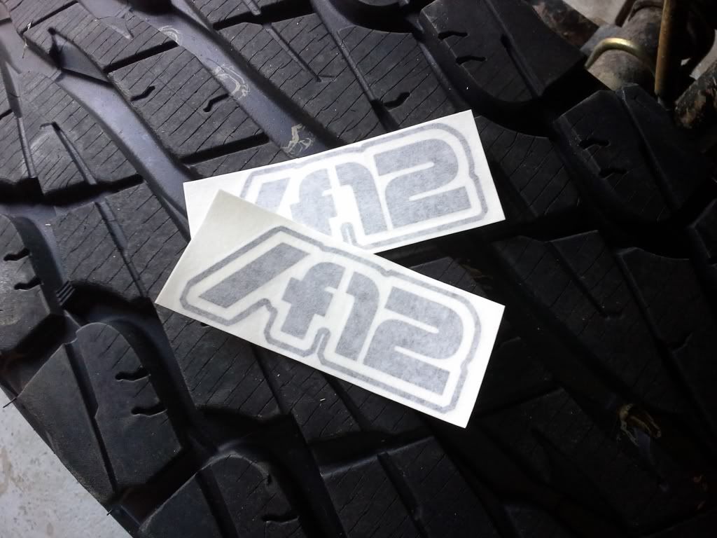

Progress is moving slowly but surely today. should be all done tomorrow.
Got these from sparrows today
ashland82391 is offline

I am jealous , can't wait for mine

My only problem now is to figure out where I'm going to put them! Lol

I plan on putting them on my cloaks (close to the flag/jeep sign!)

But you cloaks are black...??

Zte got my back up red ones....

Oh and I think they look cool on the side of the cowl right where it meets the front quarter panel.

Uhhhhhhhh

sneaky sneaky....lol
