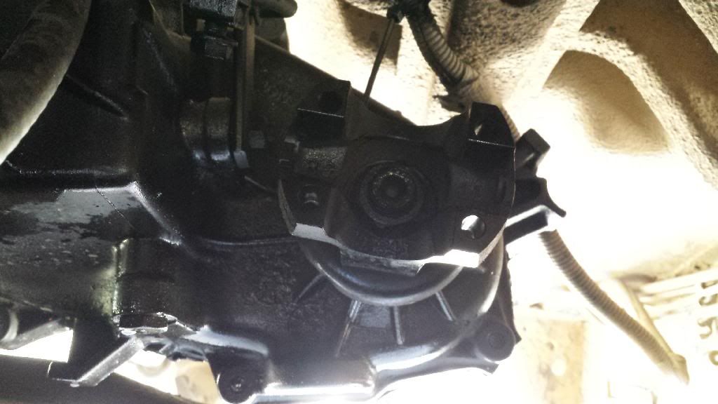

Installed the zj yoke
Then measured. My total length from tc to axle is 41" do I'll have to have the drive shaft lengthened 9".
