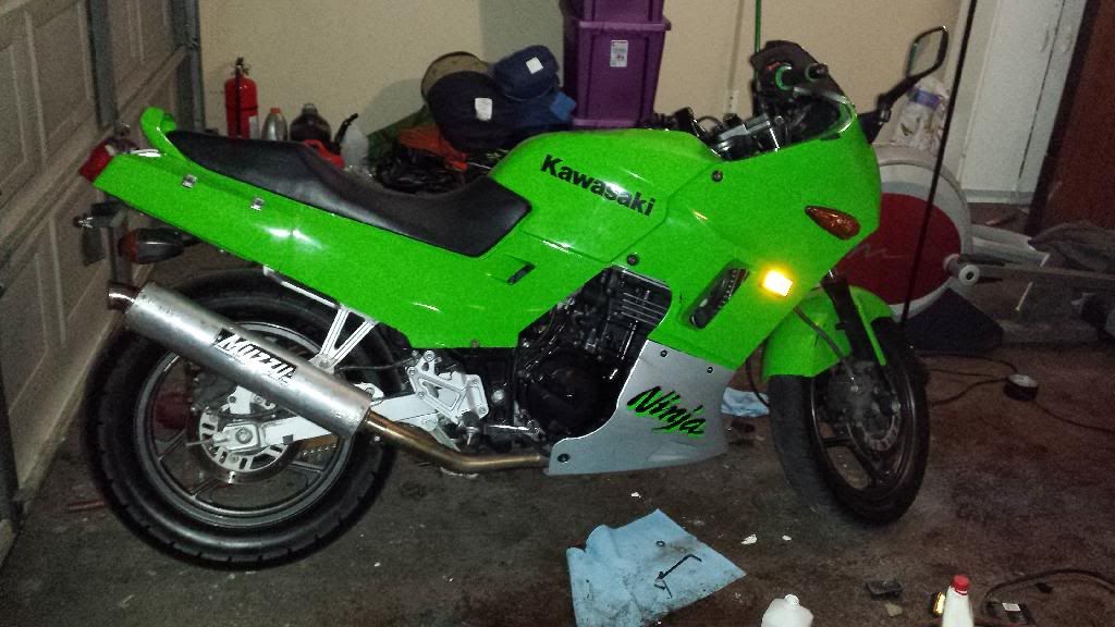

Yes yes yes lol my father-in-law made sure to make that a point. He's the one that gave me the first one and bought this one for me. Great guy.
