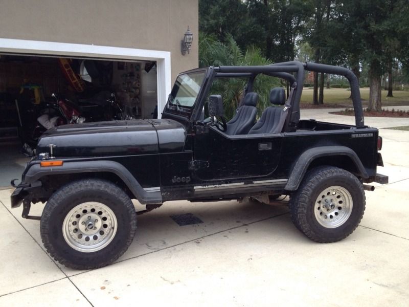

I bought my Jeep about 3 months ago. Not my first one and probably not my last (hope my wife does not read that line.) I feel like I got a pretty good base to start with.
Well here is what I started with:
1988 Jeep Wrangler YJ
Chevy 350
Turbo 350 trans
NP231J with SYE
D30/D35 3.07
2" Springs
Procomp Shocks
5/8 shackles
265/75/16 Goodyear MTR
Knowing what I wanted before I started has helped a lot for keeping progress moving.
