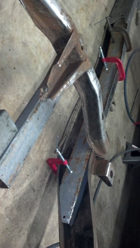

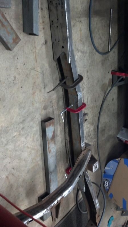

Not had much time to work on it with holiday stuff going on but last Saturday my buddy david came over and I was showing him how to weld and also let him try using the plasma cutter (he has never done either ) but I did cut the 2x4x3/16 to fit in the frame and I cut access holes and welded tubes into them so I can get a socket on the lower foward 4-link bar nut (don't think I got pix of them yet )
Now I just need to weld them together , weld them into the frame , cut the bottom of the frame off and weld it
And the reason I stoped working on it Saturday was I went to the =SunSet= VA truck club meeting so I could be made official
Ok finally got back to working on the wagoneer , welded in the box tube on the passenger side , then cut the bottom off and finished welding it then cut the boxed part of the frame and made a filler for it and welded that in also
Here are the pix of today's work
That peice of round tube welded in the box is access to the original leaf spring nut as I'm thinking I'm going to use the stock leaf mount for my lower 4 link mount
Cut out
Old support tubes for trans mounts ect..
Pix from today , got a late start but got the driver side rail cut and welded up
I forgot to cut the spare tire carrier bolt off before I layed the frame back down so that was holding the *** up just a tiny bit
Ill also box the rest of the frame once I get the notch in
