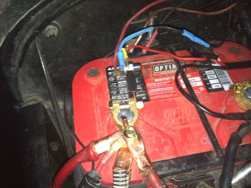

So I finally figured out my winch issues after basically redoing all of my battery connections....
I feel like an idiot for not reading the wiring diagram for the winch.
There's a ground terminal under the winch motor for the ground to negative battery terminal I had missed. I had both the battery and solenoid ground hooked to the same terminal on top of the motor :
Now to respool the cable and start recovering sh*t!
Also I don't know if this classifies as jerry rigging, but I switched my terminals to the posts with a butterfly nut. I didn't have enough room and I was out of eyelets for a larger gauge wire so I used a 175a fuse to connects all my accessories with a bolt on one end and hooked the other end to the bolt on the terminal. Everything has power so far, but idk if it will cause a problem later to have a common ground like this..
