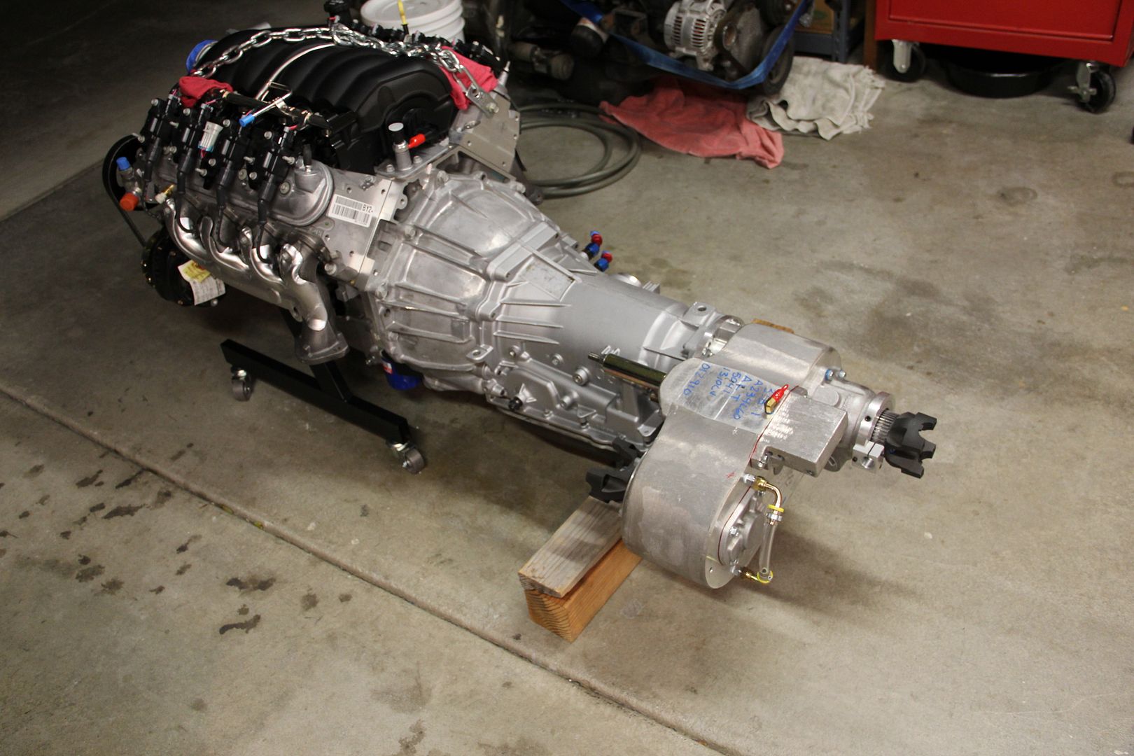

I'm sure I will have a thousand questions for you and here is the first one . Since you mentioned Atlas, I am about to shoe horn this in my jeep this weekend and I don't want to pull it back out. Do you remember where yours was clocked and did you have to mod anything to get it to fit using the genR skid? Right now I have mine at the least rotation which is 7* I think.

That's a nice set up, LS3? 4L60e? How you dealing with the smog? I'm looking into doing a V8 swap but concerned about the exhaust routing and dealing with a smog ref.
Not sure where I have it clocked at? There's a picture on page one the shows the Atlas installed, with the new 4 link cross member/skid plate will hang down about 2" or so below the frame.

You got it, LS3/4L60E. I got the LS3 E-rod crate motor, which comes CARB certified as a package for pre OBD-II vehicles. It came with everything including the evap, cats, two sets of manifolds, complete wiring including the new fuse block, gas pedal, sensors, everything. Not sure exactly what I have to do for smog when it comes time, may have to go to a ref the first time. I'm a bit worried about exhaust as well having to use the 4 small CAT's. I know I saw pics of that red gen right YJ with an LS1 in it I believe.
You might have yours clocked one more hole down than mine is right now, hard to tell. I'm going to have to measure it but I don't have the skid yet so didn't know if it would work like it is now without cutting into the tub. I put a 1" BL on to try to avoid that. If yours all fits in there at that rotation with the gen right skid and not mod anything else ( I believe you have a 1" BL?) then I may go ahead and clock it down another hole. The holes are 3/4" apart though and seemed like it point the driver side down too far.

Yes, I have a 1" BL and also a 1" raise motor mounts. My Atlas just barely clears my tub, in fact it's really close. I tried to clock it up more but I was having clearance issues and didn't want to cut the tub if I didn't have to.
