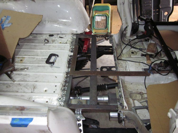

The support frame for the floor extension (made from channel and L1.5x1.5x1/8" angle):
Installed... Note the welded nuts for the relocated rear seat brackets!
Once I got the tub squared with adjustable scissor jacks at four corners and measured 100 times, I welded on some rail extension supports to hold everything in place.

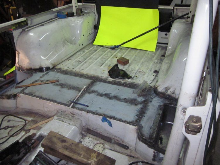

Time for sheet metal work!! After seeing another Jeeper's TJ-6 build, I could not in good conscience leave the floor completely flat as I originally intended to. So, I kicked some ideas around and decided to make use of the available space for some storage compartments that will continue off from the wheel wells. It will take a lot more work, but... what the heck! It is going to be so sweet!
First, I made my templates out of posterboard material. Then, working with 18 gauge sheet metal and using a homemade press brake, various cutting tools, and a heck of a lot of hammering, I made this support bulkhead. I started out painting everything with weld though primer, later I just stopped doing this because of the time it took to get the stuff to dry and for some reason, I could not get good spot welds that held together.
Welded it in place with one half of the floor panel...

Then came the actual compartments... with some posterboard mock up work first...
Spot welded it in place...
I was running short of time and the air was feeling kind of damp. I knew it would be a while before I picked this up again so I painted the interior with primer for rust protection:

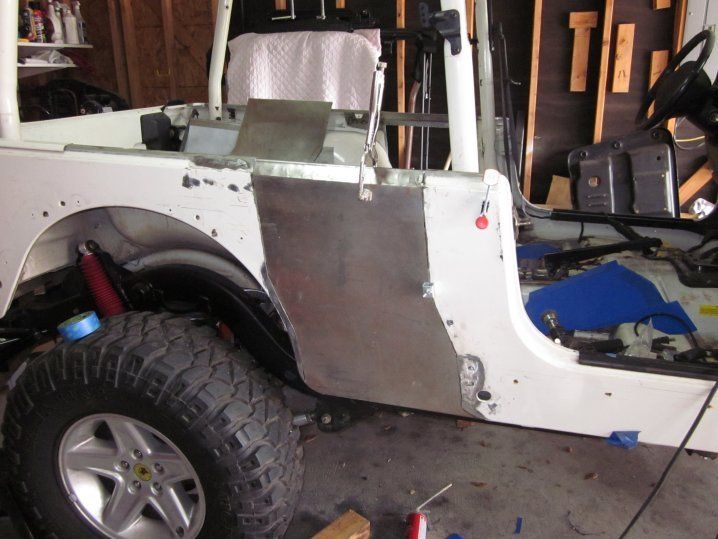

Just for kicks, I decided to test fit the side panel:
I need to finish this already!!

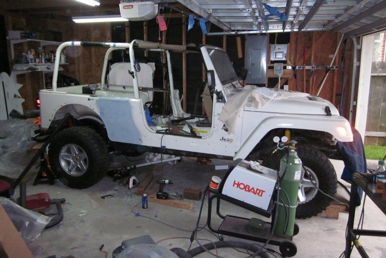

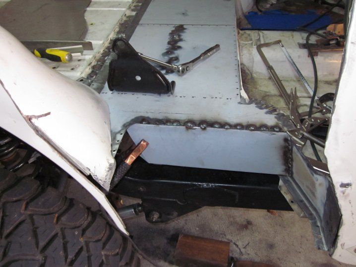

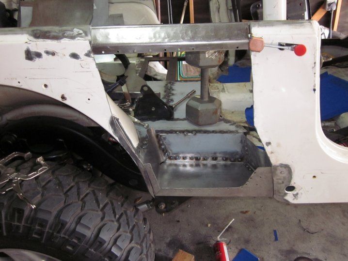

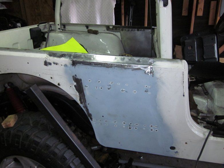

Had some time to work on the TJ-6 this weekend...
I bent some more sheet metal for the driver side storage compartment:
And then installed it...
Now the floor panels are starting to look like something. I still need to grind down all of those spot welds.
I made a few fitting adjustments to the passenger side panel, drilled a couple of holes for the AEV flare connections and proceeded to weld it in place. This will be a slow, careful process; we don't want excessive heat to burn through the sheet metal or warp it.
Sahara Surfer is offline

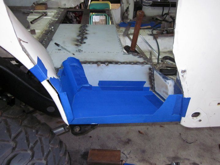

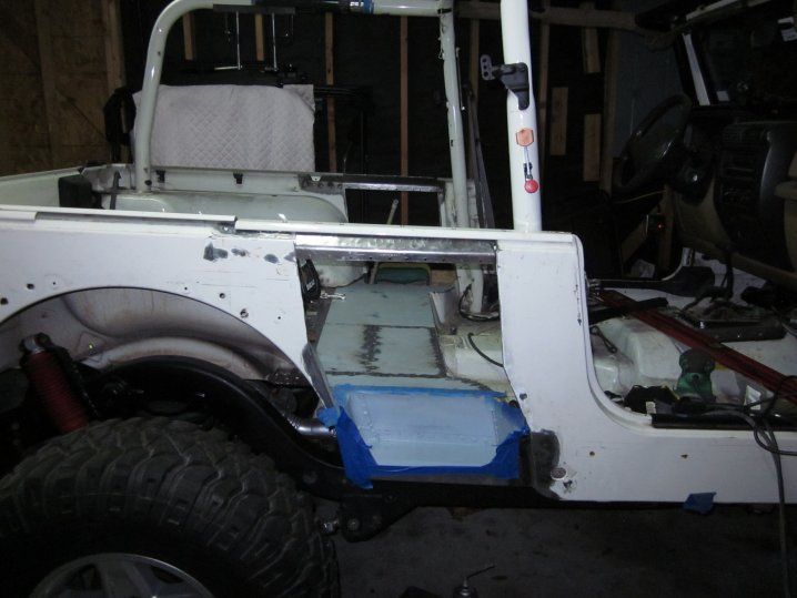

Finished welding in the passenger side panel, cleaned it up, and slapped on a coat of primer to combat rust from the Houston humidity (It really takes a few hours for bare metal to start turning).
I am getting closer, but there is still a lot left. I have to have it painted by the end of July!

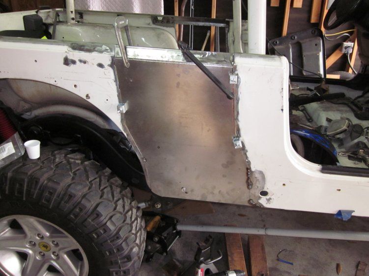

I am now under the gun to finish this project in three weeks. I am selling my daily driver and will need the Jeep to drive around until the new daily driver arrives. Needless to say, the pressure is on to avoid being stuck with a rental in the interim.

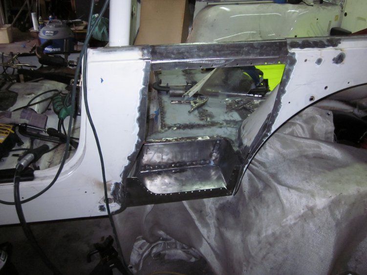

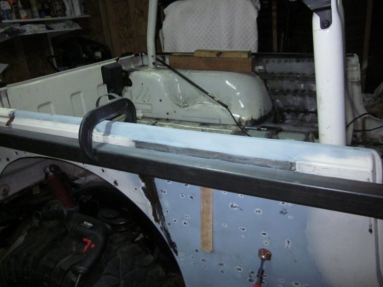

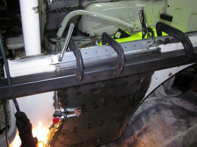

Continuing with the interior of the side panels... I fabricated the tops of the storage compartments. In order to attach the lid hinges, I needed to weld some nuts on the insides.

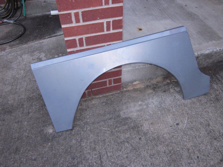

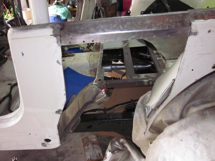

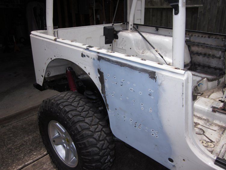

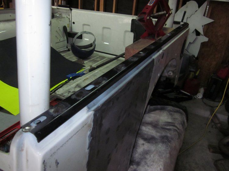

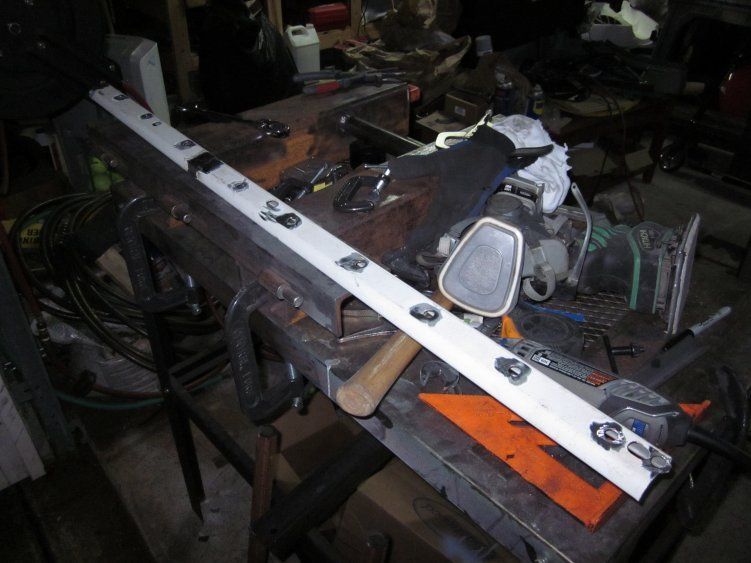

I knew that creating the belt rail supports at the top of the tub gaps would be a challange. Ideally, I would have liked to have found some donor sections from a wrecked TJ tub. However, this proved to be a difficult errand. It was tough finding two unblemished 15" sections and the few that I did find, the sellers wanted me to buy the whole tub. Trying to fabricate some of my own would only result in some ugly bends (I am not that skilled).
In my search, I came across this weld-on TJ repair panel from NOR/AM that just happened to have the sloped bends that I was looking for. The sheet metal was thin (21 gauge) and felt flimsy, but in short sections, it was stiff enough to work. Best of all, it was only $60.
Look how perfectly the bends match the factory tub!
Passenger side welded:

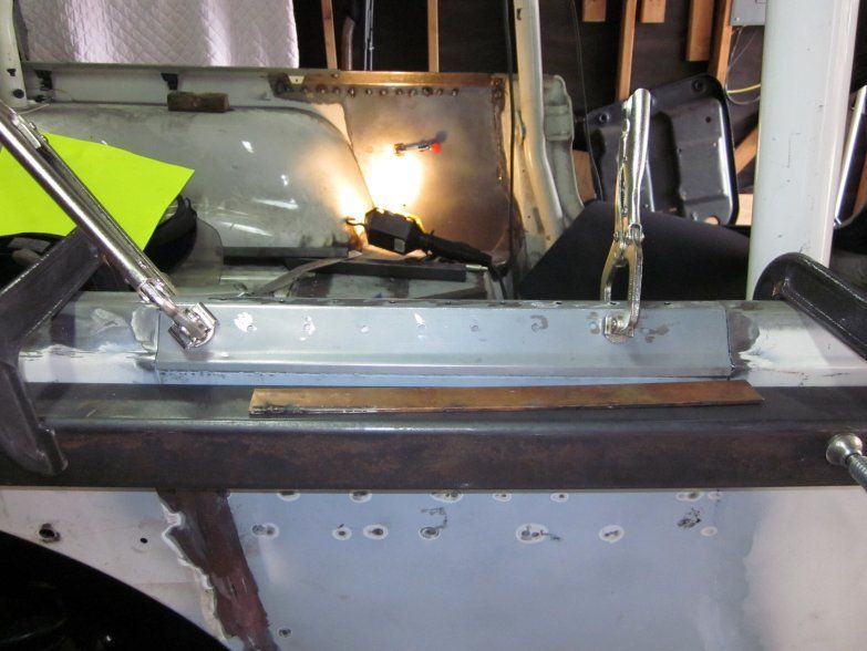

After grinding everything flat, it was important to hit the top of the tub edges with some weld through primer. Once the belt rails are in place, any exposed metal in the interior gaps would be exposed to rust.
I bought a new LJ rail on the driver's side which I had no problem welding on.
For the passenger side, I fabricated one extended belt rail from the removed pieces.
