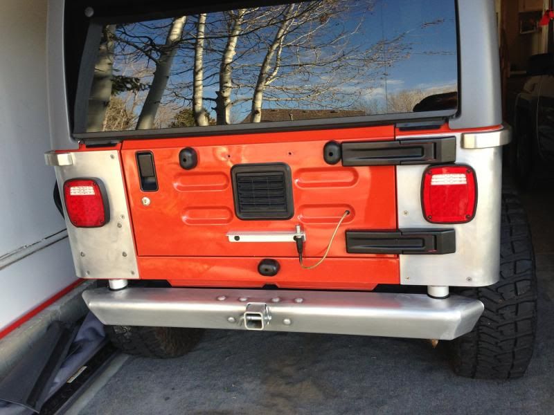

Banged out these today.
The Savvy LED's are nice but these are a pain in the a$$ to install. Directions poorly describe the install and I can't get the LED lenses to sit flush in the housings. There's just too much wiring in the back and the ground lug is too tall which makes contact to the LED lens. Also, I installed the required LED flasher and everything works as it should.

How difficult was the flasher install? Simply just pop the steering wheel cover and plug it in?
AngryTJ is offline
post #24 of 276 Old 05-12-2013, 10:05 AM Thread Starter
OkLaHoMaTJ
Location: Denver, CO
Posts: 771
It's not hard at all. There are 2 screws under the steering column that come out and then it just pops apart. Pulled the old flasher...put in the new flasher.
Works great. No more fast flashing and the LED's look awesome!

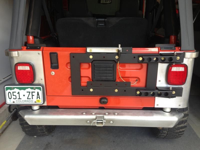

Gr8tops Exogate.
I love this thing. I just finished installing this today and I cant say enough good things about it. I got the idea from Savvy. I originally had a POS Road Armor tire carrier that weighed about 200lbs. not including the spare. I bought the Savvy receiver bumper and thought I would run without a spare for a while. It wasn't until I ran Spring Creek last week when 2 guys in my group cut their tires, then I realized I need a tire carrier. So I looked at Bestop Highrock and that wouldn't work because it was hit the rub rails on the Savvy Corner armor. I also looked at TNT and wasn't that impressed either. So I followed Savvy's thread on "~My Savvy Jeep Build~" where he uses one on Kat's Jeep. The only thing is that you HAVE to modify the top spacer. It hits the rub rail when you bolt it all down. I cut off approximately 1'' and it fit perfect. Just waiting on my tire mount to get here and it'll be ready to go.

Another
You'll notice in Savvy's thread with Kat's Jeep he said the Exogate went on without any modifications to the Gr8tops spacers or Savvy Rub Rails. Well, that's just not true. There is no way the top spacer can bolt on without interfering with rub rails.
Also, note that I left out the bottom plate that goes below the tail light. I feel that the armor is sufficient enough to hold the weight of the tire. If you were just using sheet metal then the supplied plate should be used.
