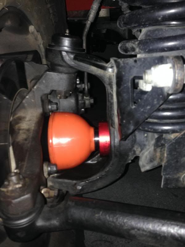

post #189 of 276 Old 04-11-2014, 05:55 PM Thread Starter
OkLaHoMaTJ
Location: Denver, CO
Posts: 771
Got the front end all torn apart. All I need to do now is clearance the knuckles so the RCV boots fit. I misplaced my 36mm socket so I have to go pick up a new one tomorrow.
Lower ball joints feel a little loose…I'm not really sure how to determine if they're worn out or not. The unit bearings are solid.
I'm off to the gym for now.
My Thread - http://www.jeepforum.com/forum/f22/another-lj-rubicon-thread-1516486/
OkLaHoMaTJ is offline
With the tire and all on the axle, jack up the tire off the ground, and try to shake it vertically. If it moves, you bjs are going out.

post #192 of 276 Old 04-12-2014, 04:39 PM Thread Starter
OkLaHoMaTJ
Posts: 771
Yeah I did that. No movement at all. Calling them good for now. I'll address these later.
Originally Posted by BimotaBruce View Post
Nice build man!
I never had a squeak with the RCV's, but from Day 1 they click when I go full lock to full lock....sounds like a CV going bad on a "normal car".
I called RCV about it, they said not to worry about it, and if it bothered me to "send them in and we'll adjust them".
I have no idea what they could do to "adjust them", but this is my DD, and between the shipping time & the inconvenience, I've just kept them the way they are.
The noises haven't gotten worse (been about a year since the install).
I just finished them up and drove about 25 miles and didn't notice any clicking or squeaking.
I'm a little concerned about the passenger side boot. I could never really tell if the boots were fully seated or not. They're not popping off and I can't pop them off with my hands so I'm calling them good for now.
A tip to anyone in the future who wants to install these. I found it much easier to use WD40 sprayed all over the CV balls and the boots to get them on. At first I was using the CV grease that RCV supplied and the air pressure within the boot would just pop the boot off the CV.
