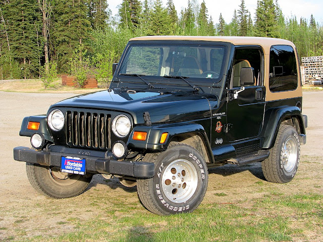

Like everyone else here I first bought my Jeep to have a nice vehicle to go off roading, plus be able to drop the top on a nice sunny day. I soon realized that although the Wrangler is a pretty capable vehicle when stock there is always the chance to improve it and make it better, hence the build...
Money, as usual, is the limiting factor. Although I have a pretty decent paying job as a 11-year Staff Sergeant in the US Army, I cannot devote all my money to the Jeep ... I am married ... if I was single I'd have this thing built as I wanted in less than a year, but the wife keeps nickle and diming me to death!
I bought the Jeep back in May. I looked around for about two months, looking at the local used car dealers, craigslist, and the local park and sell lots. In the end I was undecided between buying this stock 98 Sahara, or another 99 Wrangler that had 33" tires, a six inch lift, 3" body lift, two piece BEstop hard top, etc etc etc. In the end I did not like the way the lifted 99 Jeep drove, it felt like there was something wrong with it, something I couldn't put my finger to. Plus I wanted to mod my own Jeep, not buy someone else's project.
My 98 Sahara came with a hard top, no ac, auto transmission (I wanted that so the wife could drive it), and I made sure I had the Dana 44 with LSD in the rear. Like other Saharas it also has the 4.0 engine.
I soon joined a local off road club, Frozen Axles, and started off roading it. The Jeep instantly surprised me, I pushed it to my limits and the Jeep delivered it, proving that its limits were beyond my own. I also quickly realized that the mod bug had bit me, I wanted a better Jeep, I wanted to mod my 98 to transform it into a daily driven trail machine. Not anything too hardcore, but a vehicle that would perform well in the trail while being relatively comfortable to drive and easy to live with.
The build the began...

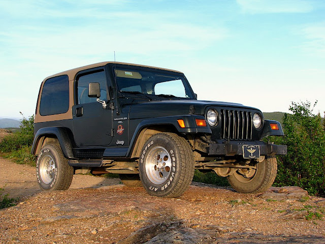

First day out of the used car dealer lot
The first mod I did was disconnecting the front sway bar. I have left it disconnected since then, I haven't missed it. Talking to Alaska veterans they say I might want to reconnect it for winter. As soon as it starts snowing they will be reconnected. I also removed both front and rear milk jugs.

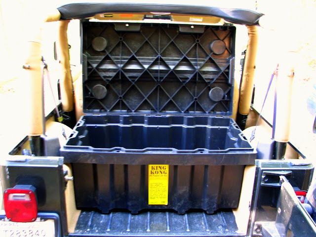

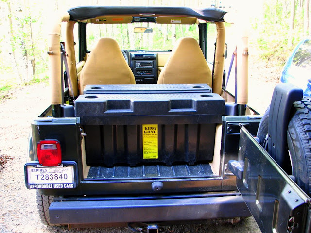

Another mod I did that was great was installing a King Kong job box on the rear of the Jeep. I wanted to put in a lockable trunk for when I ride topless, and by pure luck I found out that this tough plastic box I had in my garage was made as wide as the space in the rear of the Wrangler. It was almost as if it was made for the TJ. It fit in there very snug, I just had to drill one hole to put a bolt and washer where the rear seat belt center piece goes. With this box and a Master Snake lock I had a lockable trunk in my TJ. Sure, someone with motivation can get in it, but for 95% of would be thieves this box is a great deterrent.
The box in the rear of the TJ, there is a 1 foot space in front of it and another one behind it, so there's room to just drop stuff there that I don't need locked.
Notice how the lid opens as if it was made for the Wrangler...

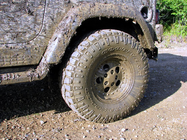

My next mods were more expensive, and more serious too. I added Rough Country 1.25" wheels spacers in preparation for bigger tires, and I started researching which tire I would buy.
In the beginning I wanted to buy Cooper Discoverer STTs, in 32" size. I quickly found out that STTs, while they are great tires, aren't cheap. I could get STTs for $225 a piece or either Dunlop Mud Rovers, BFG KM2 or Goodyear Wrangler Duratracs for less than $175 each.
I ended up going for the Duratracs, as they are a hybrid AT/snow tire, not quite a mud tire, and since I live in Alaska and for six months of the year I am commuting on snow and ice I need good winter tires. The Duratracs fit the bill. They have a nice, aggressive tread to them, as in the two days I had them installed they have not disappointed in the mud. They worked great in the sloppy stuff too. Now I have to wait for snow and ice to see how they do in their designed environment...
The only thing I didn't like about the Duratracs so far is that they are made only in 31" or 33" size for 15" wheels. I wanted 32s, but I had to compromise. I figured sooner or later I would want 33s anyway, so I got them, 33/12.5x15. For my review of the Duratrac tires, click here.
Duratracs after the mud
Nice aggressive wall treads should provide good traction on snow and mud
Good looking tire from the front too
Tire detail
Tread detail
These snow hybrid tires did not disappoint in the mud
Frozen Axles? More like Muddy Axles...
They look good even on the driveway... (yes, even in my driveway I am off roading )
With just a 2" BB and 1.25" wheels spacers these tires are rubbing on the front fenders and the front right tire is rubbing on the lower control arm on full right turn. I am ordering a 1" BL to fix the fender rub, for the control arm rub I have to research how to fix that...
