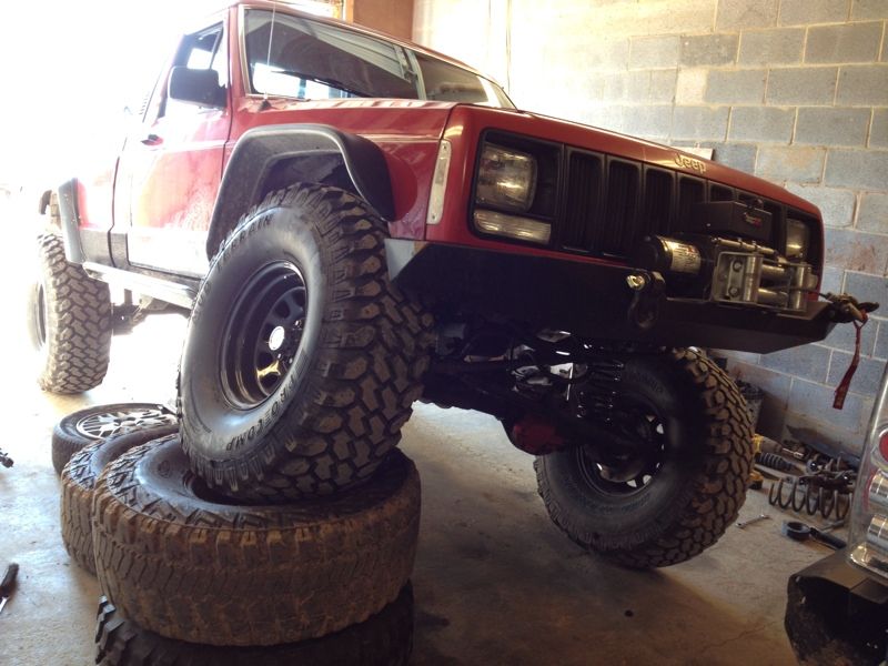

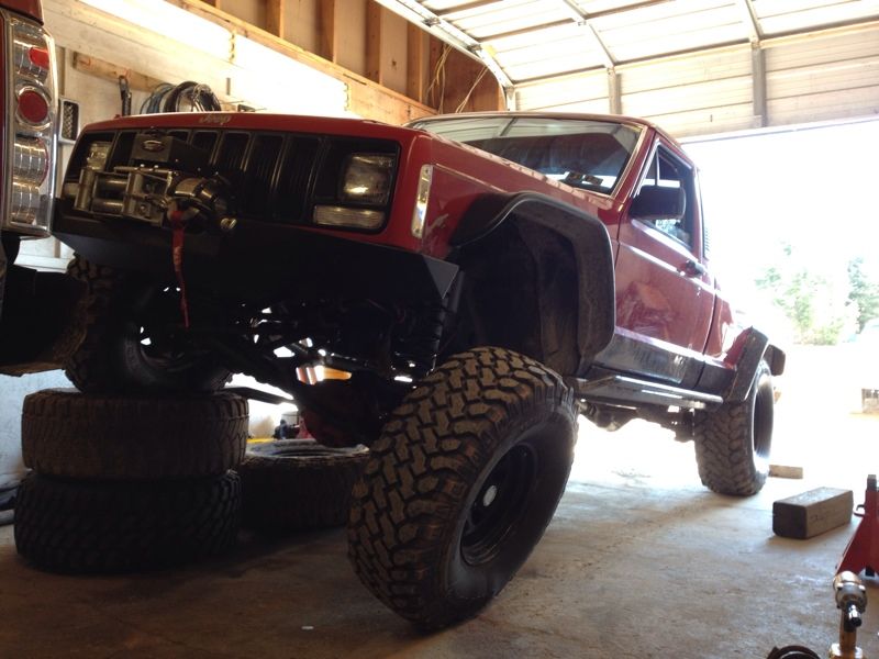

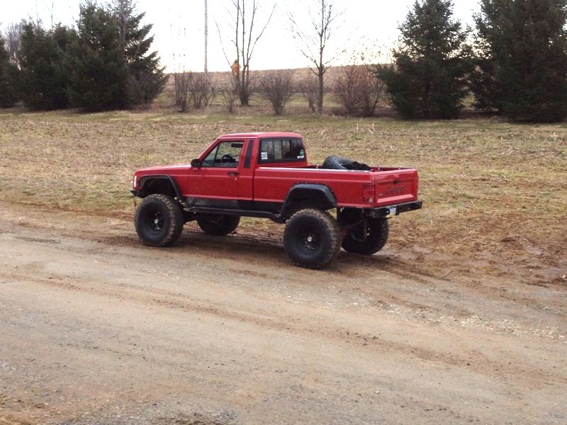

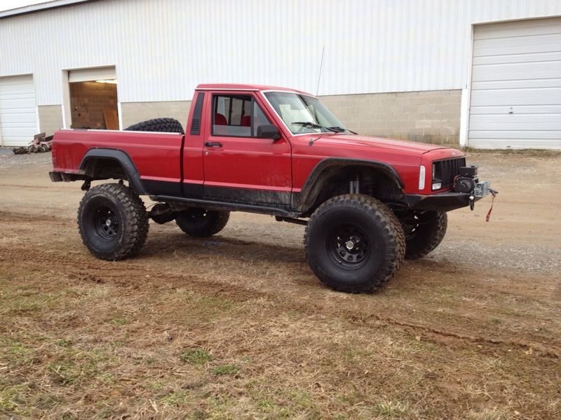

i had off work today, since we started working 4 10's.. so off to the garage i went, got sterners 5.9 zj buttoned up and out of the garage. then i brought down the comanche and put in the 6" coils, and i used the 12" travel bilstiens up front... then i tore into the rear, the spring over axle conversion went well but i still have to finish weld the spring perches, mock up shock mounts, and re-route the brake lines. i ended up going with a JKS bomerang shackle (stock height for an mj) and the 3" alcan spring pack, which it is apparent that i need to remove 2 or 3 springs from the pack, the rear sits 2.5" higher than the front making it 8.5"
it flexes so much better with the new shocks, now the drag link is my only limitation. in these pics the driverside shock has 4" of more down travel available, and the passenger side has 0" of up travel. i am going to need to work with the suspension, maybe rebuild the upper shock mounts, and install bump stops.

Hot d@mn that thing looks like a race truck man all jacked up in the rear n stuff hahaha

Pulled the smallest and 3rd leaf from the pack... Much better
