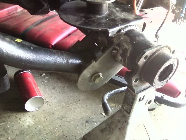

also got the lca's tack welded into place... the brackets were too narrow for the bds arms (w/ poly bushings), but the fixed rc arms fit fine, i think i am going to try shaving a bit of the bushing and sleeve from the bds aca's so i can adjust the pinion angle... either that, or i might try to trade the bds lower adjustables for some upper adjustables... we'll see about that.. my friend will hopefully be stopping by tomorrow or friday morning to burn a good weld or me
