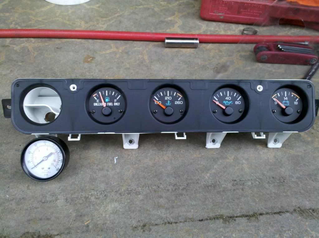

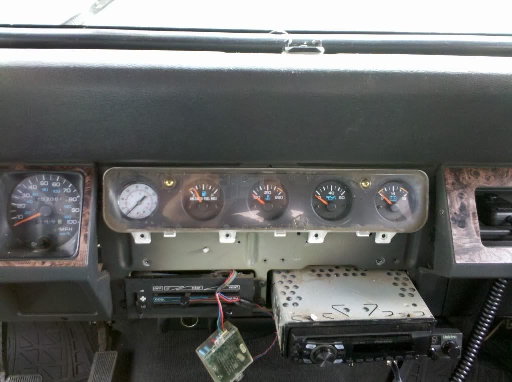

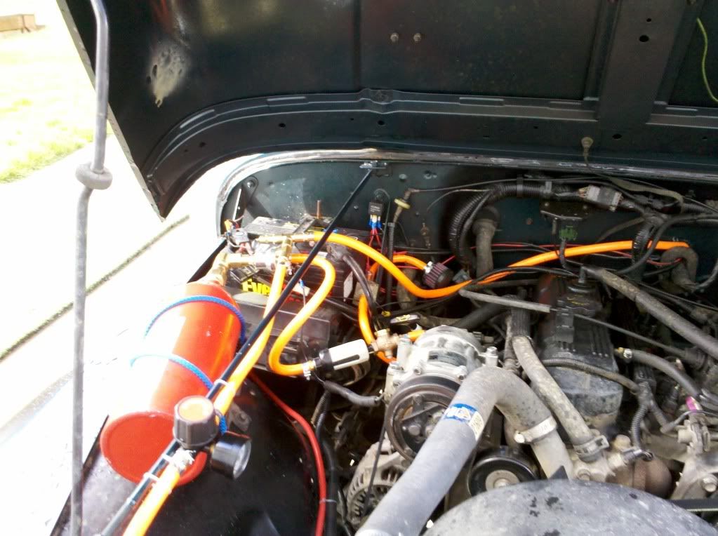

So I got to work more on my OBA project and I can say I upgraded fire extinguishers. It all works and pumps air great! No real leaks to be noted of. Although I believe that the pressure relief valve is bad. It keeps going off at 100psi, it is suppose to go off at 115psi. The main problem with this is the fact that my Pressure switch doesnt tell it to shut off till 110psi.
Still have to finish some minor things, wire a correct switch inside the cab. Get a actual strap and not a bungie cord to hold my Fire Extinguisher down, and plumb a front quick disconnect. May leave the Quick disco under the hood for now though.

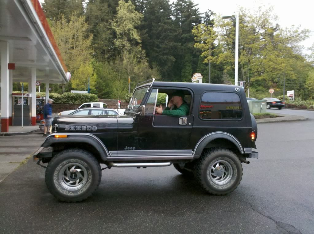

My girlfriends dads jeep and mine

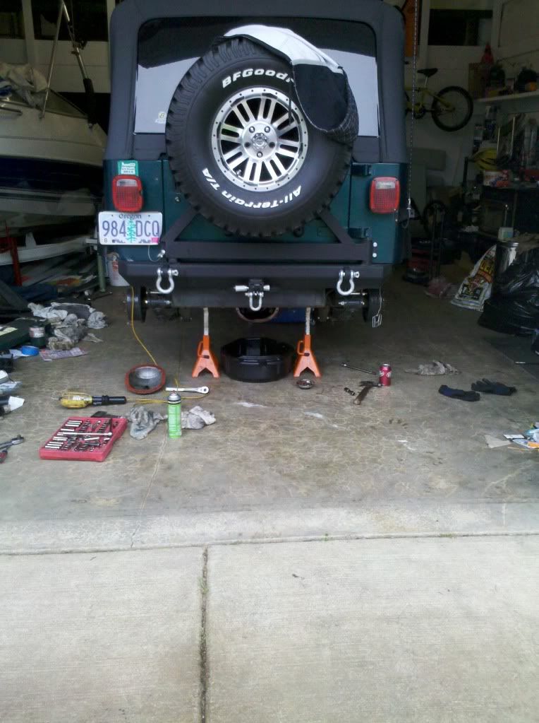

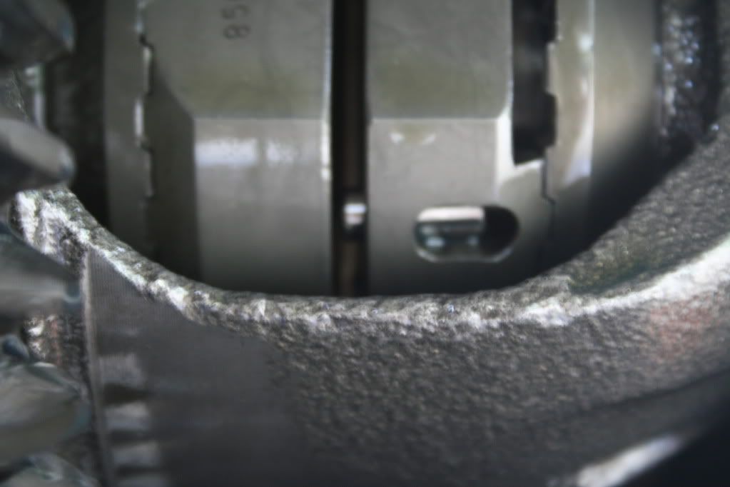

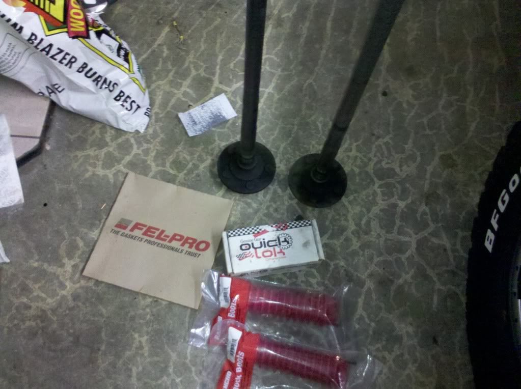

Well I decided to give the Turdy five a chance. It is now locked now that I have got a pair of spare shafts. The install was not as bad as I was expecting minus me being messing up installing the spacer. Found out that pretty quick when I went to put the shafts in. Then had to tear it all back apart.

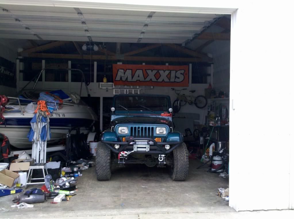

Going into the shop
The parts, and spares
Look very closely at this photo spider gear pitting.. I was amazed it still worked I am guessing there was not much lift left in them
Installed
Because I could

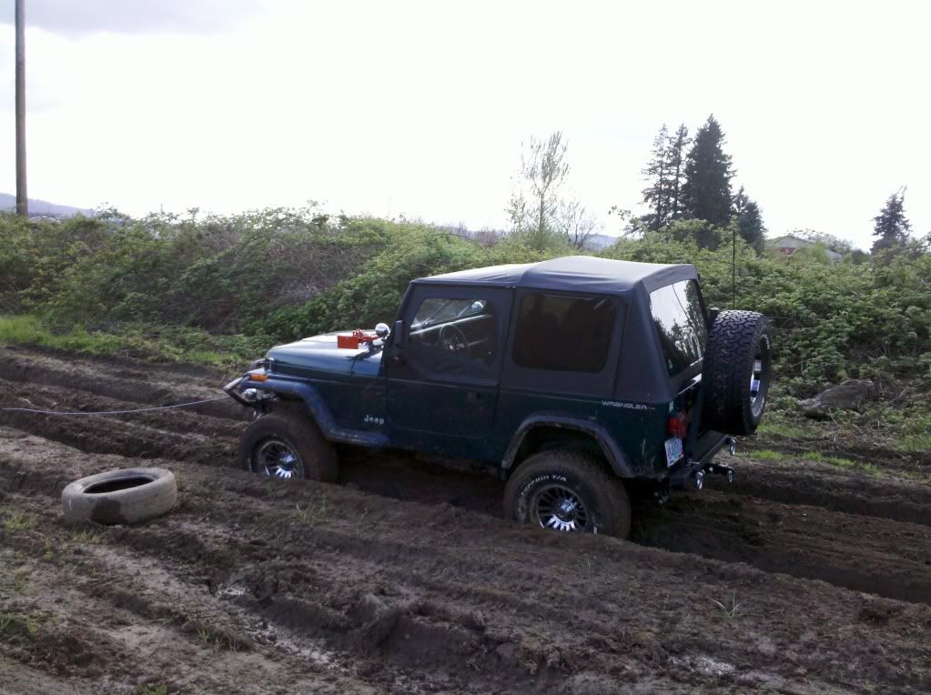

Then just to shoot my confidence back down after being fully locked, I went to a local mud hole where sure enough it got deeper and I high centered and used my winch to get out haha

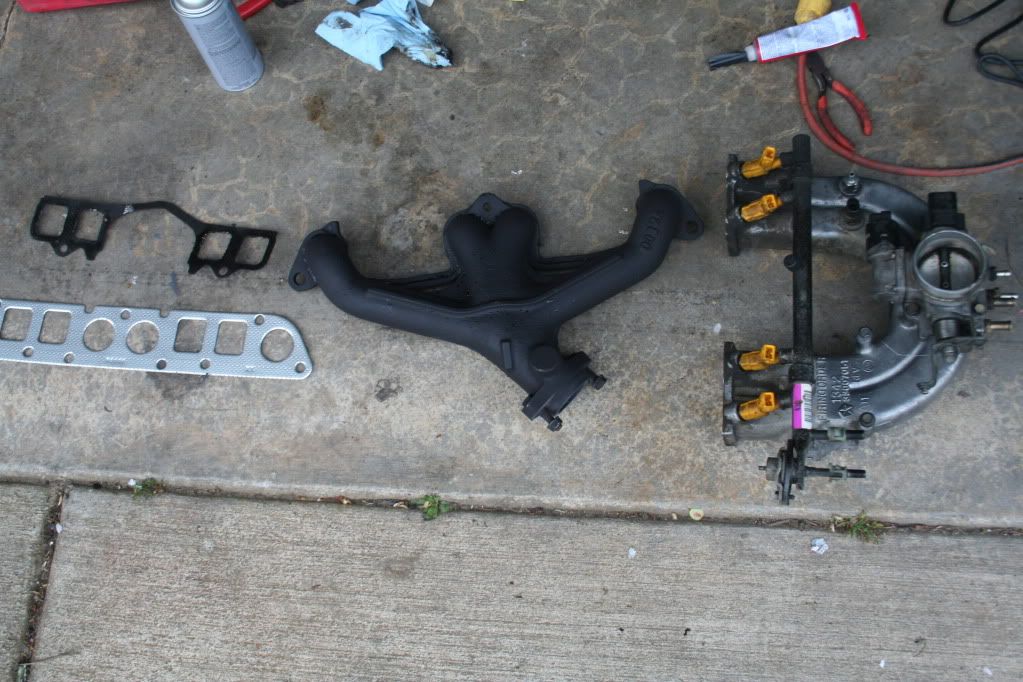

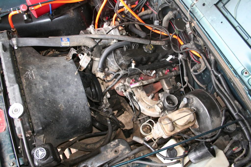

I am really just fixing a bunch of things that bothered me. My jeep has had a header manifold leak for some time now and is driving me bonkers, plus my gas mileage is worst because of this. I also need to paint my drivers side fender flare and high jack lift. I have rear shock boots to put on.
I am also planning on doing 19lbs injectors and a 4.0 throttle body while I have everything apart, that way I can correctly port the intake too for the throttle body..

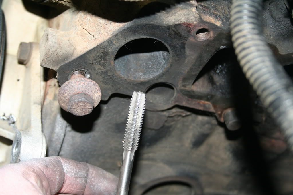

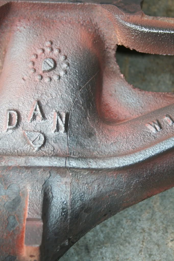

Well I had two broken bolts inside the head that held my exhaust manifold on. Taped and dyed, DONE! I hate manifold studs... Almost every car I have had has had at least one broken.
Ohhh and my header had probably a 4 to 5 inch crack on the back of it. Welded it up, hopefully it holds.
High jack lift is semi painted.

Said header crack
Welded (Pretty much a newb, have welded a header before on my old ZJ and it held fine)

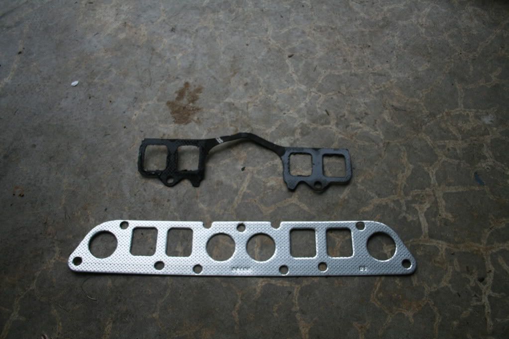

All that was left of the old gasket VS. the new

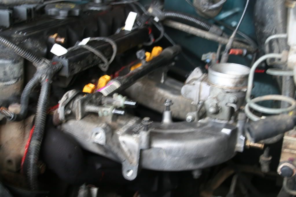

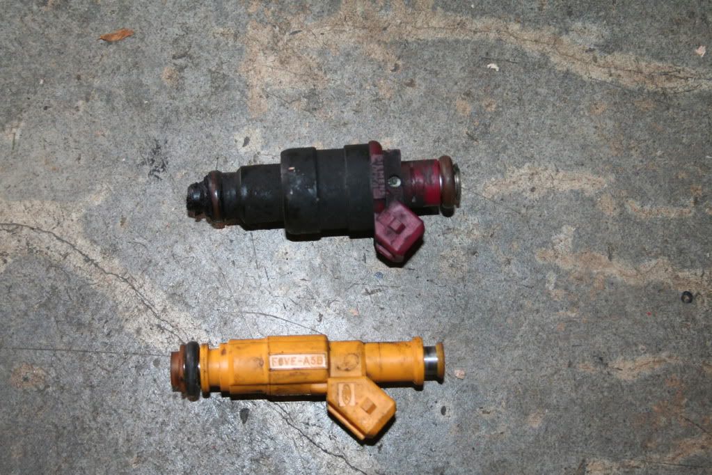

Old injector VS. 19lbs 4.6l Thunderbird injector (I liked this style better due to the smaller size but still the 19lbs and 4 nozzle)

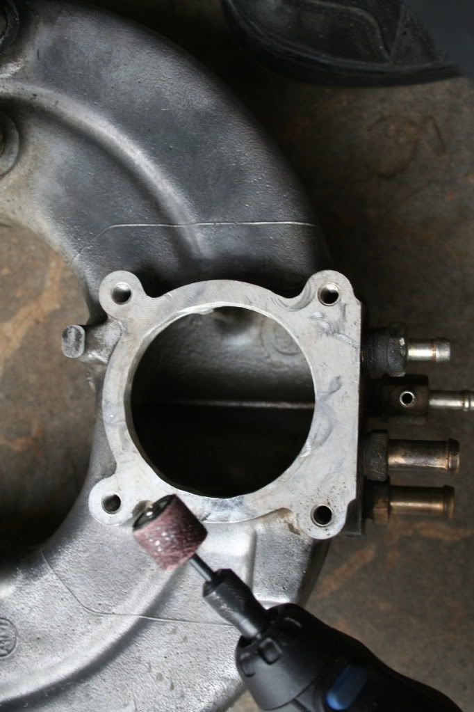

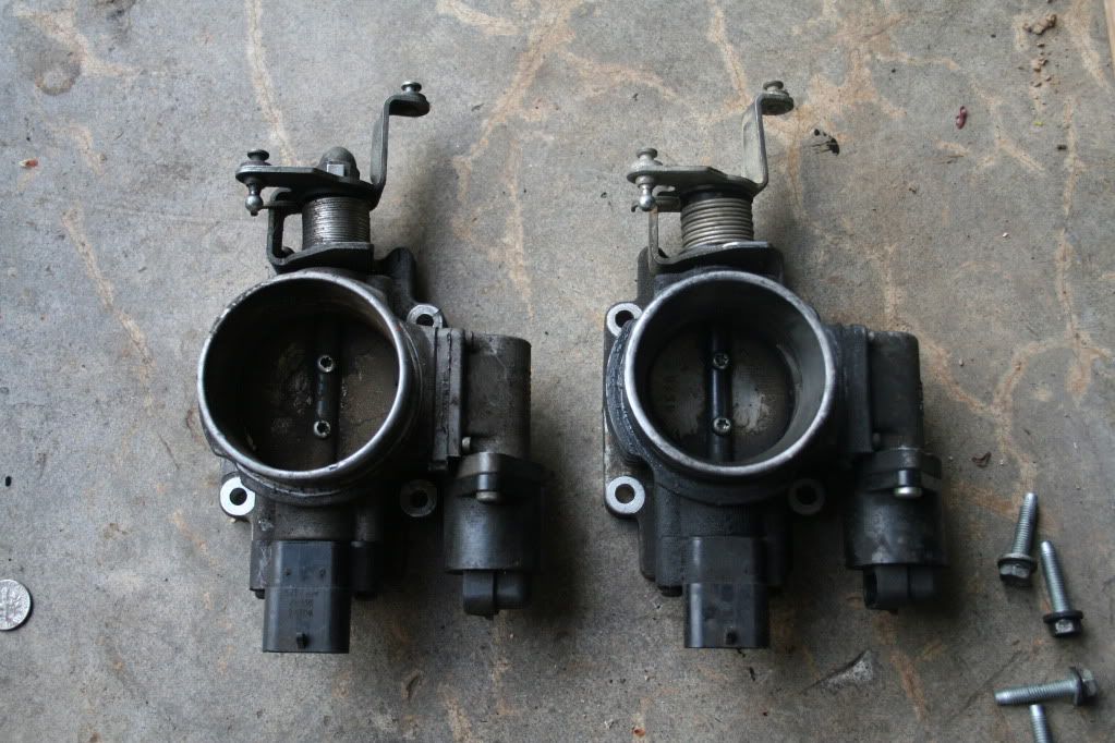

4.0 VS. 2.5 throttle bodies
Porting out the intake to make the 4.0 throttle body useful
Drilling out the broken head bolt
Fixed!

Anyway I have now completed this and drove the Jeep tonight. I can say it has more low end for a better take off. It may have a smoother power band as well. I can say that I am excited to drive it too really feel if there is any difference at all.

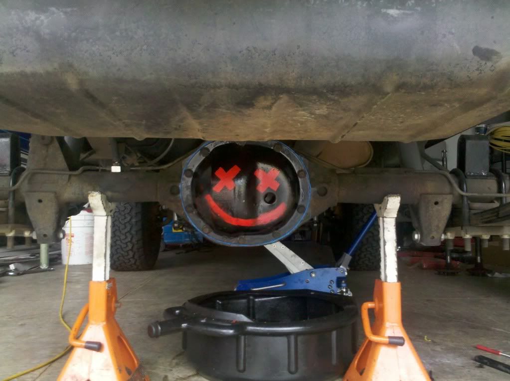

Well, I went out wheeling yesterday and the rear locker I just put it blew out. It either sheered all the teeth off or did some other catastrophic failure. I ran to pick and pull yesterday and pulled some usable spider gears as I was not going to put mine back in. I will hopefully get that together today with an update on the condition of the locker.
I had to drive home in 4 wheel drive which was not so fun on dry pavement with lockers.

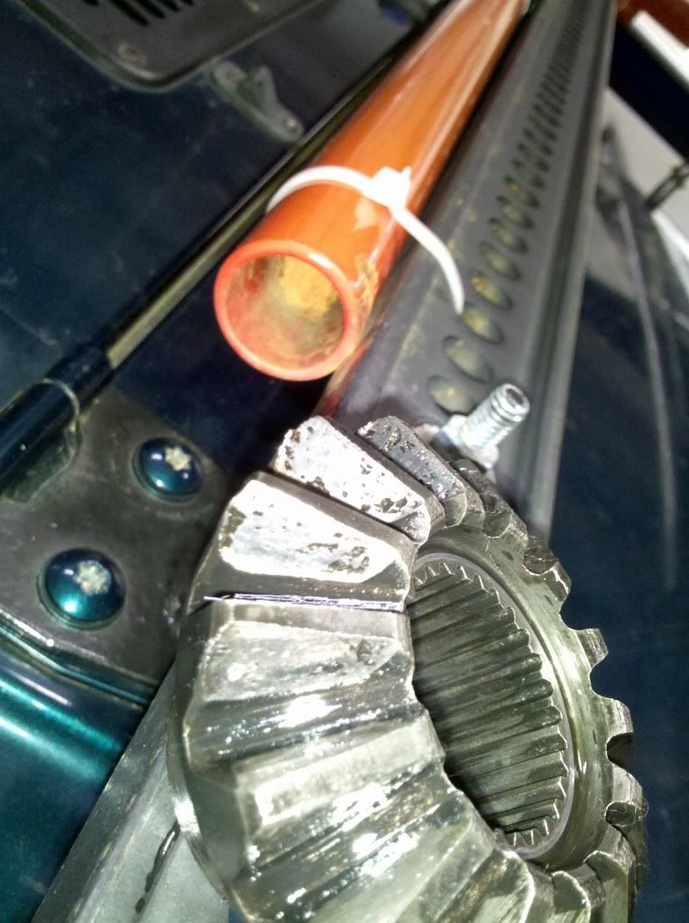

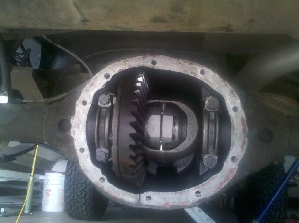

Well as it turns out I dont think there is anything wrong with the locker. Two of the springs like popped out of the locker and it did not have enough force to hold it locked.... Anyway on that note my backup vehicle/daily driver the clutch stuff went out and now had no car. Borrowed my moms car and drove to the parts store for fluid and gasket for my diff cover and threw my spider gears back in so I could get to work tomorrow.
Heres a pic of what was missing.

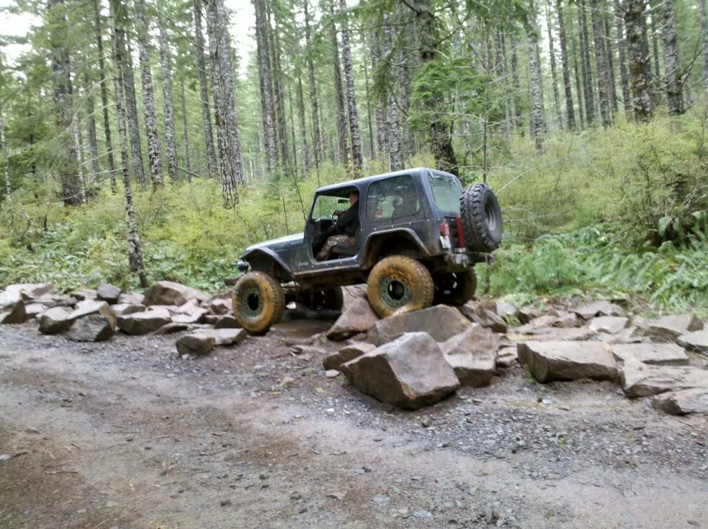

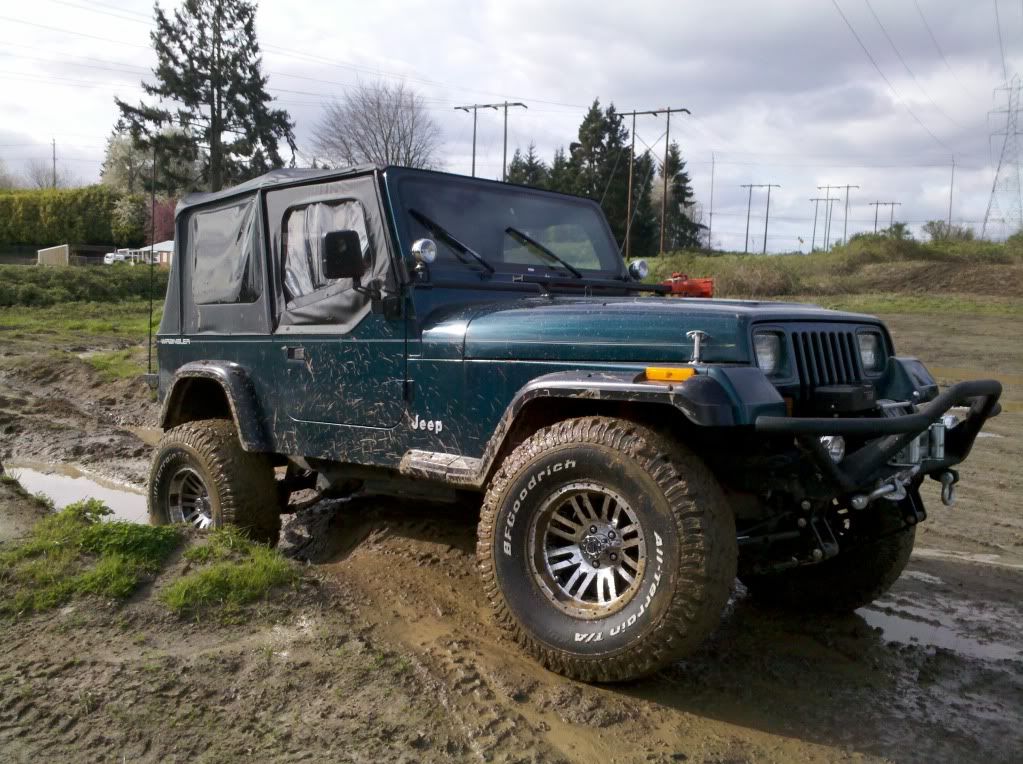

Heres some wheeling photos:

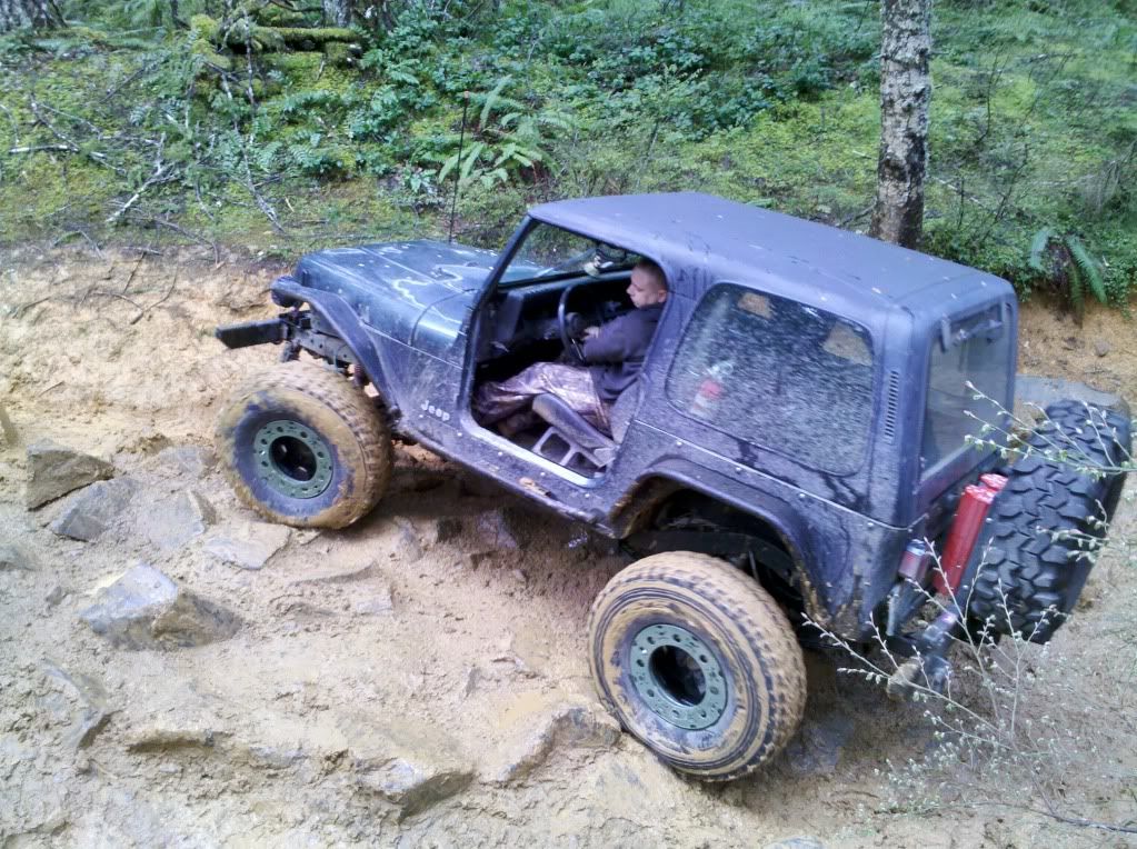

This guy is fully Metalcloaked on 37's
No cool action shots on this trip for me
