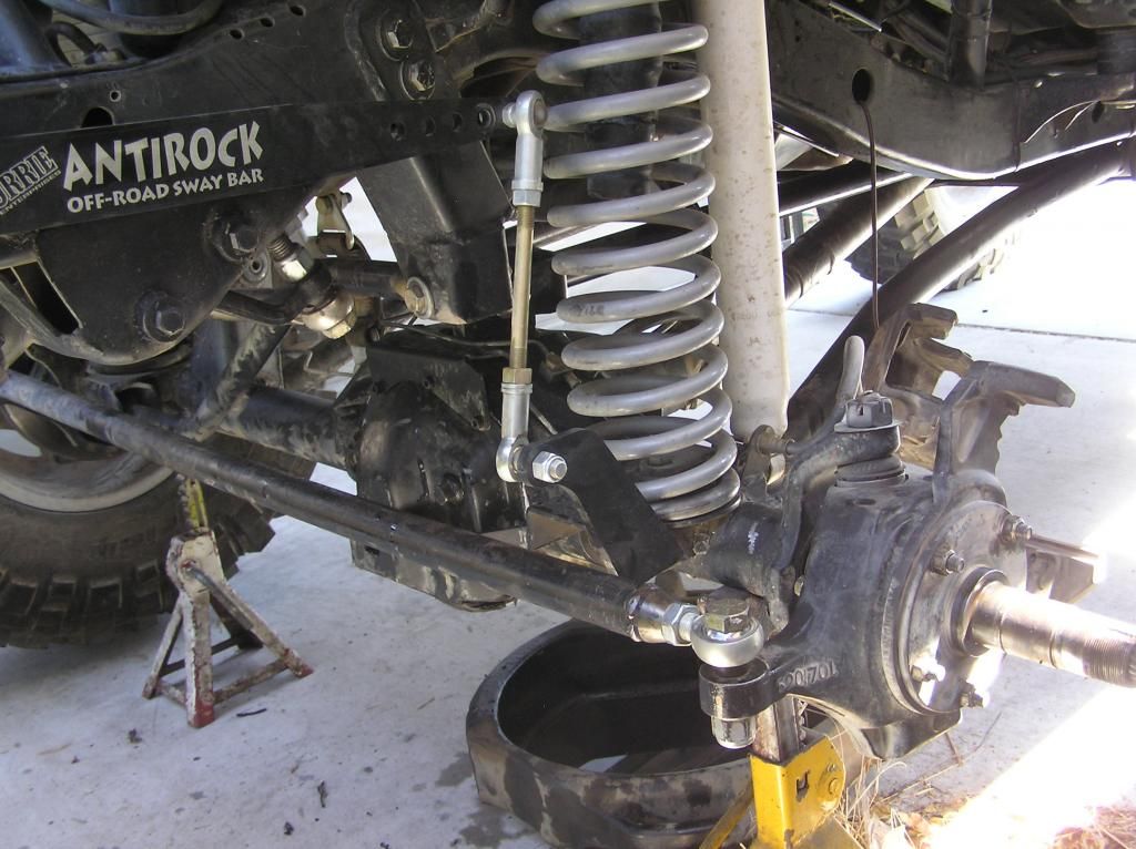

You want a trackbar with a heim or JJ on the frame end.
Also the current extension bracket that you have will just put more strain on the frame bracket, the stock bracket does rip of or crack under heavy trail use as is. Rockkrawler and RE make an add on bracket that goes to the frame as well and is a much better add on than you have now

I had an issue back in the day with the trakbar being too short so rough country sent me the bracket for their 4-6 inch lift which looked just like that rockcrawler one. When i set it in place to look at it i noticed it was right over my tierod and i would have needed massive bumpstops to run it.
The one i have now has a rod end on the axle side so im just going to leave it on as a temporary think till i save enough for the currie one

The Currie trackbar isn't bad, however you are going to find that the big bolt that goes through it and mounts it to the frame bracket will come loose, no matter how much you tighten it. Been there done that.

Thats interesting. Its the first time ive heard that. Maybe it would be better to make what i have now work. I was thinking of putting a jj on the axle side since the rod end it has now has some play. Or maybe like you said and get a trackbar with a heim on the frame end

Truthfully to do it once and to do it right take a look at the rockkrawler bracket. It will pretty much keep the frame bracket from cracking at the webbing or keep it from ripping of the frame all together.
Then either get their trackbar or use an RE one or add heims on both ends of the one you have

If you have a trackbar with one heim does it matter what side its on? Or will the side its on see less stress? Wouldnt a trackbar with heims on both ends flop over?

It would but you can mostly limit that. The bushing should be at the axle end since there is the least amount of rotation there.
