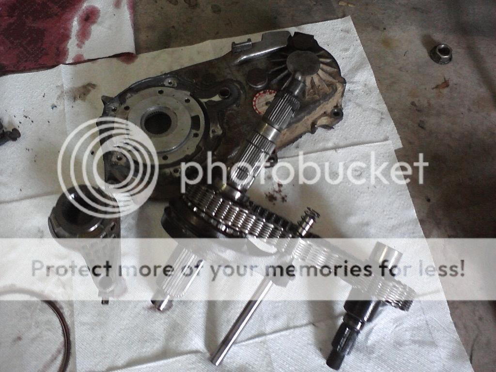

Did a ton last week(including moving back to IL), I've been waiting for my buddy to send me pics. My plan was a simple tcase swap, that did not go as planned, each tcase had different input shaft length so I had to swap them here are a few pics my buddy took, also had to swap the front the output yokes. sorry for crappy cell pics
Pic of me starting to work on the TJ case
After 30min or so I had this (TJ case on left,YJ on right)
Input shafts next to eachother(TJ on left, YJ on right)
just some random pics
Yuck
More to come

Which eventually turned into this
I had to drive to Wheeling, IL in FWD to get the shaft that came with the tcase shortened.
Heres the shortened shaft
