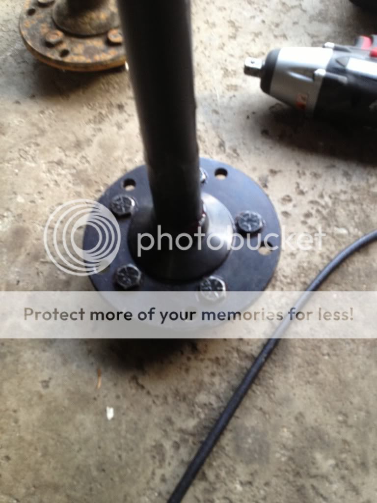

Time for an update, so since I bought the jeep my rear axle has had excessive endplay in the axle shafts, so I finally decided to do something about it.
Here's the shafts that were in the jeep, they appear to be superior brand based on part #
Here's a stock shaft
The answer, alloy usa 30 spline
Removing old bearing/seal
New bearing
New seal
Studs installed
Shafts installed

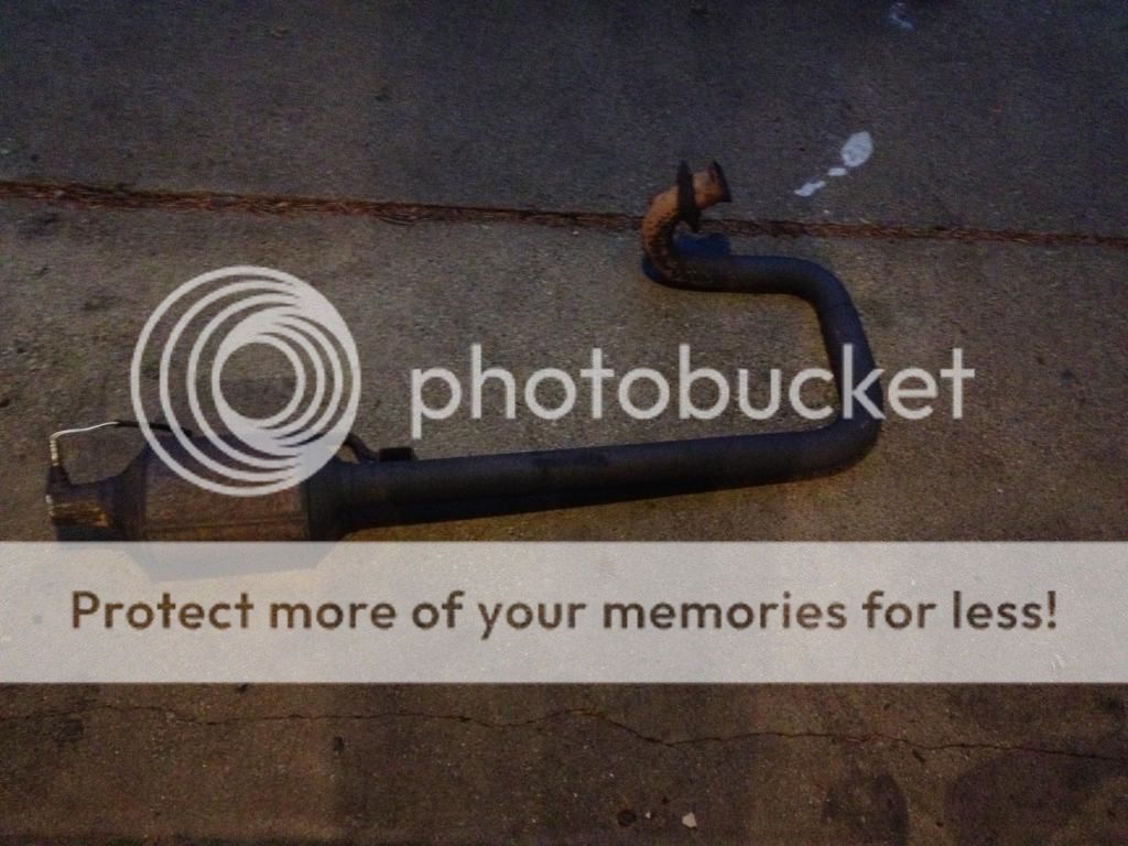

Wow been over a year since last update! Today I started doing some very overdue maintenance on the jeep, since I don't drive it during the winter I'm in no rush. Removed the old leaking, bent to the point it was rubbing on oil pan exhaust.
